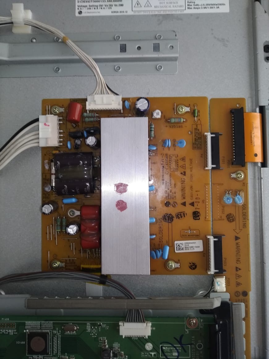

      Below is a picture of the ZSUS Board which is directly linked to the Power Board:

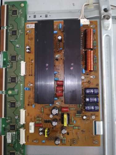

      Below is a picture of the YSUS Board which is connected to the ZSUS, it is not connected to the Power Board:
      When I plug the YSUS to the ZSUS after changing the shorted IGBTs, the TV start again to click and two of the ZSUS IGBTs get damaged and I have a short between VS and GND.
      I have also noticed that when I remove the ZSUS shorted IGBT and plug the YSUS to the ZSUS, I have a picture on the TV until two of the YSUS IGBT get damaged.
      About the fake Chinese component, yes it is a possibility. I was looking on the mouser website for 30F124 or 30J124 IGBT but I could not find any. So what I did is to order same IGBTs from different suppliers. Hopefully, today I will get some other ones and I will check again.
      In my TV configuration, is it possible that a damaged YSUS could damage the ZSUS?

        I have made some progress, I removed the damaged IGBTs from the YSUS board (they are located on the SUS_UP part).
        I plugged back everything including the ZSUS board where I have changed the 30F124 IGBTs (also located on the SUS_UP), and now the TV powers up with a blurred but watchable picture.

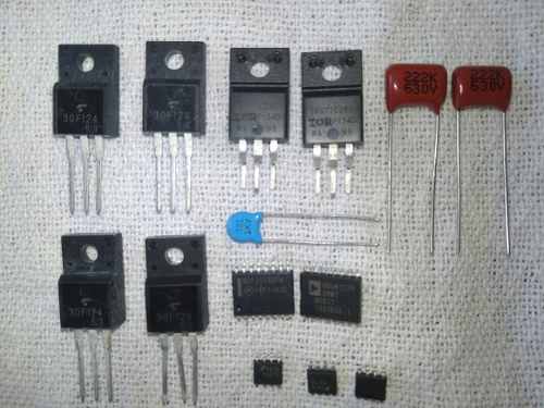

          hi friend ! congratulations from brazil !!!!
          ATTENTION! Due to the absence of the LG manufacturer to provide new parts in addition to the opportunism practiced in the market, I decided to repair with SUCCESS of my own LG 42pw350 TV, I am sharing and making available components necessary for maintenance of the Y-Sus (EAX62080701) + Z-Sus EAX62081002Y) suitable for LG 42PT250 42PT350 and 42PW350 PLASMA TVs >>>>
          COMPONENTS FOR Y-SUS >>>>
          -02 Toshiba IGBT 30f124 transistor (position Q-713 and Q703) (can be replaced by 30j124 30f125 30f126 30f127)
          -02 IGBT Irg71c28u IOR transistor (position Q-709 and Q-708) (can be replaced by 30j124)
          -02 IGBT Fdp33n25t Fairchild transistor (position Q-711 and Q-710)
          -01 331k x 1kv polyester capacitor (position C-721)
          -02 222k x 630v polyester capacitor (position C-765 and C-764)
          -01 Ci ADUM1234 (back plate position IC-701)
          -03 Ci FAN73711 (back plate positions IC-702 IC-703 IC-711)
          -01 Ci NCP3163bpw (back plate position IC-509)
          COMPONENTS FOR Z-SUS >>>
          -02 transistor IGBT 30F124 Toshiba (can be replaced by 30j124-30f125-30f126-30f127)
          -02 ceramic capacitor 222k x 630v (position C-111 and C-107) It is necessary to change when pair of 30f124 burn again for a second time with Y-sus OK (without short).
          -02 Ci Fan73711 (back of IC-7 and IC-8 position plate) OBS> it is necessary to change when the pair of 30f124 return to burn for a second time with Y-sus OK (without short).
          IMPORTANT >>> After replacing the components, make sure that the capacitors in the power supply are discharged before reinserting the plates in place, thus preventing the risk of electric shock and electric shock to the plates that cause the newly replaced components to burn prematurely.
