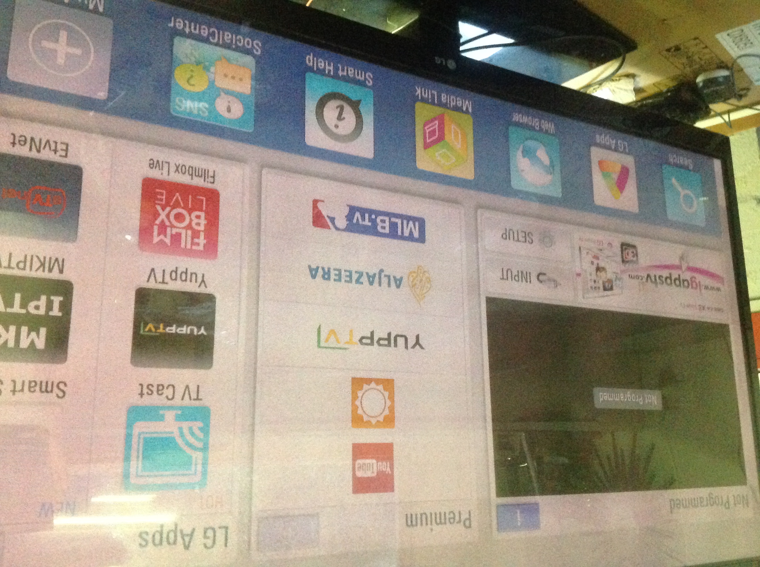

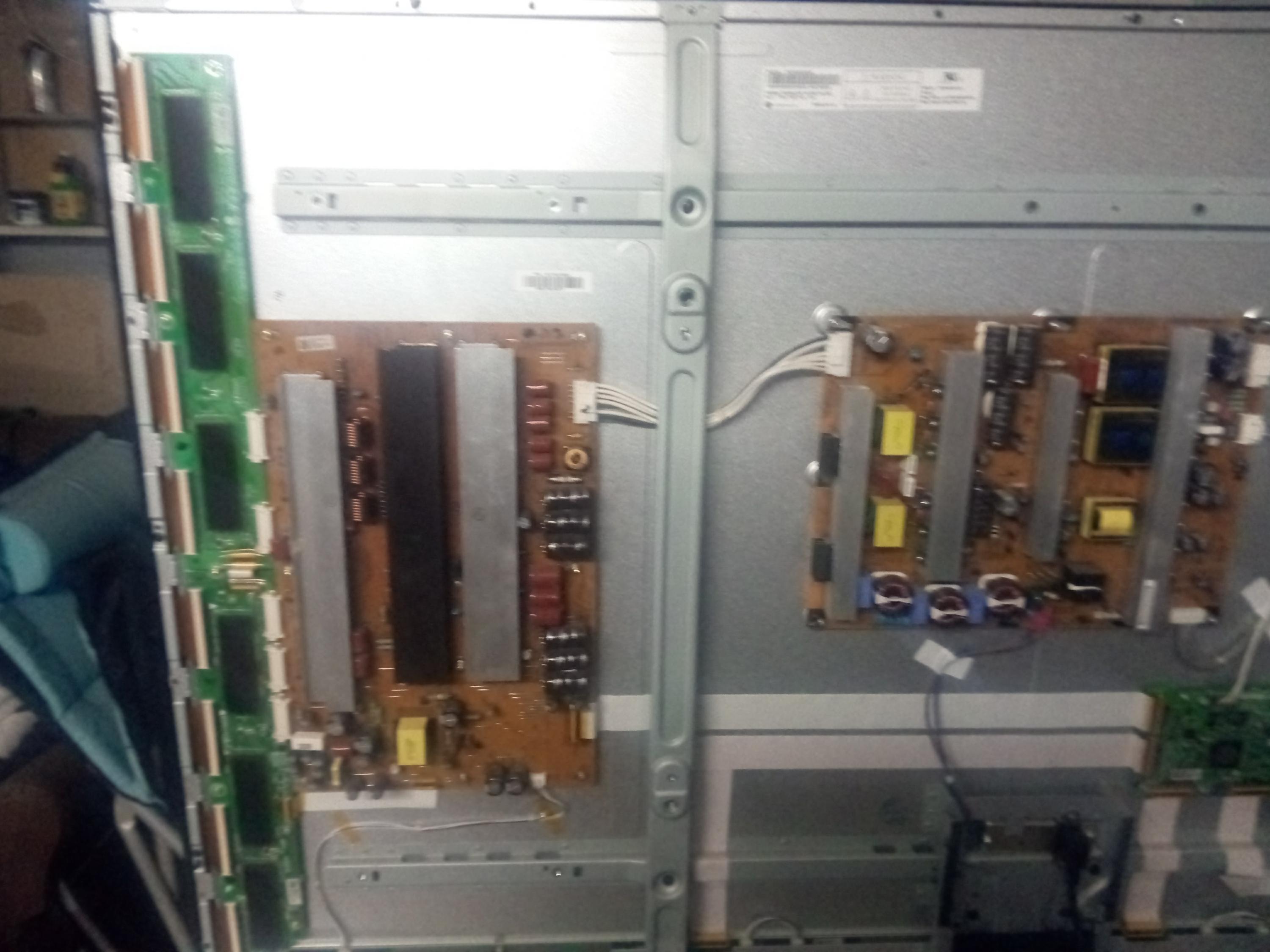

    Hi everyone,
    I have had a interest in electronics forever, and as a hobby have tinkered with repairing things, taking them to bits, and so forth.
    However, I have a LG 60PZ570 that is causing me to rethink my life!!
    I purchased it for $100 as it had no picture, got it home, and it has the classic ZSUS issue, where in the picture is splotchy and dark.
    I checked the ZSUS board and determined there were a few blown transistors, fuses, etc.
    I looked up the repair kits, but the $70 shipping fee was a bit steep for me (I live in New Zealand) so actually managed to find a new ZSUS board.

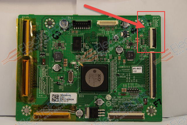

    Now, according to google, the board I got new, a EBR73561701, is compatable with this model of TV.
    The previous ZSUS was model EBR67820001.
    Anyway, got the new board, plugged it in, and I have the same issue, but also a buzzing from the new ZSUS board, probably from the coils I think.
    Attached are some photos, and click here for a google video link to a video I took of the noise from the ZSUS.
    I've checked the voltages and all seem ok. I did the jumper test with the control board and got test patterns ok. When I plugged my old ZSUS board in the TV shuts off straight away, which I half expected because I knew the ZSUS has busted transistors.
    I'm just at a bit of a loss....is there a chance the new board isnt compatable? What should I do as far as my next troubleshooting steps are?
    I have been following the service manual for my troubleshooting. (I also checked via search function too to make sure no one else has a simular issue)
    Any advice MOST WELCOME!

    Re: LG 60PZ570 - Zsus replaced, still have issues
    Check and double-check the coils on the Y and Z sustain boards. This model is known for cracking solder around the coils. Buzzing from the Z sustain can also be caused by voltage being carried across the panel to the Z sustain board from the Y sustain. Make sure you're getting good voltage at the Z sustain. I worked on a 60PZ950 before. This TV was a real pain in the ass to figure out
      Also make sure all screws are installed on y and z board. This model does not use a primary ground contact between each screw lead

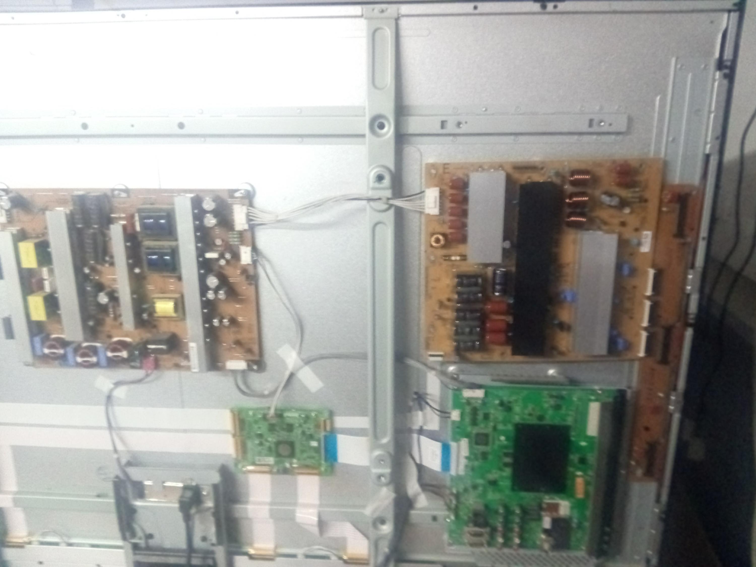

                I notice in your video that the boards do not have all their securing screws holding down the boards. I believe when reading through the Forum, that it is vitally important to have all securing screws in place and firmly done up or could cause you even greater problems.
                  Hi to dick_barton, heavymachines and again to freakaftr8, thanks all for your replies.
                  Tonight I went down and hand screwed in all the screws in tight as I could, triple checked the tv for all the screws, all in and tight. Same issue occuring.

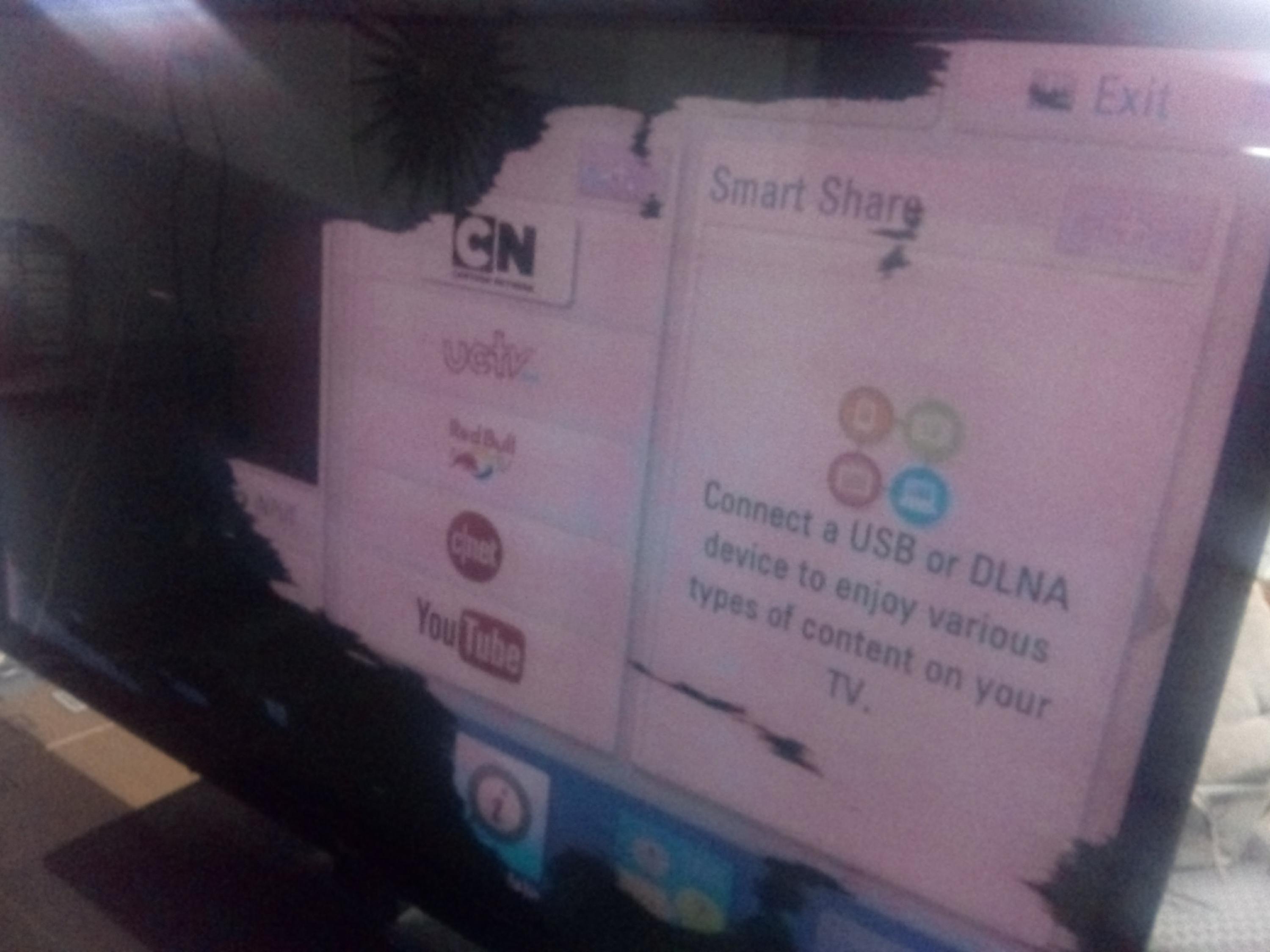

                  However, before tomorrows adventure of removing the boards and checking the solder, I followed up on that cable that I dislodged by accident.
                  So, the picture is a full screen now, only dark pools/patches when the tv powers on, for a few seconds, and then its a full screen.
                  I've taken another video, hosted in google video here on this link, just to show what happens when the cable is on and then removed.
                  I appreciate any insight into this.
                  A further FYI - while poking around the control board with my multimeter, I had black to earth and positive to the top then bottom of the crystal at point X1 on the control board.
                  When it was at the top, the buzzing would turn to a different frequency, and when to the bottom, it stopped totally.
                  When checking the screen, the test patterns stopped and the voltages going to the control board were down to 5v from the ZSUS, so I suspect that I might have earthed it and it triggered some kind of protection? Just thought I'd add that in there.
                  Thanks again for your time reading this, do check out that video and let me know it there might be something in that, or am I doing serious damage in playing, haha!
                  Thanks.
                  PS - also attached pictures of screen condition now, is this dot mal-discharge?

                    This looks like y sustain issue now I would go ahead check soldering on all those coils of both boards but you're definitely getting closer

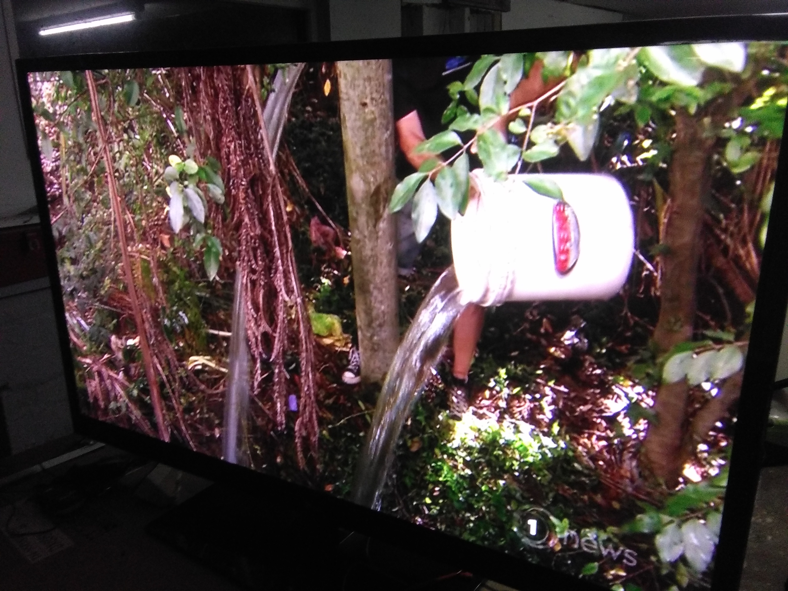

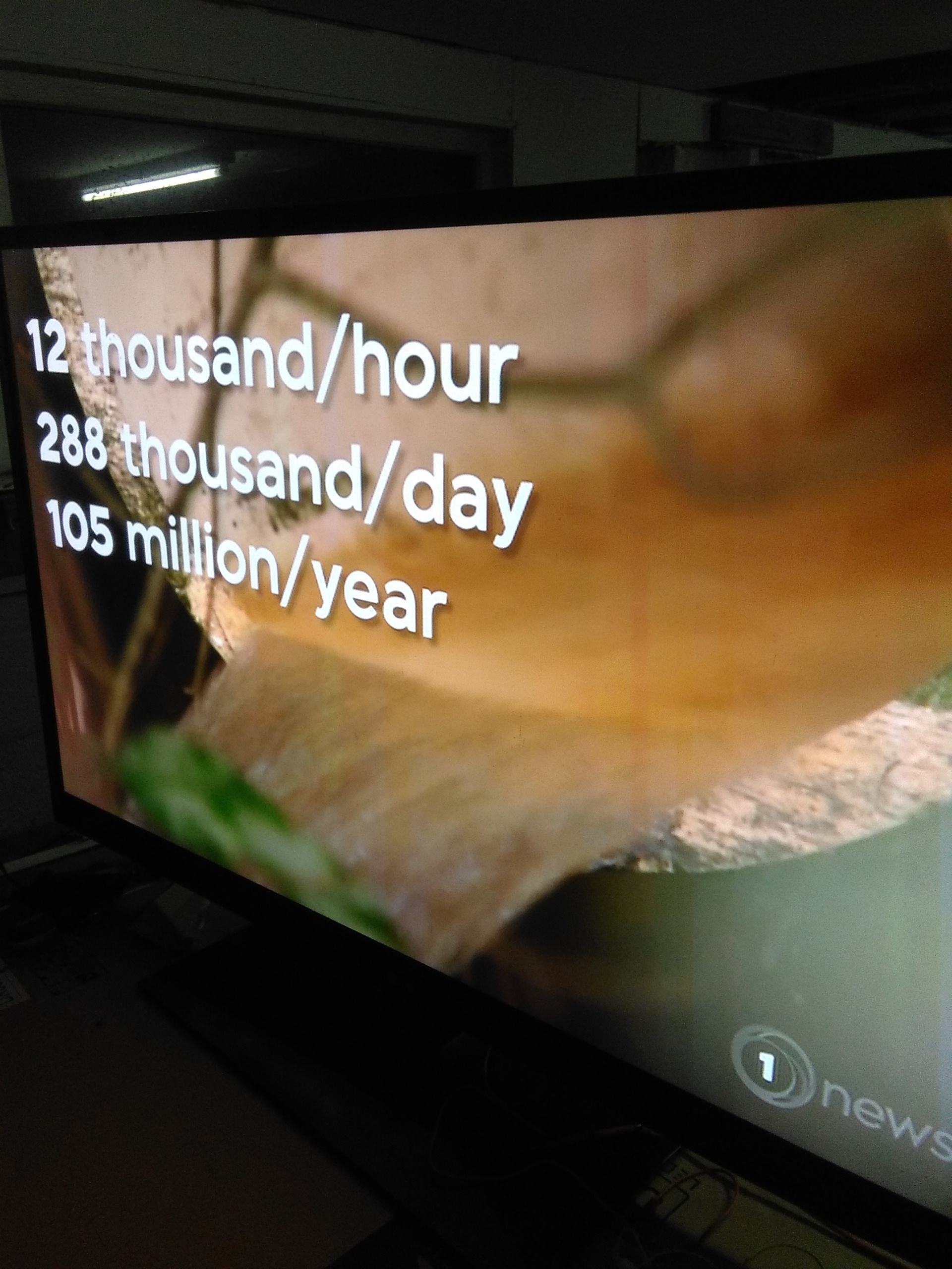

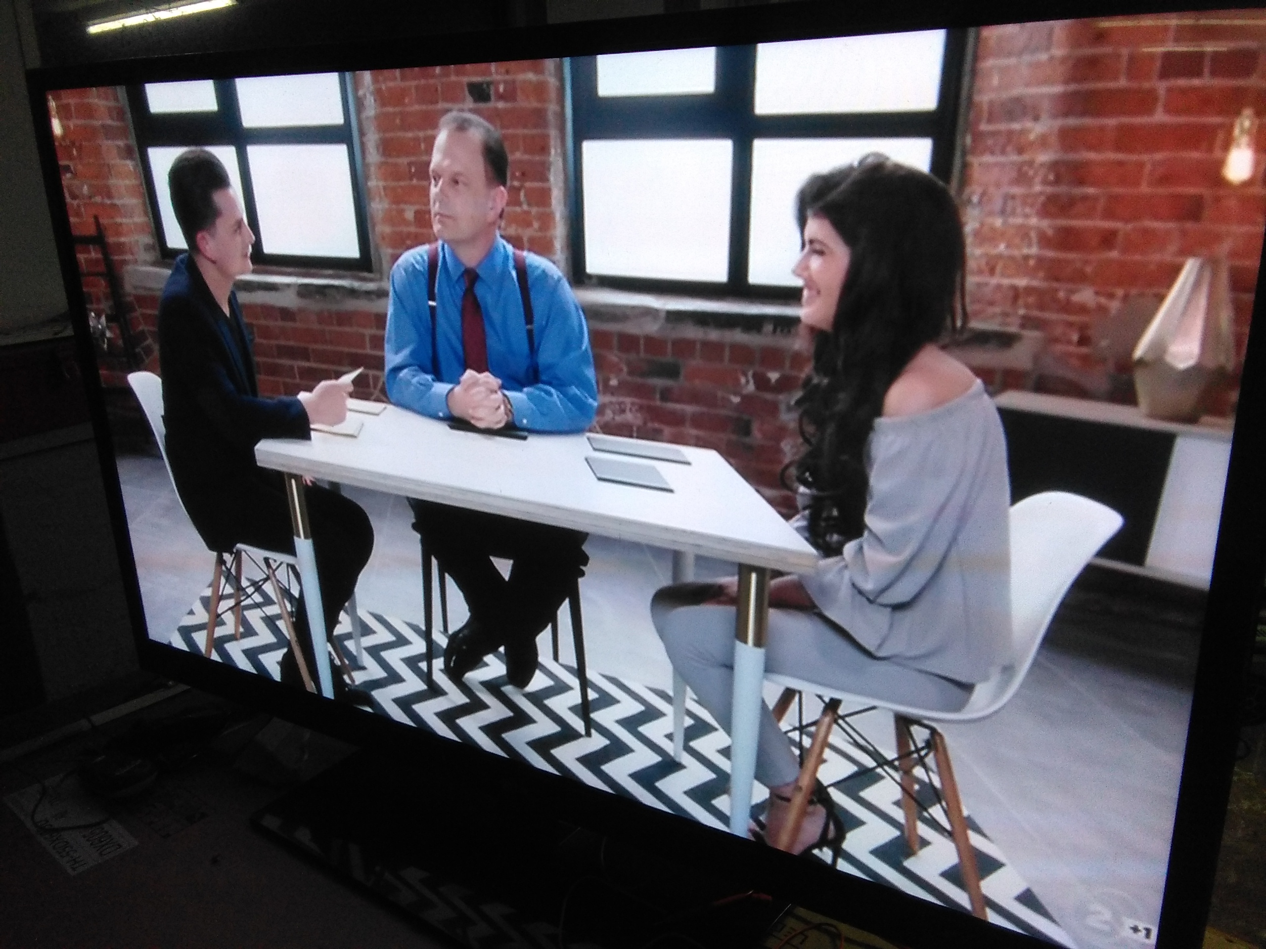

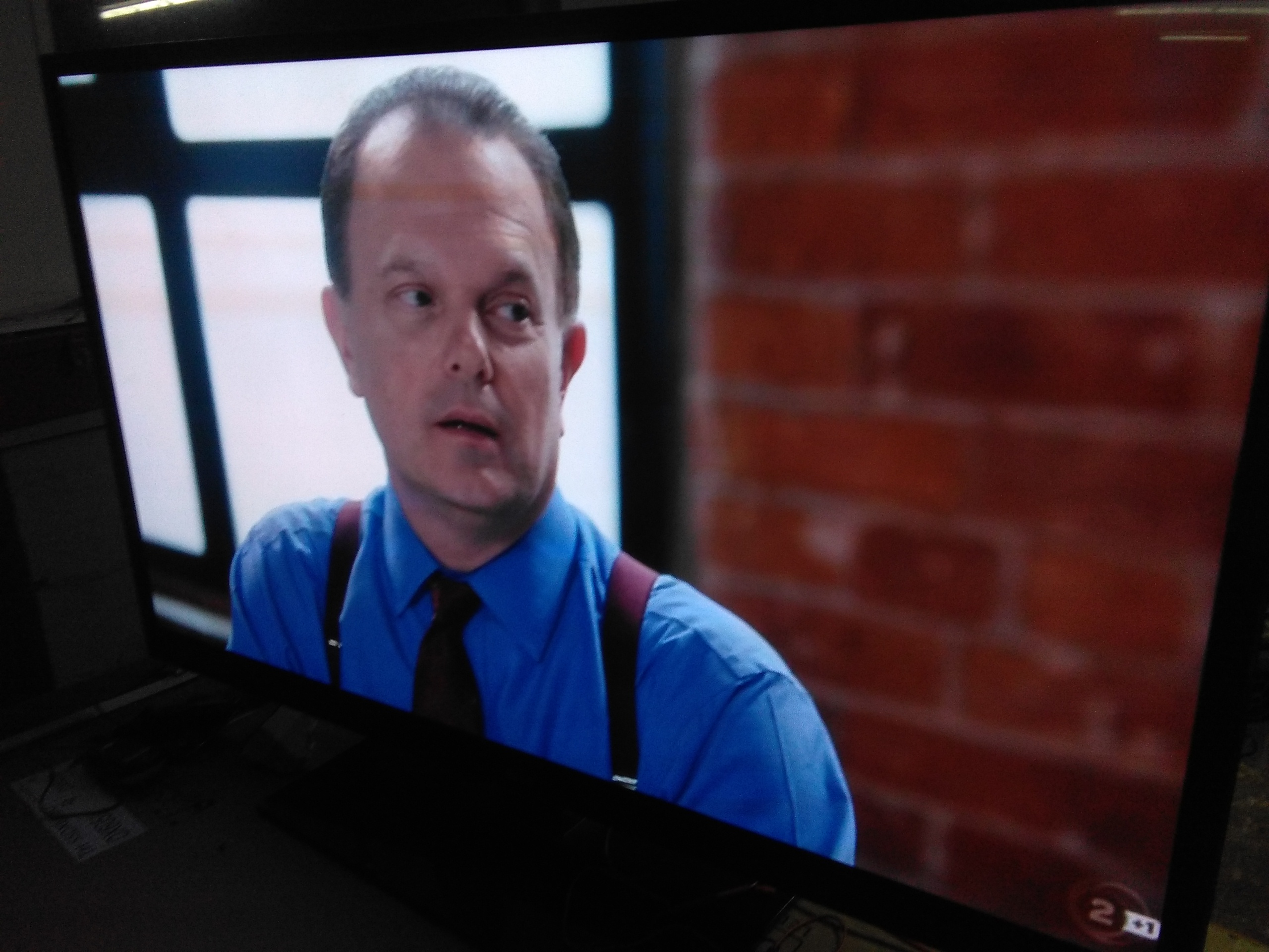

                          Hi everyone, a update on this TV, a final update, and it's good news!
                          I got in touch with the supplier of the board, they sent me another one, free of charge, plugged it in, hand tightened all the screws, and BLAMMO. It looks amazing.
                          Thank you to all those who contributed, I now have my first 1080p tv, at 60 inches, and it looks awesome.
                          I'm going to add some external fans to keep the hot running ysus and zsus cool, apart from that, and the 30 kgs I need to lug up a flight of stairs to get it into my lounge, life is good!!!
                          Attached are some pics of the success.
                          THANK YOU EVERYONE.
