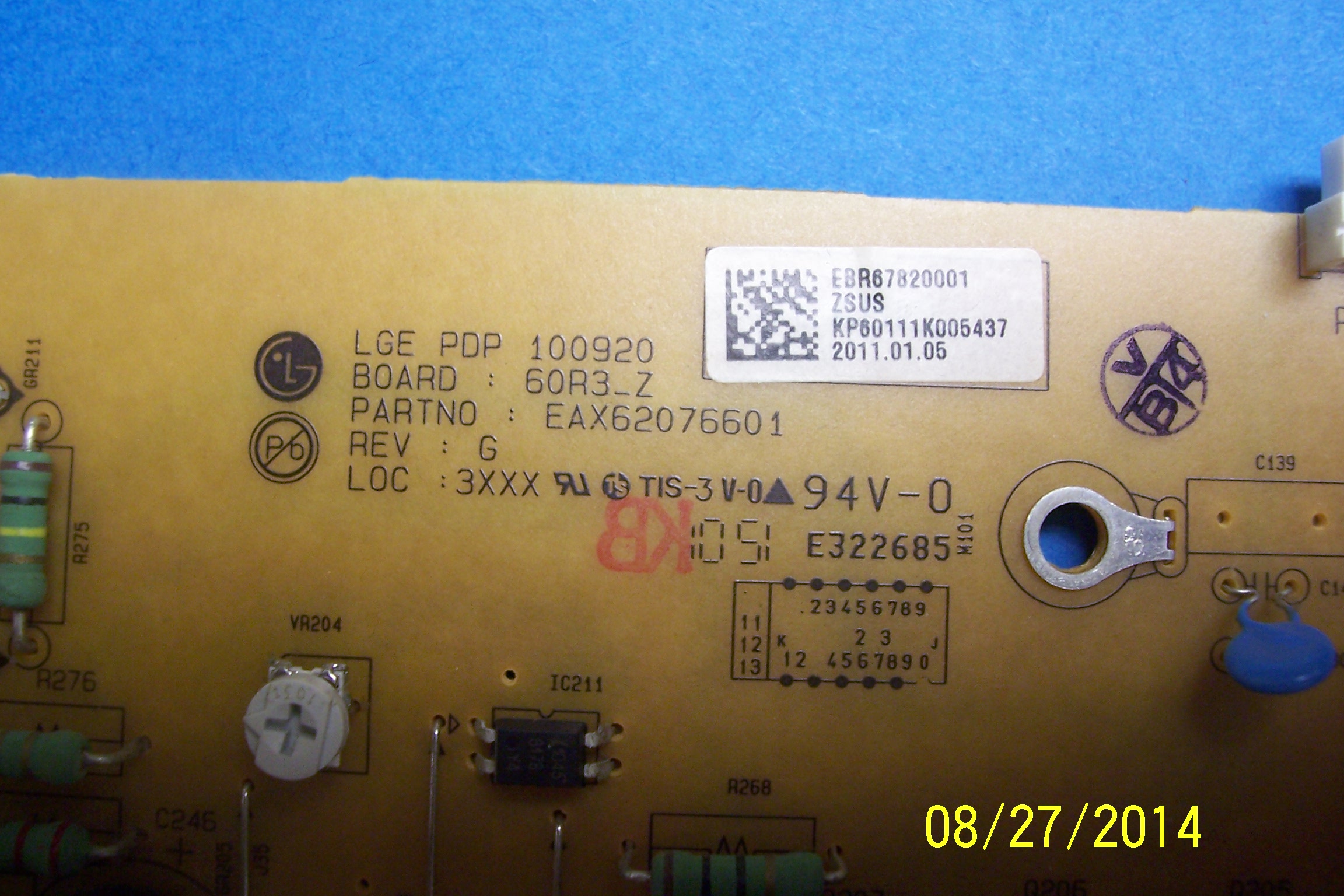

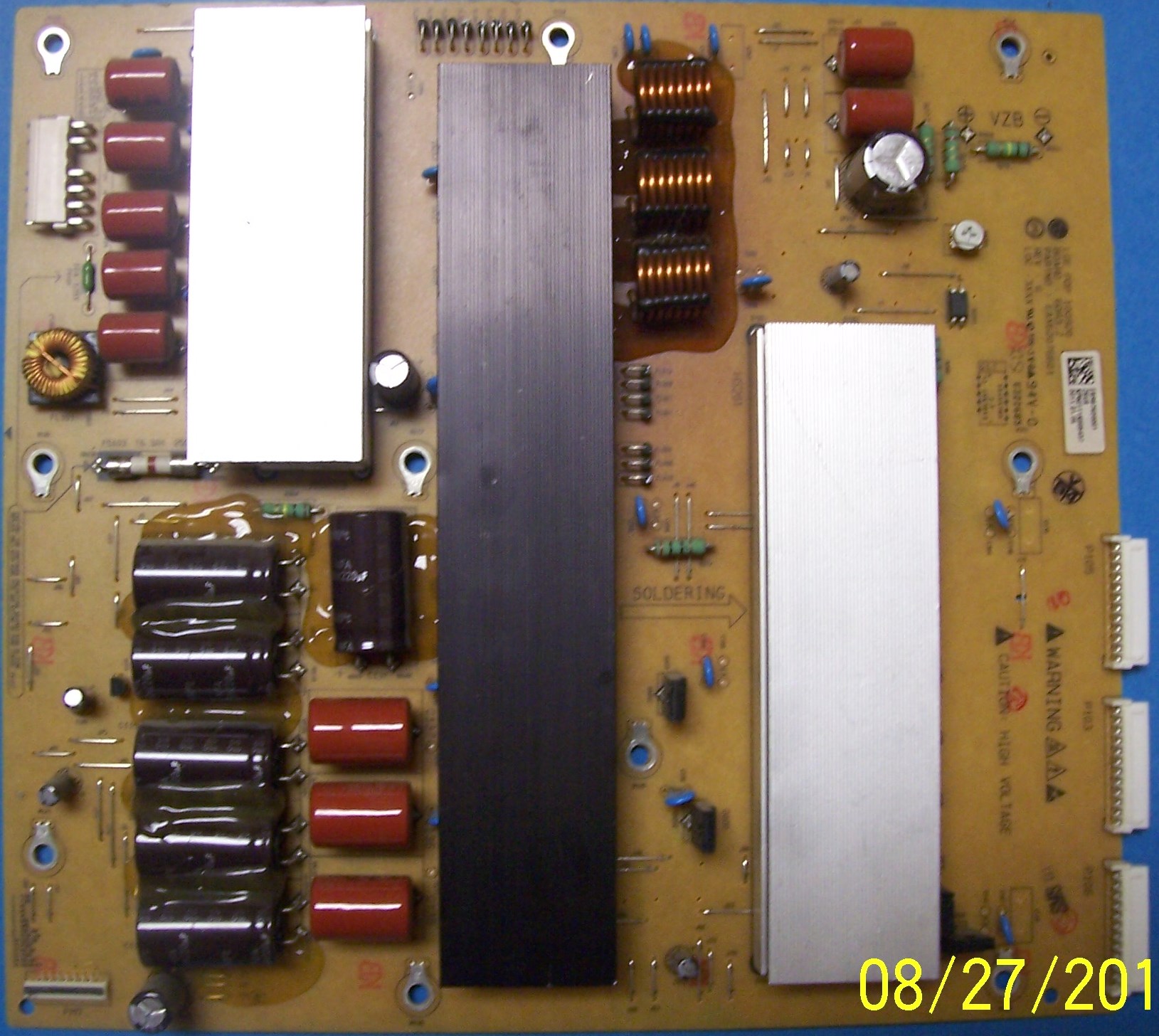

    Hello all,

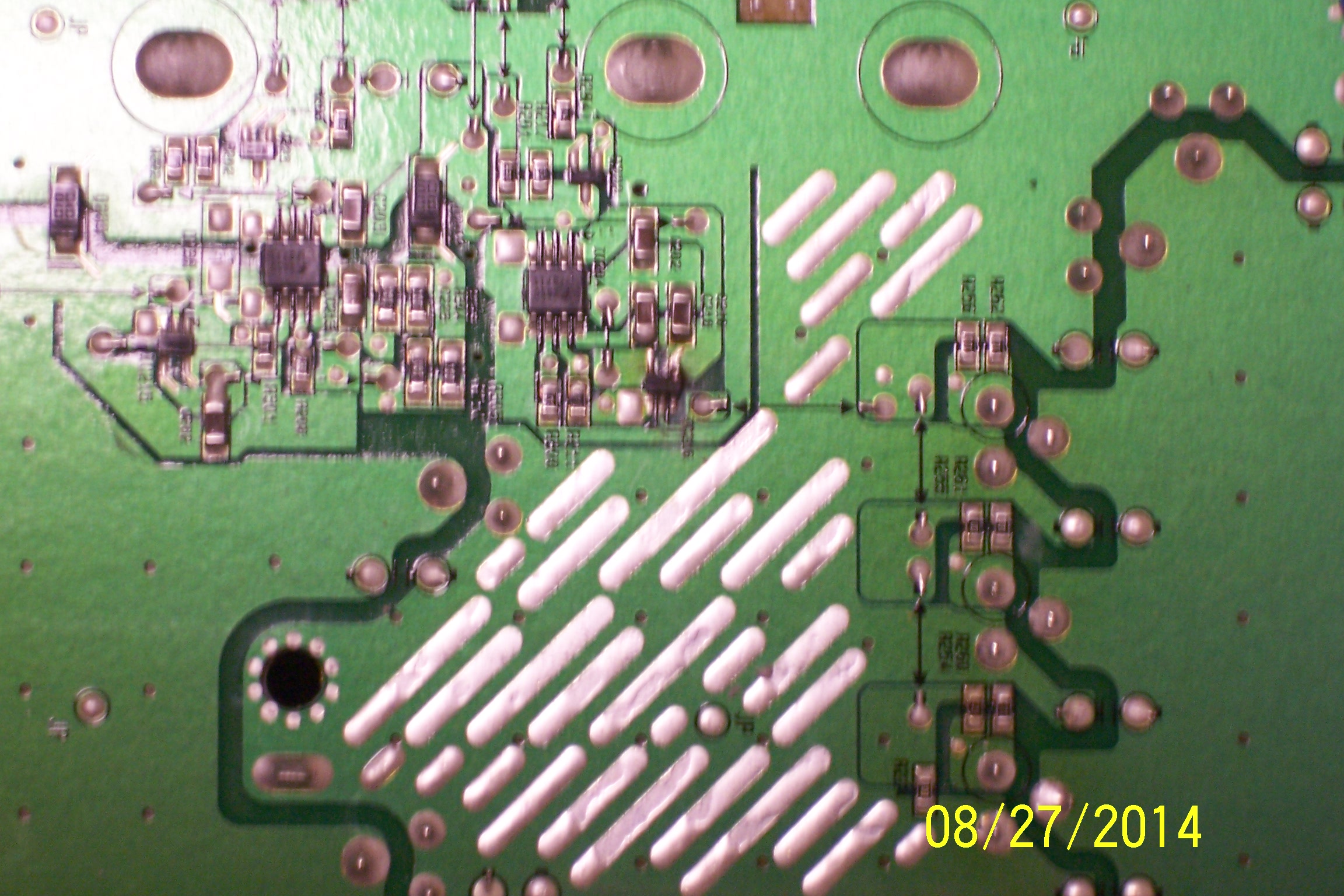

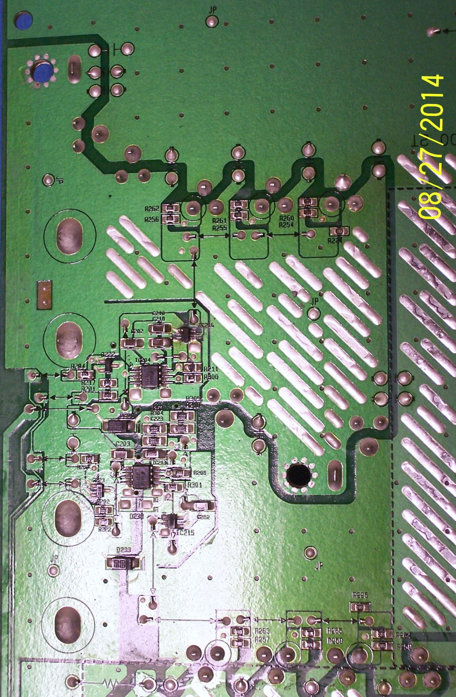

    First post, so I'll ask for patience in advance . TV went out without warning a few days back. Traced down to a burned out IC on the z-sus board (IC216). Can't find any available anywhere, so a couple of questions-
    1-Anyone know where I can find one?
    2-Is it possible to find and replace the IC?
    3-Is there something I should be looking for as the cause of this IC burning out?
    Any help would be greatly appreciated. I've enclosed a few pics, but haven't figured out how to notate them yet

    Have you checked if any of the adjacent MOSFETs/IGBTs are showing as shorted? They could damage the ic (it will be a gate driver)

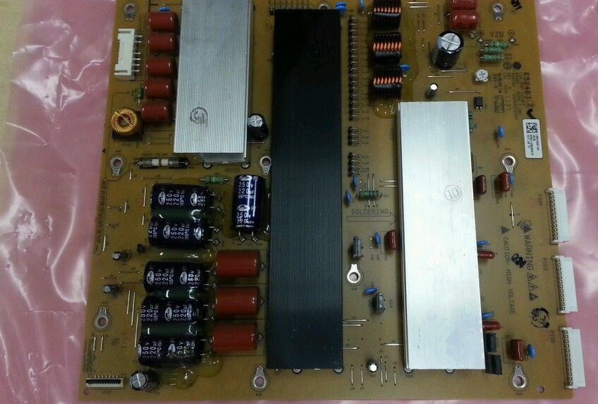

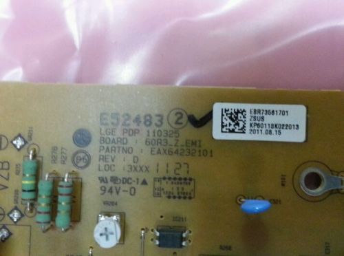

      Is it possible to test the MOSFETs/IGBTs in circuit since there's a short on the board? Or would I have to take them off to accurately test them? Also while searching for the EAX66076601 board, came across the EAX64232101 board from a Zenith Z60PV220 that looks identical. Can these boards be subbed?
        Re: LG 60PV450 Z-SUS unavailable...sustitution?
        Well--since LG has owned Zenith for some time--VERY likely a Z-sus from a zenith would be the same.
          ^^Yes, if LG rebadged this set as a Zenith, which they did for some models. As did Sanyo (prior to becoming a division of Panasonic.)
          The MOSFET/IGBTs have 3 pins and are primarily mounted on the heatsinks. Check all three combinations of pins (1-2, 2-3 and 3-1) for shorts using a multimeter on diode mode. (Board must be removed and not powered up.) Note if you find any low readings (<200 in diode mode) if you do the component needs to be removed and tested out of circuit.

            A lot of sets have mosfets in parallel. All will show bad if one shorts out. If parts are cheap enough and it's your tv I would replace all three or four.

              Thanks guys for the responses. Ordered a z-sus board, waiting for it to arrive...will check back with results

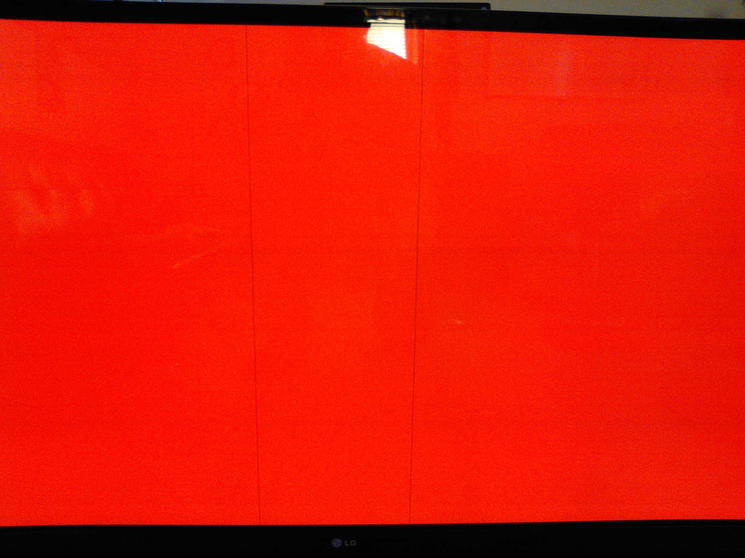

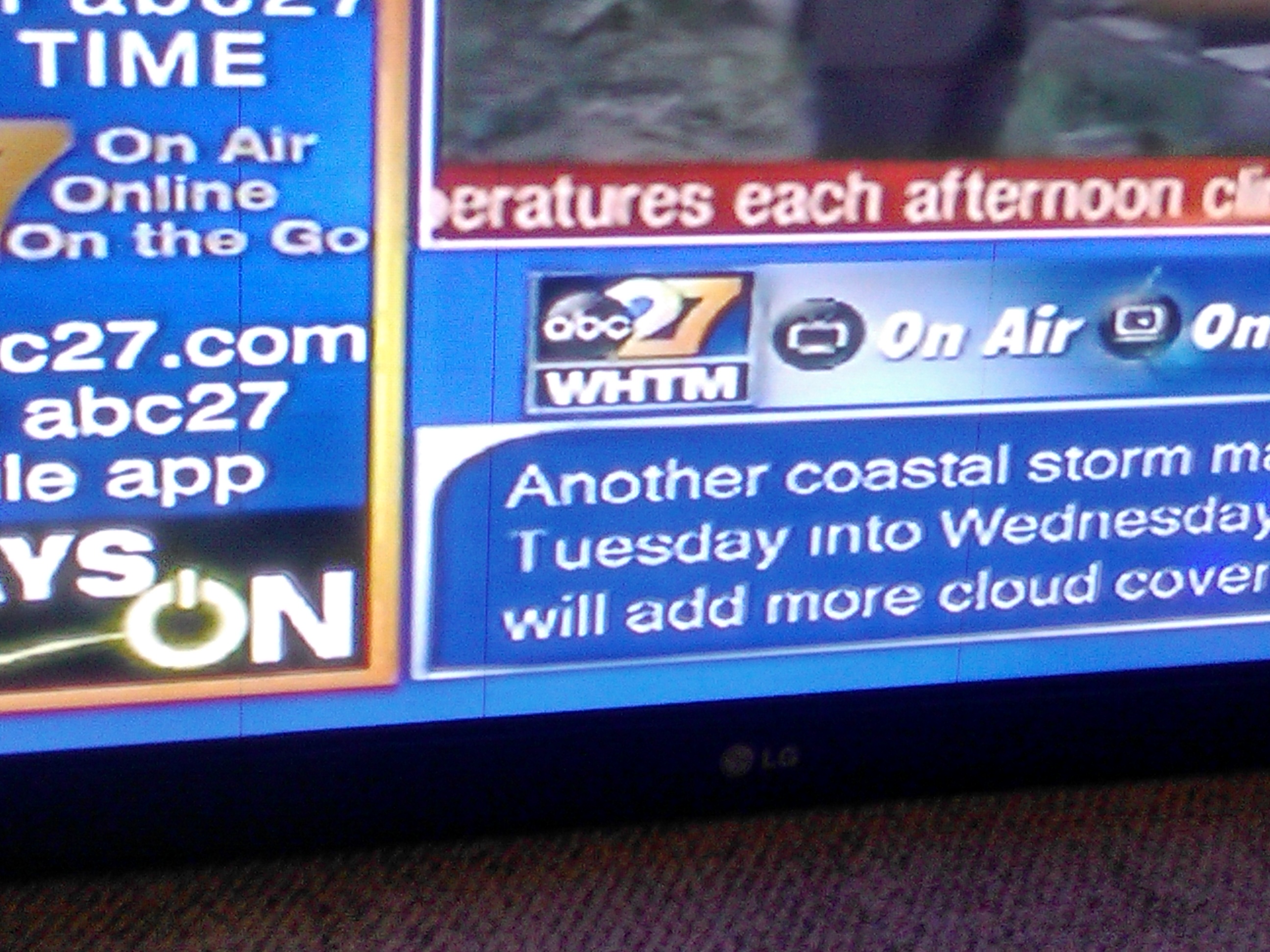

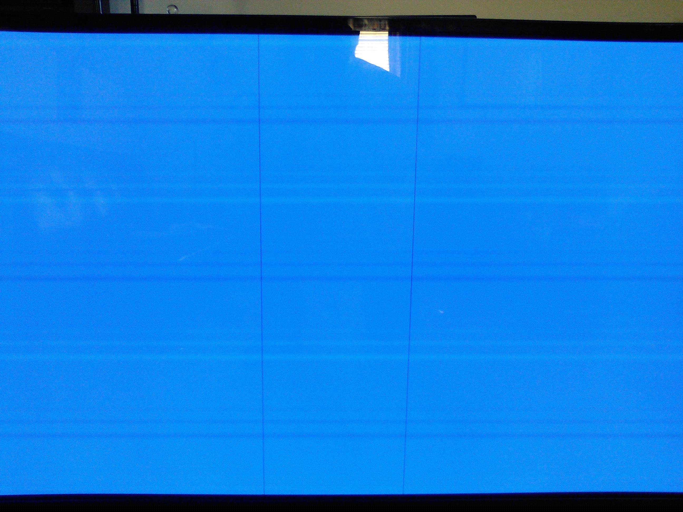

                      Finally found and received new z-sus board. It's actually the Zenith I saw earlier. Installed it and at first had a green "solarized" effect. After checking here, I found a post that talked about the ribbon cables maybe causing this-Spot on, rechecked cables and !!!, I could see my screen again! Checked voltages, everything was within .1-.2 volts. Thanks guys, Y'all gave me the gumption to try this! But and it seems there's always a but, I have a new, hopefully small problem. 2 vertical green lines on screen. They look to be not more than a pixel or two wide, however they are there, except where the screen is white. Pic will hopefully show what I mean
                        Just took a closer look a the pics I took...the first shows 3 lines, but the 1 on the left has disappeared, leaving just the 2 in pics 2 & 3 taken during the test screen
