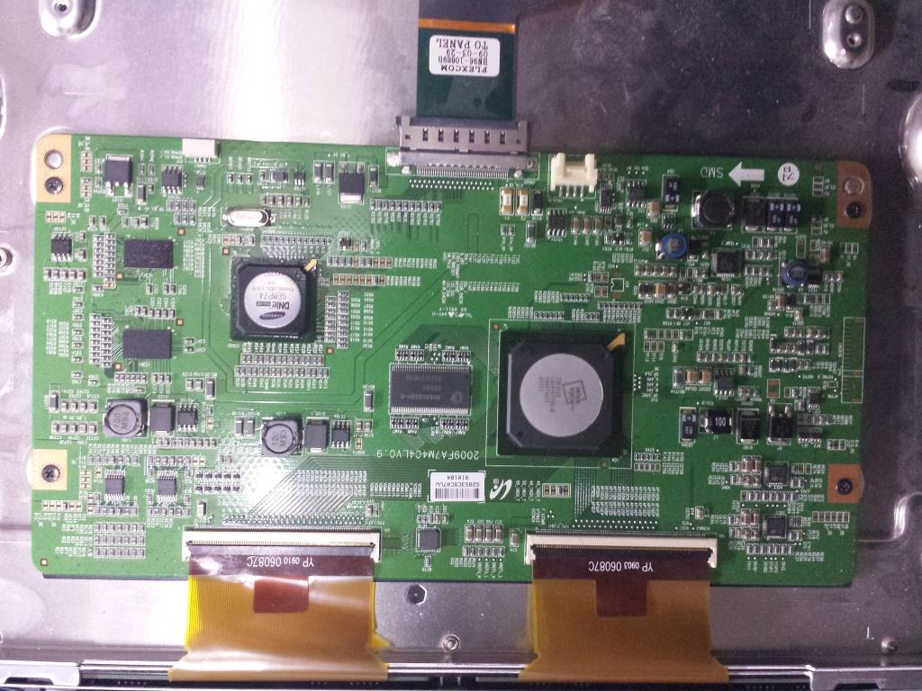

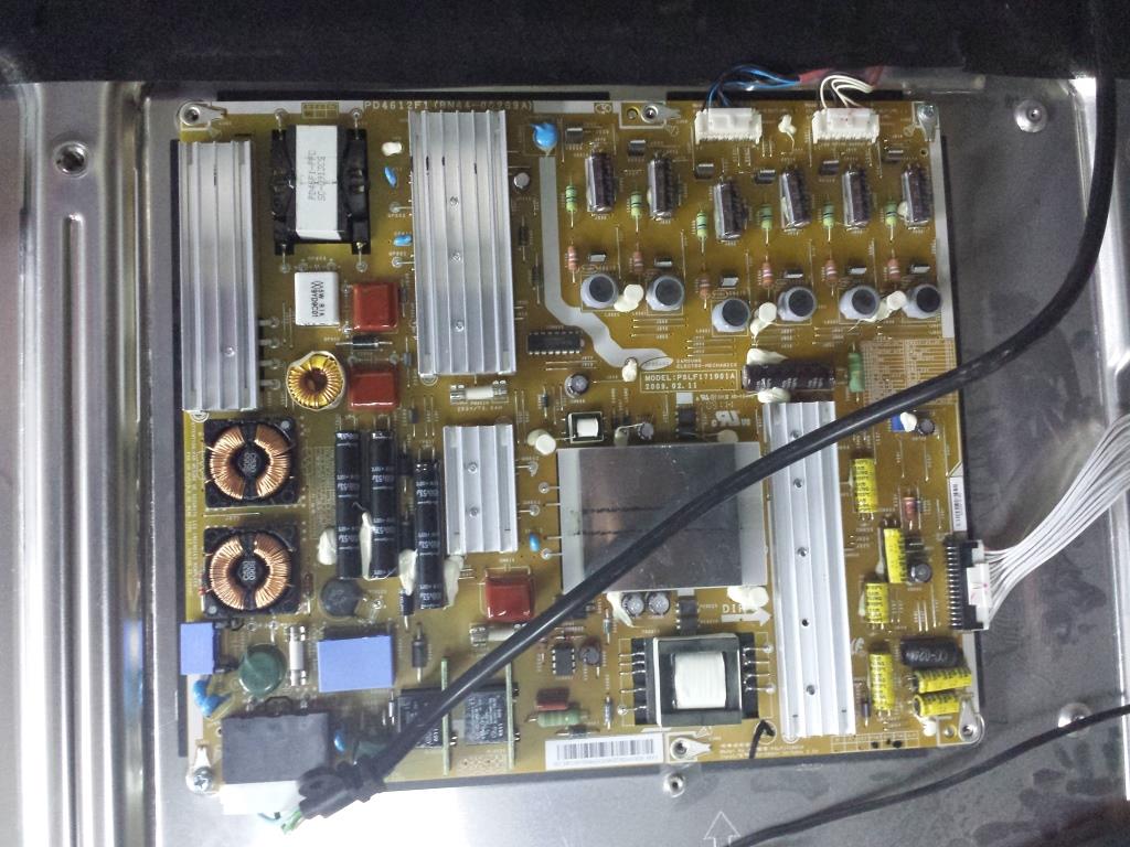

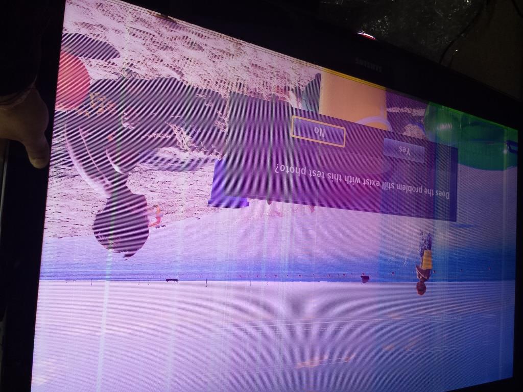

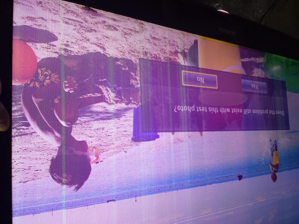

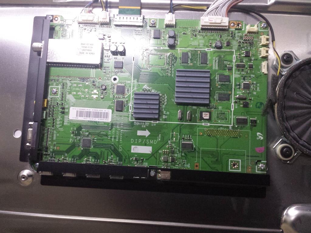

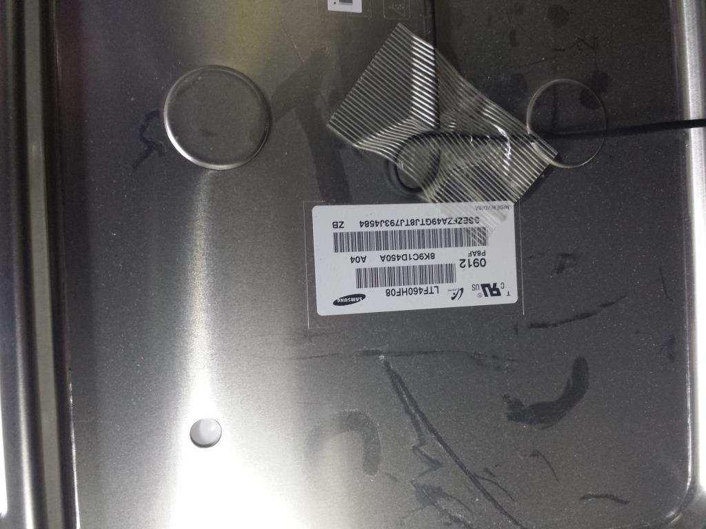

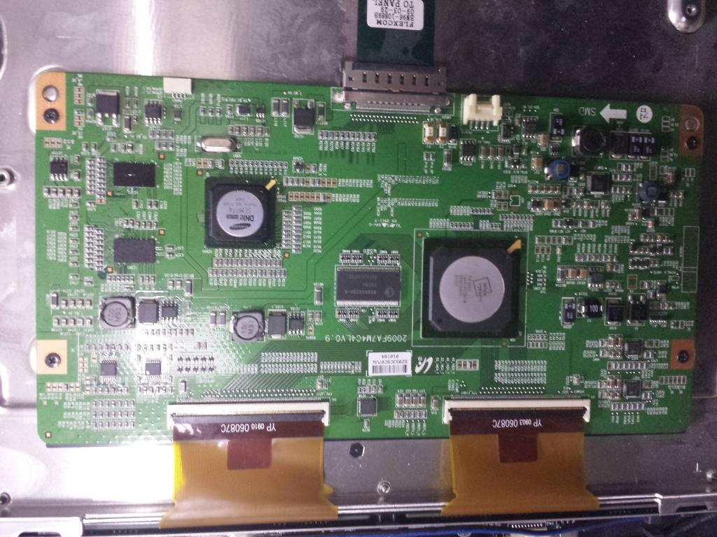

    Hi there,
    I am working on 46" Samsung smart TV. The TV is having Horizontal line all over the screen and shows weird colors as well. The color issue gets worse after 2 minutes turning the TV on. I have checked the voltages at the power-supply all looks normal. No visual damage. The voltages at the T-Con voltage regulaters looks normal as well.. any suggestions. photos attached.

    Re: Samsung 46" Horizontal lines.
    I'm quite sure this is a bad panel, simply search the T-con board number on here or through Google and that will give you your confirmation(I have had the same problem).
      Thanks Dang for quick reply. Which one is the T-con board number. Is it the one on the sticker or on the board.
        Simply search in Google: 2009fa7m4c4lv0.9 repair, you'll likely get your answers, the first two main responses are from this very forum.
