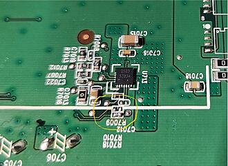

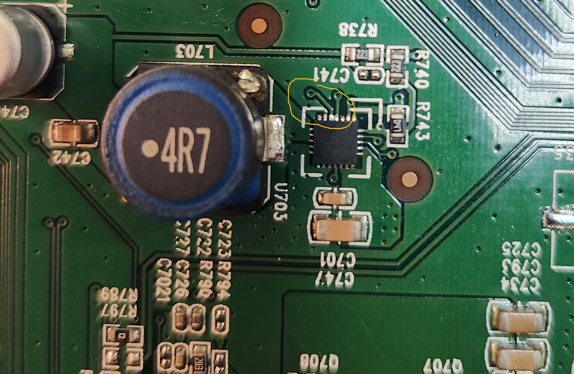

    This is a better image of the component in question Click image for larger version

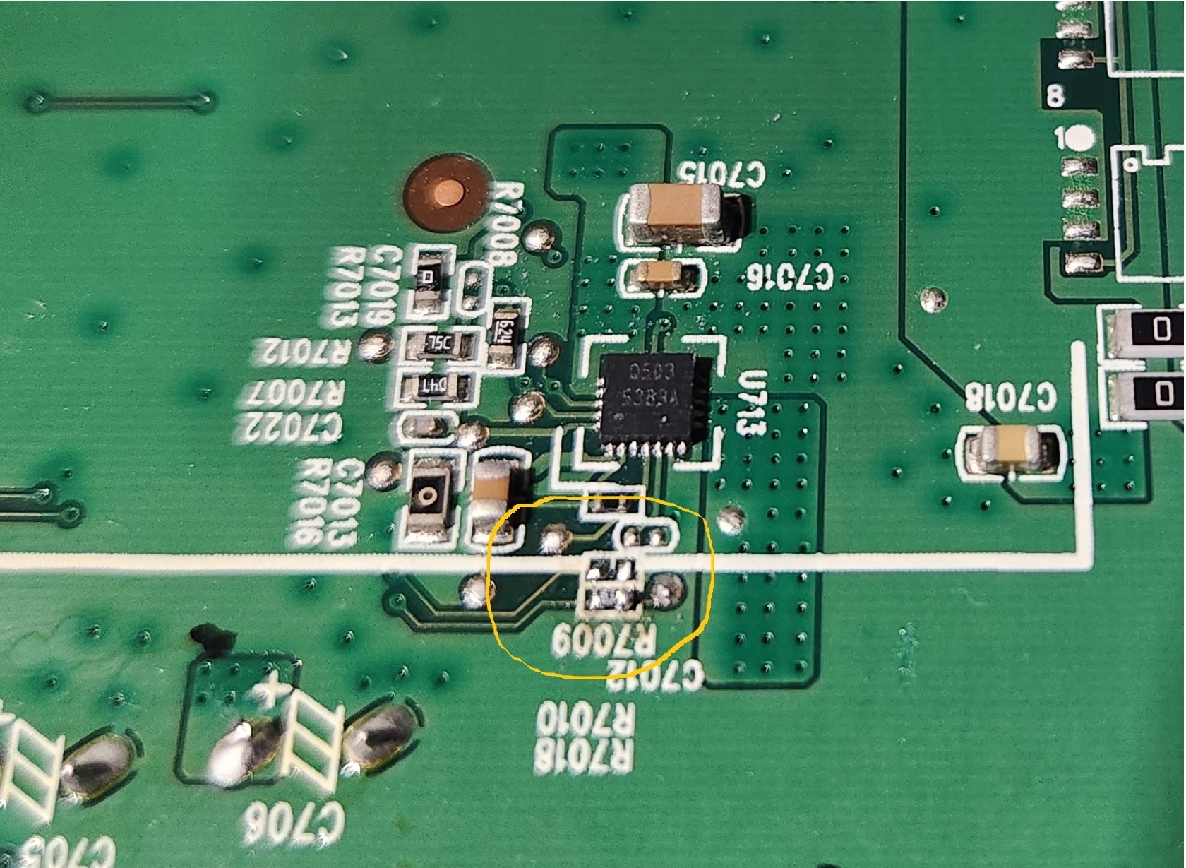

      I was able to revive the main board by removing the huge heat sink and reflow the 2 CPUs. Now the On/OFF signal to power supply is at 3.3V when the power button is pressed. The backlights are turning on but no image on the screen. I figured out the there is no 12V on either side of the FUSE on the T-Con board. This voltage comes from the main board. No shorts on the main board for 12 V but it looks like the voltage is generated by this IC U713 on the back side Click image for larger version
ID:	3708772 (Q503 5383A are the markings on the IC). The output of this IC, is exactly where the Ref. Des. U703 is located in the image and is directly connected to the 12V going to the T-Con board. Can't find the spec sheet.
      Did anybody ever find this issue? Also I suspect that the location circled in green still has a missing component.
      Thank you again for your help.
      Massimo

        Hi all again.

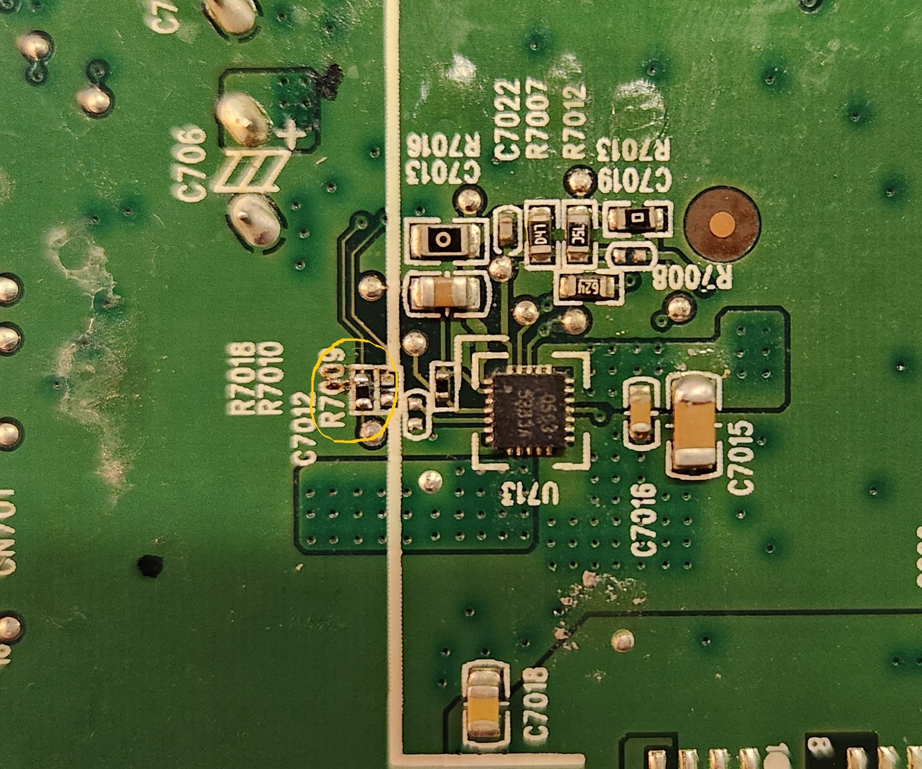

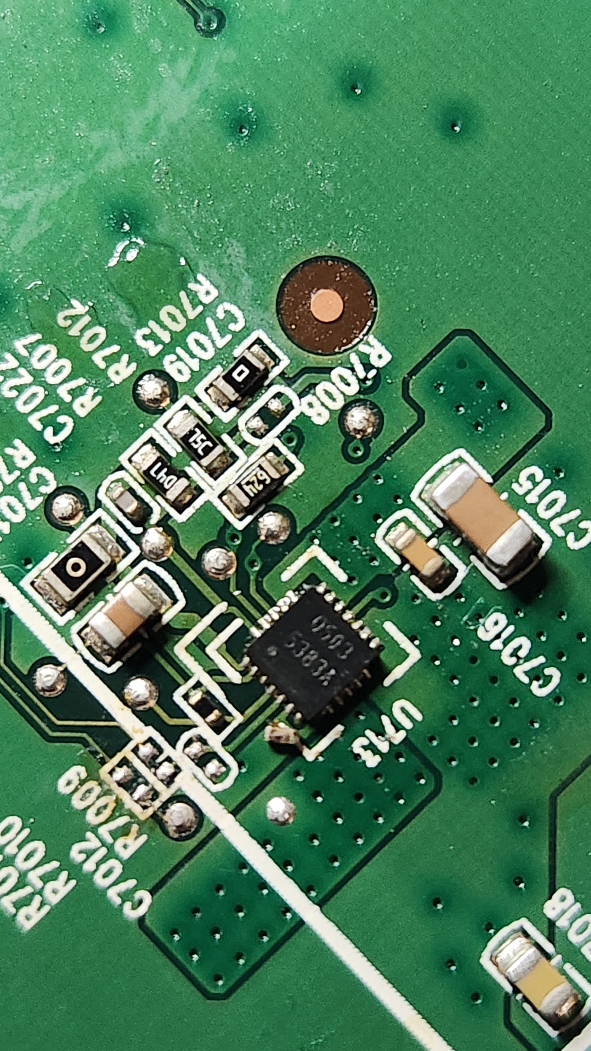

        I was able to generate the 12V for the T-Con on the main board. I was able to find a datasheet for the mysterious IC listed above 5358A.The actual part is G5358A ( High Efficiency 4A Synchronous Buck Converter )
        made by some company in Asia. See attached datasheet​.( ) It appears that on the main board there is the same regulator producing 5V.(input is 19V from PS) According to the datasheet, there is EN pin (#5)Click image for larger version
ID:	3710161. This pin is connected to the CPU by one resistor (16.5K) on the other side of the board. I placed the same resistor on location R7018 Click image for larger version
ID:	3710163 This connection enabled the 12V regulator that feeds the T-CON. The 12V regulator, using the same 19V from PS, is configured differently to produce the 12V. After that the TV turned ON and the Vizio logo showed up on the screen among the NO SIGNAL post on it. I did not have the time to put everything back together but I need to find a way to mount a fan on the back cover to cool off the huge heat sink.
