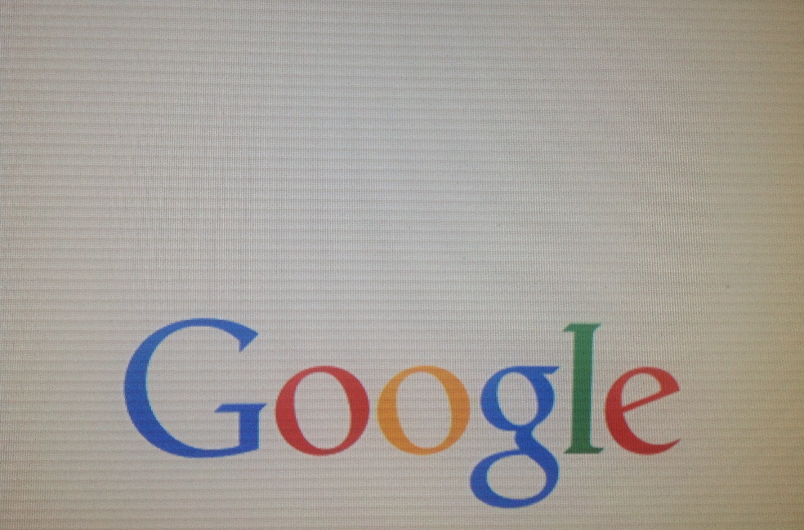

    M470NV Vizio Consistently Spaced Horizontal Lines
    I haven't been able to find the same issue as I am reporting on the forum. I am attaching an image of what the problem looks like. The lines appeared recently a couple of days after moving the tv to a new location. The tv was working perfectly then one morning the lines appeared. I'm thinking something got bumped loose - maybe a ribbon cable from what Ive been reading. The lines go a little thicker then back to their normal size on the lefthand side of the screen producing a very subtle dimming/brightening effect.I have tried replacing the power cable and checking the border of the tv by squeezing around it but the problem remains. If anybody has seen this issue, I'd greatly appreciate any ideas or insights.
    Thank you for your time

    Re: M470NV Vizio Consistently Spaced Horizontal Lines
    There could be some bad capacitors in one of the power supplies, If the cap. is bad it is not filtering the power supplies ripple and this could show up as lines in the video.
