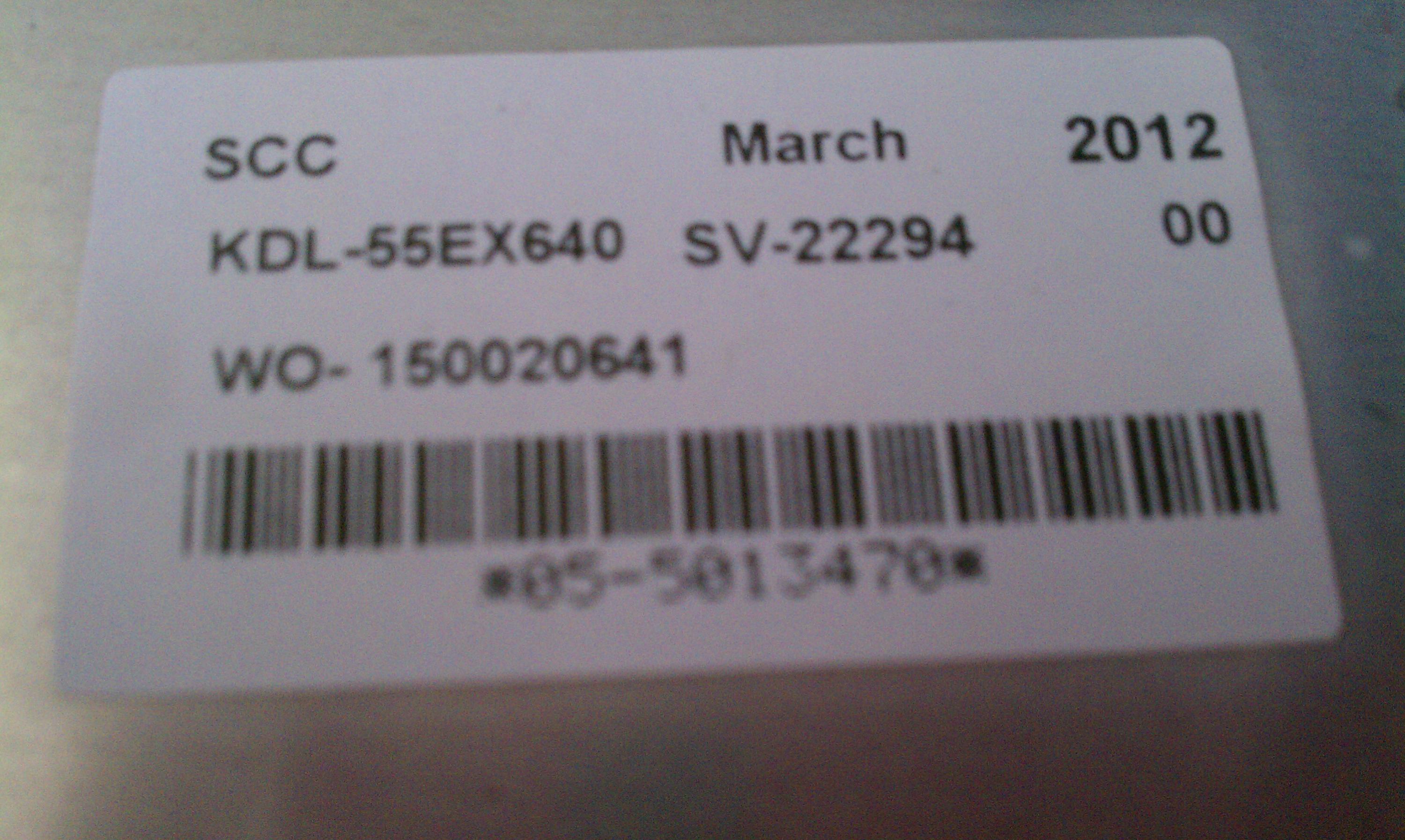

      Re: Sony Bravia 55 KDL-55EX640 no backlight / flashes once
      ok but i have 14 led strips. they are made to fit together so i guess i actually have 7 full LED strips. but there are only 4 LED- and 4 LED+ pins on the connector. seemingly i can only power 4 LED strips...but why did the guy send me 7??
      im afriad there might be something else going on behind the panel and just plugging one LED strip per +/- might not be a good idea?

                  How many wire harnesses go into the panel? Or how many connectors are on the board?
                  • triplefour
                    • May 2014
                    • 1747
                    #69
                    2 connectors on the board, 4 wires in them each. one connector is for the - and one is for the +
                    so there are 8 wires total going into the panel...i think i took a picture of it in an earlier post

                        hmm i just read this in the service manual and its kinda freaking me out:
                        "Bright picture & thin design with Edge LED backlight"
                        what is EDGE LED Backlight??
                        is that where they are 2 strips on either edge of the screen?
                        cuz if thats the case...the strips this guy sold me are TOTALLY bogus

                            Backlit LED use those LED strips that you just bought them used, edge lit the skinny LED strip are on the edge of the screen same kind of setup as used in many LCD monitor that uses CCFL or LEDs.
