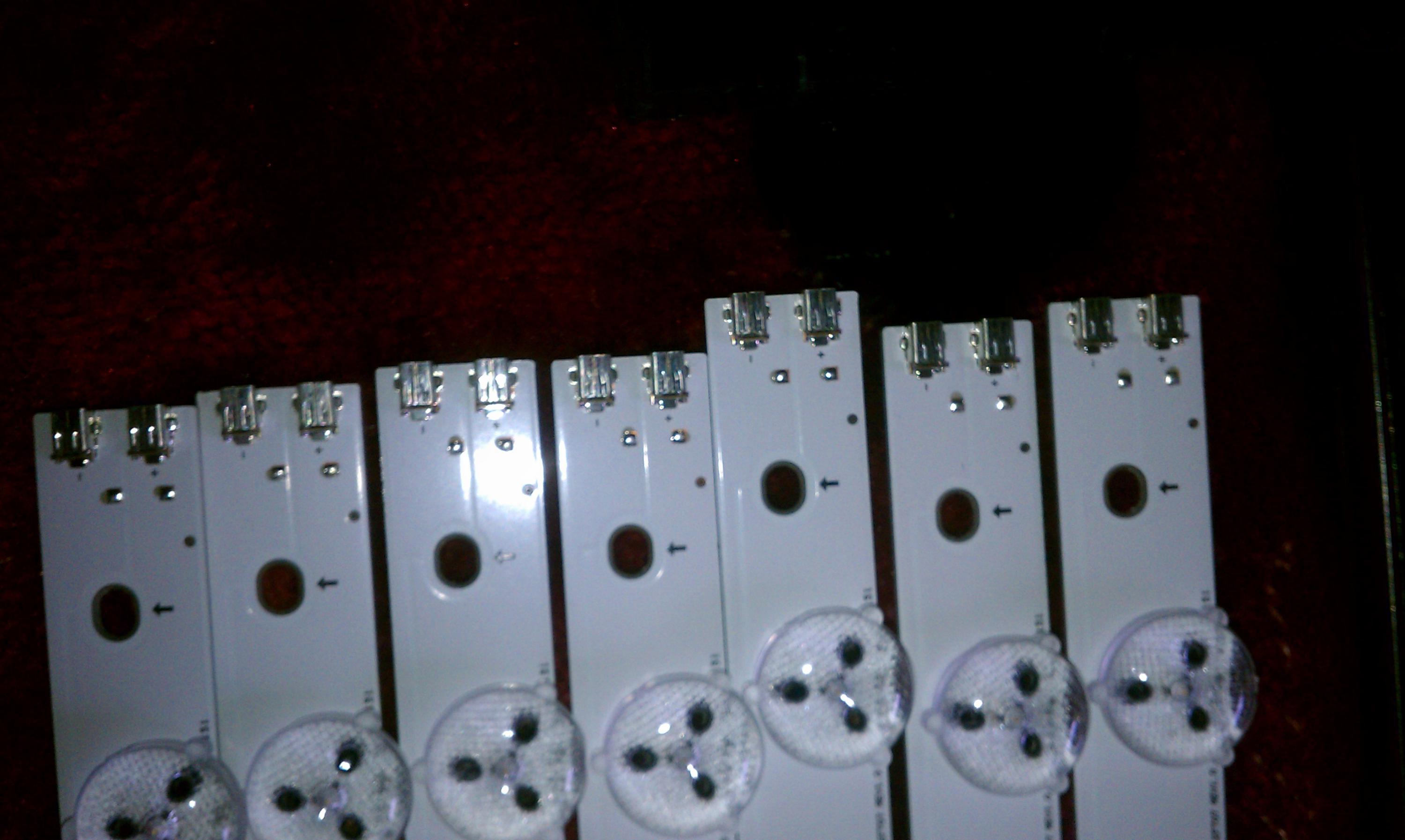

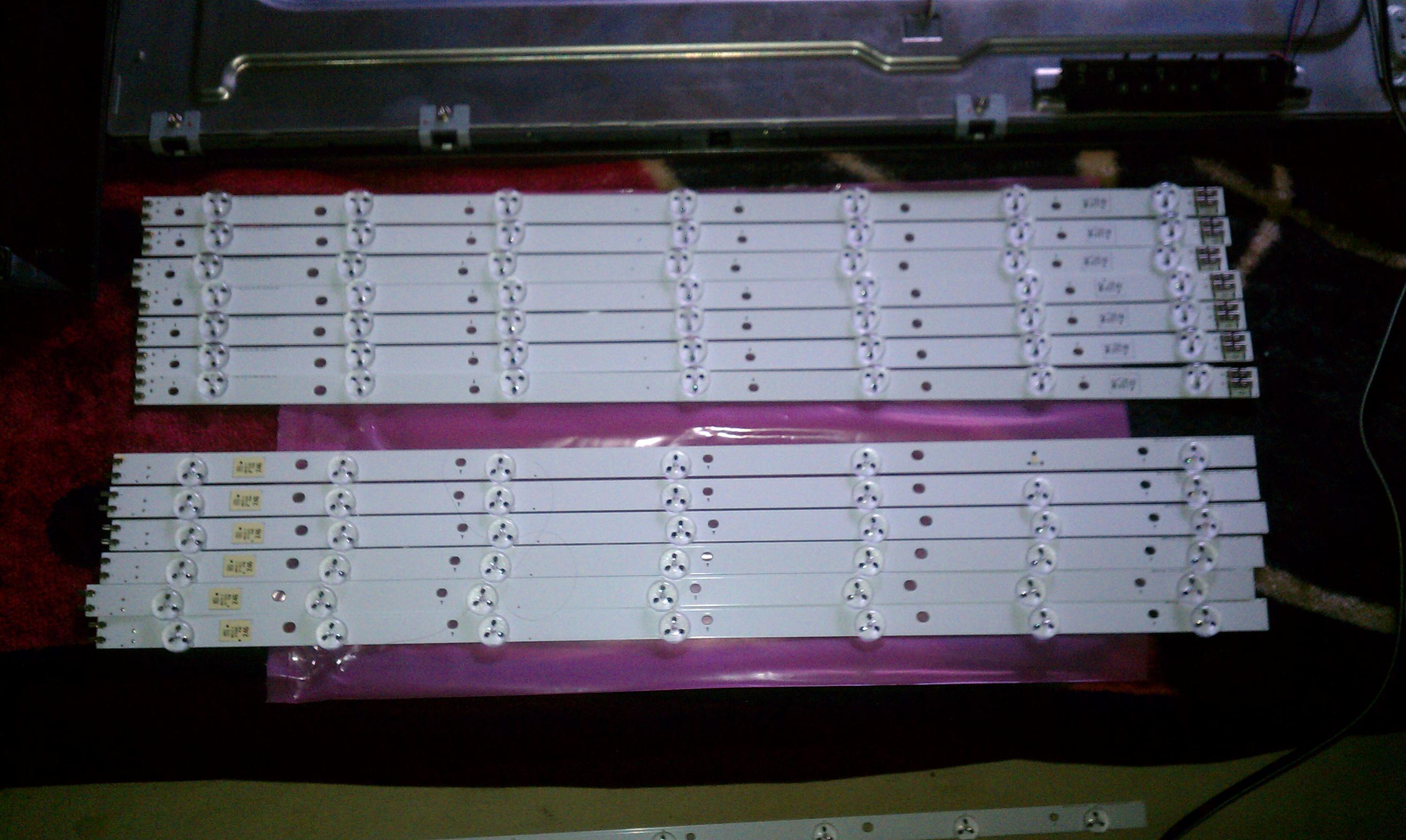

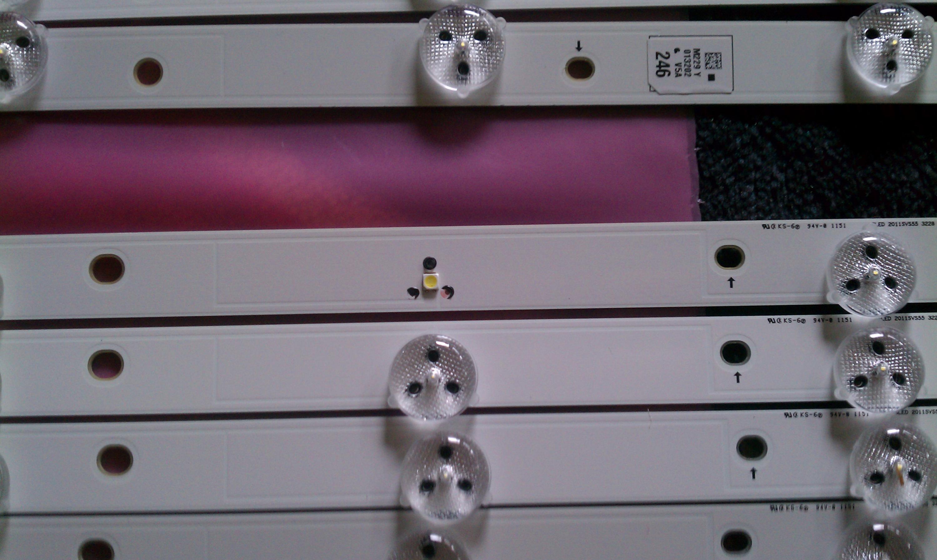

                                        #59
                                        Re: Sony Bravia 55 KDL-55EX640 no backlight / flashes once
                                        well i went ahead and bought some LED strips from the other guy on ebay "patch1stripe" who actually was nice enough to tell me there were 7 on each strip.
                                        however, he listed the item as NEW
                                        and when i finally got it, i notice one of the strips is missing an LED!
                                        i already sent him a message about it. because obviously they are not NEW!
                                        the other troubling thing is that while i thought we had decided that i should only have 4 LED strips in this panel,
                                        he sent me pairs enough to make 7 strips!
                                        without having opened the panel i have no idea now how many strips there actually are in there but 7 cant be right, can it?
                                        oh and also, i was hoping they would come with the wiring so i could just plug them directly into the power supply without opening the panel, but they are just the strips!
                                        is there a way i can hook these up externally to test my internal LED strips?
                                        and howabout trying to make a dummy load with some resistors based on what we now know about these LED strips?
                                        please help!
