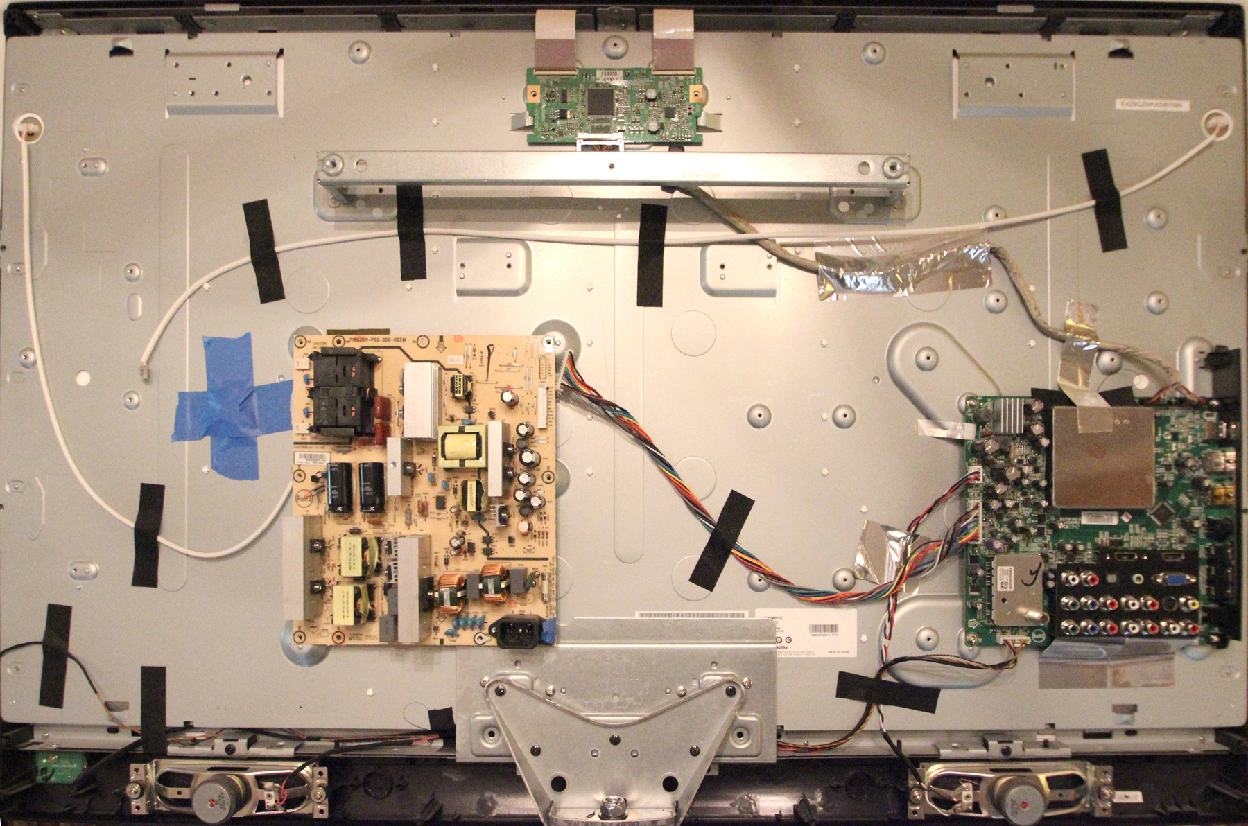

    Insignia - Model NS-L42Q-10A. Was close to a lightning hit the other night. Blew out an old Emerson flat screen and old Dell computer.

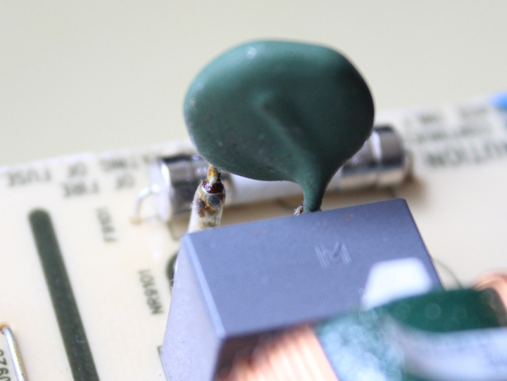

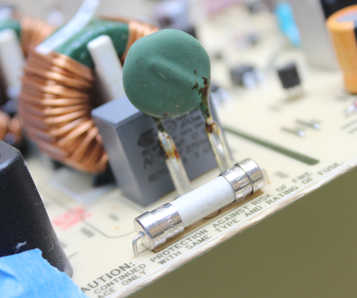

    Opened this Insignia up and saw no major burn marks. White fuse shows continuity. Did see the burnt fuse (photo attached) so figure it is shot. No markings on it but board shows NR9101.
    Should I try and replace it, and if so where can these be purchased?
    TV less than 5 years old so hoping I can salvage. Any ideas? Thanks.

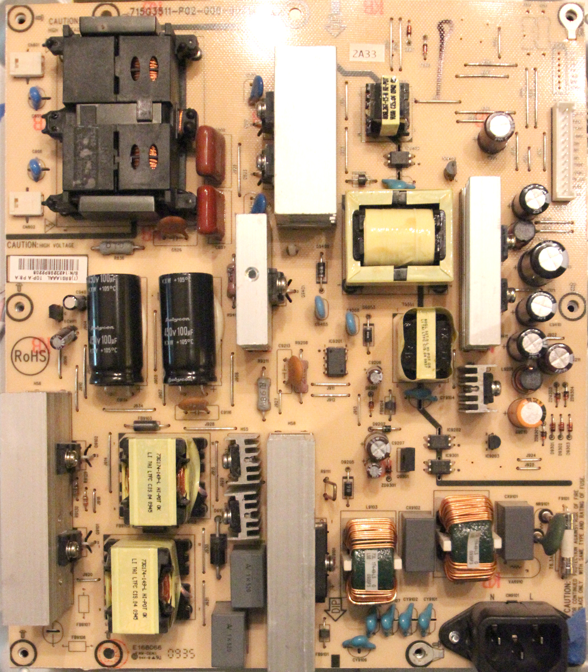

      Check the DC Voltage RIGHT AT THE TWO LEGS of the main filter caps (100uf 450V) laying on the side.

            You must be real careful since you will be working in the HOT deadly side of the circuit, if you are not sure, then do not try. Set the meter to 250Vdc, then use the two probes of your meter, red to the positive leg, black to the negative leg (the stripe on the body of the cap is negative), just do not let the probes slip and do not touch any part of the board with your body.
            That white fuse show less than 1 Ohm, right? No need to turn on the TV, the voltage on the cap should be about 165~170VDC.

              Found a power supply on Ebay for $20. Replaced, but no different results. Bad replacement power supply?....or different problem. Nothing but a small red light at bottom right of TV.
