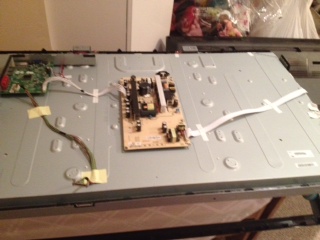

    Hi Everyone, I am also having issues with my 50 in LCD TV, it is model # NS-50L240A13. The tv is just over 1 ½ yrs old, which of course is just outside the warranty. The TV just suddenly went black but I could still hear the sound. When I hit menu, I don't see anything. When it comes on it is just a dark glow, I can see light on inside. Any ideas what it could be and is it possible to fix on your own? I do not have any tools to check voltage. Would just try replacing the whole board? Research has me thinking on TCON Board, does that sound right and is it easy to fix and where it on this TV. Thank Tou

    This TV uses the LCD panel with integrated T-CON, you can only check on the main board to see if it does send either 5V or 12VDC to the panel or not. You may have to get the LCD panel model number to get the pinout of the LVDS connector.

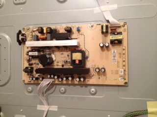

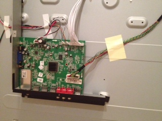

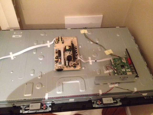

      Thanks for taking time to respond! I have no skill set with this stuff so sorry for the questions. What is the T-CON integrated with and where is it located? In my picture, I only see a Power Supply panel and Main Panel. Is that correct? Is the LVDS connector the wire going up the TV with yellow tape? What does checking if it is 5V or 12VDC mean? Will I need a special tool or do I just read it? Is there a special way to remove the LVDS connector?
      I was hoping to just unhook a panel and replace it with $50 panel instead of taking to get fixed. It sounds like it may be to complicated.
        Re: Insignia NS-50L240A13 - No Picture but sound
        The T-CON board for this panel is inside the LCD panel assembly. Some panel may need 5VDC, some may need 12VDC to run, we do noy know until we get the spec sheet of the LCD panel model numbers. If you need new panel, then forget about fixing it.
        "Is the LVDS connector the wire going up the TV with yellow tape?" Yes. Pin 1 of that white LVDS connector X501 is more likely to be the one that supplies 5 or 12V to the panel.
