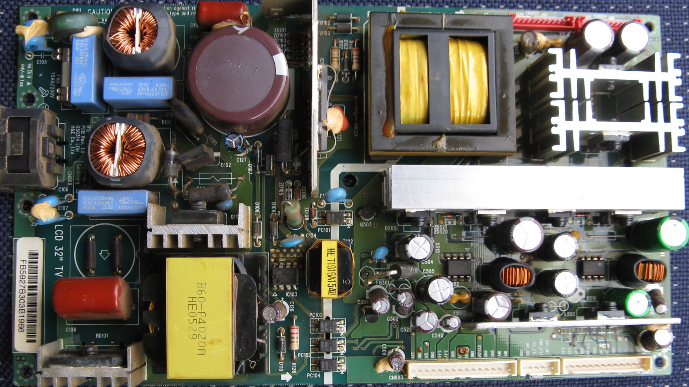

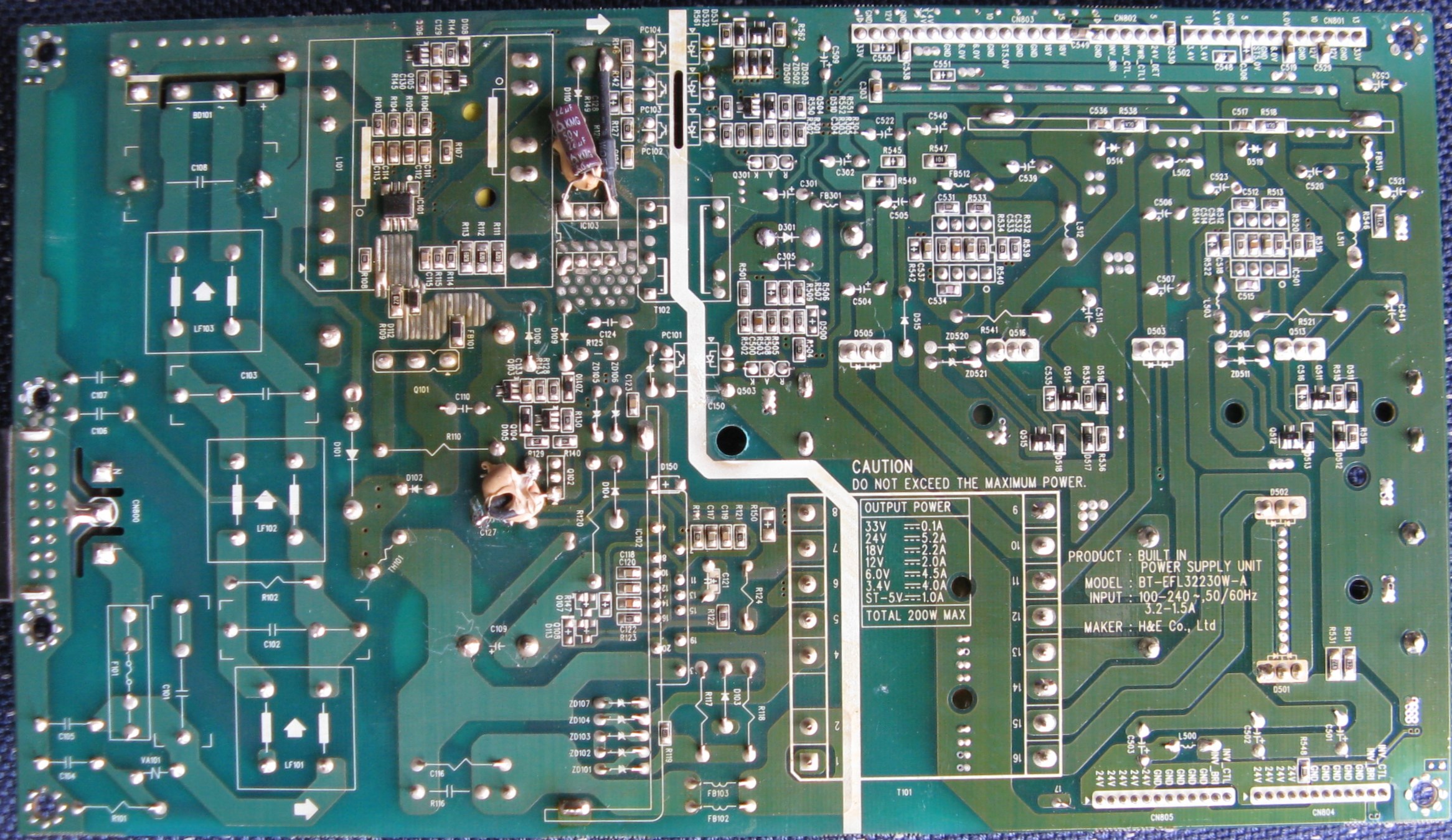

                        Failing that if you post good clear pictures front and back of your boards ( clear enough to read the numbers on the board) we may be able to help.
                        Post them using manage attachments jpgs up to 3mb usually work ok.

                          Attached are two pictures of the board (front and back) and one file of the circuit diagram (finally found it). Please note: the board # is 6871TPT303B but the diagram is for 6871TPT303A. However, it is probably close enough.
                          The Viper22A is designated as IC103.
                          Now the status update:
                          1. Resistance readings (each pin to GND) are:
                          pin 1 (Source) 0 ohm
                          pin 2 (Source) 0 ohm
                          pin 3 (FB) 1.2 kohm
                          pin 4 (Vdd) 30 kohm
                          pin 5-8 (Drain) 6 Mohm
                          So it seems to be reasonable.
                          2. Voltage readings on each pin are:
                          pin 1 (Source) 0 V
                          pin 2 (Source) 0 V
                          pin 3 (FB) 0 V
                          pin 4 (Vdd) 11.5 V
                          pin 5-8 (Drain) 345 V
                          More info and more questions:
                          * My board (6871TPT303B) has some modifications done with an additional cap and 2 additional diodes added at the back (you can see them in the picture). They are around pin 4 of IC103 and also around Q102.
                          * I am not sure where the startup capacitor is. Is it C126 or C127 as per circuit diagram? Please indicate the path for startup voltage.
                          * How does Vdd (11.5 V) arrives on pin 4? I thought that it would have come through R150 and D150 (as per diagram) but R150 and D150 do not exist, the path is open there.
                          * In the end still no 5VST.
                          Hope this helps. Would like to hear more from you.
                          BTW Sorry, I am yet to learn how to mark items on the drawing with an arrow or text.

                            Hi Well budm is the circuit man - I will go for the simple stuff In the picture D301 appears to have a leg lifted. This seems to be in the 5v sby circuit so first thing would be to confirm that it has been put back in?
                            Ok Perhaps just change both C 126 and C127 ( already changed -what brand series is that) with good quality low esr capacitors panasonic FR or equivalent.
                            Do you know who did the modifications - check the glue is not conductive
                                Feed to Vdd pin looks to be via R126 and D110 - If you notice on the schematic D150 and R150 have asterisks which suggests a modification but we dont have that information

                                  i think startup cap c127 has leaked.
                                    Re: TV Power Supply Unit
                                    At 11.5V on VDD pin 9the startup cap is charged up through the internal current source, that is below the startup voltage requirement which is around 14.5VDC.
                                    Page 6/20 of the spec sheet I provided: It is good to read the description on how the IC works.

                                    So the startup cap connected to the VDD pin may have leakage resistance or the internal current source inside the IC is bad.
                                      BTW, did you lift up the Anode side of that rectifier Diode next to C301 for the STBY supply for a reason?
                                        Well spotted. The picture was taken just after lifting D301 for checking. It is now back in its place.
                                        Perhaps just change both C126 and C127 (already changed -what brand series is that) with good quality low esr capacitors panasonic FR or equivalent.
                                        It may be a good move to change both caps. C127 has been allraedy replaced. Not sure what brand it is, 105 C rated though.
                                        The modification seems to be "global". I have seen a picture of the same board earlier on this forum. It had those added components on the back as well.
