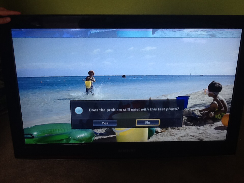

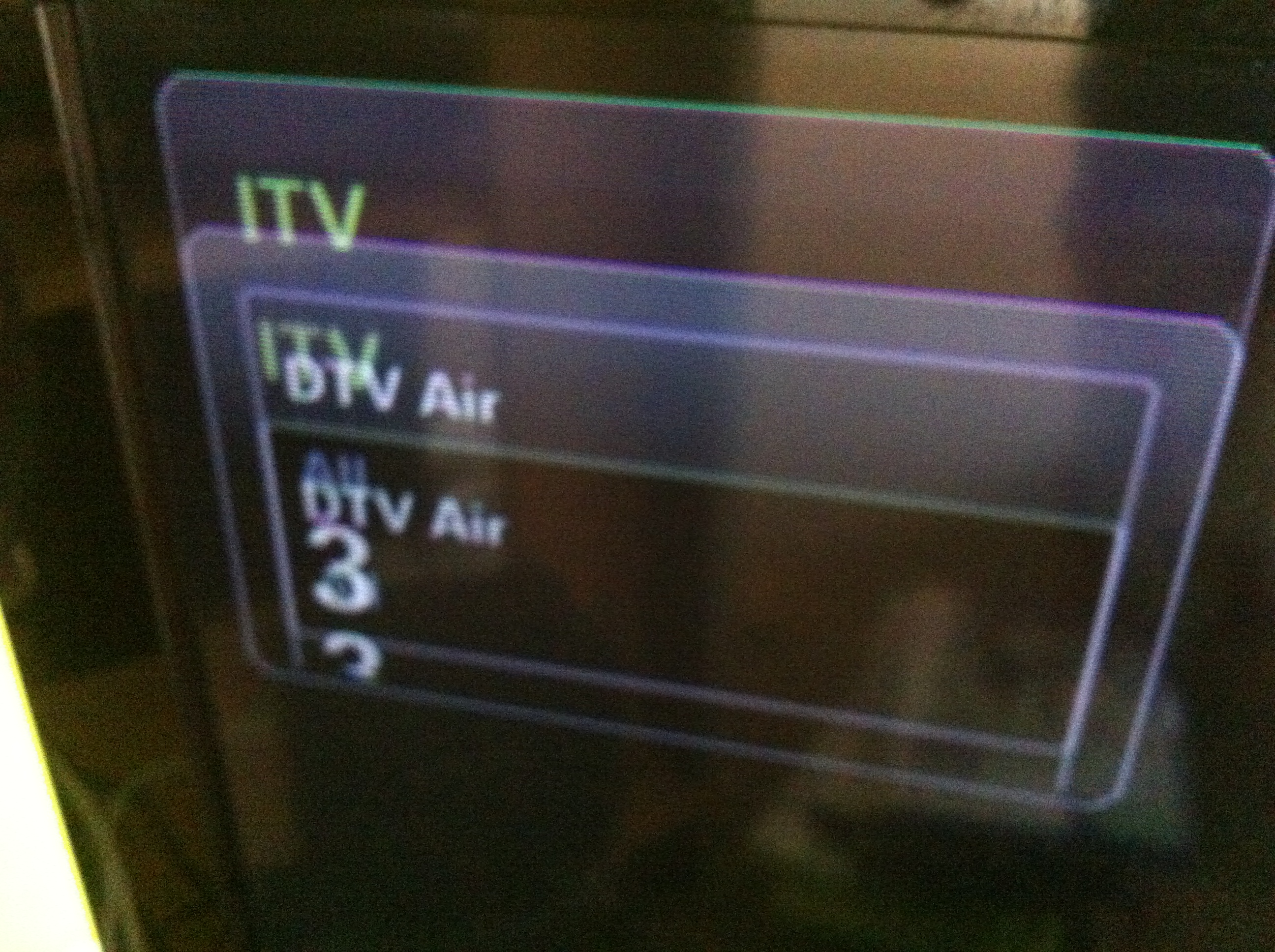

            Re: LE32C450E1W double vision
            Here's a better picture of fault. I just want to be sure it's not the main board as it's a replacement from ebay. The previous fault was a flashing standby light.

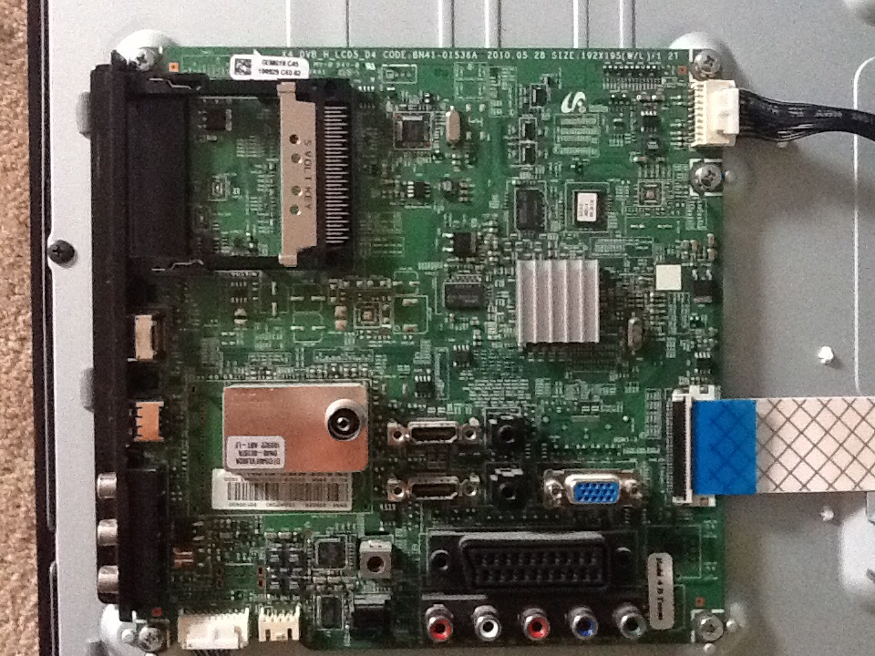

              Picture main board
                If you look at shopjimmy, both boards look the same but one only for one model, another on for 9 models.
