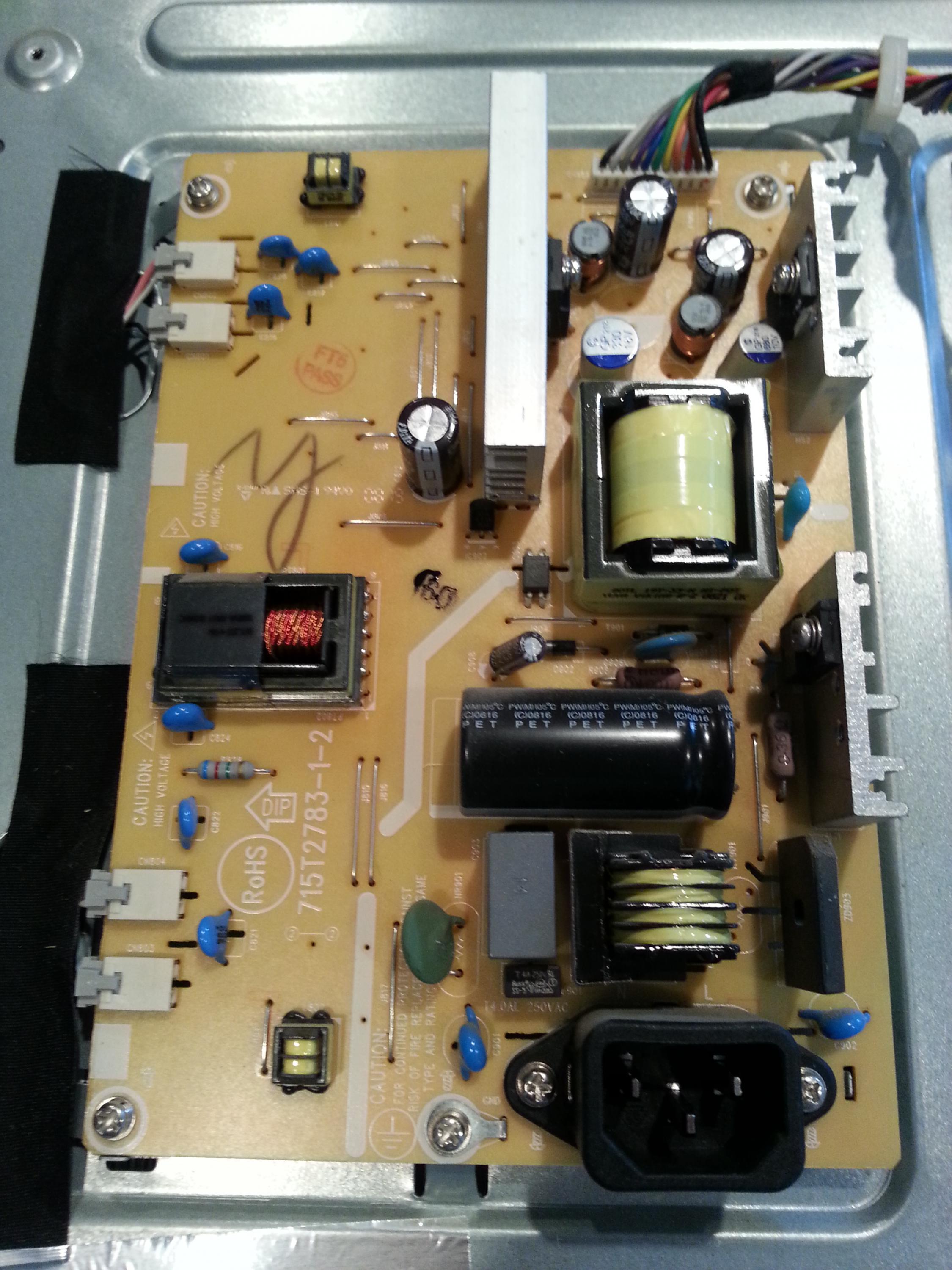

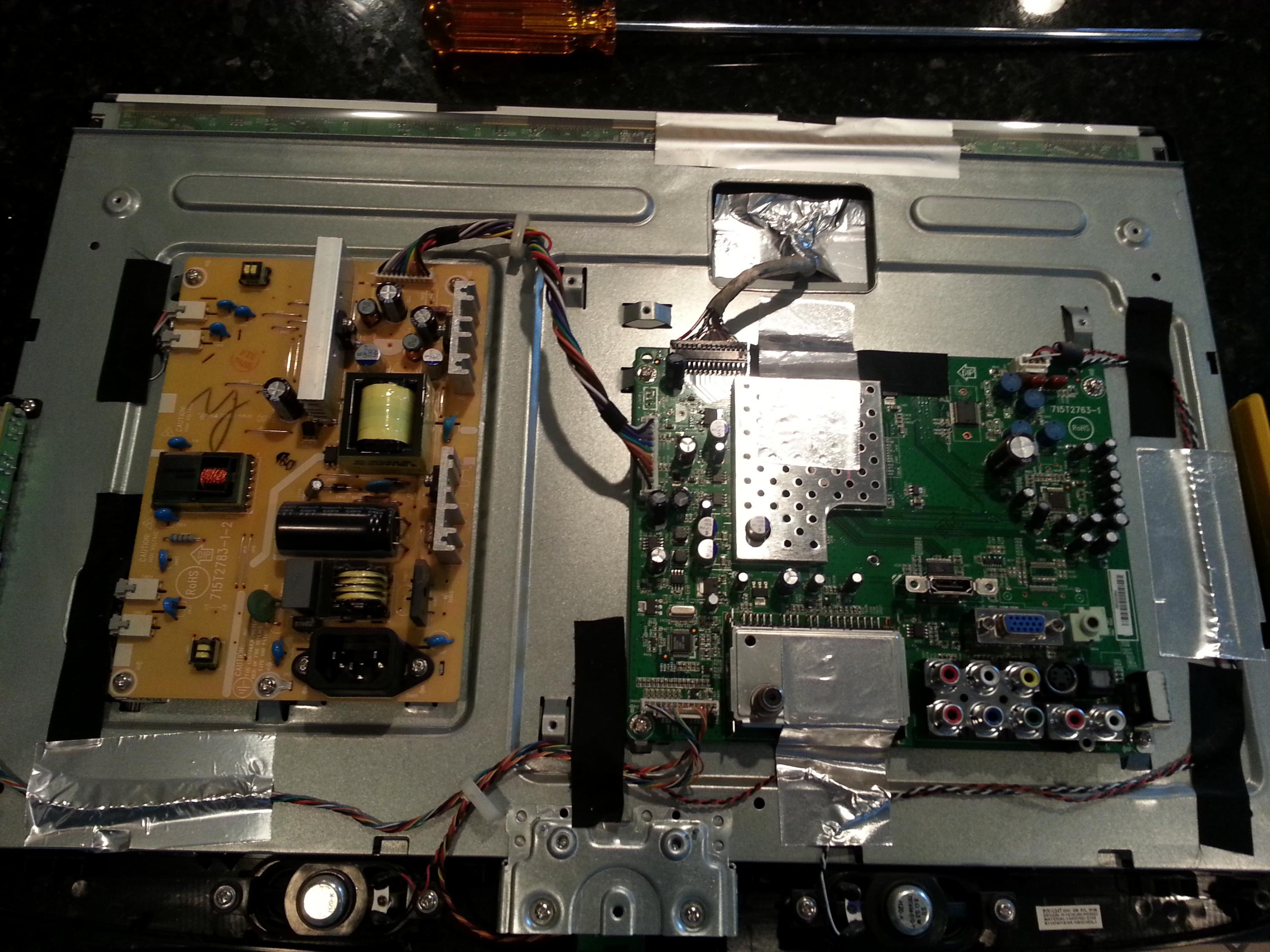

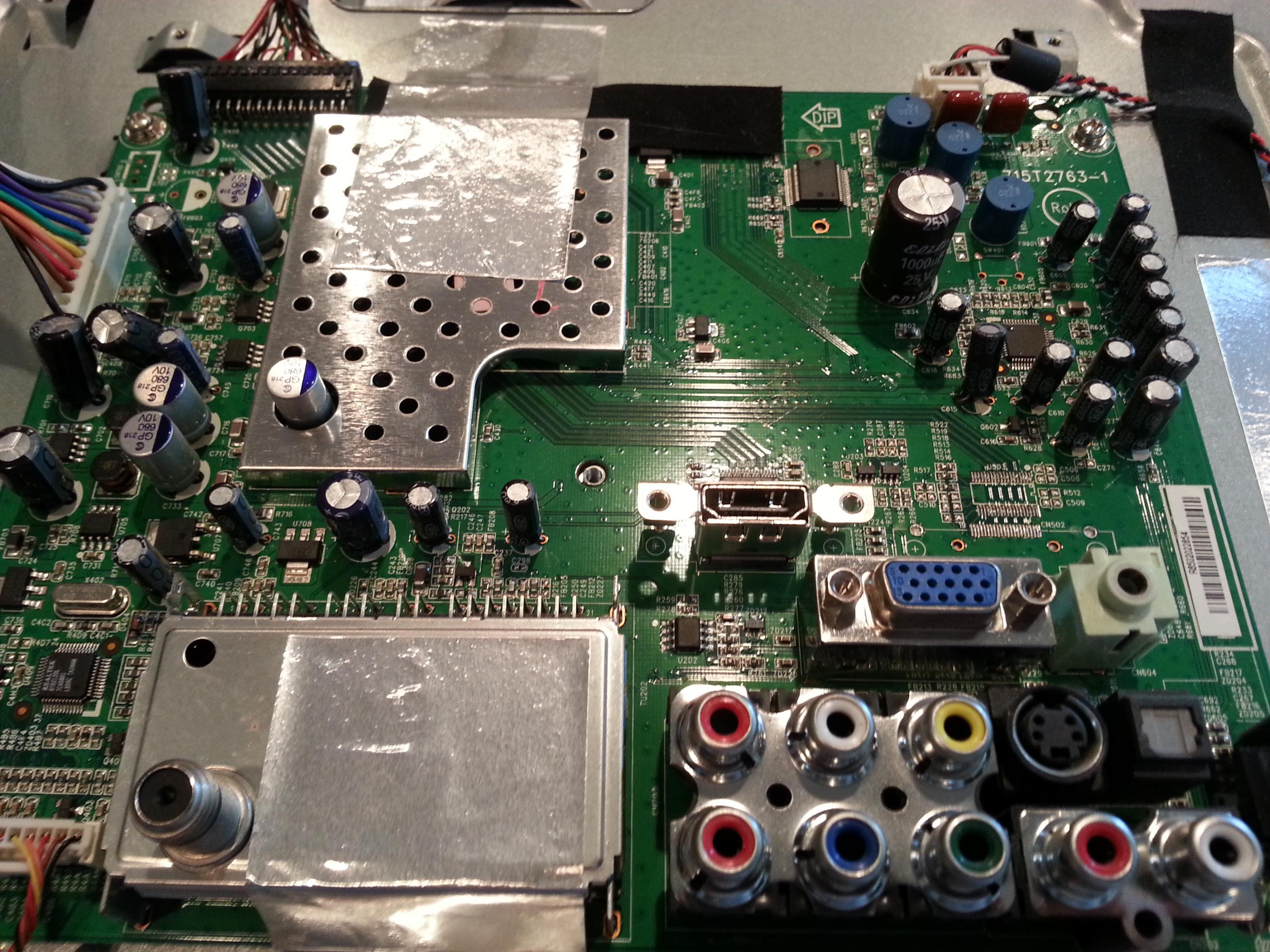

    I mentioned this TV in another thread, it was a freebie when I picked up another set. The facts so far:
    1. Powers on, but doesn't seem to process any video sources nor show any menu
    2. When plugged, LED blinks red 5 times and goes steady red on the 6th blink
    3. When turning off, LED blinks 13 times and goes steady red on the 14th blink
    4. When turning on, LED turns blue immediately
    5. 12v rail measures at 13.05v, 5v is nearly perfect at 4.98v
    6. Primary cap measures 168v at all times, powered off and turned on/turning on
    I don't really have a use for this TV, but it was free and if I can fix it for cheap I'll find a home for it (maybe a new monitor in my server closet).

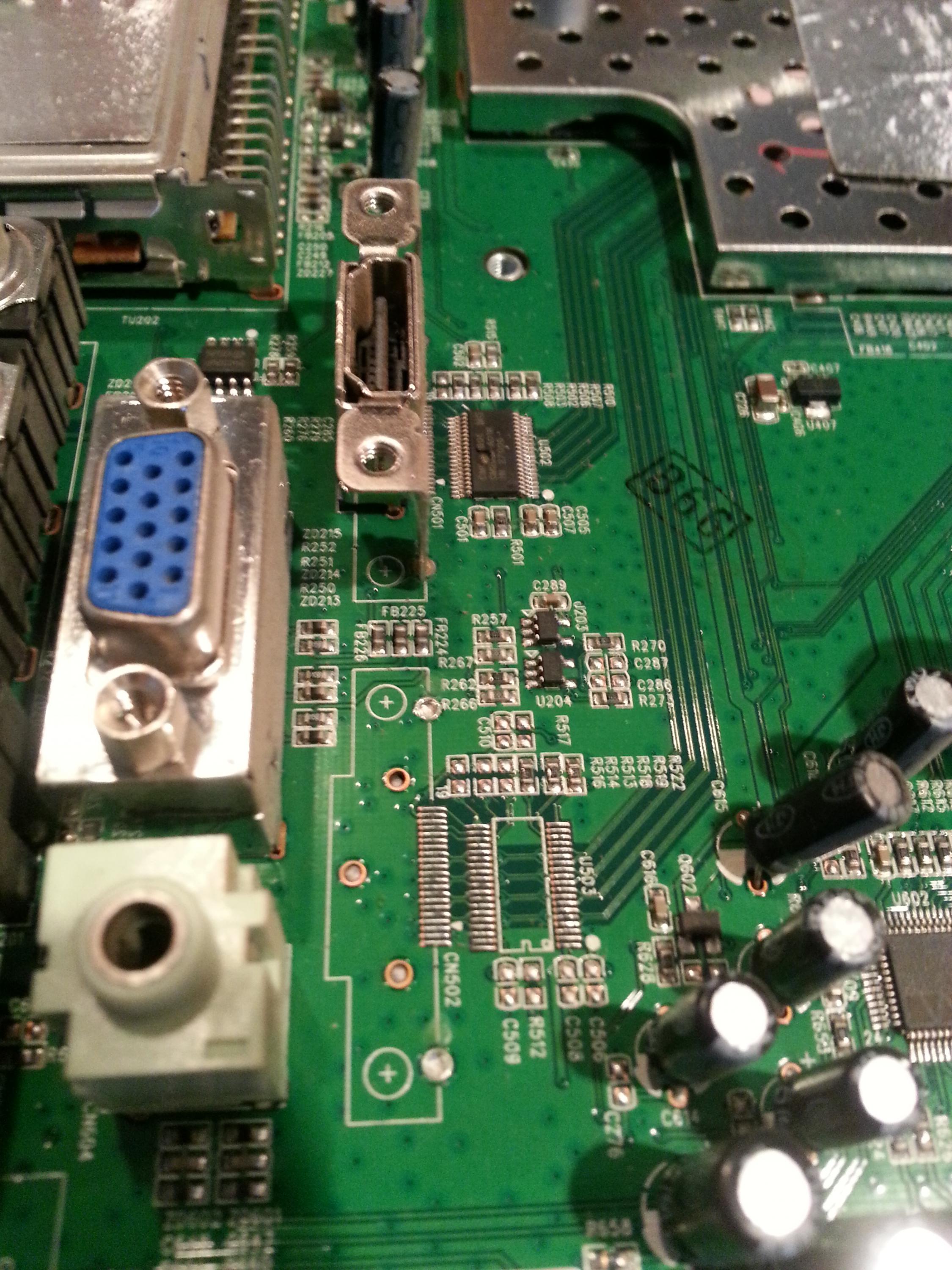

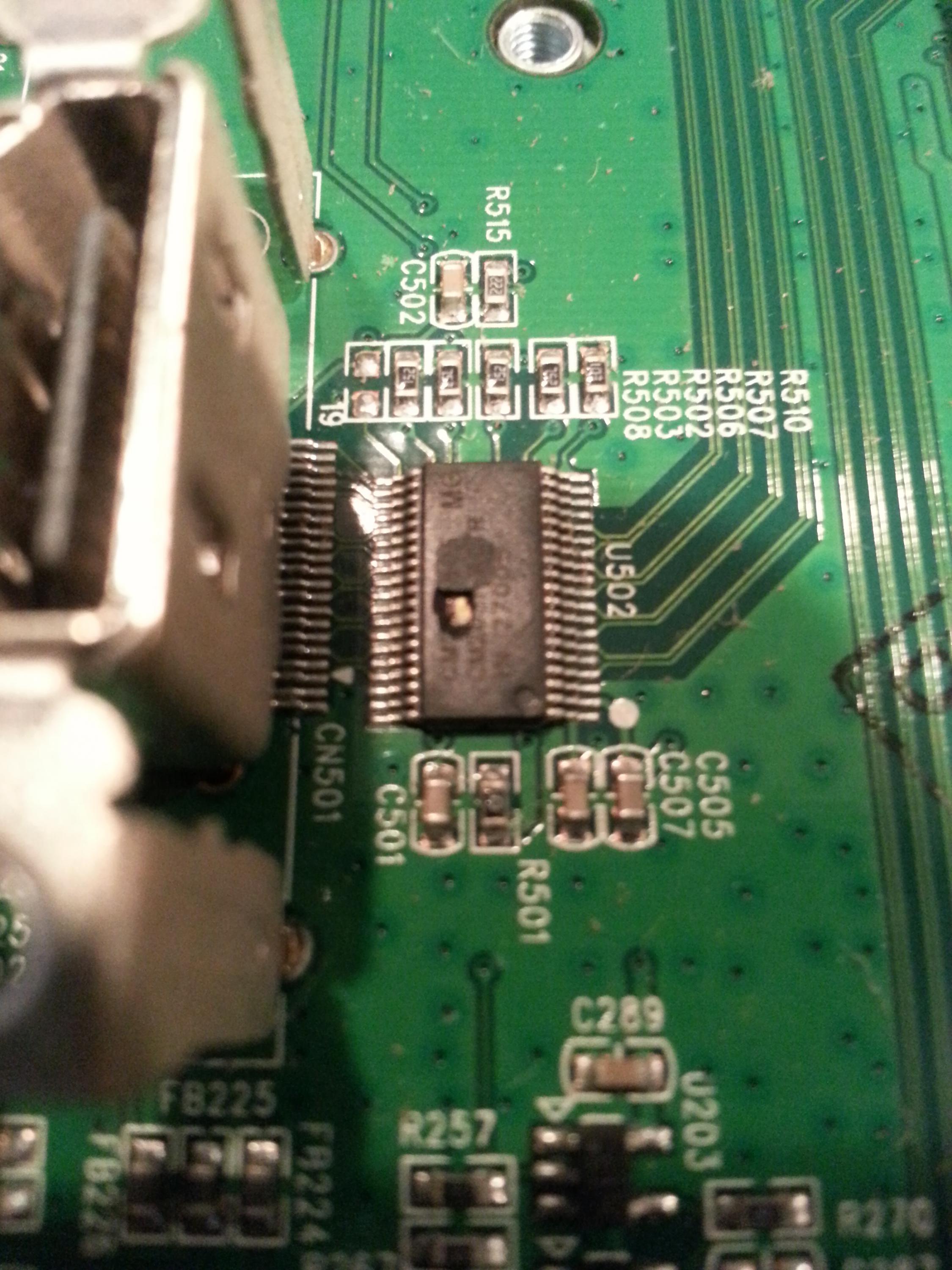

      Originally posted by DLinkOZ
      Well, that can't be good!
      True !! what is/was it?
      • DLinkOZ
        • May 2013
        • 238
        Re: Vizio VW22L
        Looks like logic for the HDMI port. There's a second, unpopulated HDMI location on the PCB and it also has a matching spot for another of these chips (also unpopulated).
        • DLinkOZ
          • May 2013
          • 238
          Re: Vizio VW22L
          A better shot of the area.
          • DLinkOZ
            • May 2013
            • 238
            Re: Vizio VW22L
            I've seen several people here lately with failures due to the HDMI chips, and they removed it to get the TV up and running. So I thought that would be ok for now, since I would likely just use the VGA in the closet. Removed and no dice, unfortunately. Still no bl_on, though an update on the 12v - it's 12.2v with power off, 13v with power on. Still the same 160-ish on the primary cap both in standby and turned on, though that's not surprising since it's not technically turning on. I'll check around for a cheap main board.
