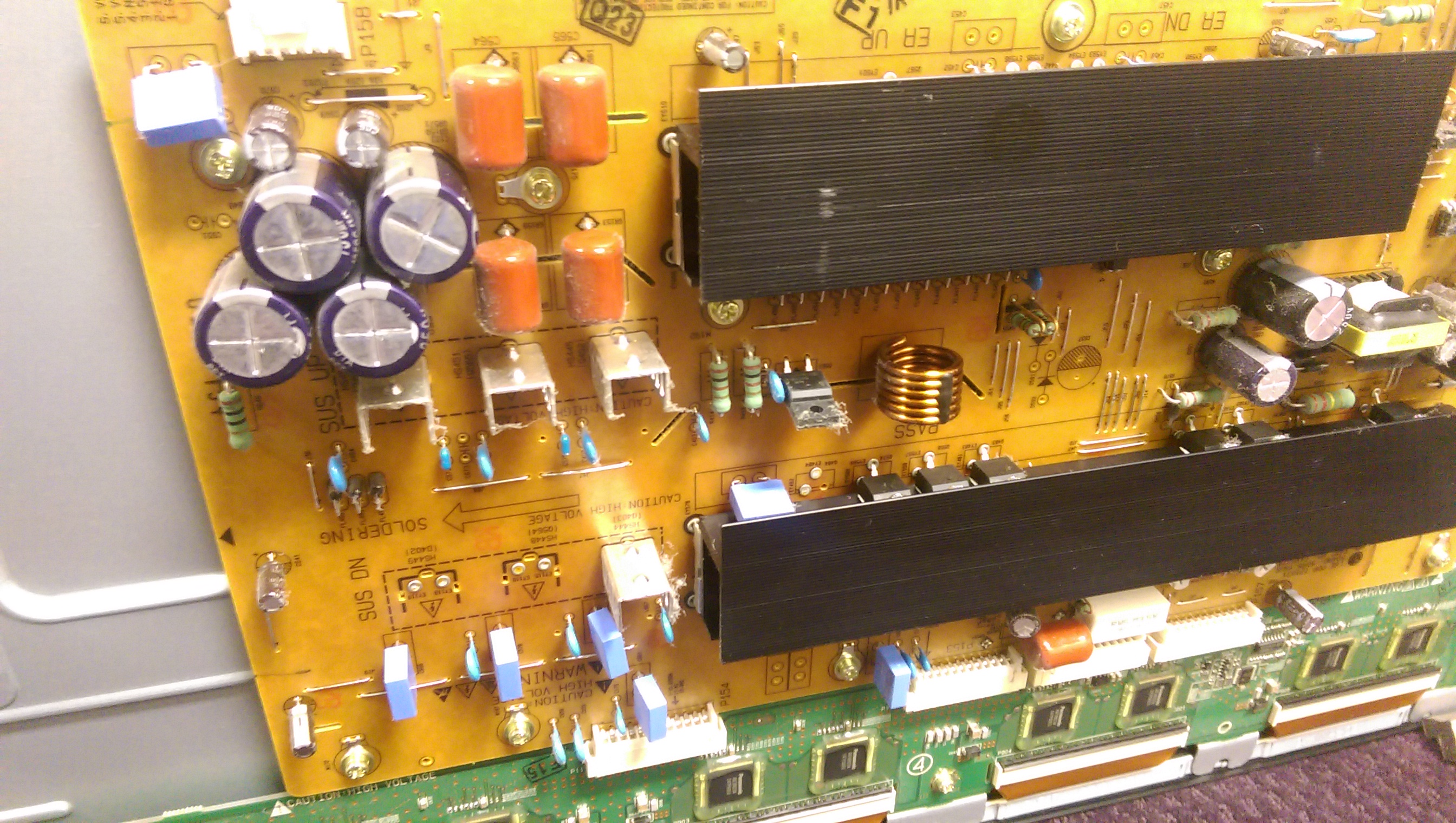

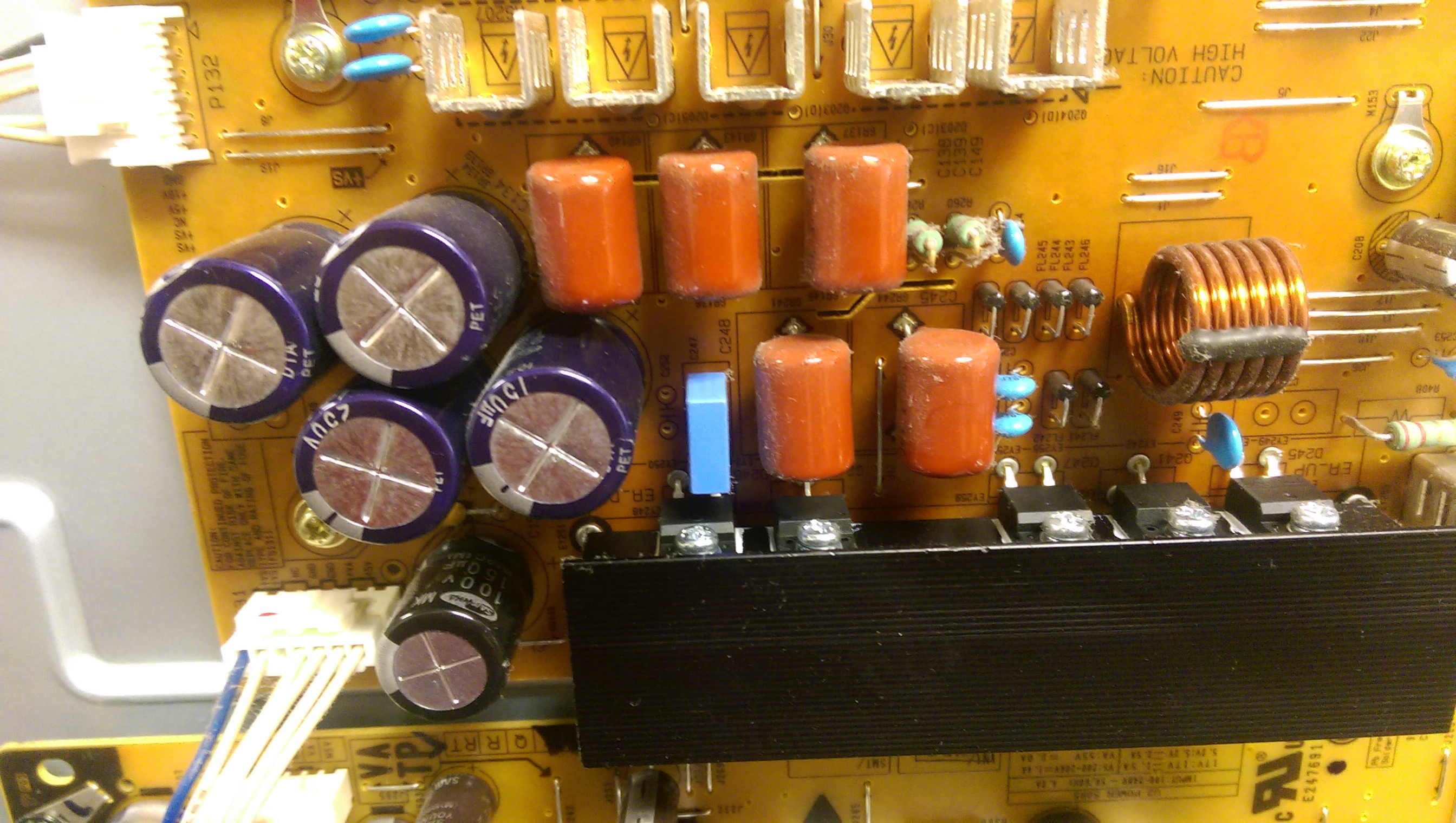

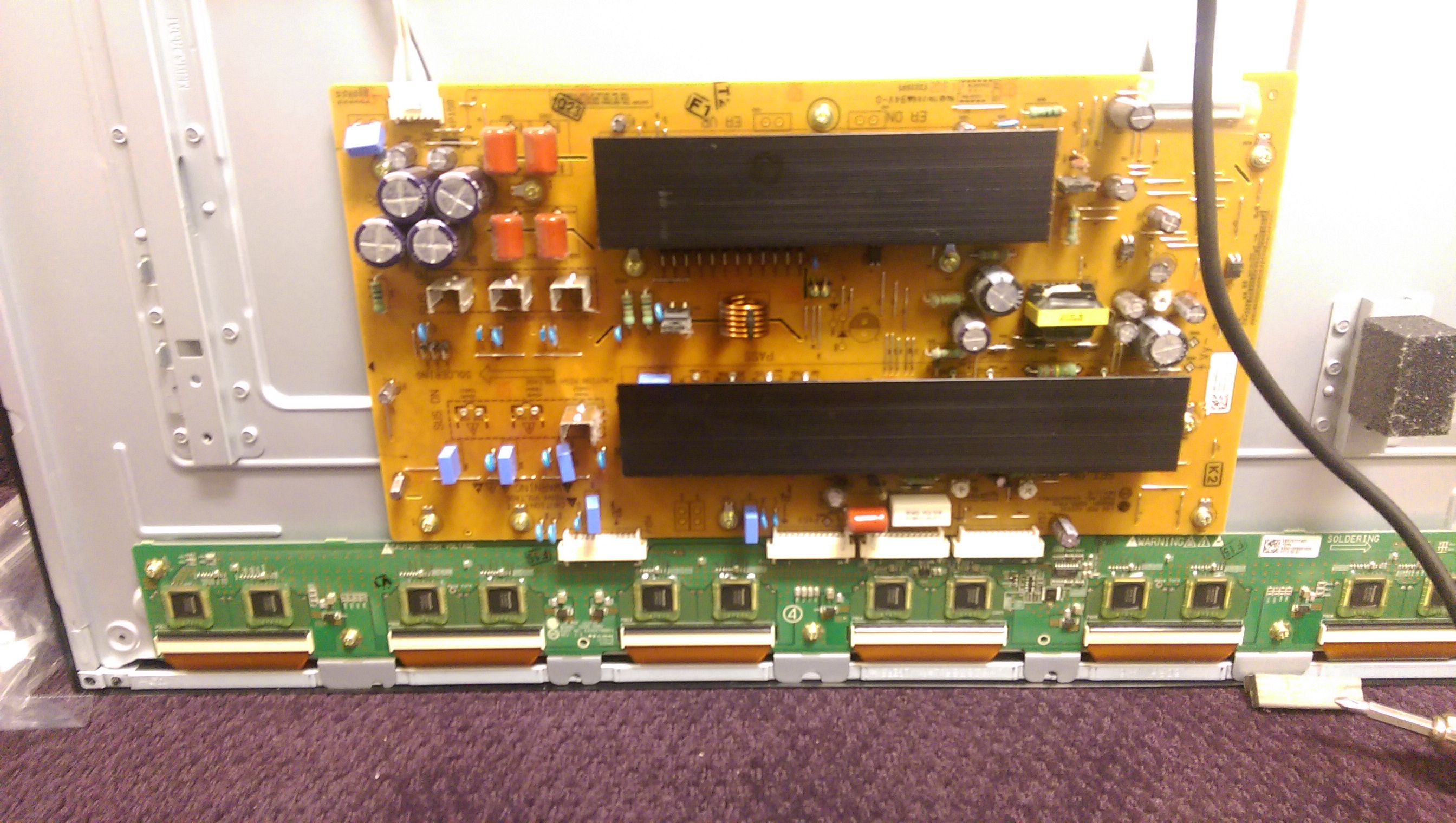

        Turned it on this morning almost made it 30 mins. I believe it's heat related as well, after I took the back off I noticed 2 areas that look a bit dark I included the photos. I'll see if I can't hunt down the voltage regulator. STJ so you just replaced the regulator and it was fine?

          the only think i can think of is to check for dry solder joints on the psu (expand when warm contract when cold) also maybe get a can of freeze spray and spray the regulators when the set goes off and see which one when cools allows it to turn straight back on but try the voltage checks first save buying freeze spray.

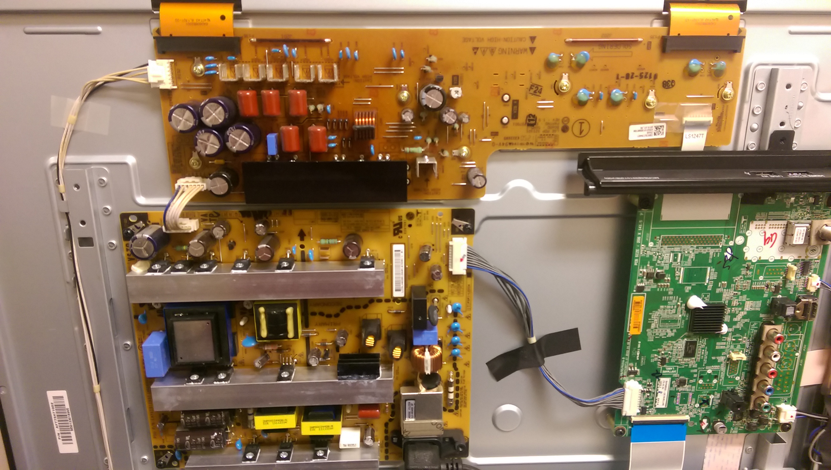

                Which green board the buffer board with the ic chips?
                • vinceroger69
                  • Mar 2012
                  • 6714
                  • uk
                  Re: Lg 50pn6500 Shuts off after 5 -20mins
                  i would guess the main board the one in pic one on the right.
