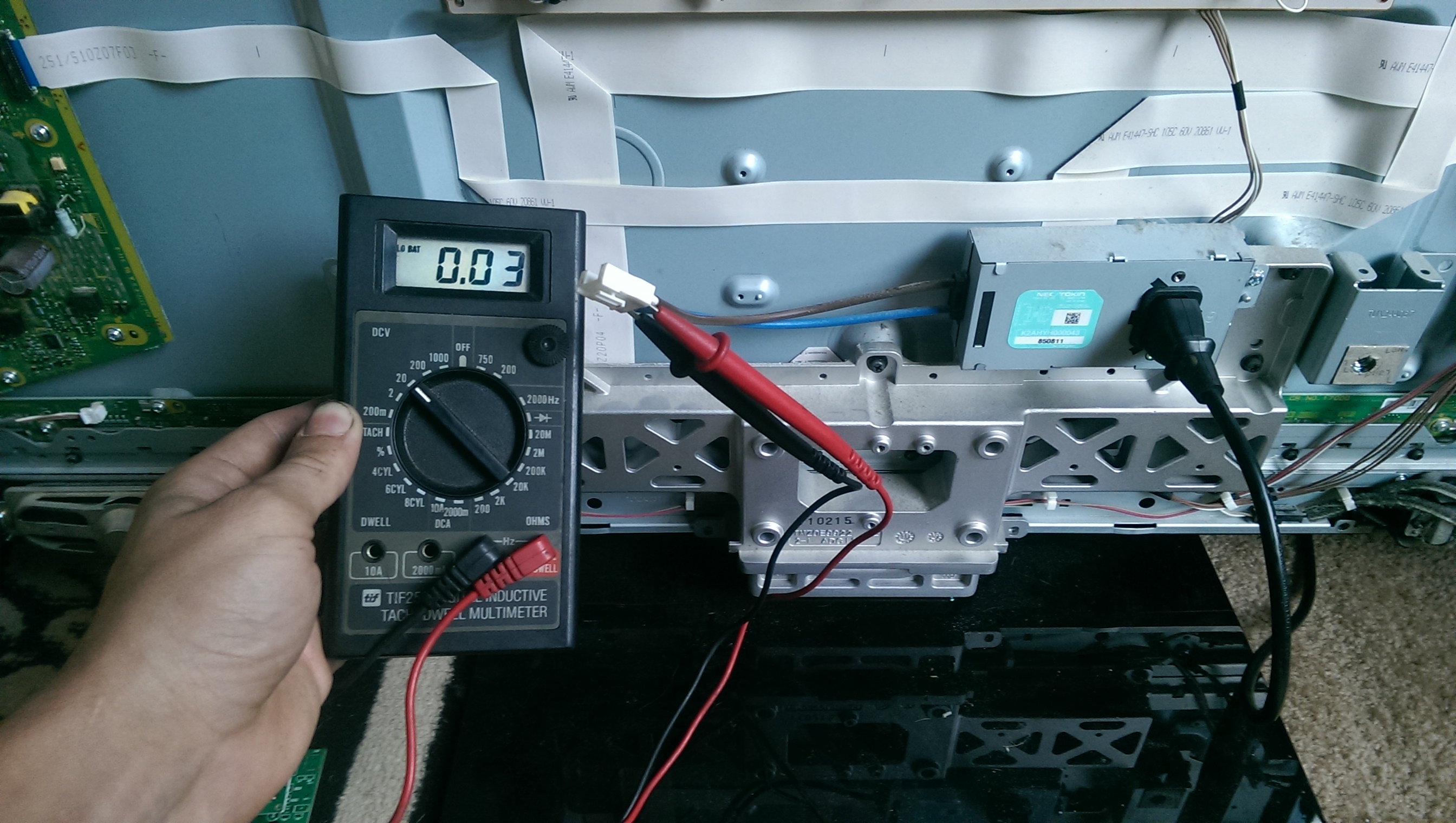

                                    Re: need help with caps on a plasma tv power supply board
                                    could this be a problem???

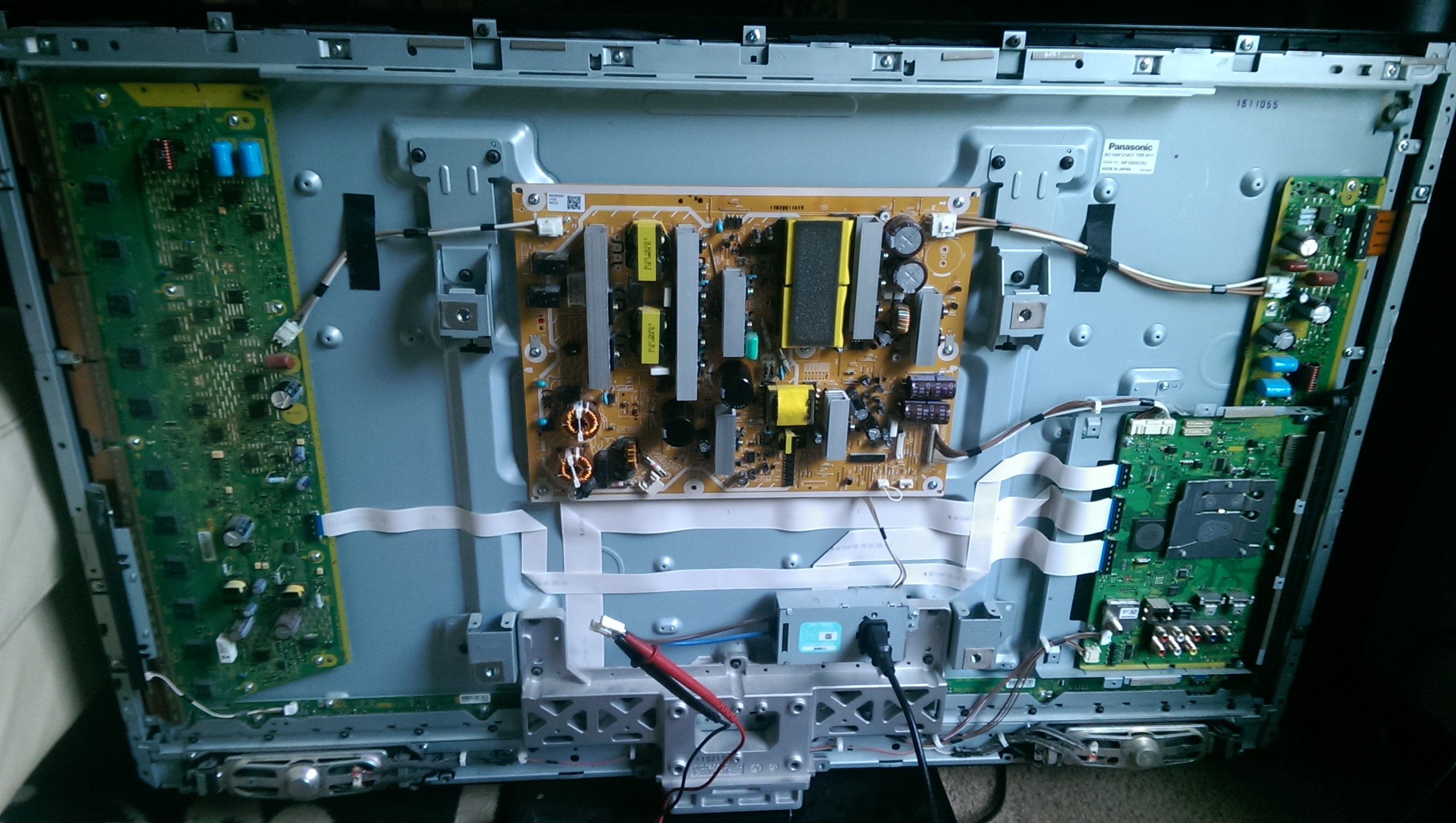

                                      tw posted a pic of the tvs setup
                                      and heres the video http://youtu.be/5YQ0YkY58oE
                                        AC volts for mains measurement, if you had no AC in you would get no blinks.
                                        Calm down, stop jumping ahead, follow tw's advice because it's confusing me and no doubt confusing him too
                                          I just dont get you at all????
                                          Problem - Noooooooo Wayyyy
                                          You have a meter with a flat battery which means any testing is likely to show incorrect results.
                                          You test resistance with Power on
                                          You replace caps irrespective of voltage.
                                          Now you appear to have a meter set on 20vDC plugged into 120 AC.
                                          I may be wrong - hopefully?
