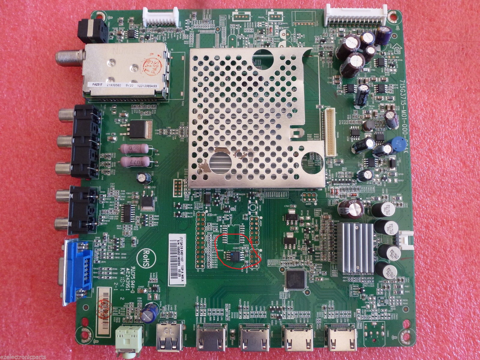

                        • aaronwt6
                          • Apr 2013
                          • 855
                          • US
                          Re: Vizio E420VA mainboard replacement
                          Post a picture of the board please. I'm not sure if the eeprom swap is going to fix it though. I've had mixed results swapping these boards in Vizio's. They use so many different panels it's hard to keep up.
                          • aaronwt6
                            • Apr 2013
                            • 855
                            • US
                            If this is the board you have, I've circled the Eeprom
                                Yep that's the board. Too bad I can't get into the service menu and poke around in the options kind of like Samsung and thier panel options although I doubt it will do any good.
                                • freakaftr8
                                  • Oct 2012
                                  • 3743
                                  Well ordered the EEPROM. Let's hope for the best.
