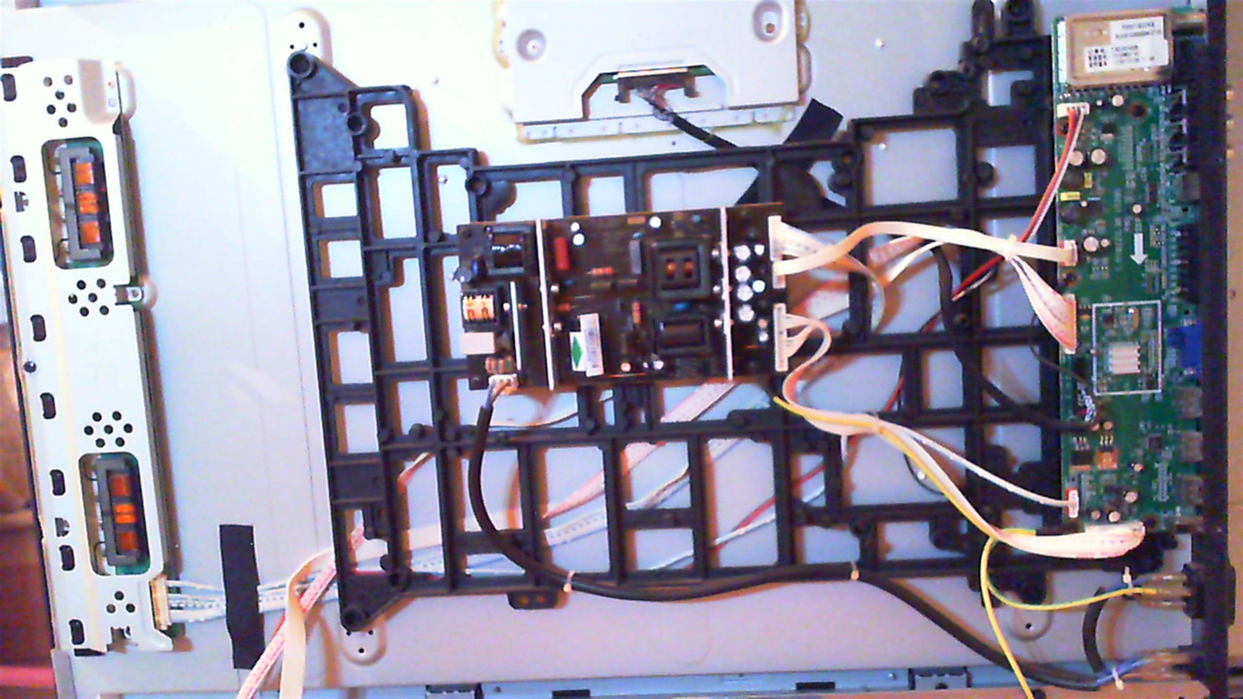

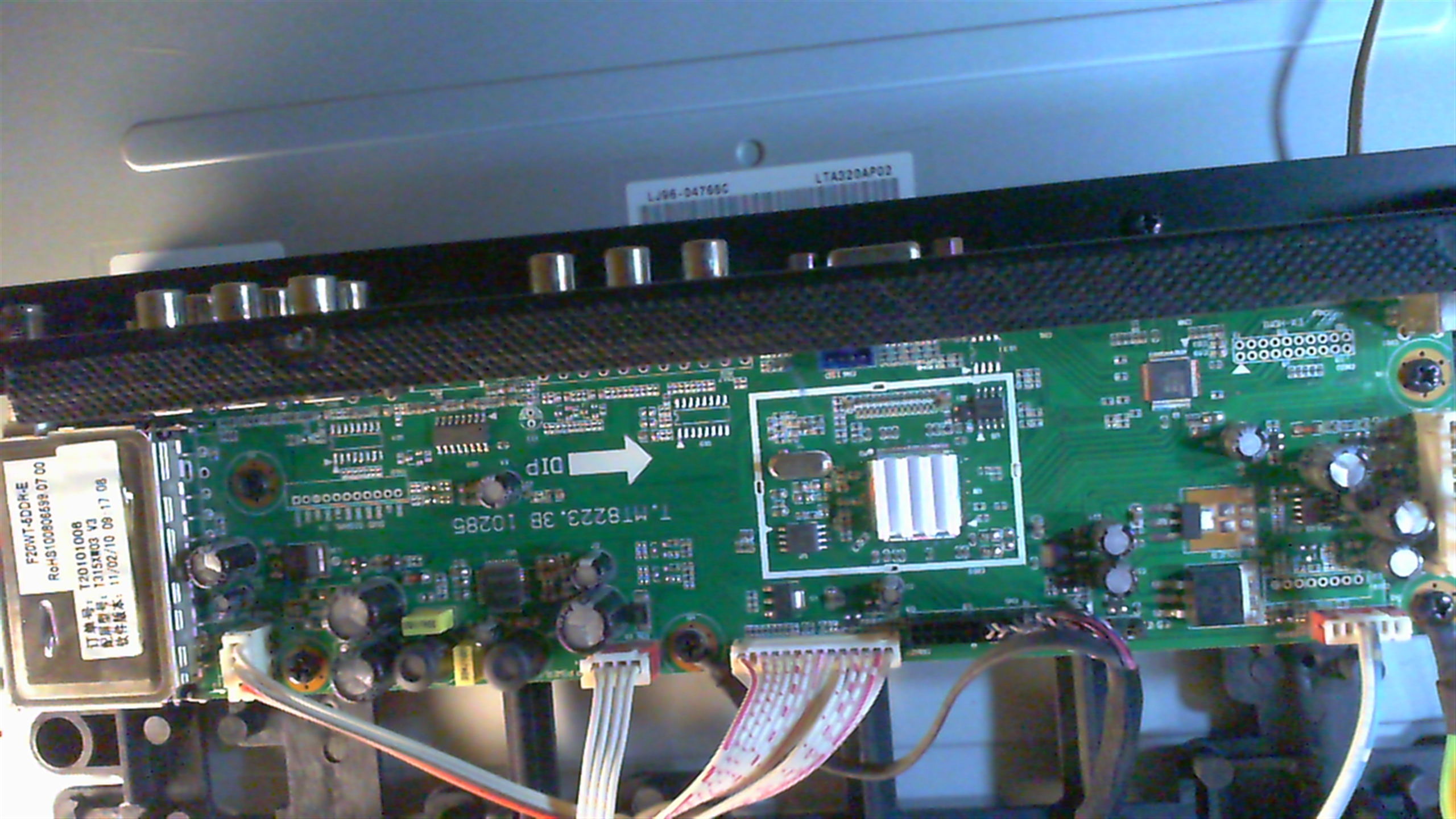

      Re: RCA 32 " tv flashing screen RLC3210
      Could you supply some photos of the circuit boards inside the TV?
          here is main board and A/V board

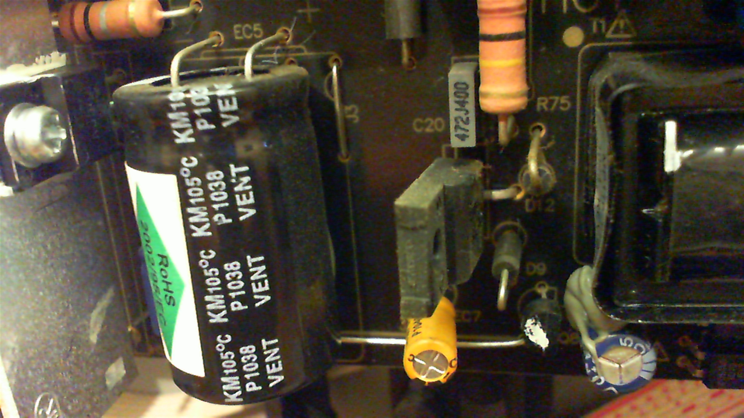

                Do you have a digital multimeter?
                If I were to guess I would say the big 450V capacitor. It has caused faults like this before.
                    Tom the big 450V tested shows 358V steady

                      I have 3 other tv`s with the big CAP which 1 do i replace this one with Please ?
                        Do not use a second hand cap, buy a new one, because you cannot be sure whether the 2nd hand capacitor has "voltage formed" which could lead to rapid failure. Digikey will sell it for a few bucks.
                        You will need to lift up the old capacitor and see what is printed underneath it.

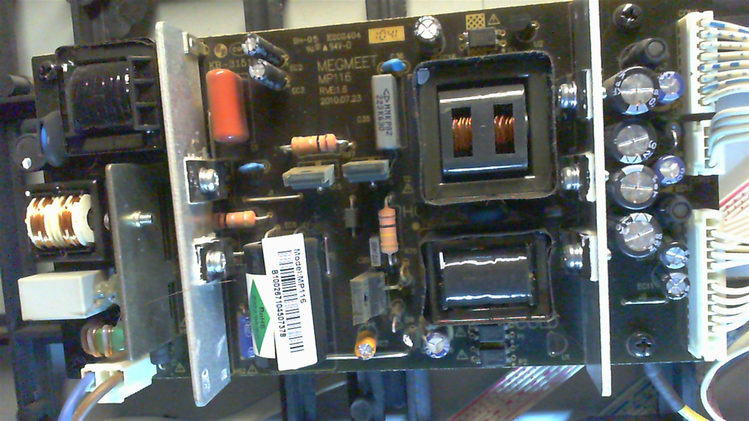

                                    after seeking solution i've found that it might be the power board or power supplies board that failed... going to the shop tomorrow to find out :L
                                      I'd be checking all the voltages before and during on the power supply when this "blinking" occours. Maybe that sheds some light to pinpoint one or all the voltage rails.
                                        I finally found the solution,
                                        is the chip L6599D L6599 ORIGINAL ST High-voltage resonant controller SOP-16 on the power supply,
                                        it cost me $ 2.
                                        Thank you for your help and I hope it will help you!
