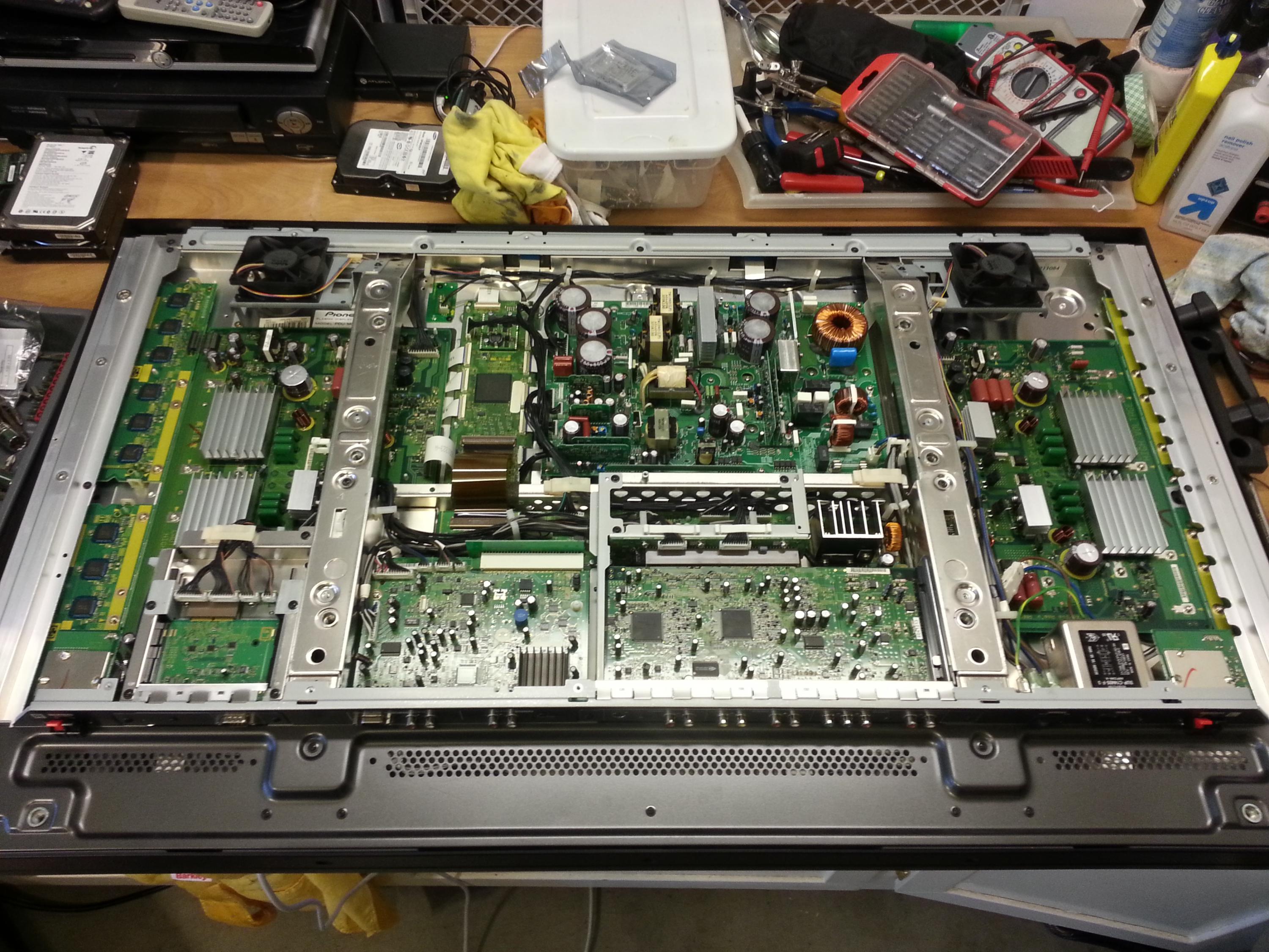

    PDP-4304 solid red/green LEDs
    I have a Pioneer PDP-4304. It refused to turn on, so I did some initial troubleshooting a few months ago, and decided to replace the power supply. I installed the new power supply but did not know about this diabolical trap switch. So I turned it on and of course, it did not power up. Instead, I have solid red and green LEDs on the front. I also research as best I could on how to reset this trap switch through the remote, but that did not work either. Couple possibilities:
    1 - Something else was broken, not the power supply
    2 - The trap switch reset method I used was incorrect / ineffective
    3 - ???
    I verified that the remote does emit IR light by looking at the emitter using my phone's camera.
    Any ideas would be greatly appreciated.

        • R_J
          • Jun 2012
          • 9535
          Re: PDP-4304 solid red/green LEDs
          Trap Switch Reset Procedure
          G-4, G-5, G-6, G-7, G-8
          • Replace media receiver, plasma panel cover, or tape down HDCP trap switch.
          If the model in question has the TV Guide option, the TV Guide
          option must be turned off before proceeding.
          • Using the customer’s remote control enter “service mode” by pressing the
          following key sequence:
          1. Press the “display” button then release the “display” button.
          2. Wait between 3 and 7 seconds
          3. Press and release the “<”, “^”, “<”, “>”, and “power” buttons in sequence.
          • Panel will now turn on in “service mode”.
          4. Press “muting” button 3, 4 or 5 times depending on model you are working on.
          Until the display shows the “initialize” page.
          5. Press and hold the “display” button until the error indicator (red LED) on
          either the panel or the media receiver goes out.
          6. Exit service mode by pressing the “power” button on the remote.

          • brainiac88
            • Jun 2014
            • 21
            I carefully followed the procedure, and nothing happened. The TV did not turn on as stated in step 3 (after pressing “<”, “^”, “<”, “>”, and “power” buttons in sequence.)
            Any other ideas?

                • brainiac88
                  • Jun 2014
                  • 21
                  PROGRESS!!!
                  Okay so this is what I did:
                  0. With new AA batteries, point the remote at the lower right corner of the TV
                  1. Press the “display” button for 1 second, then release the “display” button
                  2. Wait between 7 and 9 seconds
                  I head a click-click, then a faint buzz sound increasing in amplitude but still no picture or any illumination on screen.... then click. No more buzzing. Both front LEDs still solid.
                  I power-cycled the TV, then tried the sequence again. Same results.
                  Next, I will try the second part of the procedure mentioned above "If a circuit failure will not permit the unit to remain powered-on..." but that requires opening up the TV again... That's for another day.
                  • brainiac88
                    • Jun 2014
                    • 21
                    More progress:
                    I read the Service Manual on Scribd and it mentioned the switch on the board beside the power supply. So I switched it to the UP position, and performed the procedure above, several times, changing the switch position, power-cycling in between, and trying 3,4, and 5 presses of the Muting button. After 20 minutes of trying, I finally cleared the trap indicator - only the red LED was lit. Yes, I taped down the trap switch.
                    So turning on the TV results in it shutting off after 5-10 seconds, and getting a twice-flashing red LED, which means a "power" fault, according to the Service Manual. I tried both power supply boards I have, and same result.
                    I guess now it's time to get another power supply board...
