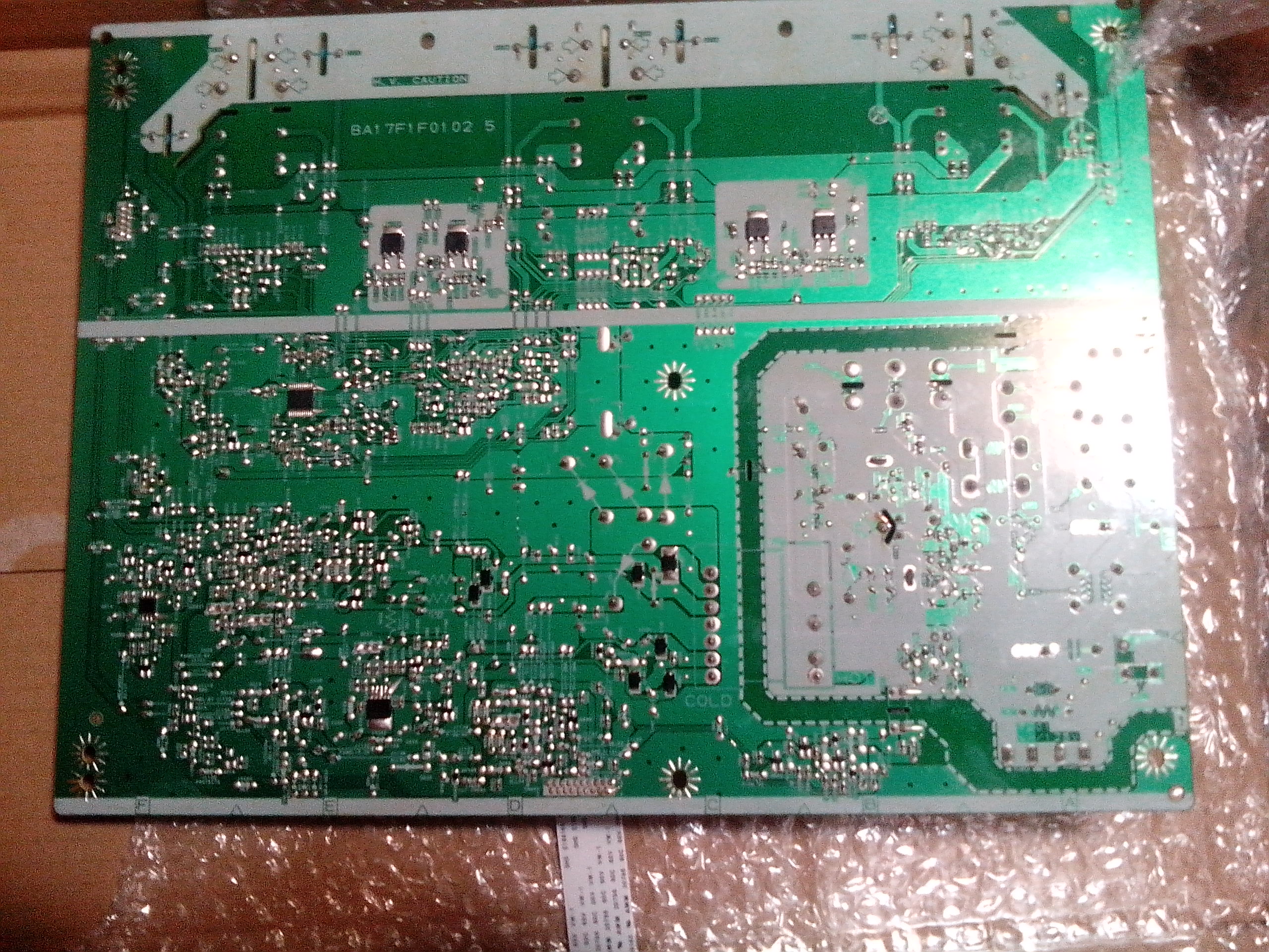

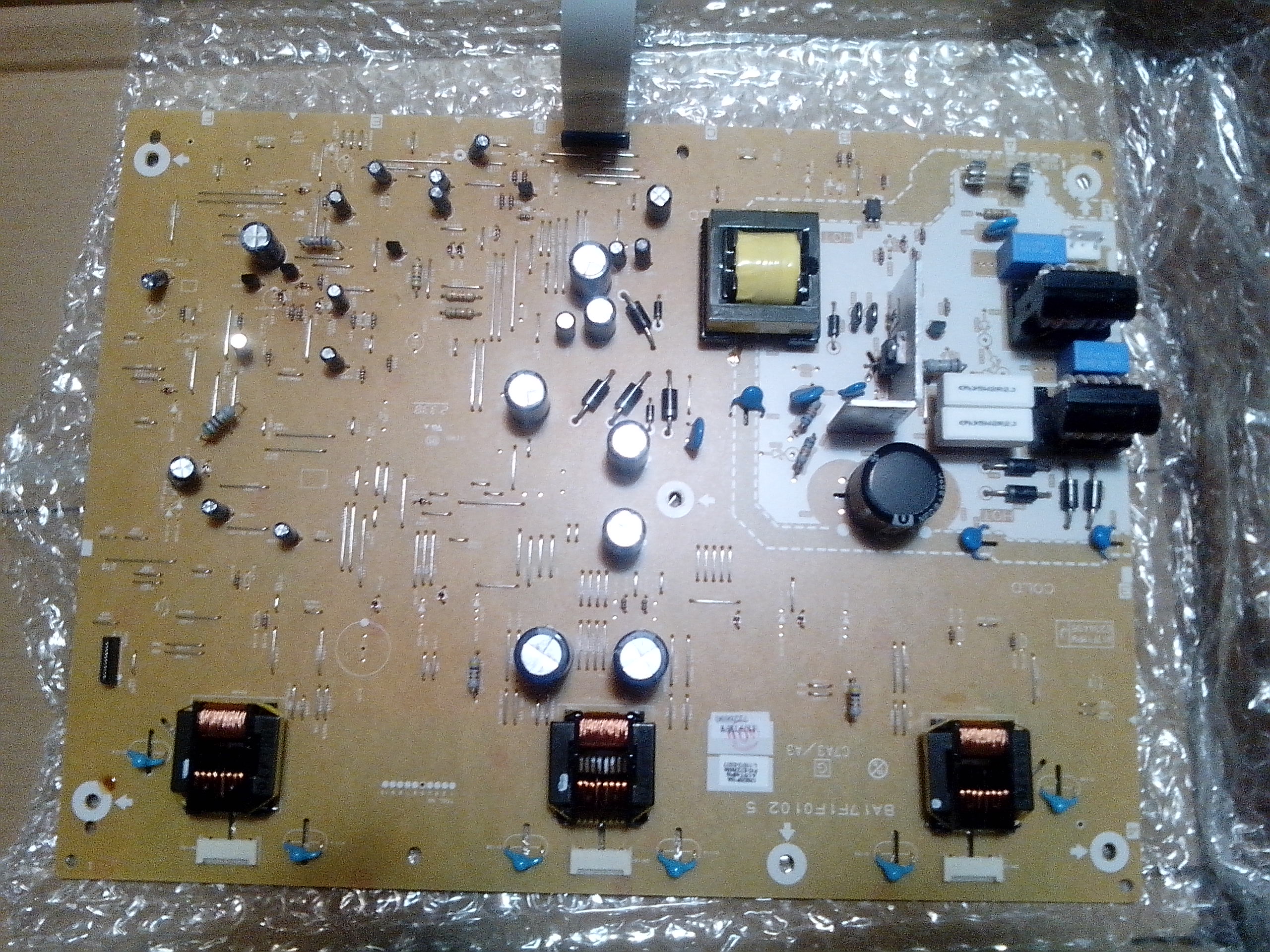

    Emerson hdtv troubleshooting

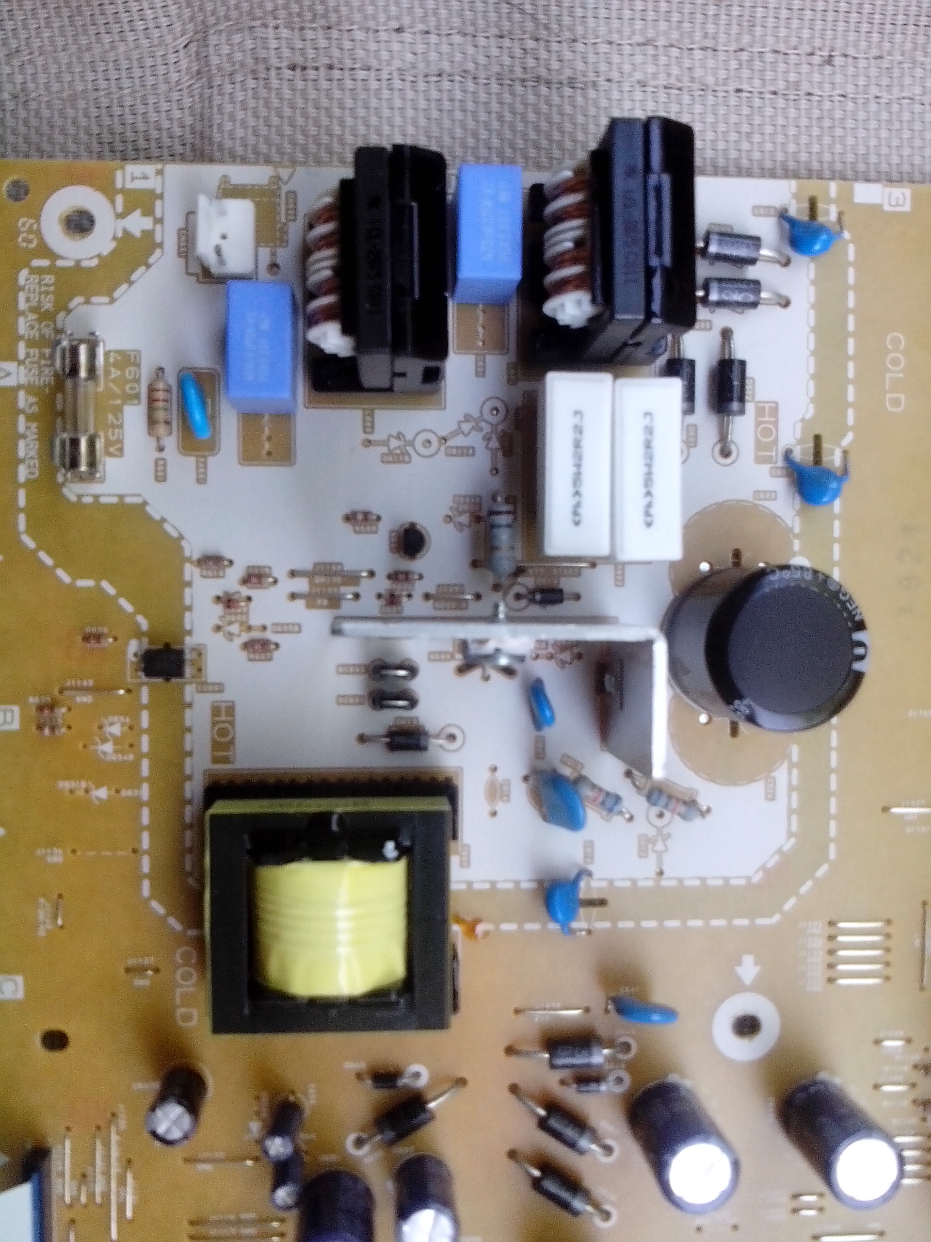

    Ok,since my Dynex is in the process of being troubleshot,I will go ahead and start this new thread for my Emerson.I had electrical strike that I believe either came in on the power line and/or via the satellite coaxial cable.
    It is an Emerson LC320EMZ.....I am attaching the power board pictures of the front and back.I apologize if the images are hard to view because I am using a camera phone under a house light.Thanks for your help!

    Re: Emerson hdtv troubleshooting
    given that the tests for a lightning strike/power surge will be the same for
    most tvs why not parallel the tests and just tell us the results?
    As you say the pictures are almost useless for troubleshooting.

      You can take some info from your other thread as in to start measuring some points..
      Powerboard disconnected from everything else,plugged in,meaurement across that large cap in the HOT section,meter on DC high voltage as you can expect up to 400 volts(167 in standby).
      Is there anything printed by the cable going to the mainboard? Looking for the standby voltage..
      Is there a board number on the powersupply? (then we can find a schematic)

        its reading 48.2 mV.......off the sticker on the board:120820p19a a17ft-mpw p/o:e7226690
        L:11072-03277......at another spot its got ba17f1f0102 5. this one looks like its going to be more difficult to spot..would you like me to take a better picture of the front and back of the board?

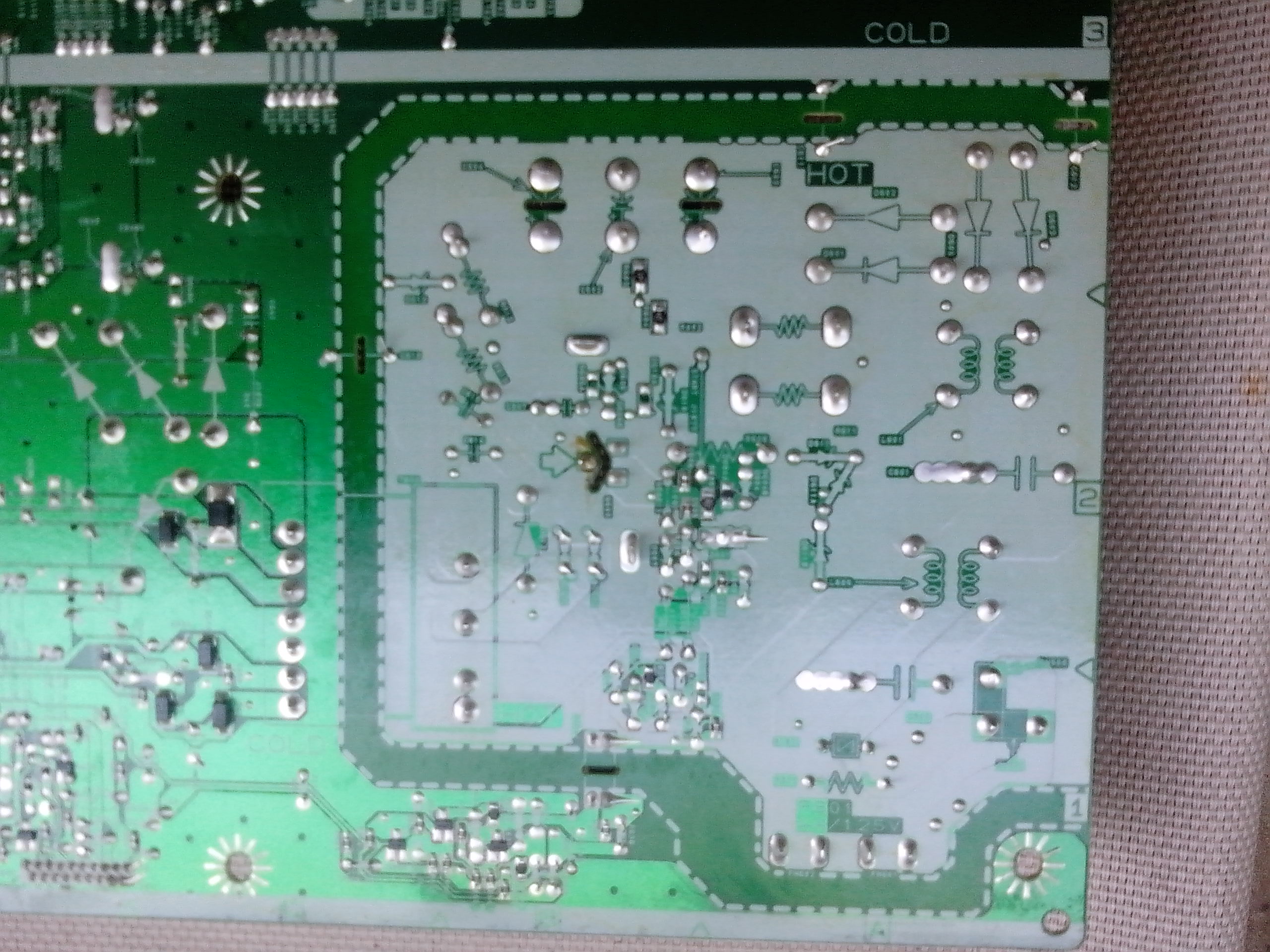

          yes a good close up of the HOT side of the board(around where it plugs 110v in and the big cap etc..)
          48mv on the main cap? meter was on DC voltage ?
          I think we need to trouble shoot this one even before the main filter cap,lets wait for the pictures...I will try and dig up a schematic..
            Yes in DC...pics to come..

              Tested the fuse?
              If that is ok there are 4 diodes just above where it says cold on the right hand side of the board in your picture. Can you test those.
                  power board pics of the hot area...fuse was good.

                    Ok like I said you need to test the 4 diodes top right in those last pictures
                    and also the 2 white boxes are inrush resistors - check them for continuity.
                    Neither test requires power to the board

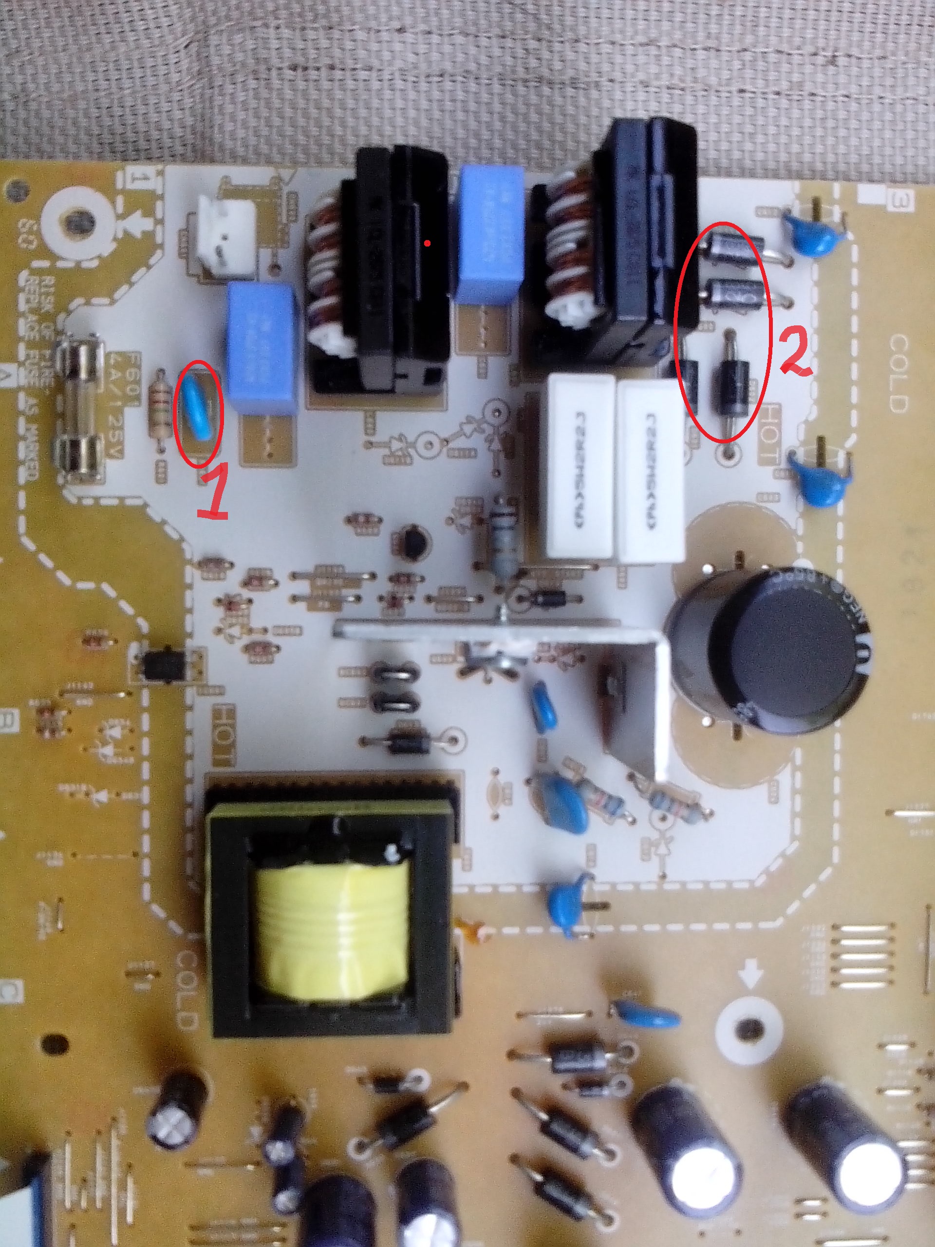

                      see pic...
                      Check #1 as you would check a fuse...TV UNPLUGGED!!!!
                      #2 are 4 diodes(as suggested earlier by selldoor),TV UNPLUGGED!!!.
                      Put meter on diode scale,measure each diode from the one leg to the other leg.then reverse your probes and test again...
                      http://www.youtube.com/watch?v=qSDRsz5-t7I
                        what is #1? ...I checked the 4 diodes top to bottom ,left to right as seen in the pic..readings are as follows 1-4.55m ohms/(reverse leads-open)..2-4.27 M (rev-open)...3--4.13M(rev--open).....4- 4.39 M (rev-open).... both resistors 1.3 ohms.My meter doesnt have a different diode setting..it is placed with my ohm setting.
                          I forgot to add pic...

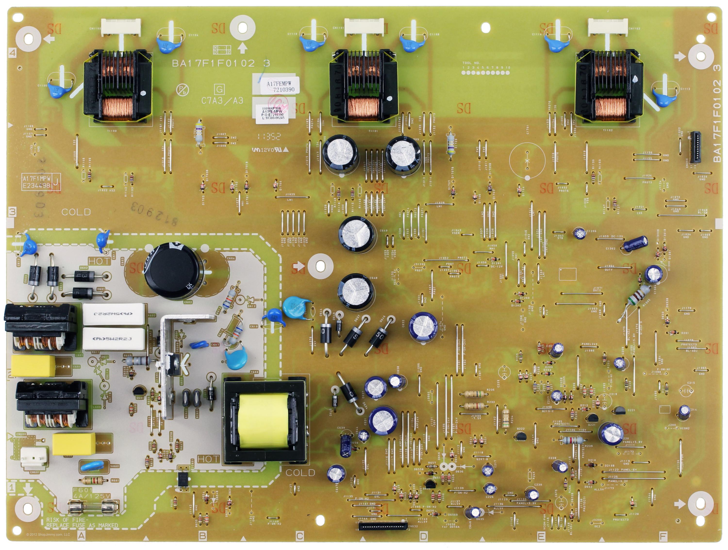

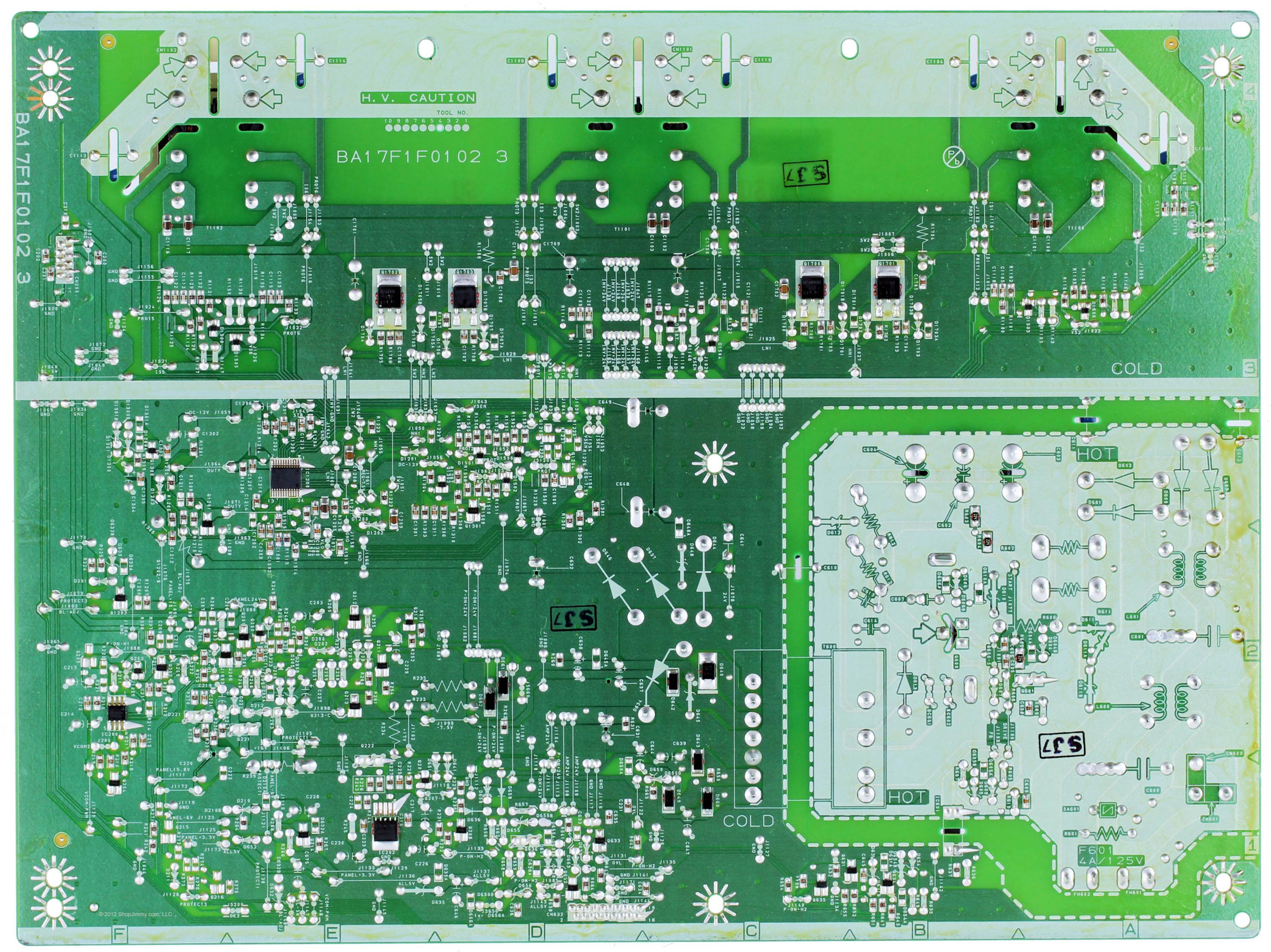

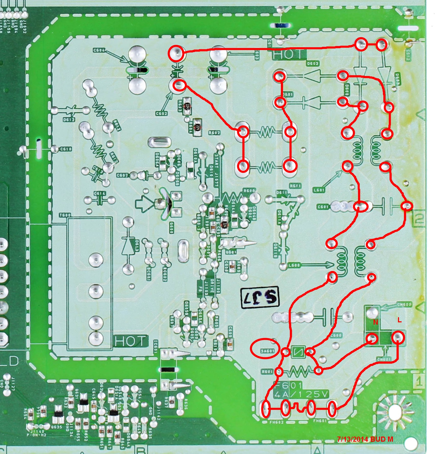

                            "power board pics of the hot area...fuse was good." What do mean by WAS GOOD? Is it still good? There is not much in the rectifier circuit, the 4 Diode are set up as a bridge, the Cathode of two Diodes (D601, D602) are tied together, then it is connected to those tow white fusible resistors (R602, R611), the output side of the resistors are connected to the + of the main filter cap, the Anode of the other two diodes (D600, D603)are tied together and then are connected to the - of the cap. So there must be an error in reading some where.
                            These are better pictures provided by Shopjimmy.
                            See how the main filter cap is charged up to 170VDC.
                            You should also check and see if the Surge Arrestor SA601 is not shorted due to the surge.

                              I'm wondering if the 110 ac even makes it to the bridge.
                                He should test for AC right at the L and N as I marked them,or if the fuse is blown (he said it WAS GOOD) or those two AC line filter inductors are also blown open. There is not much to the circuit, he should be able to do resistance test from the Line and Neutral terminals all the way to the diodes. see post 14 drawing.
                                It is hard to do long distance troubleshooting if the information are not correct.
                                  I was wrong too,in post #13 I circled part#1(Surge Arrestor SA601),thinking it was in series with the 110 line..
                                  Now looking at your #14 pic drawing its parallel...
                                    1 is 1.19 m ohms

                                      Ok -see the plan budm drew for you. Locate on the bottom of the board
                                      where the mains lead pins are and where the BIG cap pins are.
                                      Working on a non conductive surface have just that board with the bottom
                                      face up. Set your meter on VAC 600 and with the board plugged into the main test the voltage on the two mains lead joints. CAREFULLY.
                                      Next change your meter to 600vDC ( I cant remember is yours an allranging one? ) anyway with it on 600v DC test the voltage across the BIG Cap joints Again CAREFULLY

                                        oops forgot to have the board plugged in when I checked the big cap ....so I will be starting the readings over ...the big cap reads 160.8 vdc with power, vac is overlimit..
