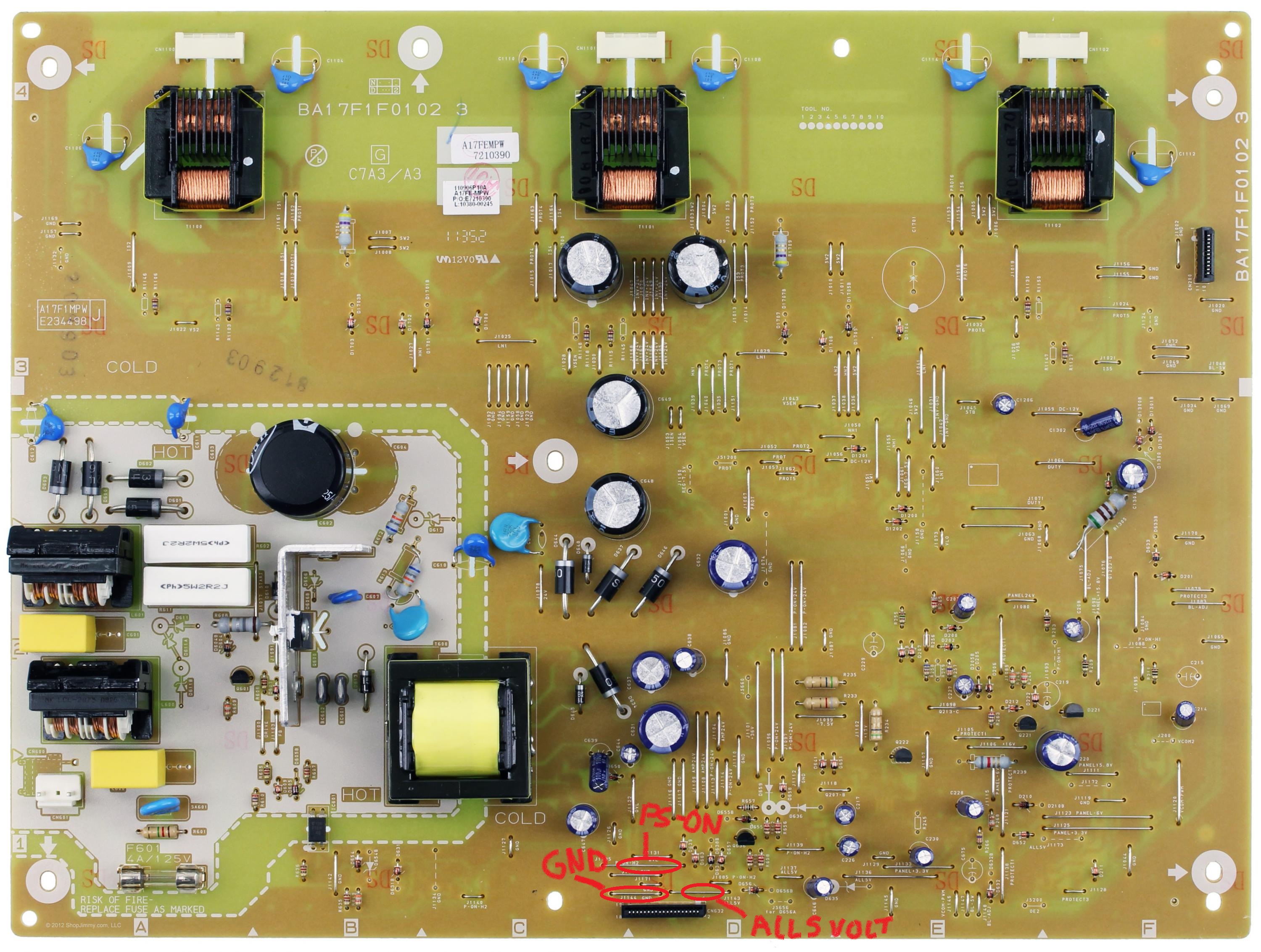

                  you won't see 24 volts etc untill we force on the power supply...
                  see pic,I marked the all 5 volt and GND and also ps-on...
                  Meter on DC scale,black on GND,red on all 5 volt jumper wire.... ?? volts?
                  Now,if you DO get 5 volt on the all 5volt jumper,then it's time to test if the mainboard tries to turn on the power supply...
                  Plug powerboard back in to mainboard and ALL other connectors...plug in the TV,put black probe on GND,red probe on the ps-on jumper wire,you will see 0 volts,KEEP probes on thse points and hit the power button on the tv(or remote)and see if now you read a voltage,could be anywhere from 1.8 to 5 volts...

                                  Could we get a clear close up picture from the bottom side of the power board,showing the area where the all 5volt etc is?

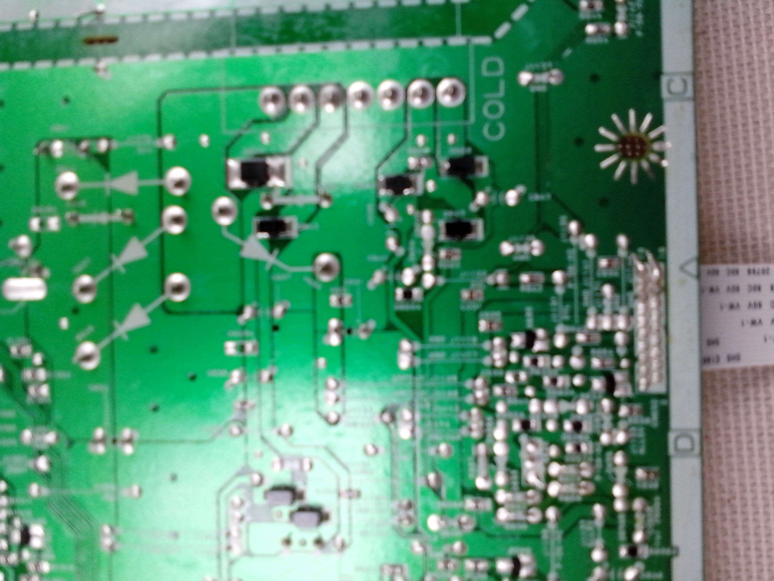

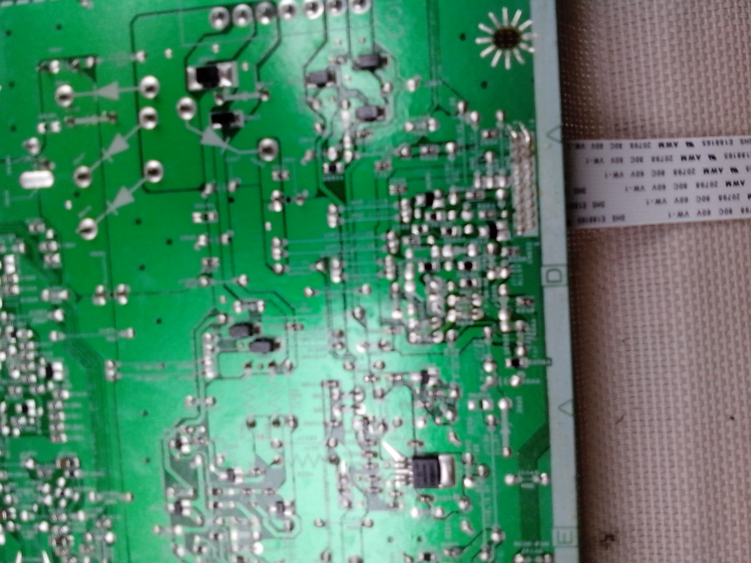

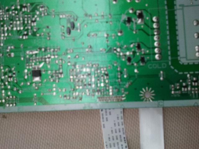

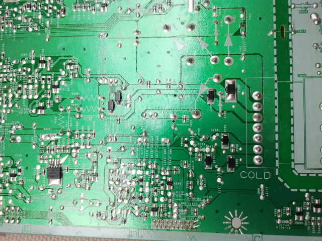

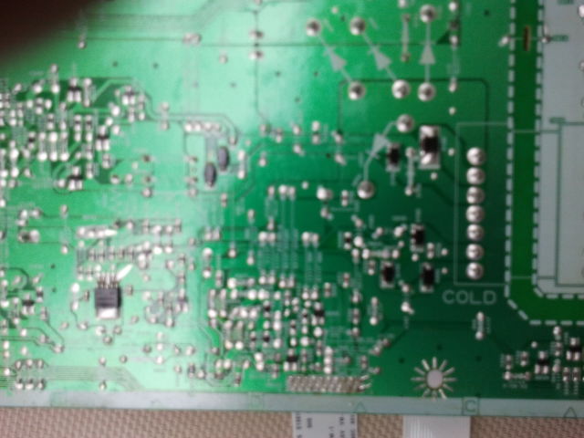

                                      the shopjimmy pic in post 14 will probably be clearer than mine..the shiny back on the board blurs my pics...I will upload a couple though and see if you can make anything out of them.I think the 3rd one is the least blurriest..good luck...

                                        May as well delete all except 3
                                        Martino yes I think its too low but no idea why.

                                          I'm on the road so can't really see pic good. But I'm thinking of a Zener diode dragging down the 5 volt a bit. Wanted to see the traces to trace back the 5 volt line to transformer.
