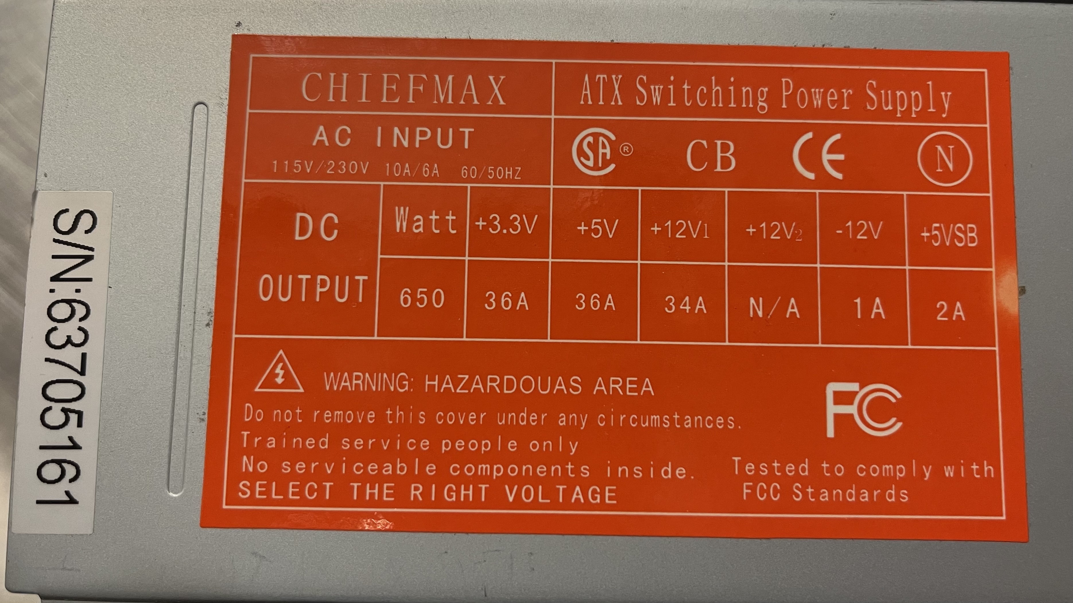

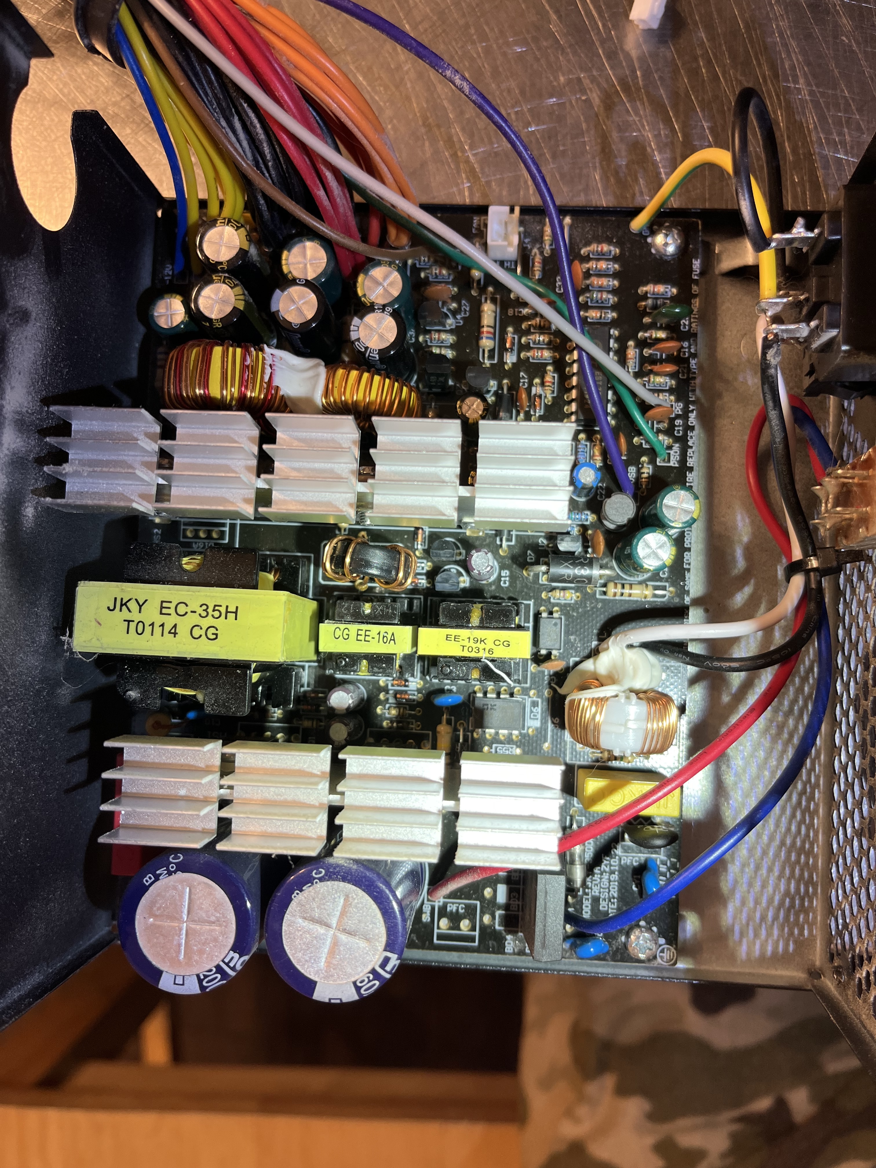

    I’m looking for some advice troubleshooting an old Chiefmax 650w power supply in a PC, if it’s advisable to dig into it.
    Worst case I can replace the PSU, I’m just interested in learning the troubleshooting process. However, it’s out of my area of expertise and I could use some direction.

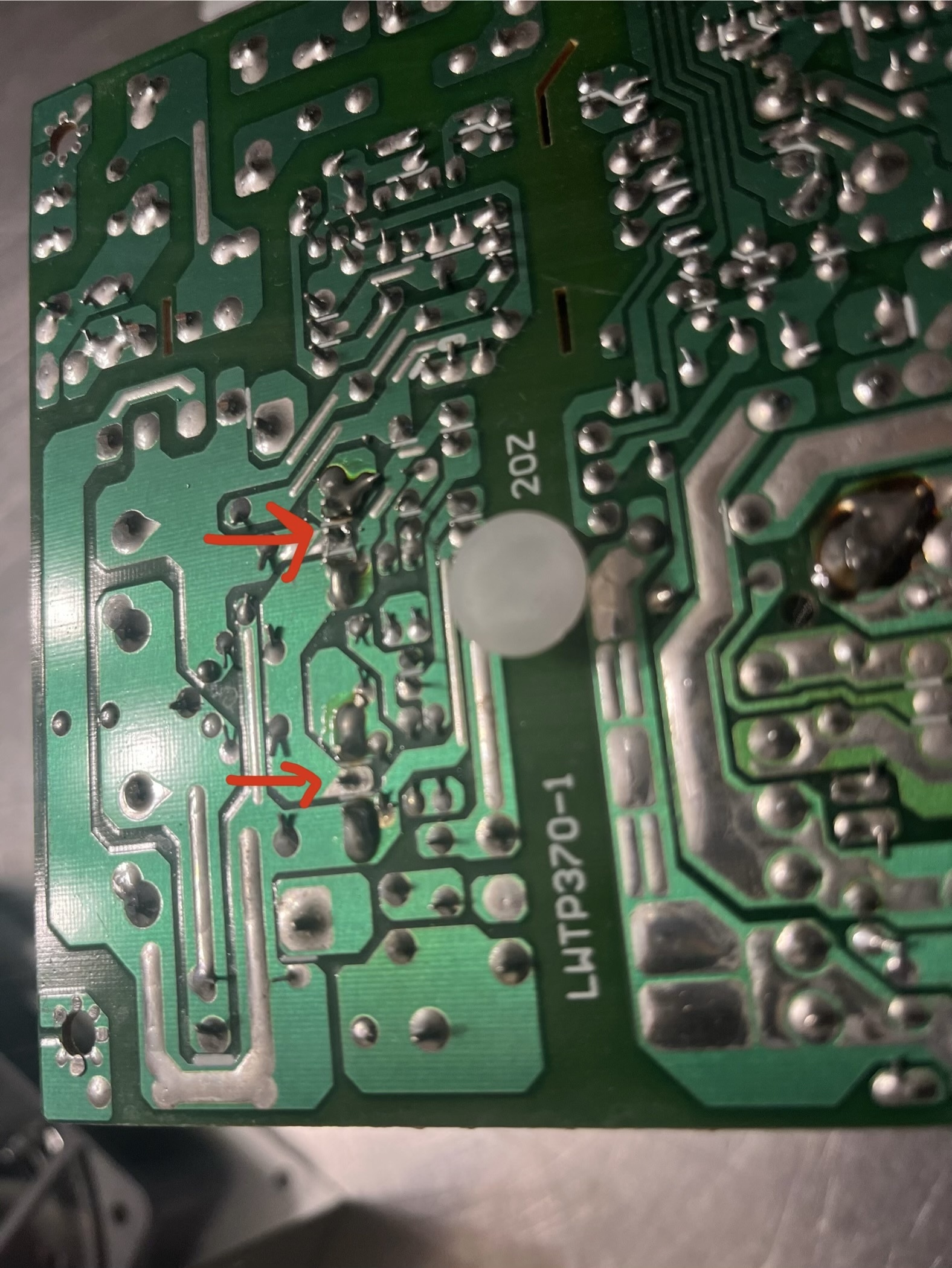

    During PC operation I heard a loud pop noise, like a cap gun and the tower lost power.
    Initially there is no power output 3.3v, 5v, or 12v when jumping the power on pin to ground. Also, no fan power.
    Opening the PSU the only things visible initially are what appears to be solder blown off the center pin of 2 transistors KS13009 on the back of the board, and some brown discoloration as evidence of excessive heat on a rectifier MOSFET U20C20C on the other heat sink. See pics.
    My plan is to remove the heat sinks to check them off the board. I wanted to check and see if there is any other diagnostics I can do as far as tracing power through the board before I do that. Is this typically the problem or just a symptom of another issue?
    Thanks.

    • 31289
    300-350w generic psu,
    check the fuse and black thermister in front of it - it looks split.
    nice setup btw - AMD JackHammer - same as one of mine

        • 31289
        the cpu is about 120w
        i dont know what the gpu needs.
        it's 100% an old 350w psu,
        infact it has hardly any output caps and no input filters!
        if your shopping for a new psu - dont buy any with a 110/20 input switch, it's a sign of an ancient design
        get one with a universal 100-250v input

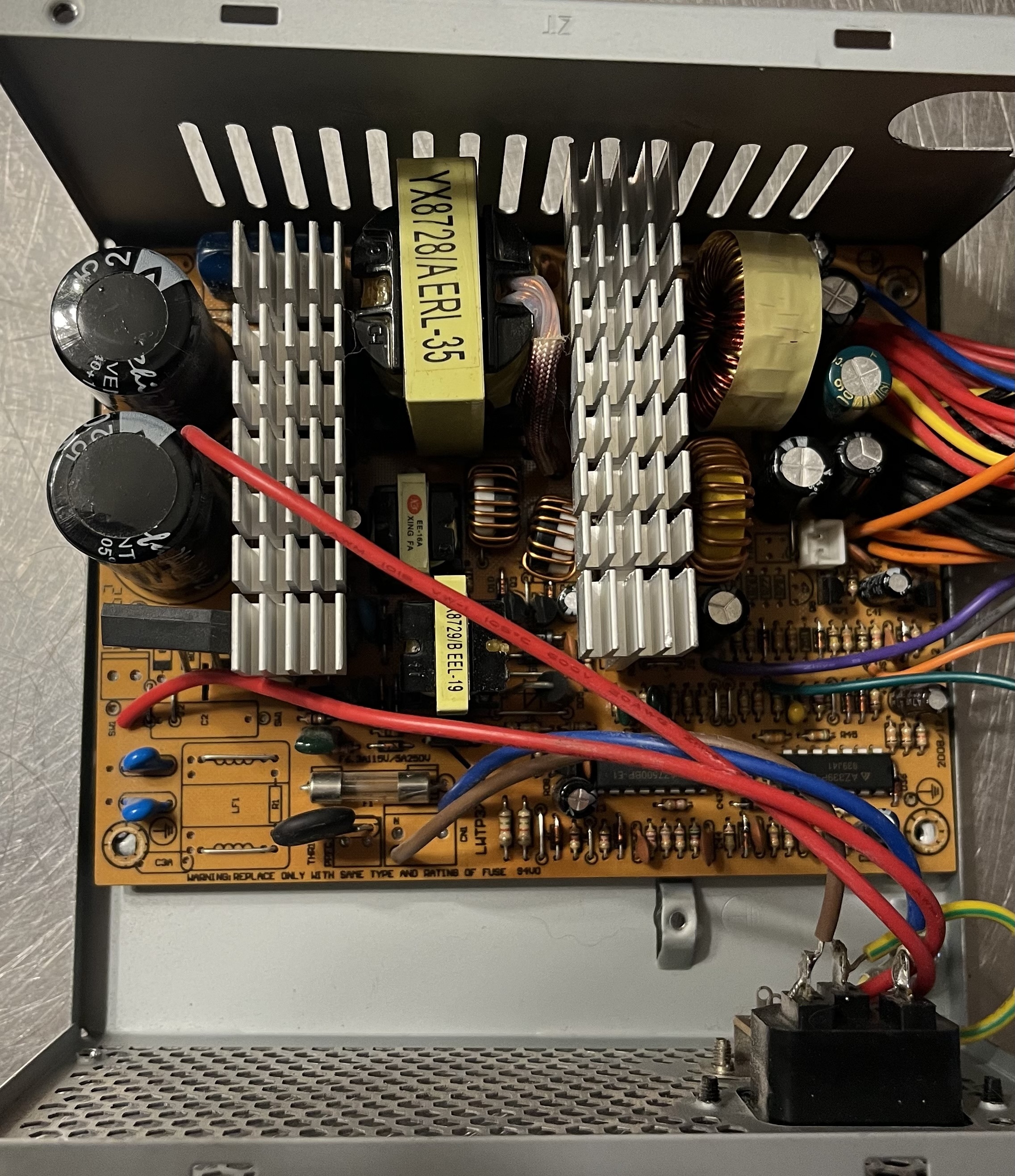

            I’ve attached pics of the following:
            The original 650 chiefmax
            The 450 replacement Venus
            The factory original 300w HP PSU
            (obviously too small and not compatible as far as output connections at this point. It does seem to have much more input and output components on the pcb.)

              • 31289
              lets see inside the Venus.
                ^This, I built a similar system years ago (and FX8320 and GTX1060) and it ran just fine with a 400W PC Power & Cooling Silencer MKIII (re-branded Seasonic S12II), so a "real" 450W unit would be fine, but many "no name" units (and some "major brands" as well) don't come anywhere near their rated capacity.
                I.E. This "500W" SolidGear unit I looked at a few years ago that could barely handle 300W before dying (and being way out of spec on ripple well before that):https://www.badcaps.net/forum/troubl...e2#post1440496

                    Originally posted by Zippie
                    My apologies. I meant to post the pics of the 3 I described.
                    1-chiefmax
                    2-venus
                    3-HP
                    Both the Chiefmax and Venus look like 300-350W units at best in reality (based primarily on the size of the transformer and primary caps hard to say 100% without knowing the specific components i.e. switching transistors/mosfets, bridge rectifiers, secondary rectifiers, etc.), and not much if any improvement over the original HP unit (and probably less efficient).
                    If you're in the US as you profile shows, if you're looking for a budget unit, you may want to look at something like this: https://www.amazon.com/Thermaltake-C...d=1161760&th=1
                    It certainly isn't the best quality PSU in the world (and has second-tier caps like most "budget" units) but can actually deliver its rated power and is a much better built unit with a much more modern design than those "no name" units.
                    If cost is less of an object Seasonic, and the higher-end (80+ gold and above) EVGA and Corsair would generally be my recommendations (there are of course other good options as well).

                            If it's just for learning purposes, then go ahead and dig in. Otherwise, it's not that great of a PSU and hence why it blew up, but I'll cover that in more detail below.

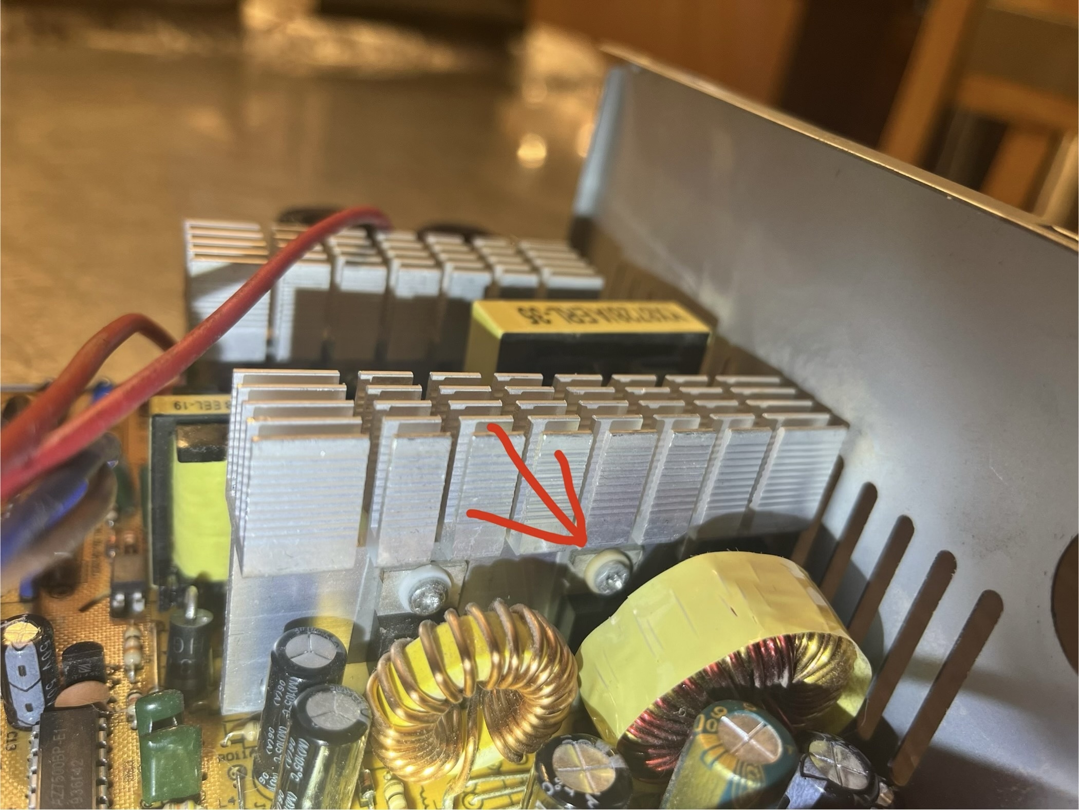

                            KS13009 are you main switching transistors (NPN type BJT's) - i.e. what makes power come to the 3.3V, 5V, 12V, and -12V rails. It's typical for these transistors to blow up in cheap power supplies either because the transistors are of questionable quality, an output rectifier shorted (it seems that some shoddy half-bridge topology PSUs cannot deal well with shorted output rectifiers), or MOST OFTEN the PSU was waaaaay too overrated and in reality could never do the Watts promised on the label.
                            As for the 5VSB, that should be on its own separate circuit and should still be functional if the main fuse and NTC thermistor are not blown open-circuit yet.
                            To troubleshoot the PSU, start by removing the two KS13009 BJTs and all small parts that are connected to their pins. Very likely you will find a pair of blown (open) low-resistance resistors, shorted diodes, and possibly more. See how I went about it in this thread here:
                            https://www.badcaps.net/forum/troubl...pcb-wf-c-rev-e
                            (Note: it's a bit lengthy in discussion, but should also hopefully familiarize you a bit more with PSUs and their components.)
                            You will also want to remove and check the U20c20c rectifier. I suspect this is the 12V rectifier of your PSU... which means the PSU was never really capable of more than 20 Amps on the 12V rail - i.e. 240 Watts. So the numbers on the label claiming the 12V rail can do 34 Amps is a complete lie.
                            Your FX8350 CPU and GTX 1060 GPU very likely regularly pushed the power consumption on the 12V rail past 240 Watts at full tilt/load. Now, most rectifiers can take quite the abuse... but they can also only do it for so long and so much. I suspect you will find your U20c20c rectifier also shorted. Of course, remove it from the PSU to confirm. If one or both outer pins read short-circuit or very low resistance (below 100 Ohms) on your multimeter, then it's bad.
                            VENUS...
                            The moment I saw that name, I cringed and knew what I was about to read.
                            No surprise that one blew too. Venus PSUs, from what I remember people posting pictures here, were pretty garbage too. Yours doesn't actually appear to be *that* bad... but it's still a 200-250W *real power* generic POS PSU.

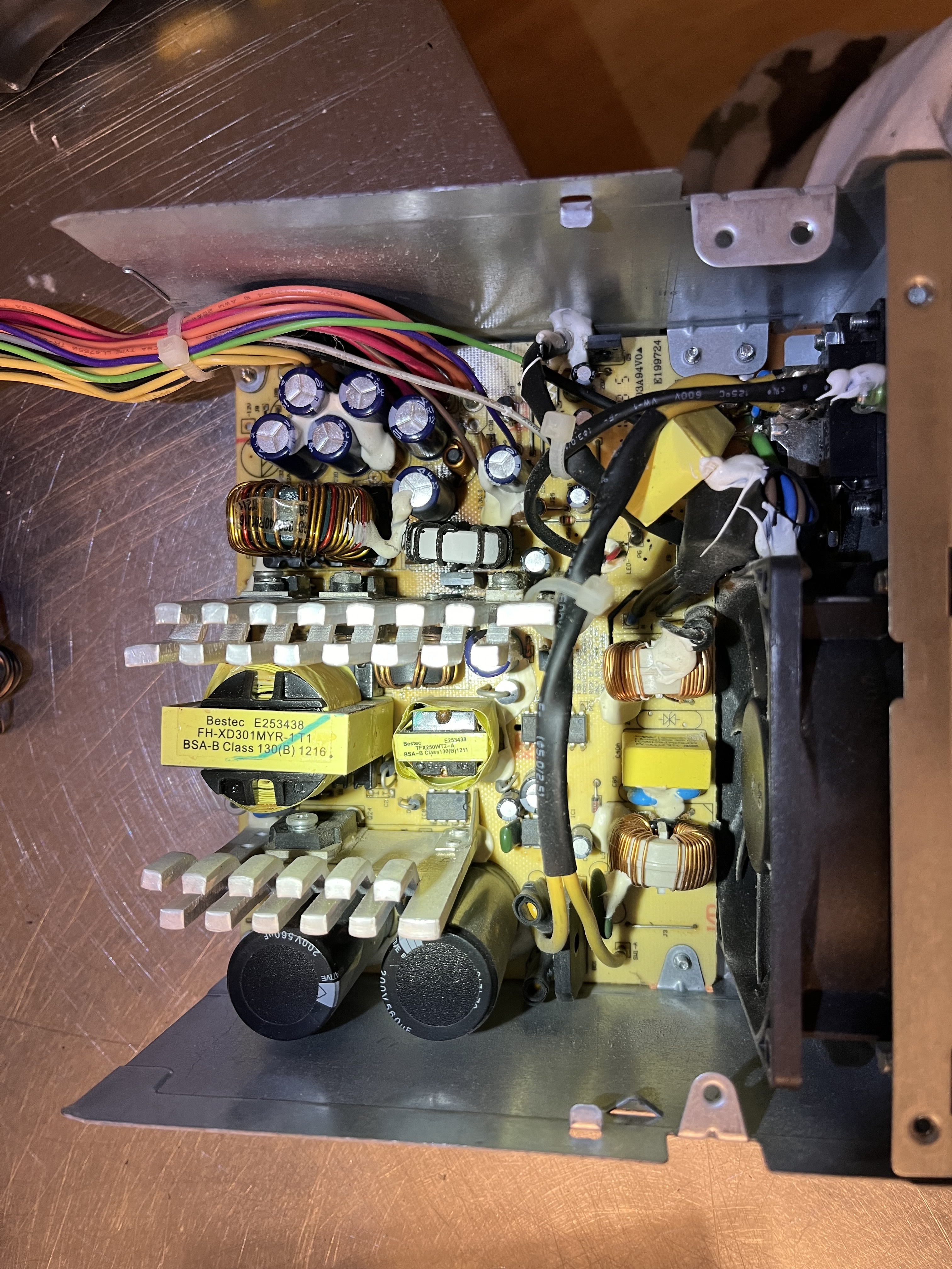

                            1-chiefmax
                            2-venus
                            3-HP
                            Between these three, I have to say the 300W HP / Bestec is clearly the winner here. It has all input filter parts installed and CAN actually do the rated output on its label - something that neither the Venus nor the Chieftec can ever do. Looks like it needs just new caps on the output and the 3.3V rail toroid replaced (something that can be "borrowed" from either the Venus or the Chiefmax PSU ). Maybe the 3.3V rail mag-amp transistor checked too. But all in all, looks like a salvageable unit. And it has good & functional protections, unlike the Venus and Chiefmax.
                            That being said, I don't know which one to put at 2nd place. Both the Venus and the Chiefmax are about on par. The Venus PCB looks a little more promising, since it has space for two output caps on each major rail, which will greatly help with lowering output ripple and noise (especially at higher loads.) It also has a complete input EMI/RFI filter. But it has a smaller transformer (with a fake "35" size label), so it's really a 200-250W max PSU (probably closer to 200W to be on the safe side.) With bigger and better caps on the output though (after it's fixed), it should be an -OK- 200 Watt PSU.
                            Meanwhile, the Chiefmax appears to have better/bigger heatsinks and bigger main transformer, so it may be able to handle slightly more power. However, the fact that there is only ONE cap on each output rail is very concerning. Very likely, it won't be able to keep the ripple & noise in spec above 150-200 Watts load, if even that much. Perhaps if you really over-size the output caps (i.e. install 3300/3900/4700 uF or higher capacitance parts) then it might have a better chance of providing cleaner power. It's also missing the input EMI/RFI filter components, so you would have to add those too. On that note, the little blue "safety" caps in the lower-left corner are regular 1 or 2 kV ceramics and not proper safety Y2-class caps. This is a no-pass for safety regulators. They need to be removed and replaced with proper Y2-safety caps.
