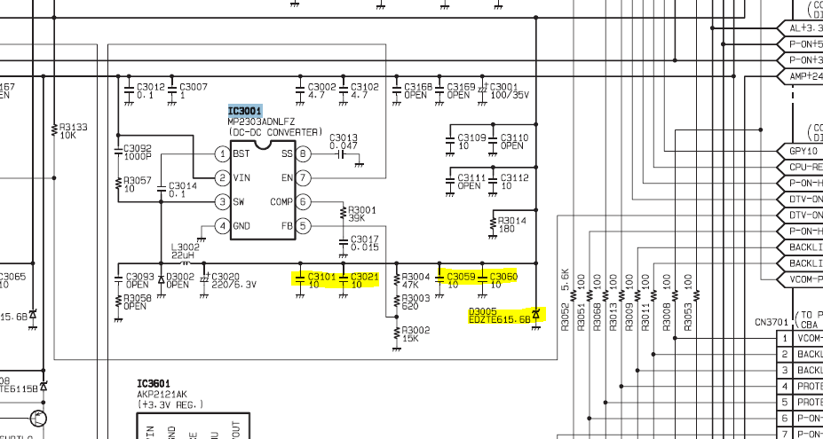

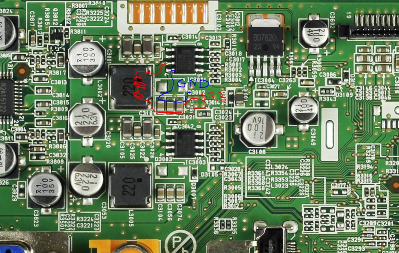

                        #91
                        Re: Emerson hdtv troubleshooting
                        Found out that P-ON+3.3V is shorted to ground on the main board (2 ohm)

                          What is your TV model number?
                          https://www.shopjimmy.com/emerson-a1...-main-cba.htm#
                          Is this your board?
                          I do not any pin out printed on the board for the P-ON+3.3V.

                            Magnavox 32MF301B/F7
                            Board looks similar with 4_1 at the end instead of 5_1
                            there is no any markings on the board
                            P-ON +3.3v is produced by IC3001 on the main board, see page 45 on the manual on the link above

                              checked the MLC caps and the diod and the're good
                                #95
                                There are lots more caps connected in parallel to the PON-3.3V, some of them through the small inductors, not just what you have highlighted if look thorough the whole page, it is also fed to some other pages of the circuits too.

                                  Yeah it's spread over the board, unfortunately I don't have a thermal camera
                                  No idea how to find the short.

                                    P-ON 3.3V Source and filter caps.
                                    How many Ohms do you get on that line?

                                      2.0-2.1 Ohm

                                        It is going to be fun trying to find out which cap is shorted out, there are so many MLCC connected to that line.
                                          I'll try to remove inductors
                                          so it is not after L3026 and L3019
