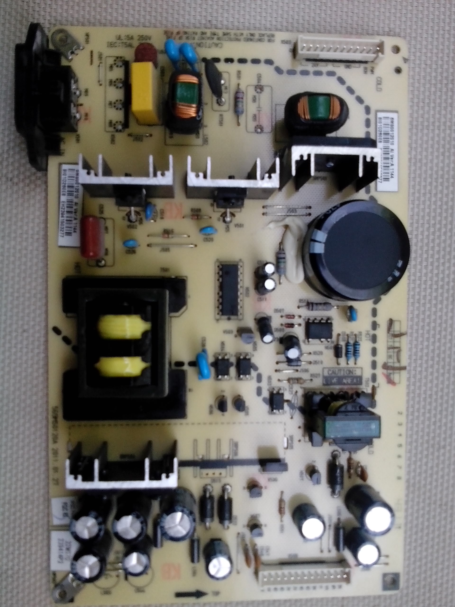

    I recently had an electrical storm come through my area here and lightning ended up frying 3 of my hdtvs.. 2 of them dont have any power at all when I try to turn them on(Dynex 32 in hdtv & Emerson 32 in hdtv) . My buddy troubleshot it some and he had said that the power boards in the tv look ok and he thinks I should swap out the main boards.Before I do this though I was going to ask here.It would seem to me though that if I have absolutely no power at all(including no standby light) that the card that would be bad would be the power board but I'm not an expert on this as it is my first foray into tv repair.One other thing:I do have reason to believe that the surge could have come through my satellite line to the hdmi cable,but I also had a circuit breaker tripped in my house circuit box so I dont know for sure.Any help is appreciated..thanks
    Ps--model nos..Dynex Dx-32L220A12, Emerson LC320EMZ

    check smd fuses on mainboards. check for stdby power. dont be so quick to throw parts at it.
      Re: dynex hdtv/emerson hdtv troubleshooting
      Do you have Digital Volt-Ohm meter? You need to at least check the main fuse, if it is OK, then you need to see if you do have any DC voltage at the two legs of the main filter cap in the primary side of the circuits.

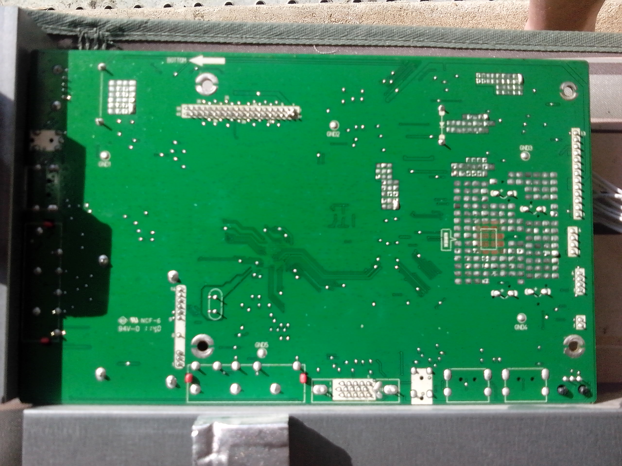

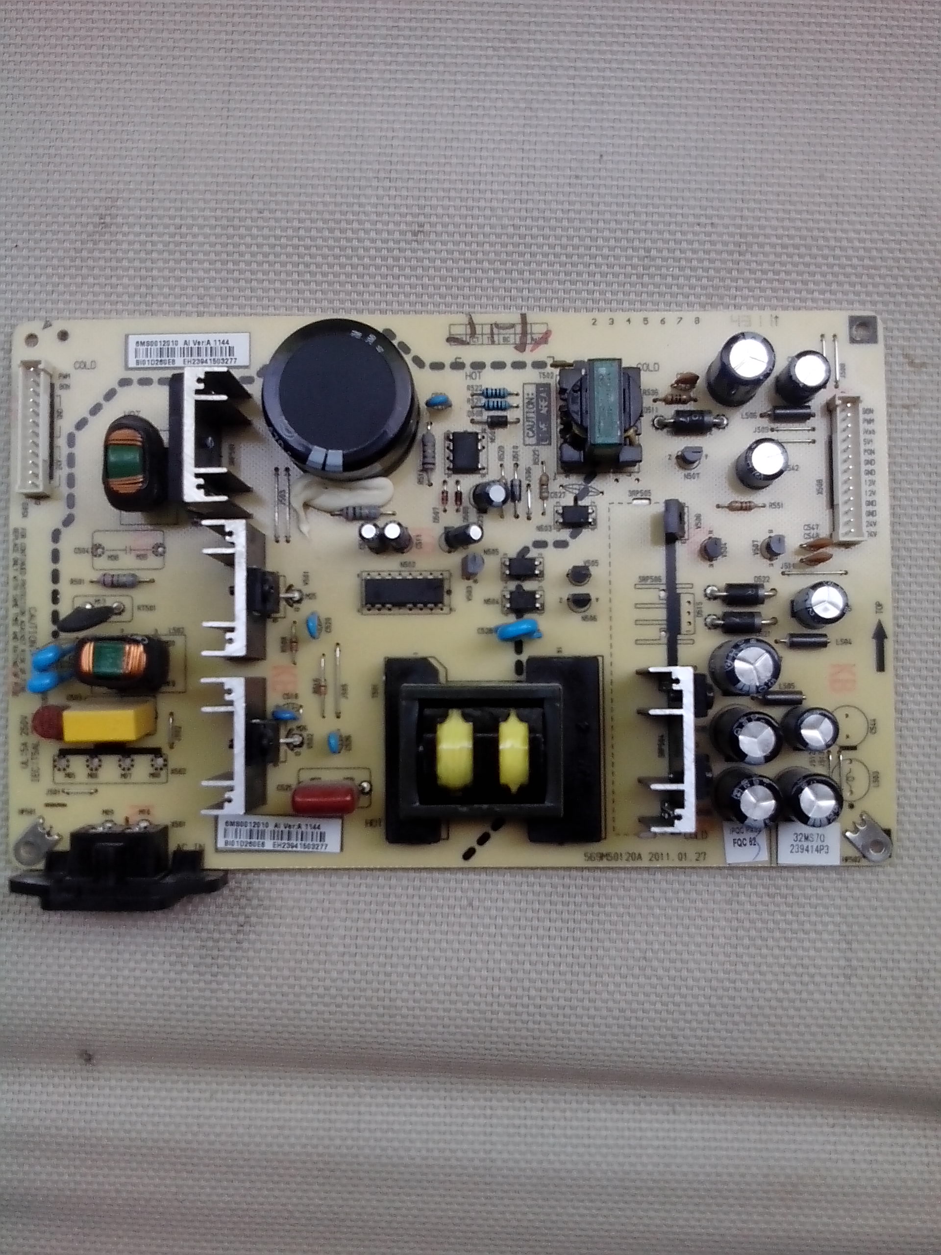

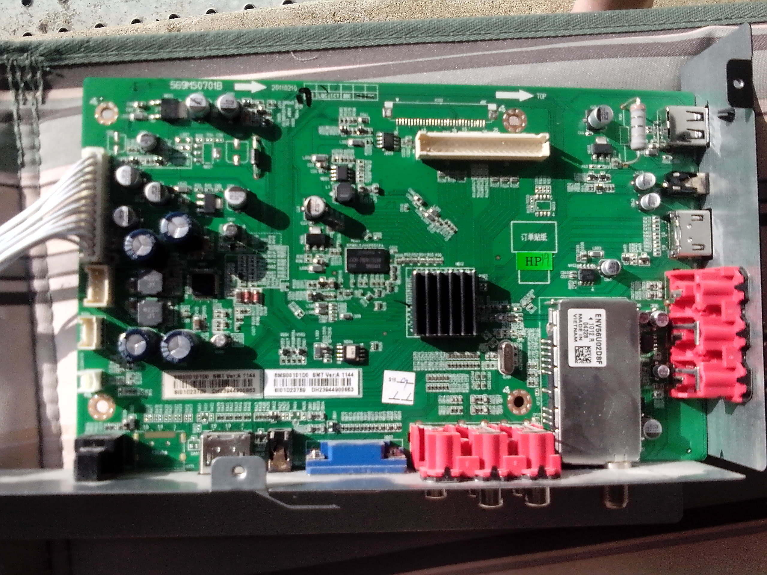

            I wanted to start on the dynex first...I will be uploading the pics of the main board and the power board..as of checking for the dc voltage at the two legs of the primary side,where would I check for that? Like I said I am new to that,and I was going to just swap out the bad card.

              forgot the pic of the back of the power board..

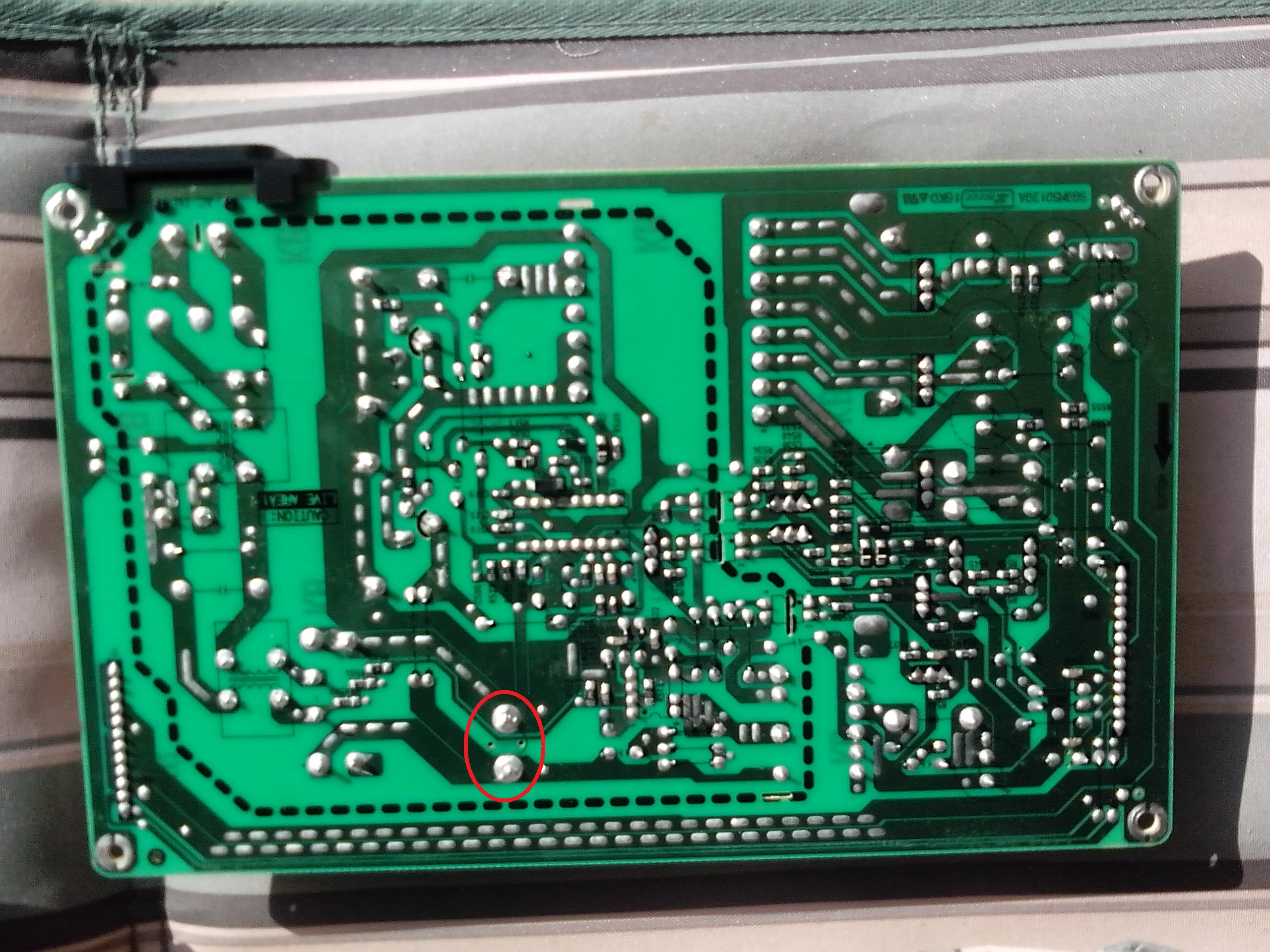

                I circled the legs of the main cap...
                Put digital voltmeter on DC scale,highest setting.measure from one leg to the other.
                CAREFULL!!!! Don't slip,high voltage there....
                What voltage do you get there?
                P.S. This cap can keep a charge,so don't touch legs even when powered off,it hurts...

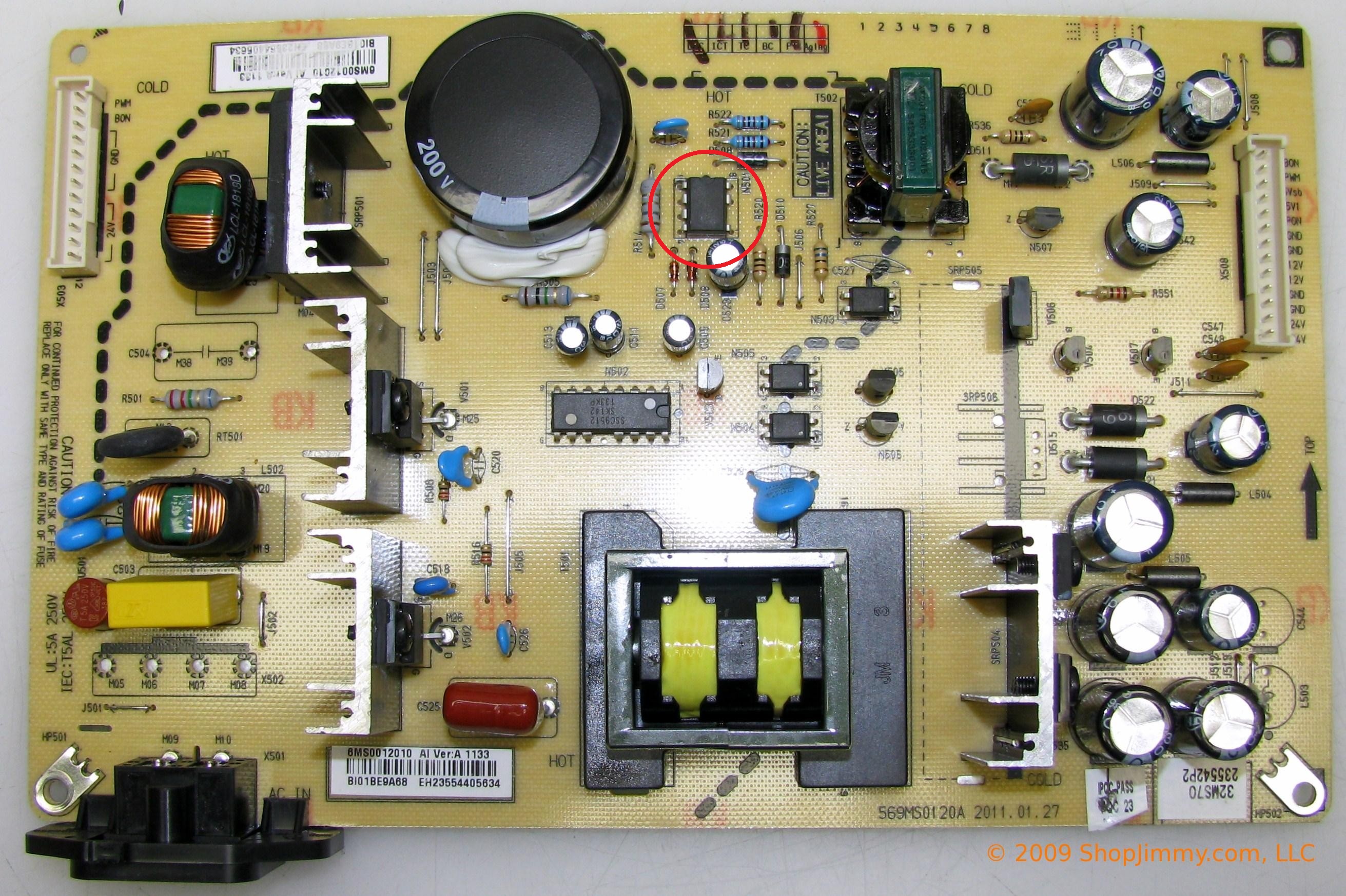

                                Can you read whats printed on N501? (see pic,I circled it)

                                    a6059h sk172 14139d
