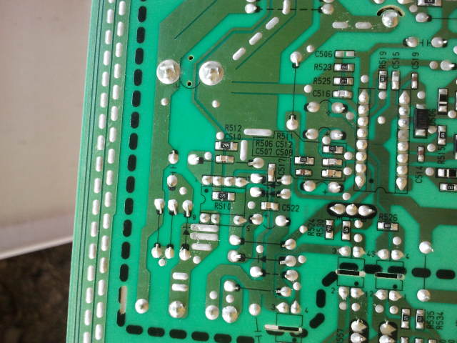

                          i have to take the pic on the cell phone...hope you can see it good.is c 528 the big black cap I tested originally?...

                            Re: dynex hdtv/emerson hdtv troubleshooting
                            No,the big black cap is the main filter cap,don't worry asbout that one
                            The one budm means is located right beside the IC you measured,if you look at the pic in post #16,it's right below the chip I circled,C528 is printed beside it....

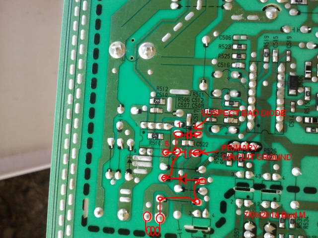

                                    That is why I request the bottom side of the board to see how that IC gets its VCC voltage from, and if it also has Zener diode in that section.
                                      #38
                                      OK, see the picture attached, see if point 1 is connected to point 5 as marked, if it is, lift up one leg of that suspected Diode then power up the board to see you will have 5VSTBY.

                                        sorry, my electricity has been out but now back on...the suspected diode is d509? You said lift it up..clip one of the legs to raise it up or melt the weld and raise it up?
                                          #40
                                          Melt the solder and lift up one leg off the board.
