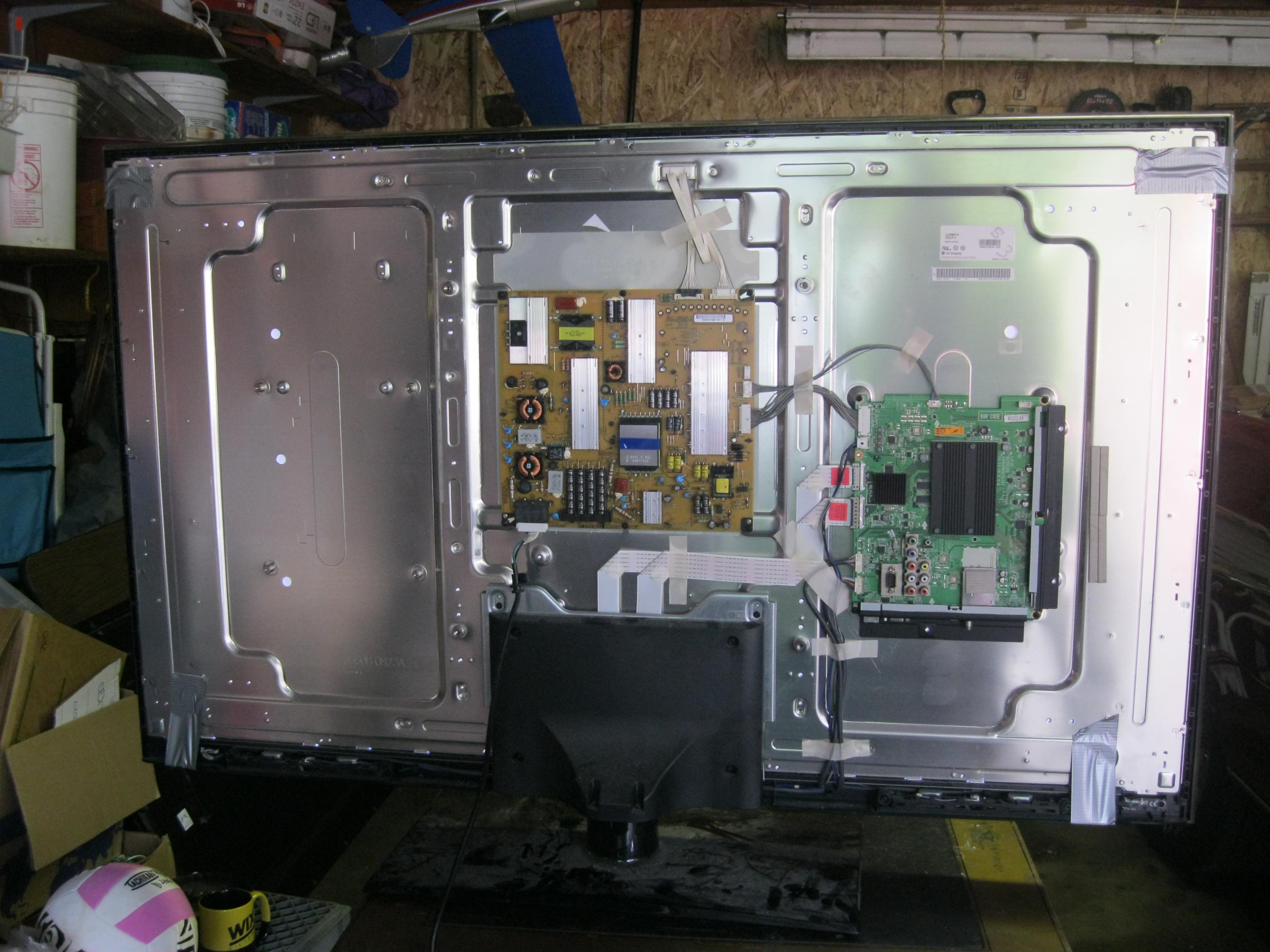

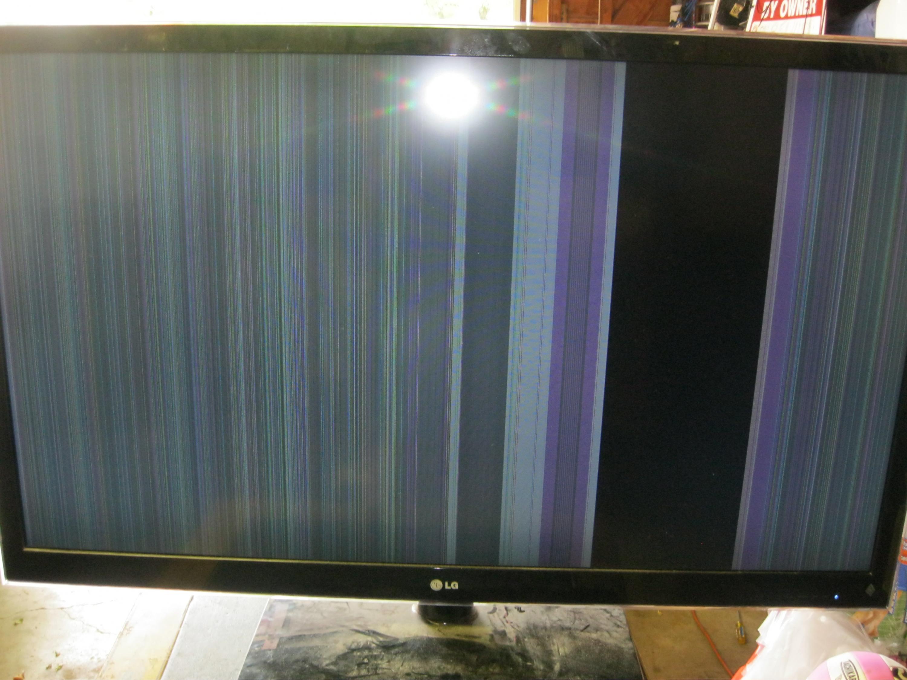

    I have this LG and the story is basement flooded but no water got TV but when cleaning up water some splashed on Tv in right lower corner of the front. and now this is the picture displayed and sound works..Is it Tcon or panel?:

    Doesn't look like it has a tcon, if it does it's hidden by the stand.
    I'd recon it doesn't because the mainboard has 2 ribbon cables coming from it rather than one.
    Also you said the lower right got wet, in this tv the tab bondings to the panel are at the bottom of the tv, rather than the top.
    Try unplugging the right hand ribbon cable, you might get an image on the left of the screen. If you do it's the panel.

      tcon bottom

        Thanks Hamie there is a small board under the stand that the two ribbon cables go to,but what i have read it may not have a tcon.I will try unpluging the cables and see what happens.

          The link I posted is the Samsung engineers training manual for that set.
          Clearly shows the tcon at the bottom.
          Maybe it frightened you off as it was the original google search link
          Here is a shorter version.
