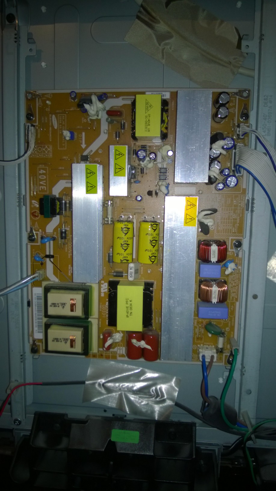

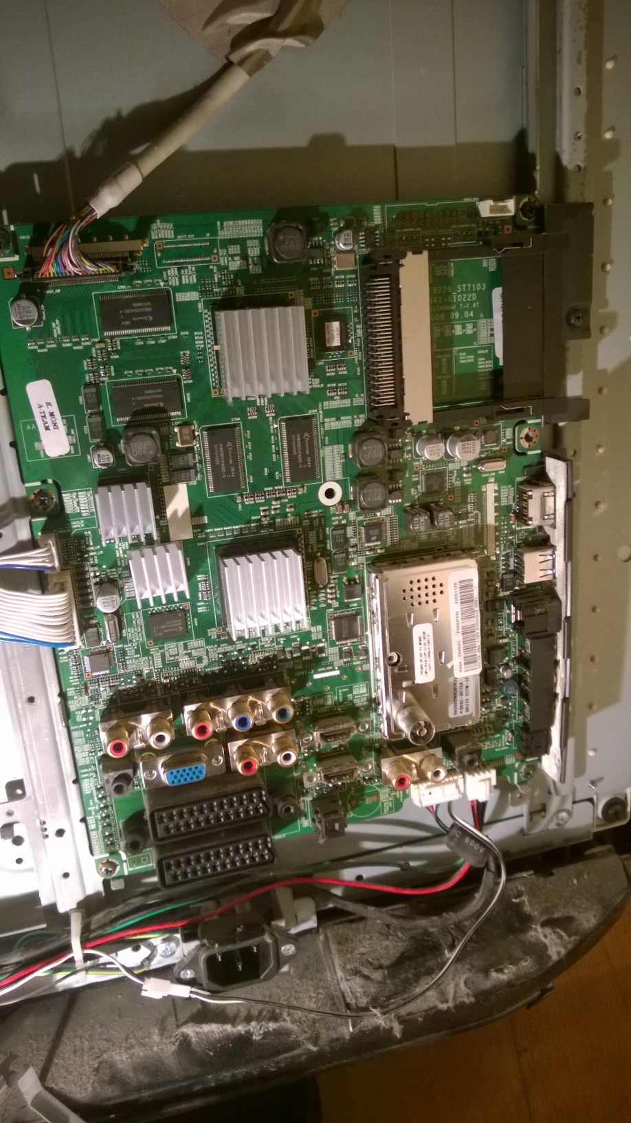

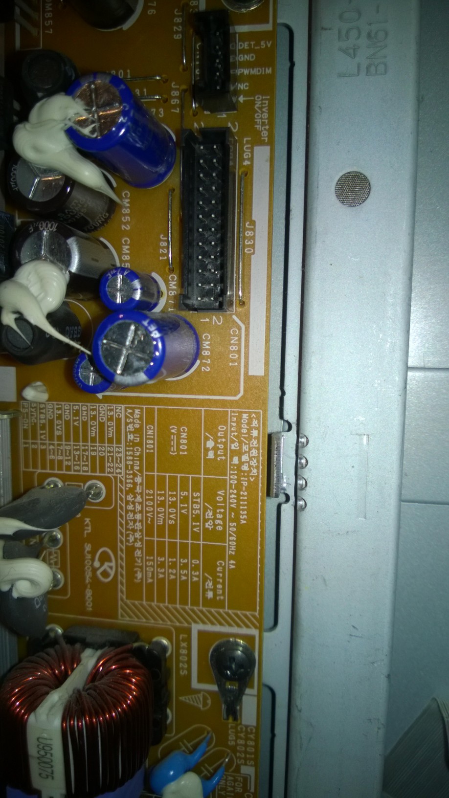

    I have a Samsung LE40A567 LCD TV with a very dim picture.
    I found that PWMDIM was low.
    I connected PWMDIM to 5V through 1K resistor, and that restored the backlights and the picture was normal.
    I could access all the menus etc, but I couldn't tune any channels.
    I assume the mainboard is faulty. What could cause the PWMDIM to go low (0,2V) ?
    The mainboard model is BN41-01022D, I can take pics tomorrow if needed.

      Re: Samsung LE40A567 - Dim picture
      Thanks,
      I removed the resistor before doing the factory reset, and now the backlights turned on even without the resistor.
      I still did the factory reset and now it found the channels too and everything seemed to work normally for a while (less than 5 minutes).
      Suddenly it lost signal, and only one channel continued to work.
      I restarted the TV and the backlights were flickering for a second or two after turning the TV back on.
      Then it was back to normal but only one channel works, no signal on the others.
          With a few rare exceptions all "LE", "LN", " LA" Samsung TVs have ccfl backlights
            Could be whatever drives it is faulty, open pullup resistor (if any), or something shorted\low resistance to ground on the line. Or like tom66 said, a software issue - and that could be caused by many things...

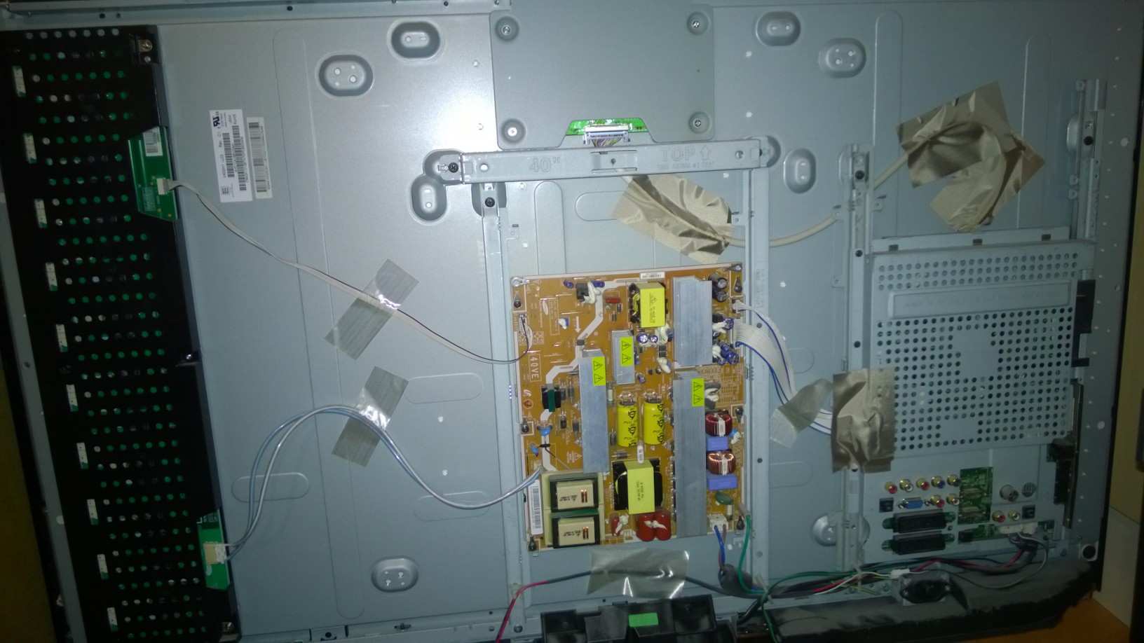

              Heres a few pics.
              It has CCFL backlights.
              The backlights work all the time now, although when turning the TV on they flicker for a second or two.
