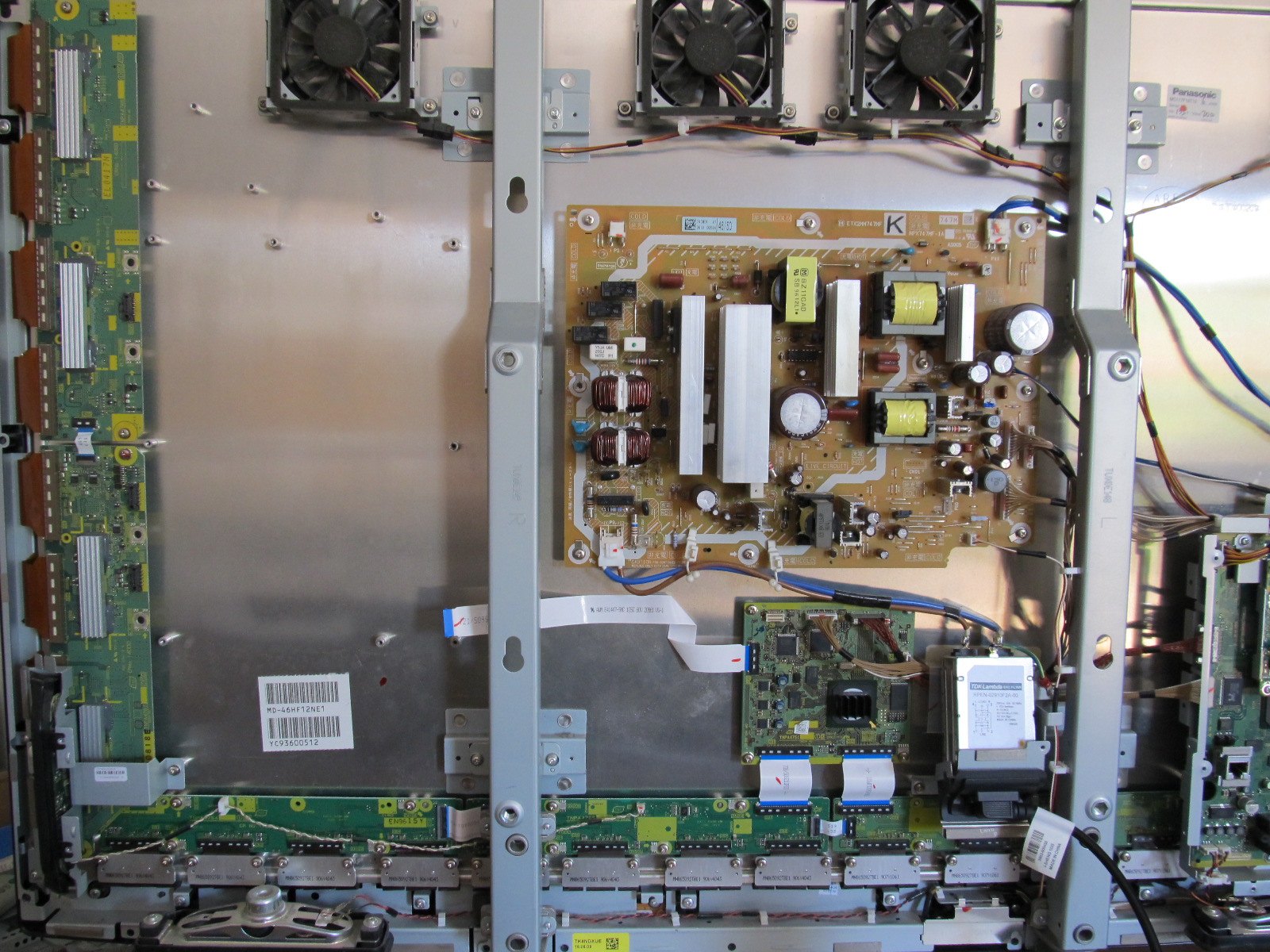

    Hi
    SC board shorted on this one. It is TNPA4782 (AG).
    I already tried once to repair it by changing shorted bits, but it gone short again right after power up. SC50 was jumpered, so none of buffer boards could kill it. Things i've replaced first time were: Q660,661,621,622,421,422,423,441,403. Also q551,702, ic773,464,465,d865. Obviously missed something first time.
    So now the IGBT's that gone short are: Q401,402,403,421,422,423,621,622 and Q661.
    R707 (3,9k) blown, q701 shorted, ic773, ic562.
    Drivers ic501, and 502 look ok, but i will change them both. ic771 com to Vin resistance around 2k, com to Vout around 6k.
    5V to gnd resistance is around 620k, and on 15V line resistance is 4.44k which is similar to someone's testing here on the forum (sry can't find the thread but i know i read that somwhere), so that looks promising.
    I plan to replace IC561,562,563. IC501,521, Q501,502,521,522,531551.
    And all before mentioned shorted things.
    Double checked all resistors, just that one blown - R707. Also went through all small transistors, they do seem fine (diode check).
    This is the schematic i've been using for throubleshooting: panasonic_tc-p46g15_chassis_gpf12du - can be found on elektrotanya if someone is interested to check it out.
    Read at least three times the whole "rebuild tnpa 5081" thread and few similar, helped a lot, and also a lot similarities between all that boards.
    So if someone have something to suggest or ask please do, i hope this time this board wouldn't go short again
    thx

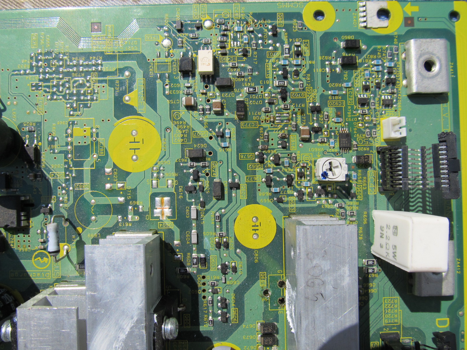

    Wow. I have to say that looks like it's heading down the path like the first board I failed , last one fixed and took about 30 components.
    Q818 is one I see omitted and was I believe what caught me out. With R707 blown I'm also wondering how far the damage has gone because on mine I ended up with a bad octal buffer IC and also I had to do the nand IC too.
    IC691

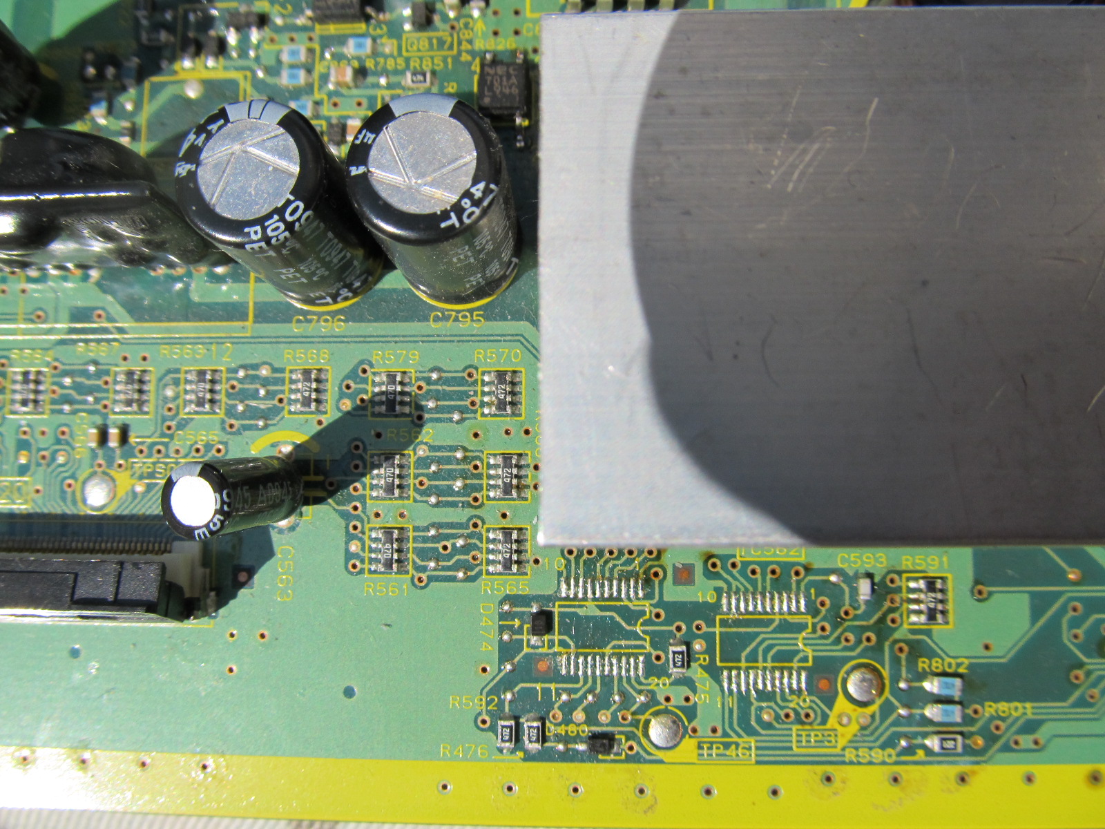

      That R707 on my opinion did blow IC562 on mine board (i believe is also octal buffer as on yours board).
      I saw that Q818 caused problems to you and some other guys, so i won't push my luck and will simply change it.
      Not all parts listed are bad, but will change them, as they are not that pricey.

              That's a good sign I guess, that's a point I got to on one of mine. One thing I am curious about was what you were thinking when you had SC2,Sc20 disconnected and jumper on SC50? The SC50 jump is to stop SOS7 detect due to a buffer removed, but you had nothing hooked up to the SC anyway, no power at all.
              Anyway looks like 7 blink issue, have a look at IC 561,562 just in case something silly has happened their with the replacement.
              was IC561,562 a new parts?
              Also does the onboard LED briefly glow before shutdown?
              Check R478 4.7k, R500 200ohm,R592 4.7k and D480
              On page 30 of the 2009 PDP troubleshooting handbook, there's a resistance check on the outputs to the buffers, can't hurt to check that too.

                  I was to scared that everything will blow up again, so wasn't very rational at time of that testing
                  IC561 and 562 are new, i replaced both of them altough just one (IIRC IC561) was bad. Resoldered them - still the same.
                  Green LED is glowing, interesting?
                  R478 is 562 and measuring 5.56k so that's good, R592 is ok, so is D480. Don't have R500 on SC board.
                  One other thing is that 3 resistors around that Q818 are showing some weird values. R673 and R680 which are 4,7k measuring 3.56k, and R777 should be 10k but measuring 4,85k. R776 is 47ohm and it's ok.
                  IC wasn't shorted, i removed it before and since i have few spare IC's i simply put new one in.
                  IC724 Vin is 5,52k, Vout 2,98k.
                  IC725 Vin 5,52k, Vout 5,935k.
                  IC771 Vin 2,05k, Vout 5,80k.
                  Does that seem ok?

                    Sorry R590, did not magnify it enough for my eyes. Check resistance between Vin and Vout especially IC725.
                    Check PC16480 opto pins 1-2 and 3-4
                    The green LED has more to do with SOS6, curious to see if it lit or not.
                    Try that SC resistance check too, just trying to find any clues.

                        I have another idea,connect the SC up without the buffers, Sc50 jumped. find D480 and measure voltage at the anode as SOS7 trips. I think 4-5V, if nothing there, repeat on the cathode side.
                        Should be able to work out which part of the SOS7 cct is triggering the shutdown(hopefully) and go from there.

                          Tried this idea with sos7. D480 anode 0V, cathode 4,5V. Went further and measured voltages on D820. On anode that is connected to R752 and Q876 i have 4,5V. Second anode measuring -0,75V.
                          D875 - cathode 15V, anode 0V.
                          Tested voltages:
                          VAD -185V
                          VSCN -40V
                          VSUS 201V
                          5V OK
                          15V OK
                          • tw2005

                                Checked resistors and diodes there and everything is in specs. Q876 had some strange measuring and since i had new 2PD601AR (needed for Q702 - bought 5 pcs) i simply replaced it. Readings after that were better.
                                So put SC board in, tested buffers once again, just a precaution. Powered set with SC50 jumpered and buffer disconnected - blinking green led went in to solid green
                                Reconnected buffers and voila - tv is on like it never was broken before
                                Thank you TW, i doubt i could solve this without your help!
