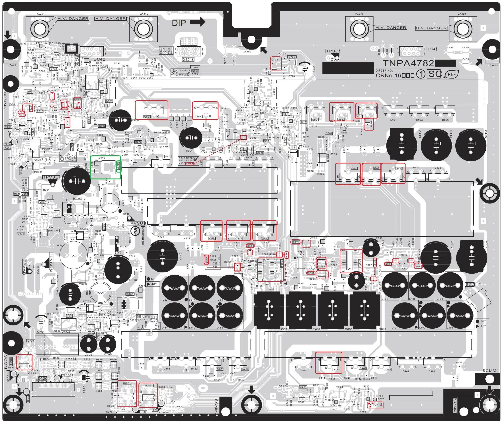

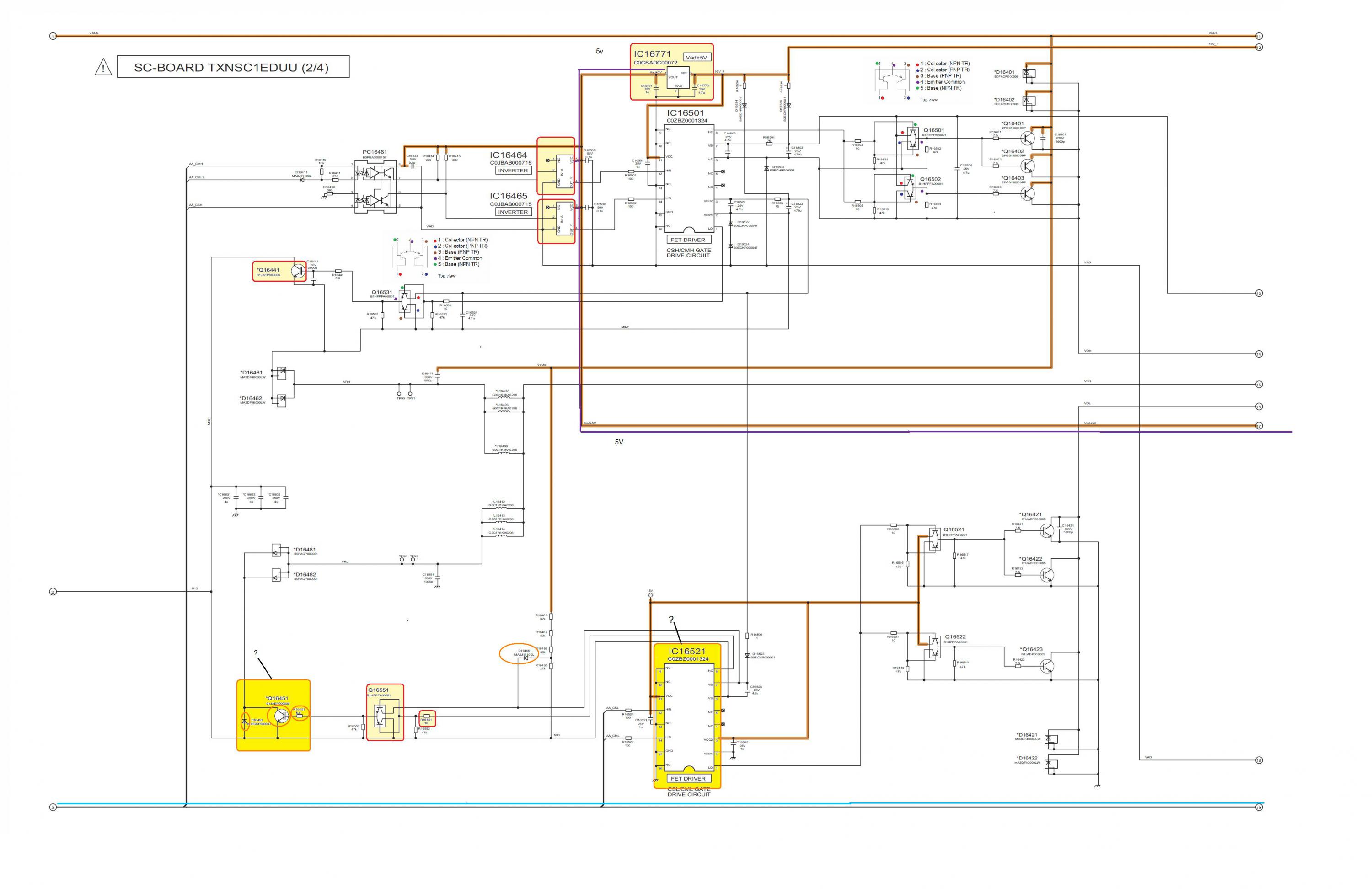

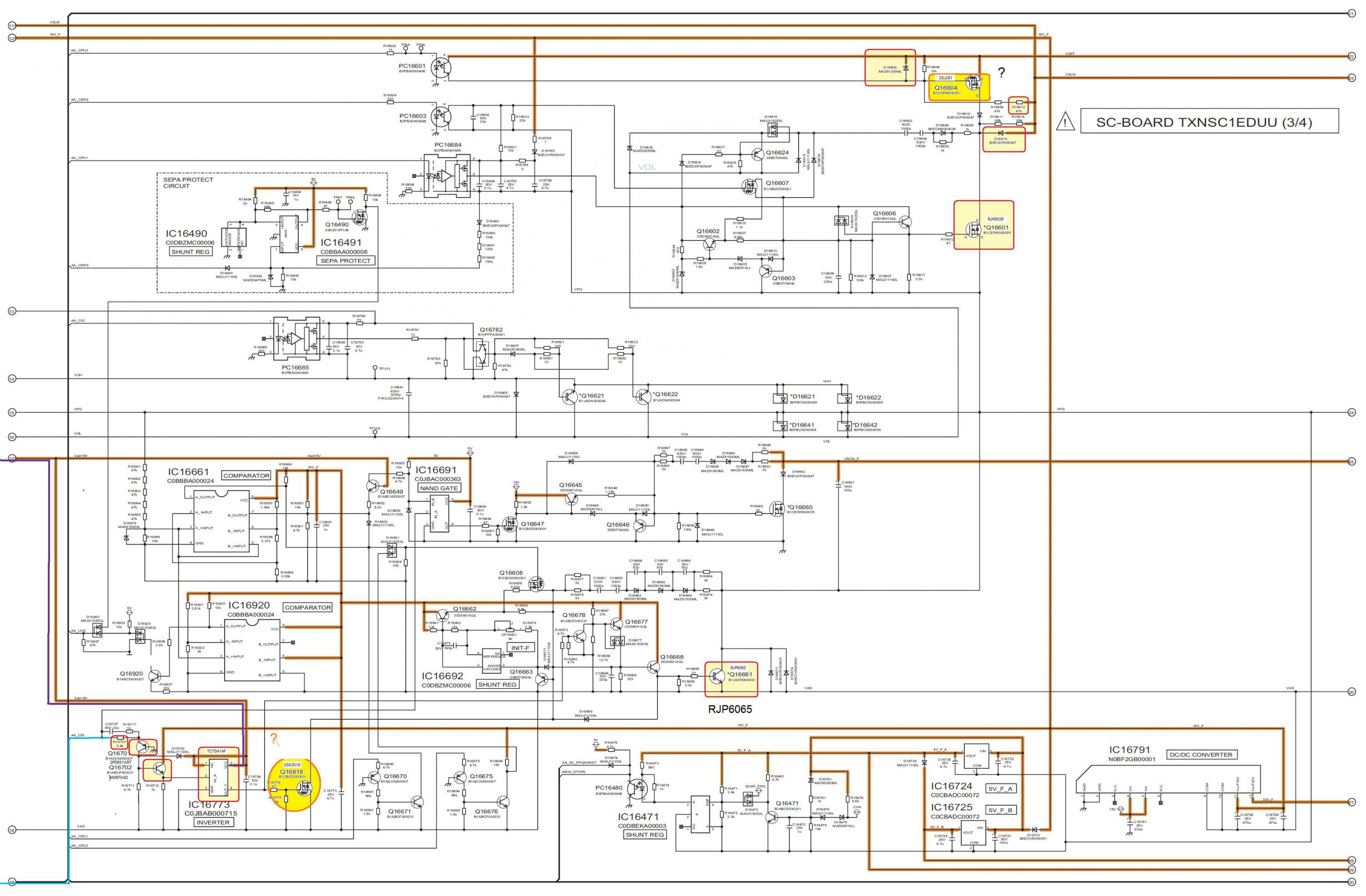

      Here's my roadmap (see attachment pdf). Circled in red are components found shorted, burned or exploded. In green are ones I'm not sure about that I'm looking at based on what you and others have found bad on these boards.
      They are:
      Q441 45G127 - shorted
      Q601 RJK6026 - shorted
      Q661 RJP6065 - shorted
      Q551 CPH5524-TL-E - shorted all pins
      Q701 2PD601ART - open, blown up
      Q702 MMBTA92 - hole in the top
      IC771 TA78L05F-TE12L - shorted
      IC464 TC7SH14F - shorted
      IC465 TC7SH14F - shorted
      IC773 TC7SH14F - shorted
      R551 open, burned
      R613 open, burned
      R707 open, burned
      D608 - open, split in two
      D618 - short, burned
      IC561 VHCT541A - Not sure how to test but seems a common failure?
      IC501,521 M81737FP - no shorts, I think possibly they are ok but common failure?
      Q501,502,521,522,531 CPH5524-TL-E - readings below:

        Something is amiss with your table. pin 2-4 for q501,502 would = 47k ohm
        normally I check 1-5, 2-3 and on the 2010 boards i have in cct usually 3 meg or more. So I'm not sure if you are using a datasheet to figure the pins or not. there's 5 pins, #5 does not even get a mention except 3-5 short and that's normal if you look at a datasheet.

          Originally posted by tn245
          Thanks tw2005
          They are:
          R707 open, burned
          Q818 2SK3018 (KN) , follow the path of R707 and IC562 could be damaged. hard to test, check p5v resistance
          R551 open, burned
          You said IC521 had no shorts, you will if Q551 is 100% short. I'd replace those FET drivers anyway and be suspicious of the rest of that cct like Q451, D451, R451
          check the schematic and you'll see it provides 5v to several devices any one of which could drag that down. I'd be tempted to just replace everything on that path"
          R613 open, burned
          again check the cct, I'd be wary of that P-FET, Q604
          also wary there are no 2pg011 or the 30g123 mentioned as bad. I would test resistance between the legs(all) they can fail and still have 200 ohms which continuity check will not beep to show short

            Re: Panasonic TX-P42G15

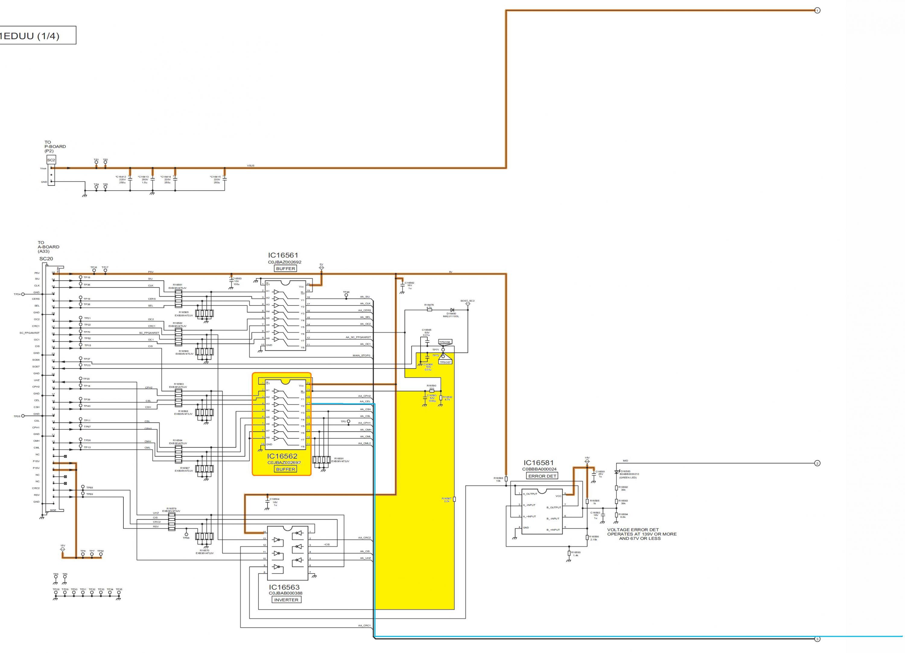

            marked what Hombre has mentioned. i think with yours I would assume you're not the first person to attempt repair with R707 blown and so expect more than normal damaged as per what Hombre did with his. if you look at the paths from r707, IC562 & IC691 most likely have taken a hit since it blew apart.
            so it'd be a matter of adding what you know is bad to checking what he's done and check that p fet
            IC562 I would consider, 561,563 not so sure they would need to be.

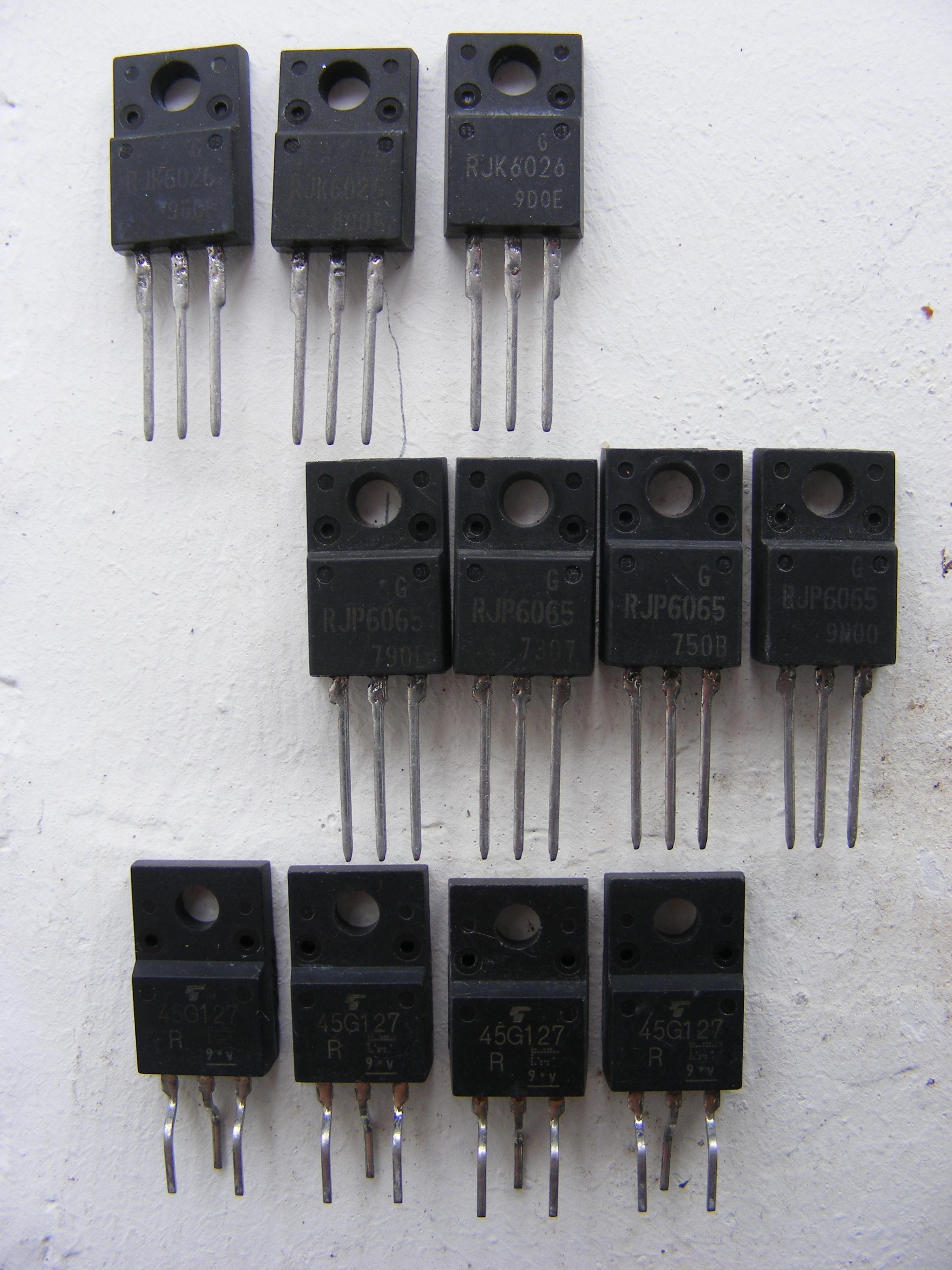

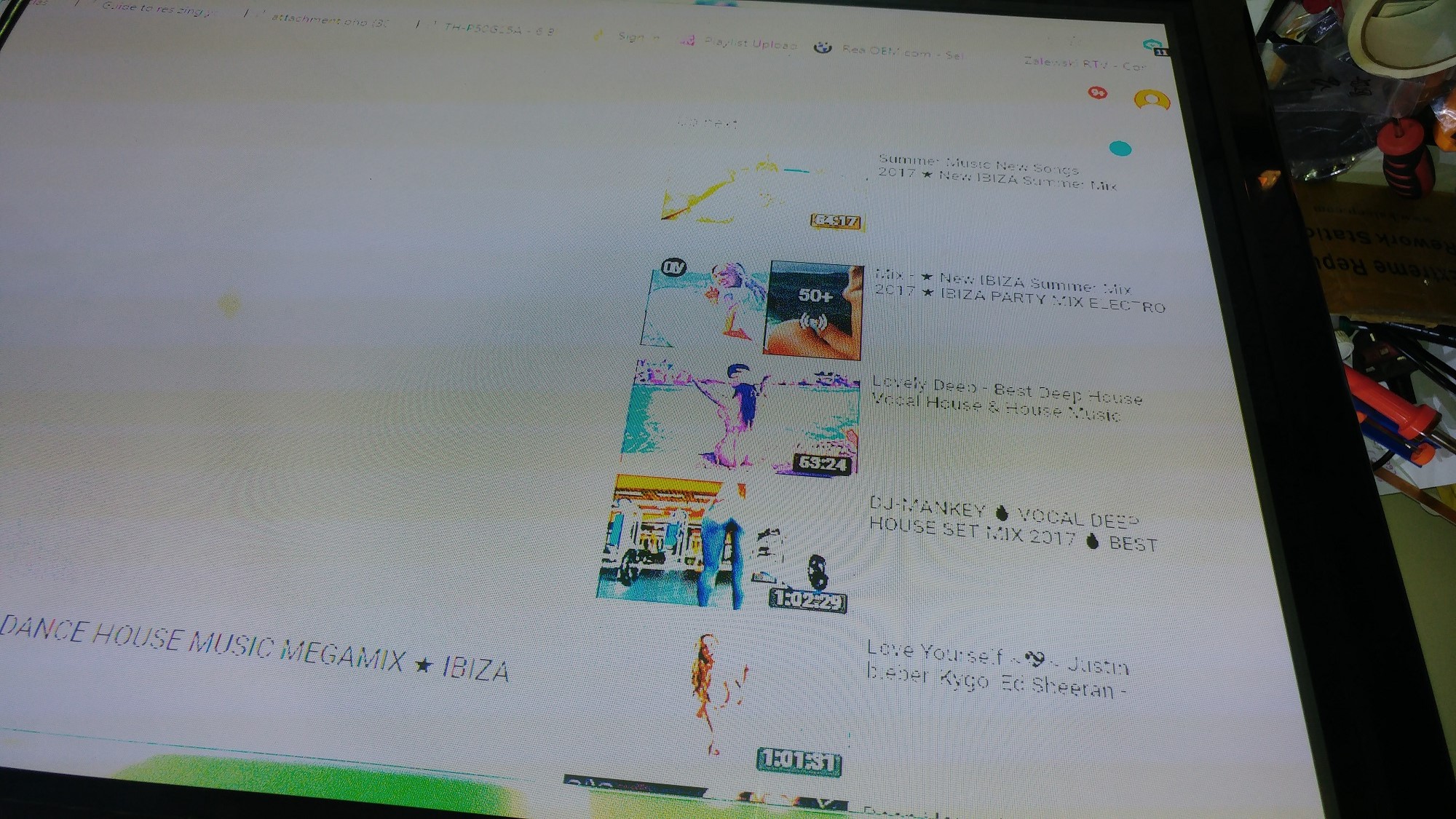

                                    I can't believe it's been more than two years since my last post on this thread and I've still got the TV sitting around waiting to be fixed. I got demoralised on it after repairing and blowing up the SC a couple of times. Am tempted to take another stab at it now as it's been hanging around too long.
                                    At the time I ordered loads of bits from utsource and got quite a few extras as they were cheaper if you order more and take ages to arrive. I hadn't heard of all the fakes by then. I'm suspecting some of my bits might be fakes now.
                                    The main thing I notice is the markings are very faint compared to the originals. Attached is a photo of the igbts I got.
                                    Where are people getting genuine parts from now? Also, is it likely just the igbts that will be fake or have people found the smaller parts fake too? Trying to work out what of the bits I've got will be safe to use. I spent quite a bit of money on all the bits back then.
                                    I seem ohmsupplies has a kit for the 4782 although they seem mixed up on model nos as they have it listed for 30 series panasonics.

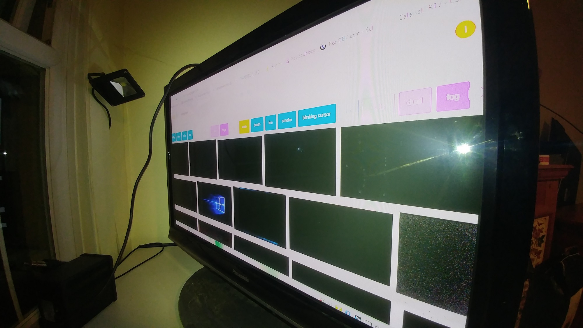

                                      Hello,After I managed to fix my sc board on this set ,is all running only problem is something with the picture .See photos please .
                                      What could cause this problem ?
