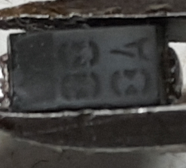

    I need to know the part number of D865. It has 88 8A markings for TNBA4829 SC BOARD pls.
    thanks
      #42
      Re: Panasonic TX-P42G15
      Ok So D865 is RF101L4S
