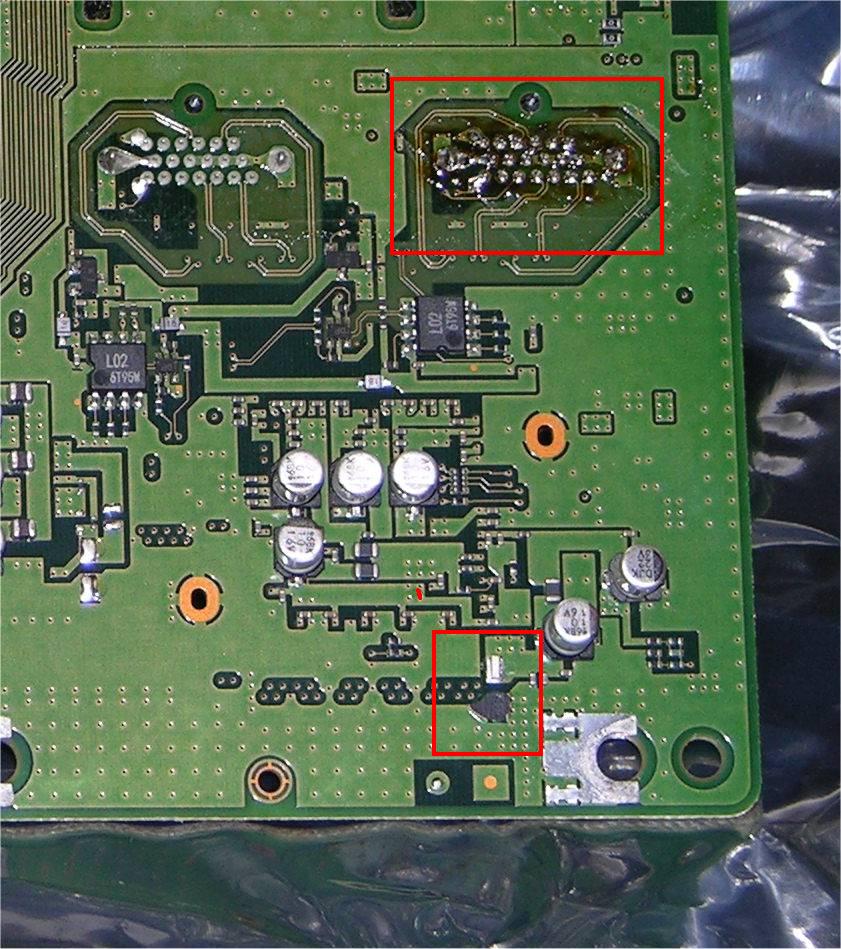

          I took a closer look at the replacement board. Please see the pictures below.
          There is is what looks to be burnt spot on the back side of where the HDMI connector is. I didn't inspect the unit that closely before installing it so I can only assume it was there from the start. Does that brown spot look like something might have been repaired? See this picture: http://i944.photobucket.com/albums/a...ackCloseup.jpg
          Also, when this item was packed for shipping there was a power supply board on the bottom and this main board was on top of it with absolutely no padding between them. There was padding in the bottom of the box and on top but no cushioning in between them. So perhaps the main board got damaged. I say this because one of the capacitors on the bottom looks to be loose while the other ones of the same type are nice and snug on the board. If that capacitor is not firmly soldered in would you expect that to stop it from working all together or just not operate reliably? Here is picture: http://i944.photobucket.com/albums/a...rdLooseCap.jpg (Update: When I put it back in the electrostatic bag the loose capacitor came all the way off)
          Overall Picture of Board - Top
          http://i944.photobucket.com/albums/a...boardFront.jpg
          Overal Picture of Board - Underside
          http://i944.photobucket.com/albums/a...nboardBack.jpg

              Re: Sony KDL-46V2500 / Blown HDMI Port from surge
              I see a someone re-solder the HDMI connector and there is a missing cap. very poor shipping. I don't like "free shipping" people will do poor packing to save money. This is the end result.
                Wow. Nice catch. I'm very impressed. I never would have noticed that. Also, looks like the top layer of the PCB board got chipped off where one of the capactior leads would have been attached. Can a cap still be attached with it being like this? I didn't notice any extra parts in the electrostatic bag so I can only assume that they missed it
                  A quick update. I bought a board on eBay from a KDL-40V2500 for about $40. I'm now back in business. Both HDMI ports are now working.
