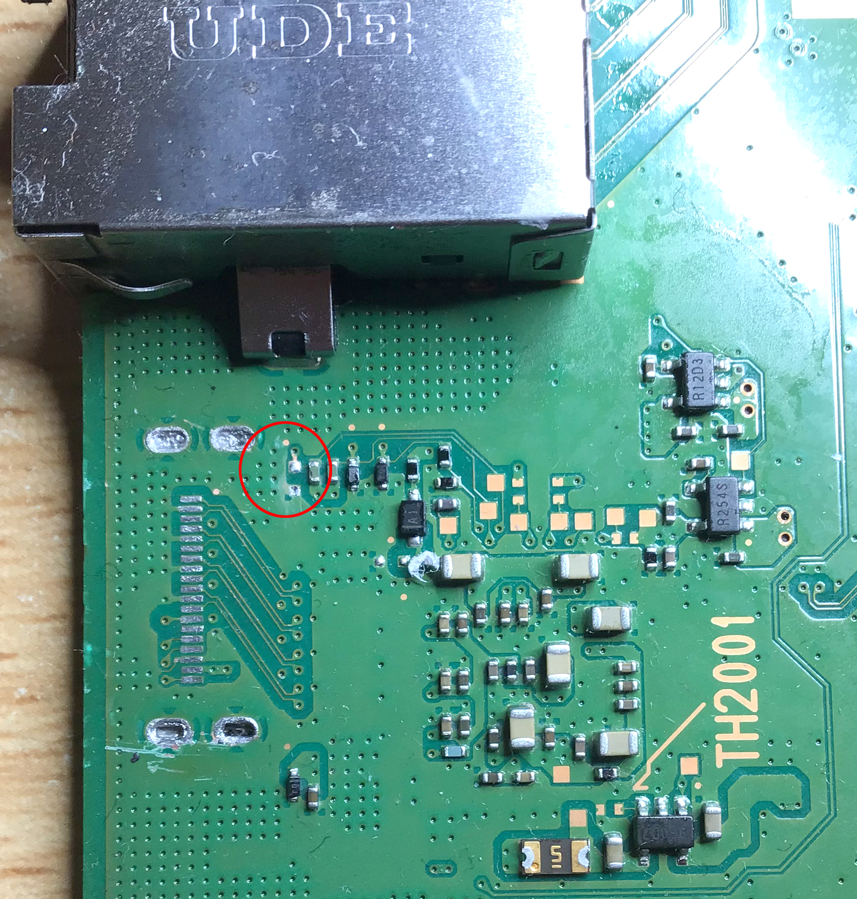

    Hi there
    A Sony PS4 came in for "No Video" and it seems there is a component Missing, near the HDMI Port.
    The Component circled in Red
    1. Was this just a Component Missing from Manufacture please?
    2. It is a straight forward Port Replacement, or do I need to be aware of anything else?
    3. Any Schematics or Board Views available?
    Any Advice is greatly appreciated.

    The missing component is a diode.
    Search diode DJ HDMI PS4 on the web

      Thankyou - I appreciate your response
      It must have broken off due to the connector being pushed in.
      I didnt see it when I opened up the unit

        Hi Elecsoluces - Would you or anybody, be able to post the correct Part and supplier I would need please?

          I see you did not search or you would have found this: CDZFHT2RA5.6B It is likely just a 5.6v zener diode used for spike protection.
