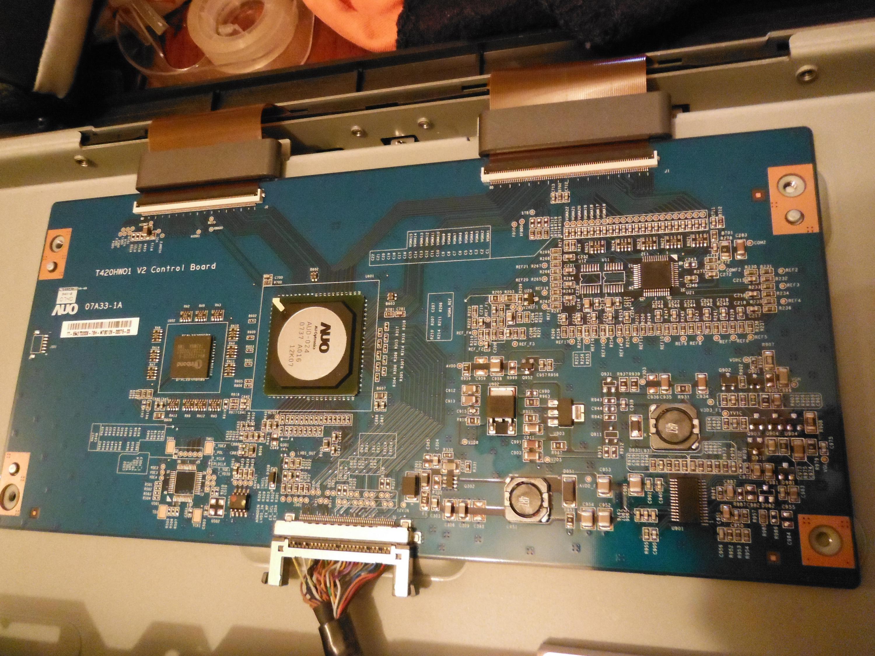

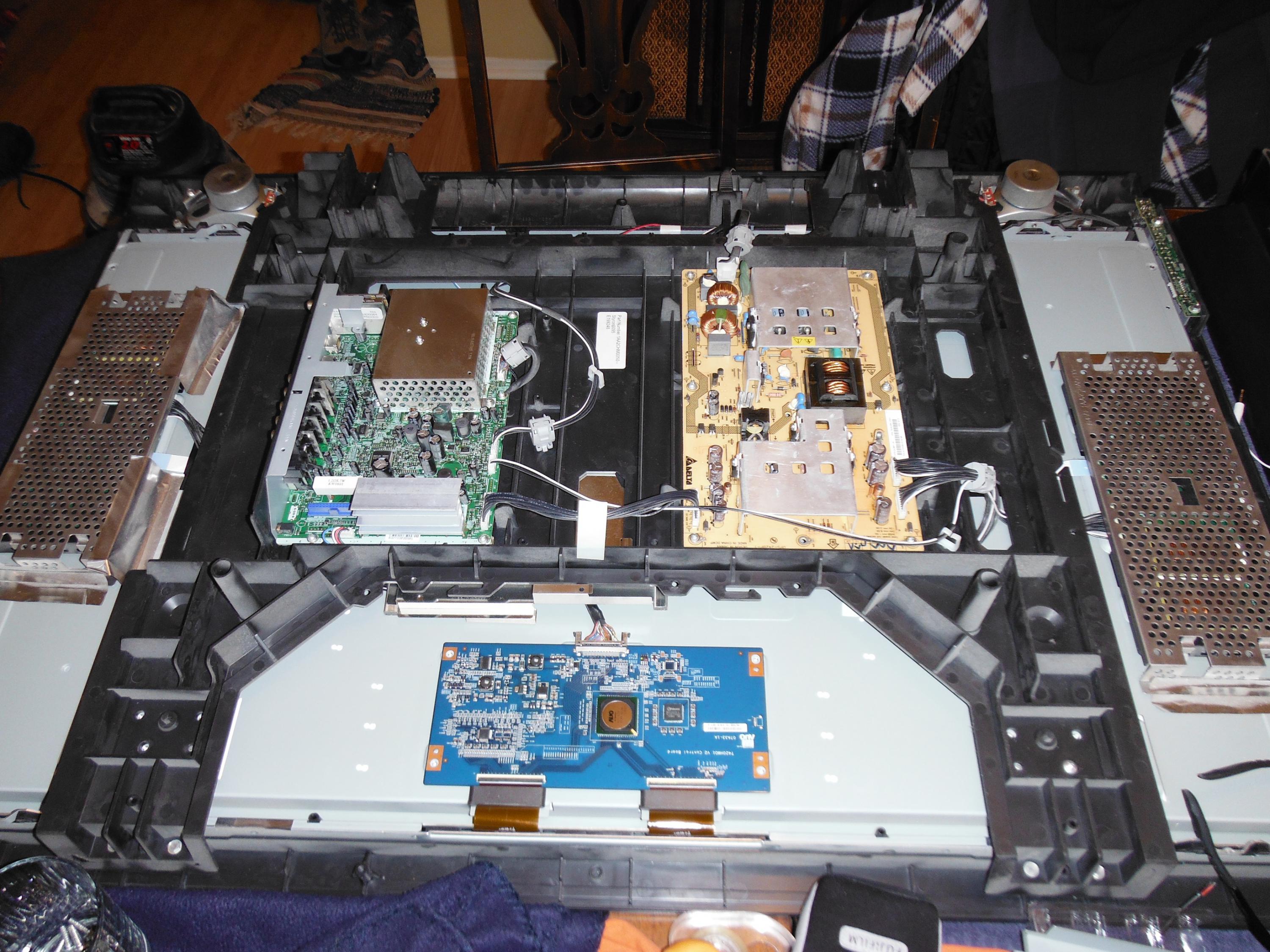

    Hi
    TV model is a sanyo DP42848
    It has a brightness problem. You can barely see the image or tv menu. I've tried resetting the colors, brightness, tint ect and still the same problem on any source input.
    Seeing i have sound, i can still see the image and the tv does not shut down and after reading some and reading some more would it be logical to suspect the t-con board t420gw01 v2 to be at fault.
    More so the ic chip as15-f?
    When the tv is on this chip gets real hot! Can't touch it for more than a half second. Is this the chip that controls brightness,color,tint ect? I beleive i read there is a way to test this with a multi meter but i am not exactly sure what to test or what the results would mean.
    Any help is appreciated as usual. I have posted some pics as well.

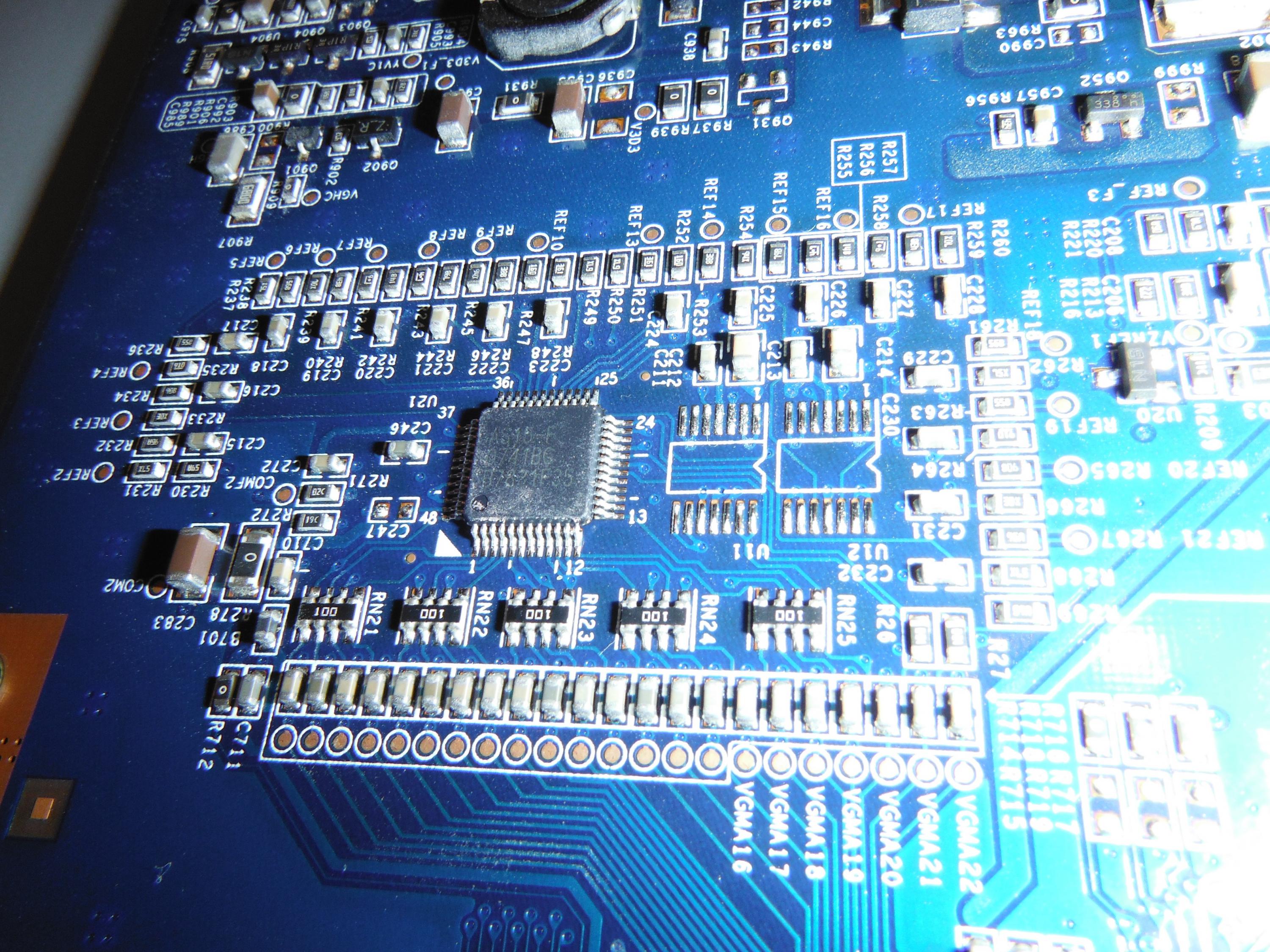

    The AS15F controls image colour and brightness, in a way, yes.
    To test it, you can use your meter to measure the points VGAMA1 through 15 marked near AS15-F chip.
    Put your multimeter on 20V mode, and test each point with the red probe on the point, black probe on chassis or other ground point. Then post your results.

        Tom66, here are the results from testing the VGMA 1-15.
        Starting with 1 and ending with 15
        5.82
        5.37
        5.37
        5.37
        5.37
        5.37
        5.37
        5.37
        5.37
        5.37
        5.90
        6.30
        7.31
        7.31
        7.28
        No idea if this is good or bad!?
          Re: Sanyo brightness problem
          That chip is definitely failed, I have never seen one that bad. The numbers normally should go from about 0V to 15V or 15V to 0V, monotonically (i.e. increase or decrease ONLY.)

              My error. If you like you can test VGAMA16 to 22 too. I was thinking of another TV, regardless though the results so far indicate it is bad.
              The chips appear to fail without obvious cause - however they do fail a LOT! When working they don't run that hot, about 45C. So it doesn't seem to be temperature.

                You are spot on! 16 through 22...
                16. 7.26
                7.27
                7.24
                7.22
                6.85
                6.83
                22. 6.87
                Ordered the chip and will wait a long 3weeks. Now like you said the hard part...! Removing the old chip. :-(

                      Ok so I received the ic as15f and swapped it out with the old one.*
                      I used an exacto and a combination of the two methods mentioned to remove the old piece. First I scored all the legs close to the ic itself and then snapped each one while rocking the exacto back and forth. Went fine until the last leg. Instead of cutting through, the pad came away with the chip. Oops! (note to self, Dont Force)
                      I ended up following the trace and soldered a wire between both points. Not so easy...those things are darn small!!
                      I should of snapped a pic or two before closing it up but forgot.*
                      Tv has been working fine for the past two days.*
