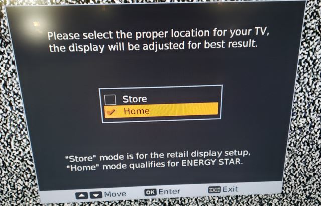

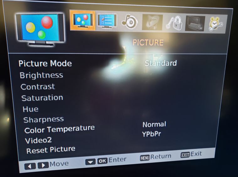

    Recently picked up a Sanyo DP55441. Set has a few issues:
    1. When I turn it on, I always have to select either "Store" or "Home" on the menu (see attachment).
    2. It forgets which input I was using last, so I have to change the input setting everytime.
    3. The controls for Brightness, Contrast, Saturation, Hue and Sharpness are not available from the menu (see attachment).
    Besides these issues the set works good, no other issues that I know of.
    I am thinking all three are related and its probably the main board. I have looked at the main board and the power board, but see no visible damage.
    Any ideas?

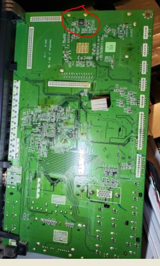

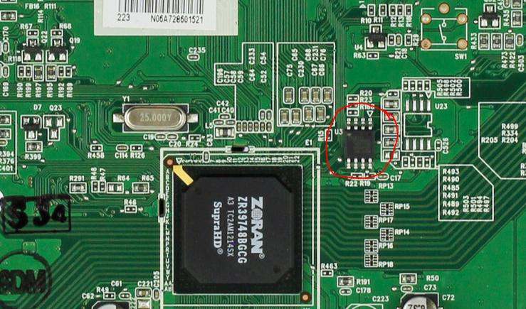

              • karthur
                • Nov 2015
                • 150

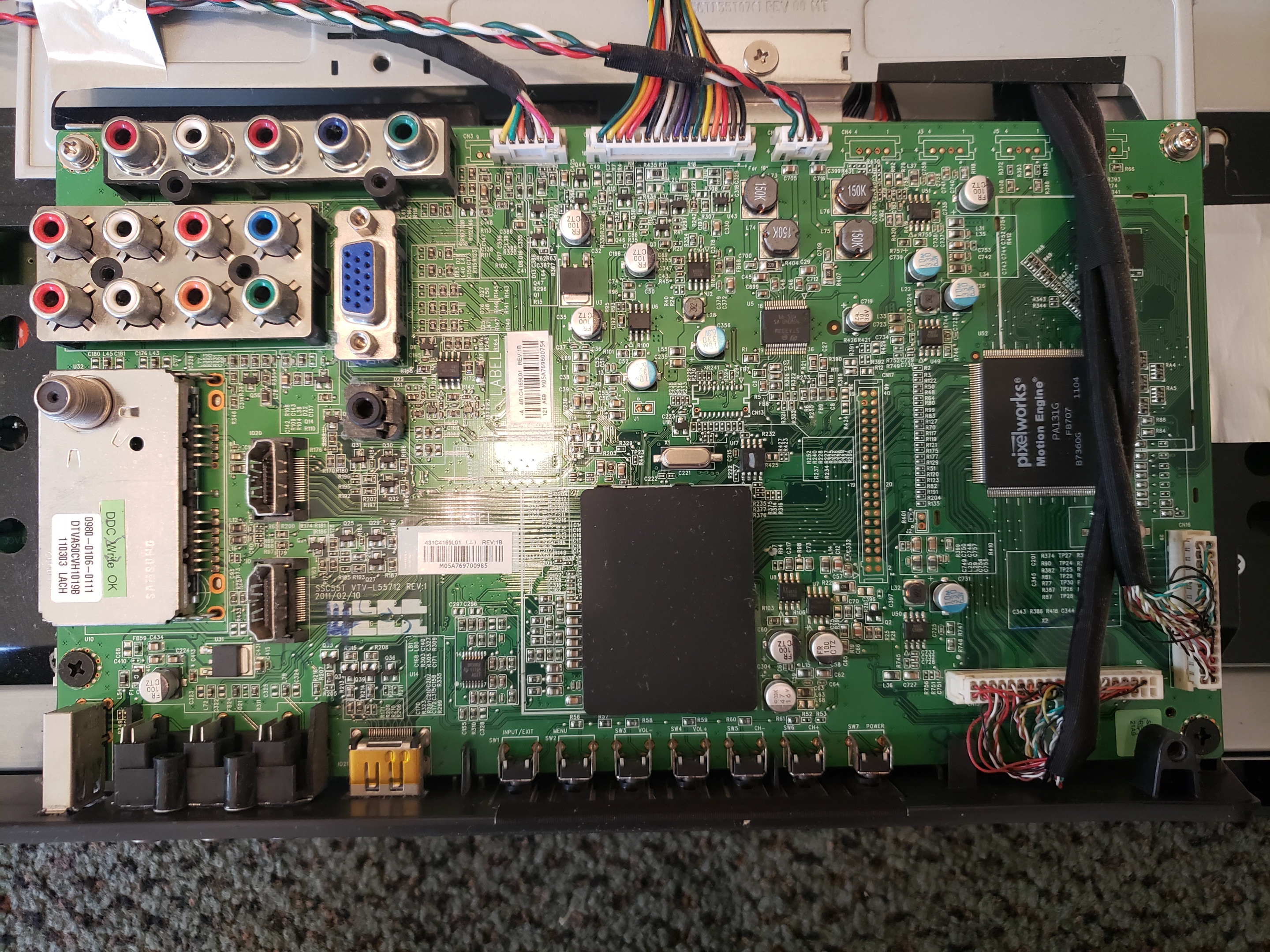

                Re: Sanyo DP55441 - No brightness control
                Originally posted by lotas
                If you have a programmer, then you need to unsolder this spi flash (from the photo of your motherboard, I no longer saw other Eeprom and spi flash). Read the contents in your memory and save the dump. Buy a new flash and load your saved dump into it and solder it in place of the old flash.
                Here is a picture of my board. There are several of those on the board.
                I don't have a programmer. Would one of these work?
                • lotas
                  • Jan 2016
                  • 4899
                  • Russia
                  If you see microcircuits on the board 24Cxx, then this is Eeprom, if there are 25Xxx, then this is Spi flash, but the markings are not visible in the photo, rather these are DC / DC converters in the Sop-8 package. As for the programmer - yes it will do.

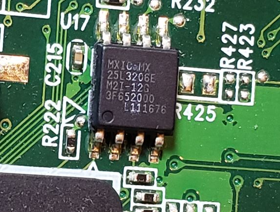

                        • karthur
                          • Nov 2015
                          • 150
                          Usually, the eeprom or spi flash is marked with a dot or a strip of paint (indicating that the microcircuit has been programmed and tested).

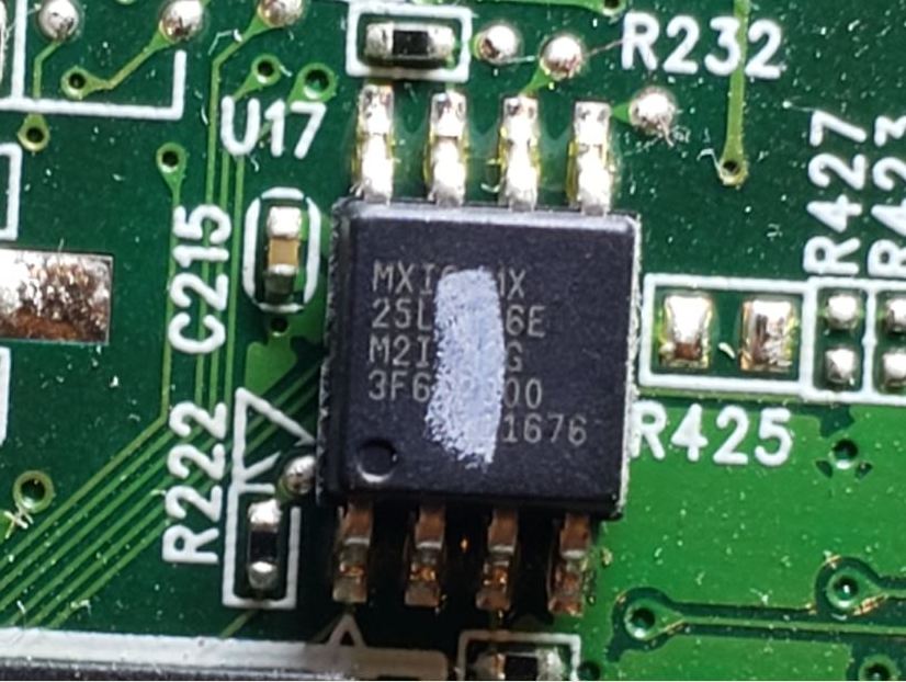

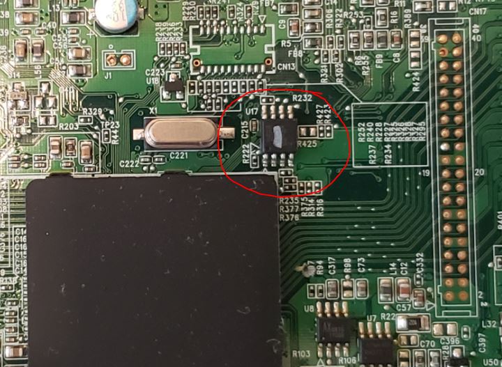

                          The only one I found with "25" on it (see attachment) and it has the paint mark. I did not see any with "24" on them. Do I need to look on back of board for one with "24" on it?

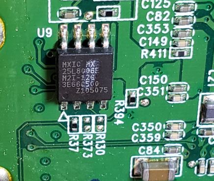

                          • karthur
                            • Nov 2015
                            • 150

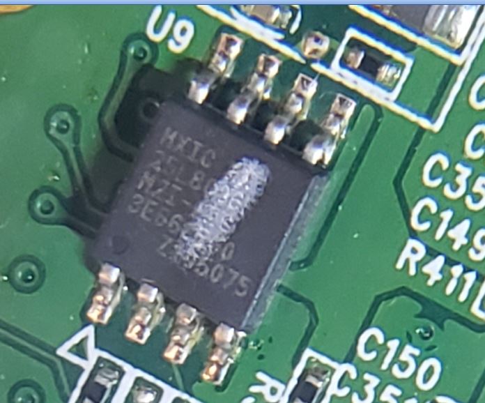

                            Went ahead and flipped the board over. Found this one with a paint mark on it too, Number on it reads 25L8xxxx if it matters. I think the xxxx is 036F, but its covered by the paint.
                              Maybe, maybe not. But rather it is not there.
                              • lotas
                                • Jan 2016
                                • 4899
                                • Russia
                                On the other hand, we do not need 25xxx, it is rather responsible for scarlet (matrix settings).

                                  Both of them are 25xxx. Is the one on the front the one that possibly needs to be replaced? Are there certain specifications that I need to look for to replace it with? Surely there are other sources for this that are not $16.
                                  • lotas
                                    • Jan 2016
                                    • 4899
                                    • Russia
                                    Wipe off the paint so that the full marking can be seen.
                                    • karthur
                                      • Nov 2015
                                      • 150
                                      Here is close-ups of both chips. The numbers are:
                                      Front Chip
                                      MXIC MX
                                      25L3206E
                                      M2I-12G
                                      3F652000
                                      L111676
                                      Back Chip:
                                      MXIC MX
                                      25L8006E
                                      M2I-12G
                                      3E660500
                                      Z105075
                                      • lotas
                                        • Jan 2016
                                        • 4899
                                        • Russia
                                        For 16 bucks there is an already programmed flash, you need to find the same or an analogue (the size of the internal memory), they cost a penny.
