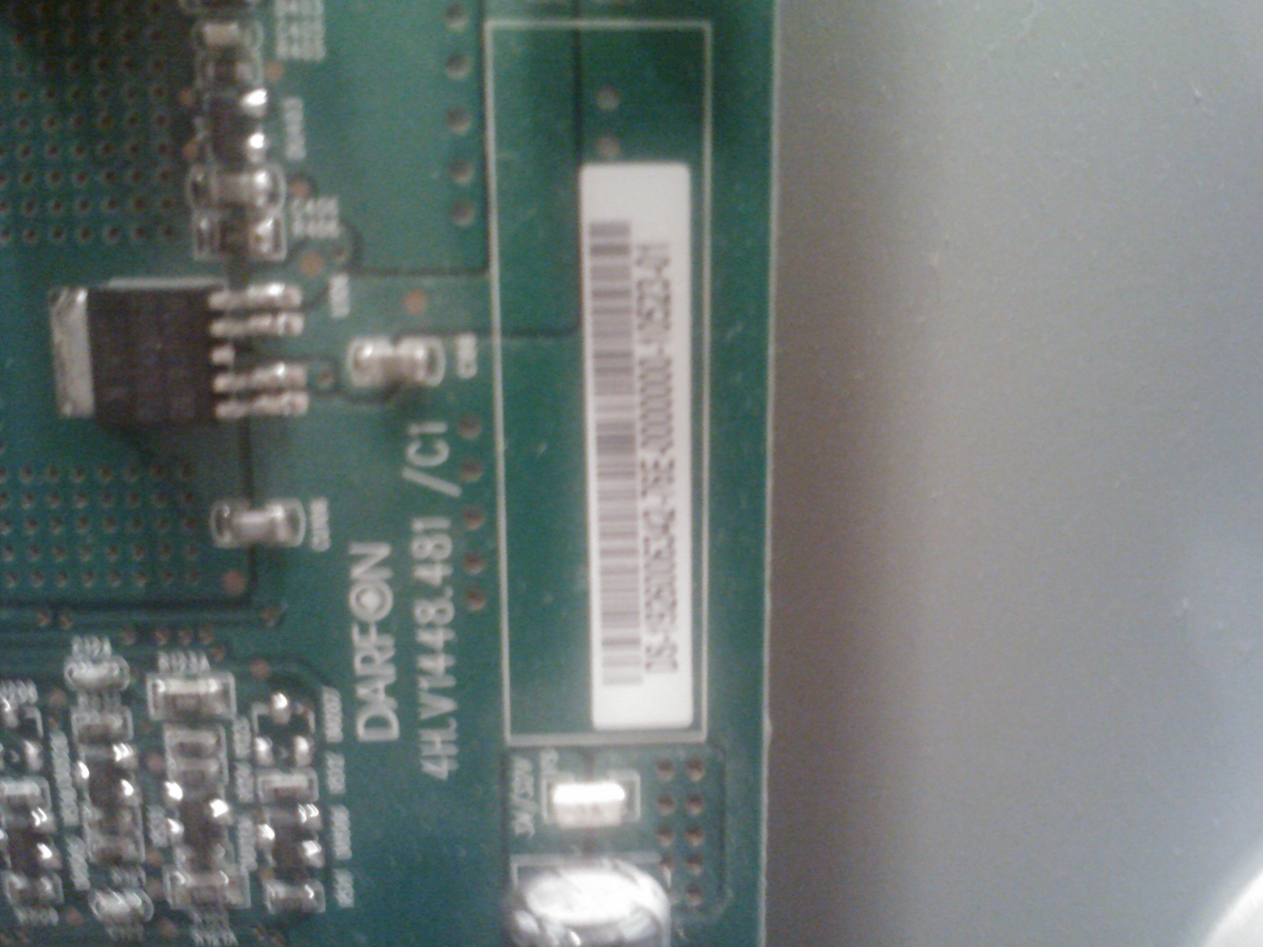

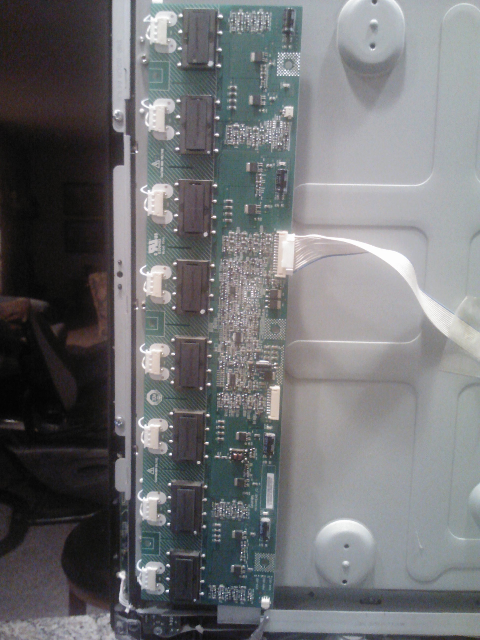

                        Re: Samsung LN-T3753H Nothing on the screen no sound
                        Yup I'm an Idiot.. I guess being tired after work doesn't help..
                        New Info:
                        Its a back light issue Confirmed that the main board works I have picture and sound!
                        What I have:
                        BL/ on is 5v Which is good
                        VDIM is @ 3.5V
                        No back light , same as before just flashes when its powered on.
                        Checked the the fuses
                        Looking for advise on a starting point.

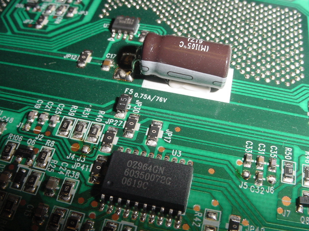

                          Sometimes there is a little fuse on these, can't see it from your photos but make sure you check it. Often marked "75", "10", "15", or "20", black body.
                          Since it is a Darfon inverter check transformer secondaries too.
                            The small black fuse looks something like this, see F5. It is used a lot in CMO Inverter board
                                Beside checking the inverter transformer resistance, the eight dual MOSFETs (4 small legs and big tab on top), and those 3 electrolytic caps ESR and capacitance should also be checked.
                                • bammbammfran
                                  • Apr 2014
                                  • 476
                                  Did you actually check to see what kind of voltage is getting to the inverter ?
                                  Picture is way to fuzzy for me to tell you where to start
                                    If you are referring to my posted pic ... Sorry my cell phone was what I had handy before I left the house this morning.
                                    I also have 24V,
                                    So if I 5V for Back light on /off , 3.5V on Dim from the PS to the inverter.
                                    Anything voltage wise on the inverter I should look for?
                                    I'm assuming if one of the xformers is bad I'm looking for a short or open.
                                    The short should blow a fuse or it has a way of shutting down which is what it seems to be doing.
                                      Post the P/N as printed on the transformers so we can look for the pinout.
                                      • bammbammfran
                                        • Apr 2014
                                        • 476
                                        I also have 24V,
                                        ok
                                        so voltages look good
                                        bad transformer may not blow a fuse
                                        They may show an open reading on the output side where the bulbs plug in
                                        a shorted transistor might blow a fuse if it is really shorted
                                        compare each transformer outputs to each other
                                        and check each pin on the 8 transistors to each other. Large tab to small pins on one side then to small pins on the other side then small pins to small pins
