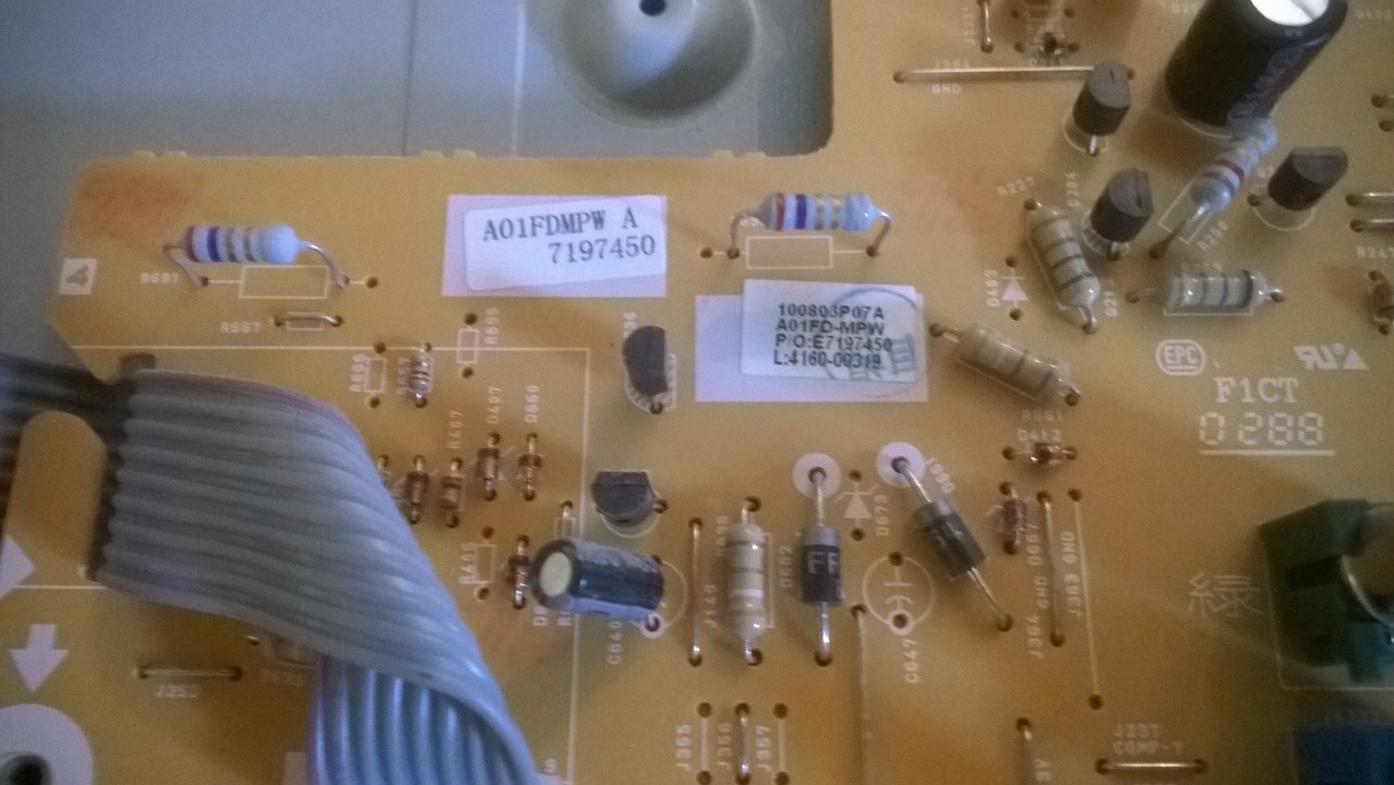

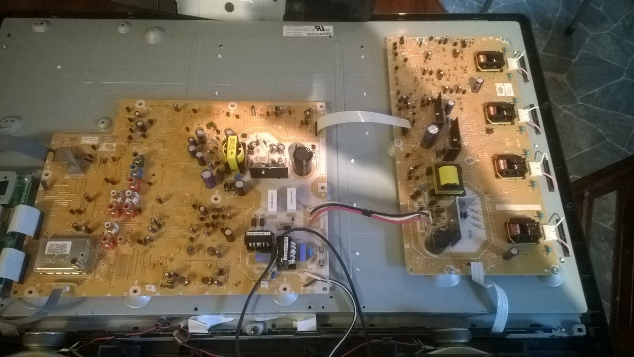

    Behavior is similar to a Samsung TV on which I replaced power supply filter caps, so I wasn't too alarmed when the TV would randomly turn off. It would always turn back on, and I figured I'd fix it when I had to. So now it turned off and will not turn back on. The LED Indicator is a white light. It flashes when you hit the power button, seems like the TV is warming up to fire, and then the light just turns off.
    I checked the resistor right next to the fuse, and it checks out OK. No bulging caps or melted IC, or burned resistors that I can see. So I guess I need to trouble shoot. So I guess I'm looking for a troubleshooting service manual for this, but not sure how to find one.
    I build and repair tube amps, so I'm pretty handy with an soldering iron.

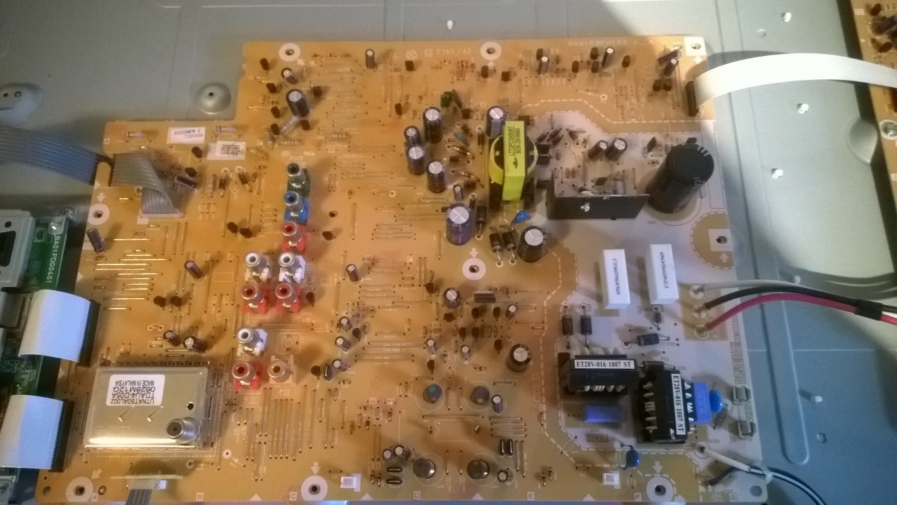

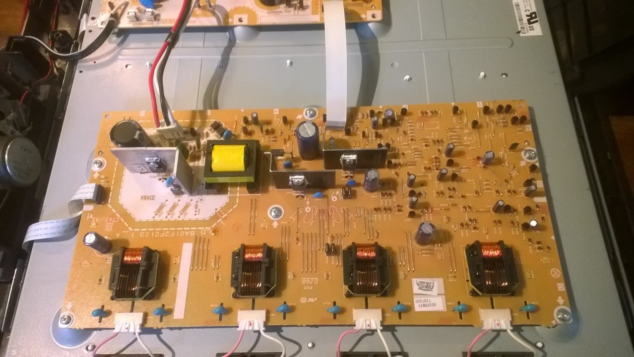

    that sure looks like it was made by funai judging from the internals, found a service manual for you (attached below) if it is a funai start by checking all the zener diodes and output diodes for shorts.
    Liberating magic smoke one part at a time

      Do the diodes need to be removed for testing or can I just go leg to leg across the diode while it's still on the board?
      edit: https://www.youtube.com/watch?v=i4jTHhXuKLA
      Watched this, so I think I may need to test both in and out of circuit. HE just removes solder to "take it out of circuit". He doesn't actually remove it from the board. I would think it would still be making contact. Or are the vias not through-plated?
