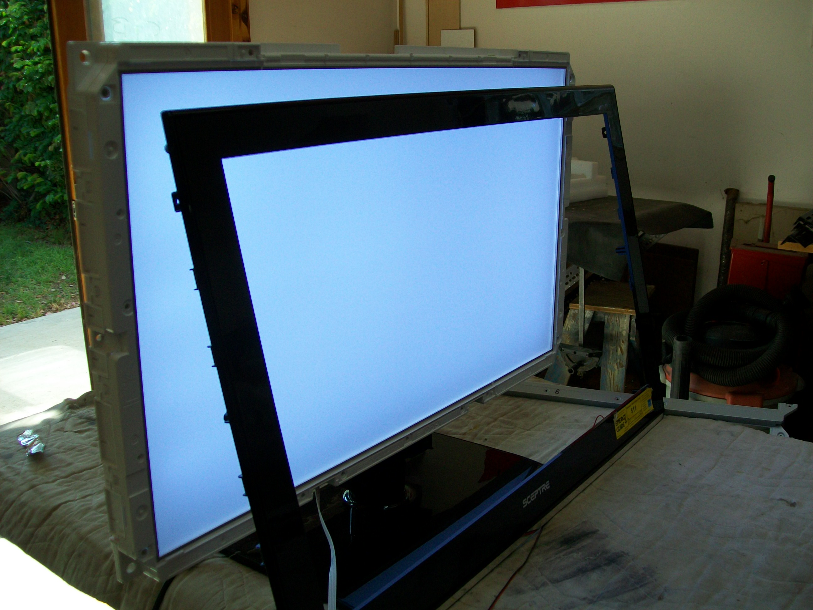

              Just wanted to shoot an update this post. I went ahead and replaced the entire power board as a unit, although I'm pretty sure the high voltage winding as Budm mentioned was the culprit. Once installed...walla! I got backlight coming on, and once all put back together the set has been working since. I wanted to thank this awesome forum and specifically Budm & DGtech for jumping in to assist, couldn't have done it without you guys.
