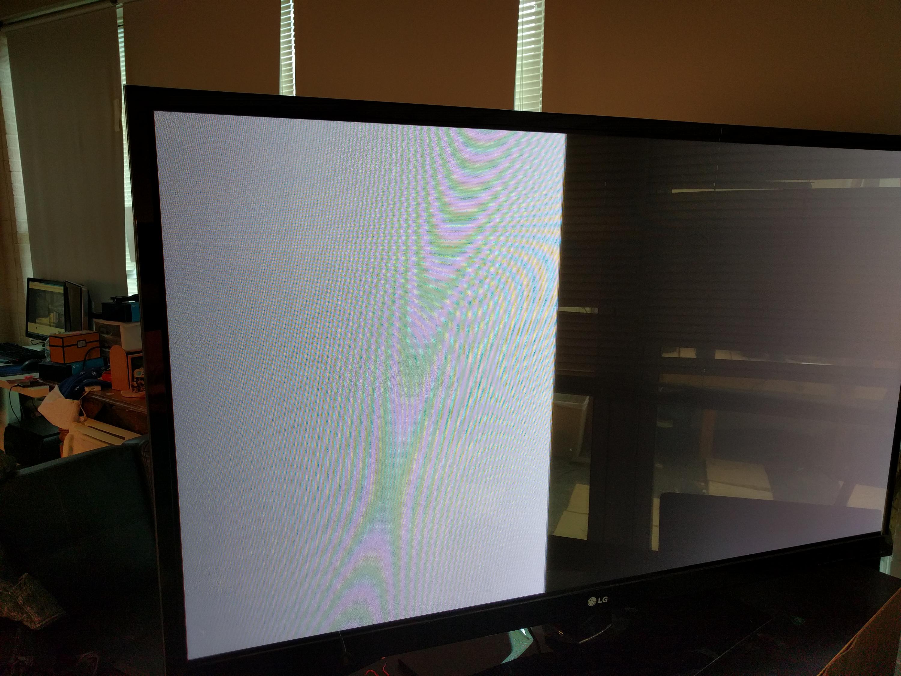

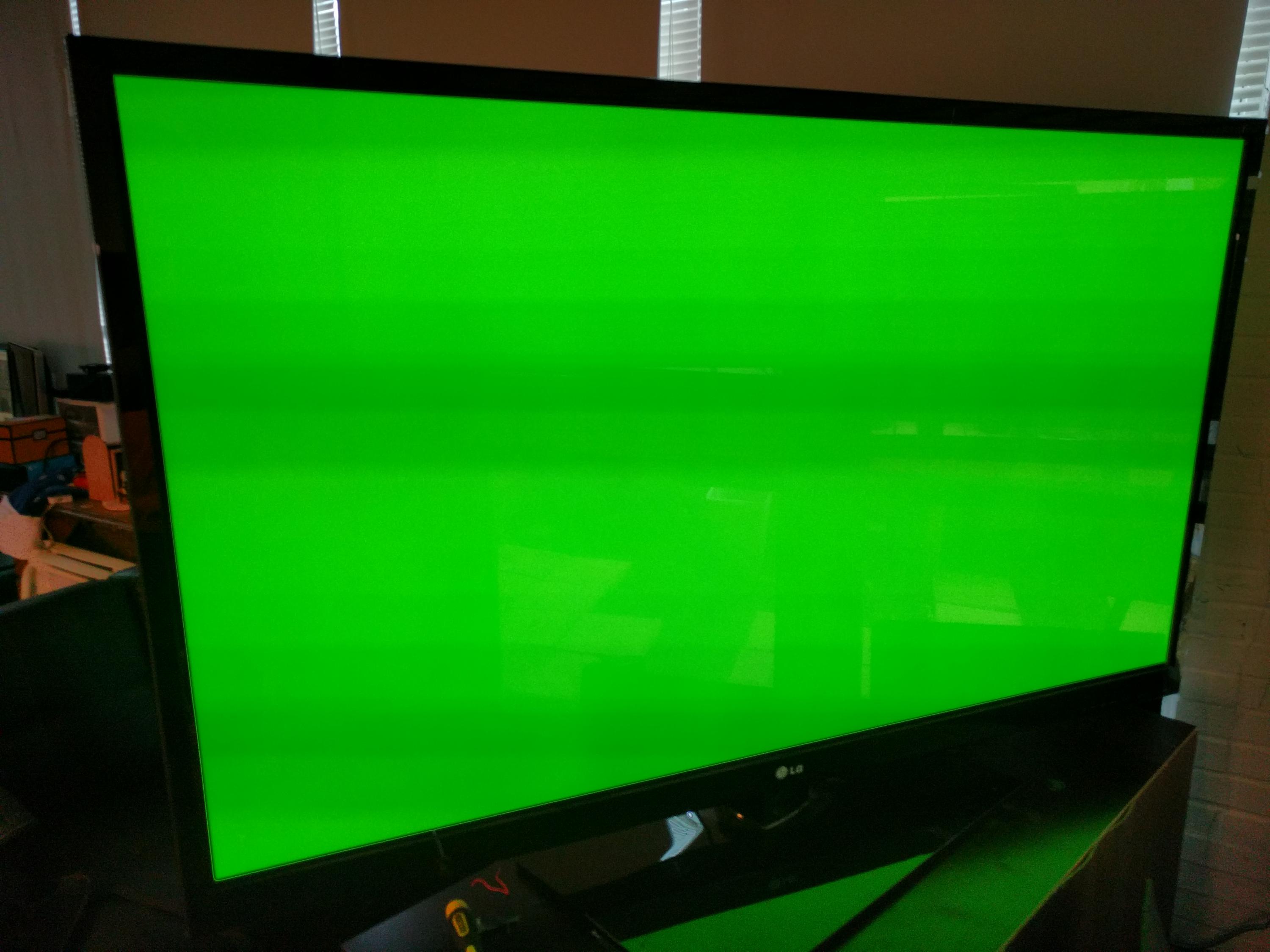

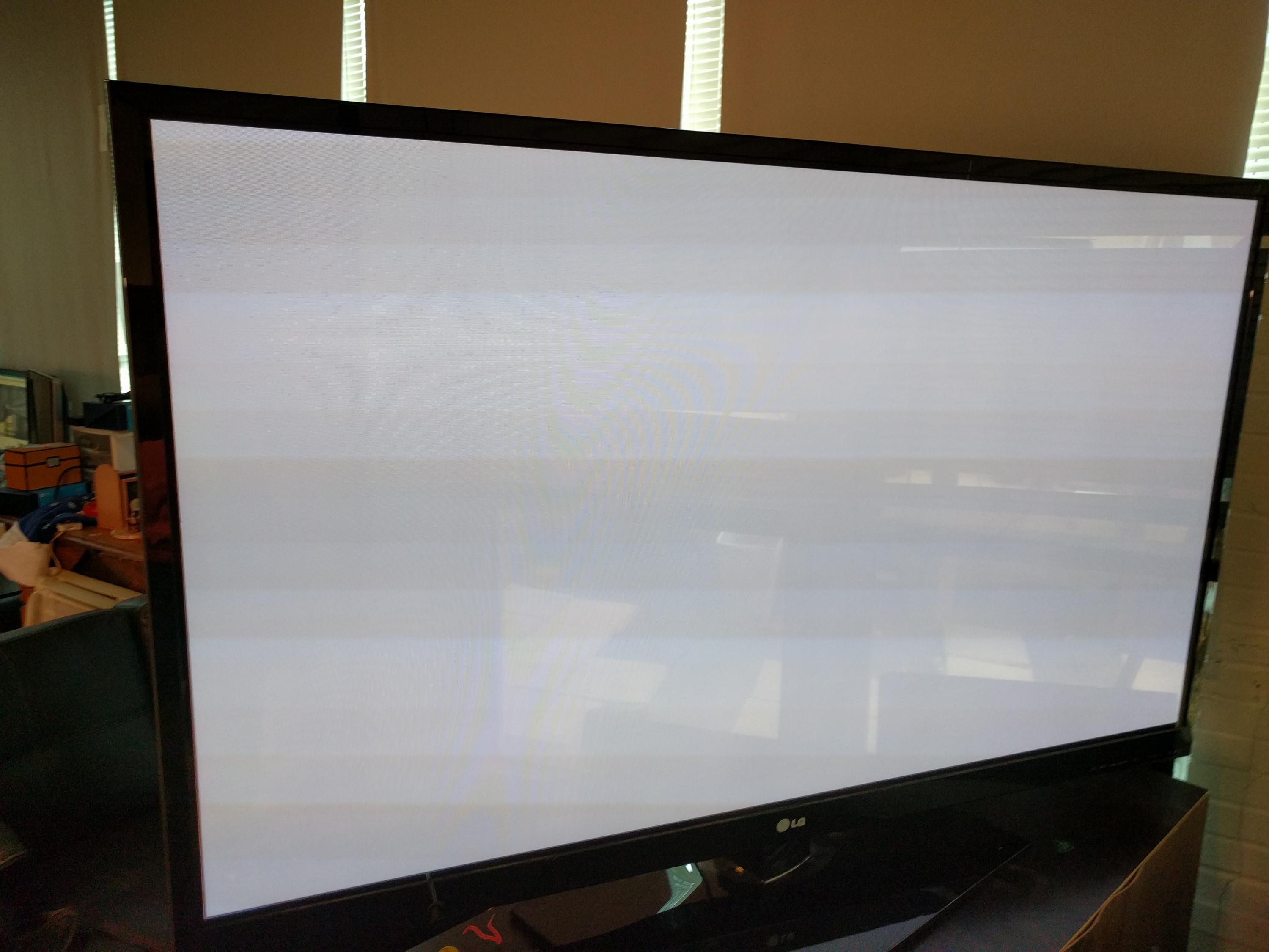

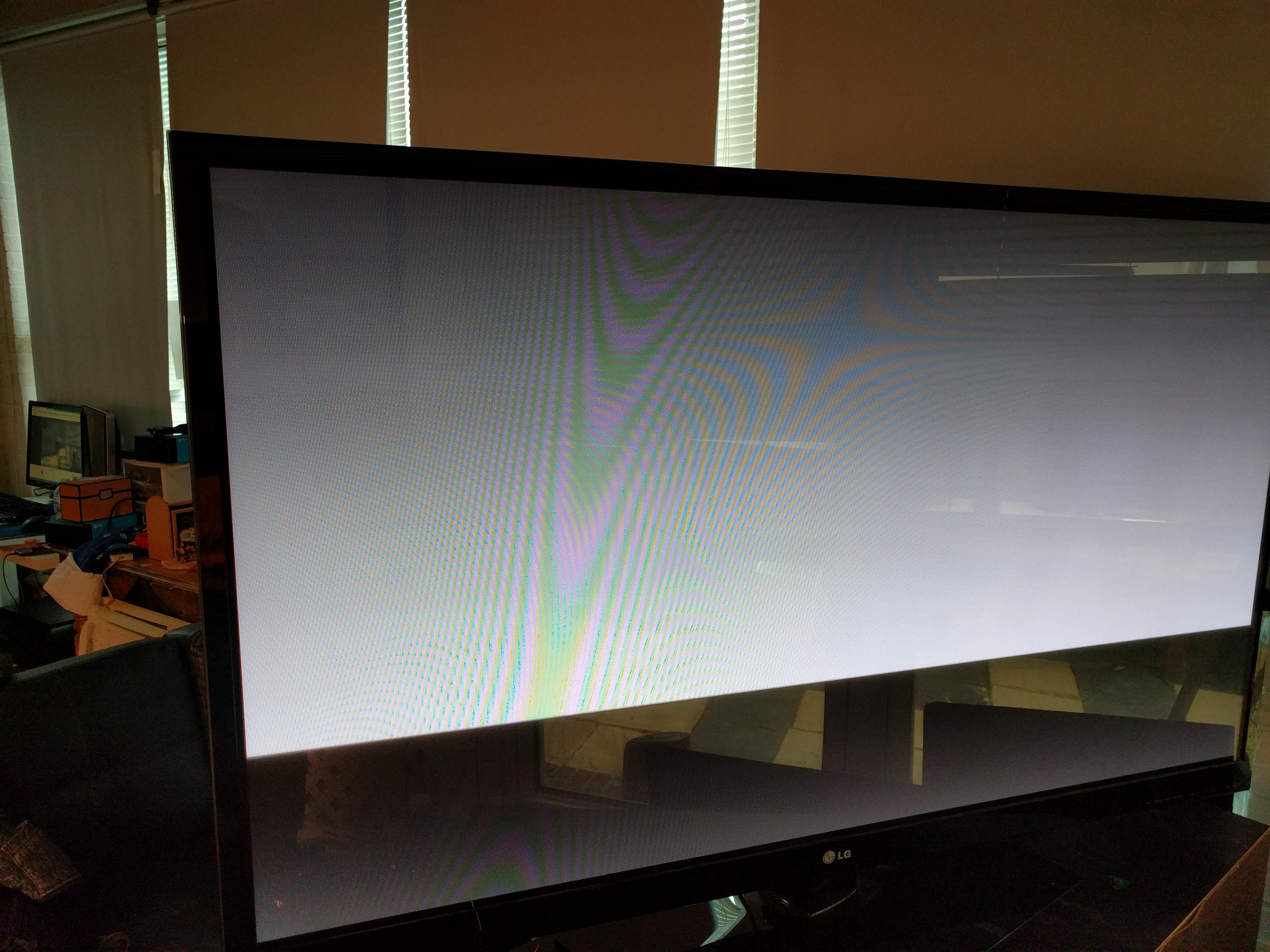

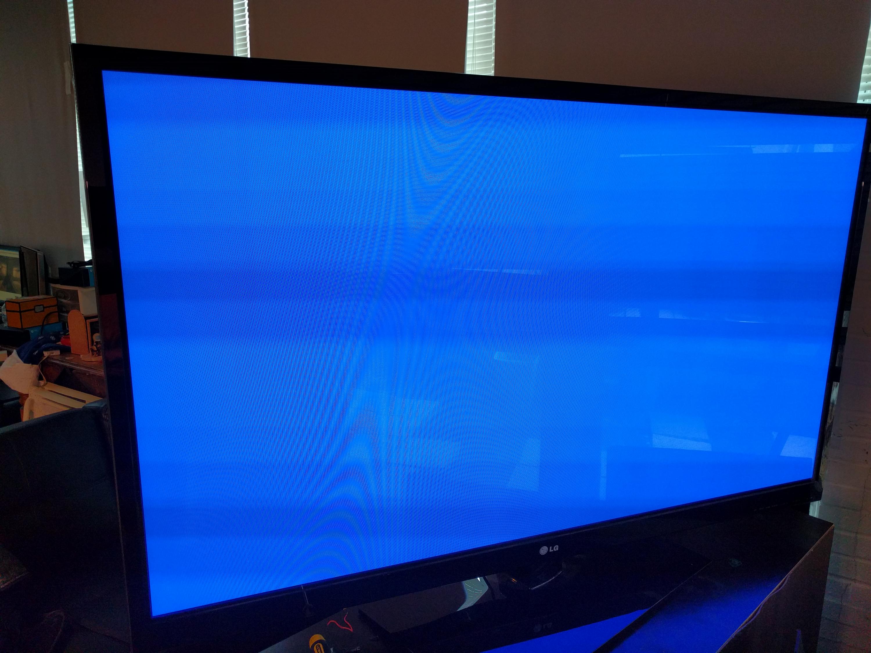

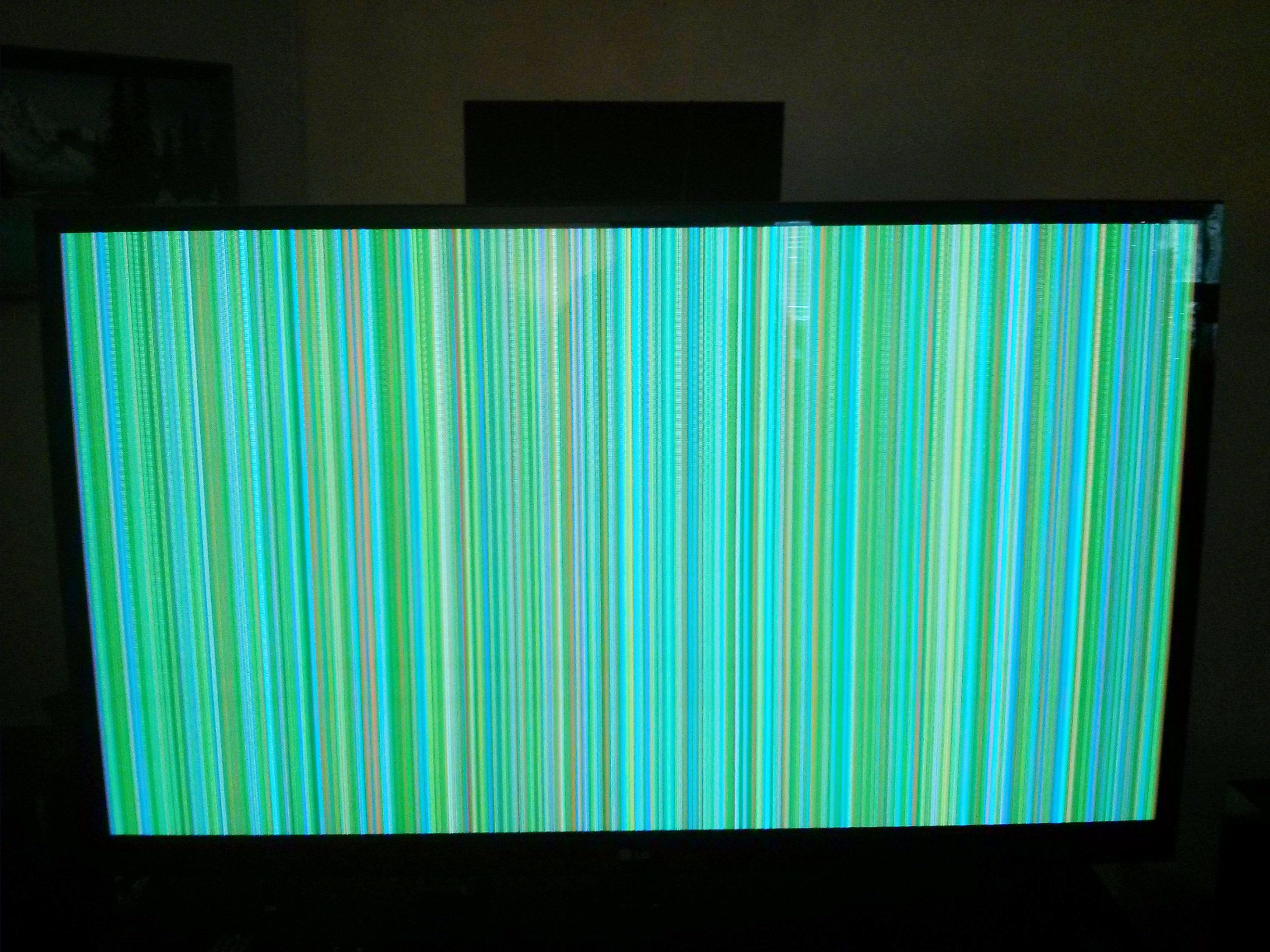

                    On Christmas Eve I was watching my LG 60PZ550. It was working fine, I never had any indication before this that anything was wrong.
                    I came back two hours later and turned it on and this is what it is now showing—sometimes it's green if I turn it off and on.
                    No menus, can't change input, but I can hear sound.
                    Does this look like the inducers would cause this as well? If not any ideas what it would be?
                    Thank you in advance.
                    (BTW there are two reflections on the picture that are not part of the problem. The image on screen is a perfect wallpaper look.)

                      I'm sorry I meant to say sometimes it's pink. But it alwyas has the same pattern in it. It is never a solid color.

                        Take the back off, you know how to run the test patterns ?
                        • Umbrella Corp
                          • Dec 2015
                          • 26
                          #52
                          Re: Purple/Pink Lines / Postering on plasma LG 60PZ550
                          Are the test patterns built into the set?
                          If they are, I'll take it off and get back to you.

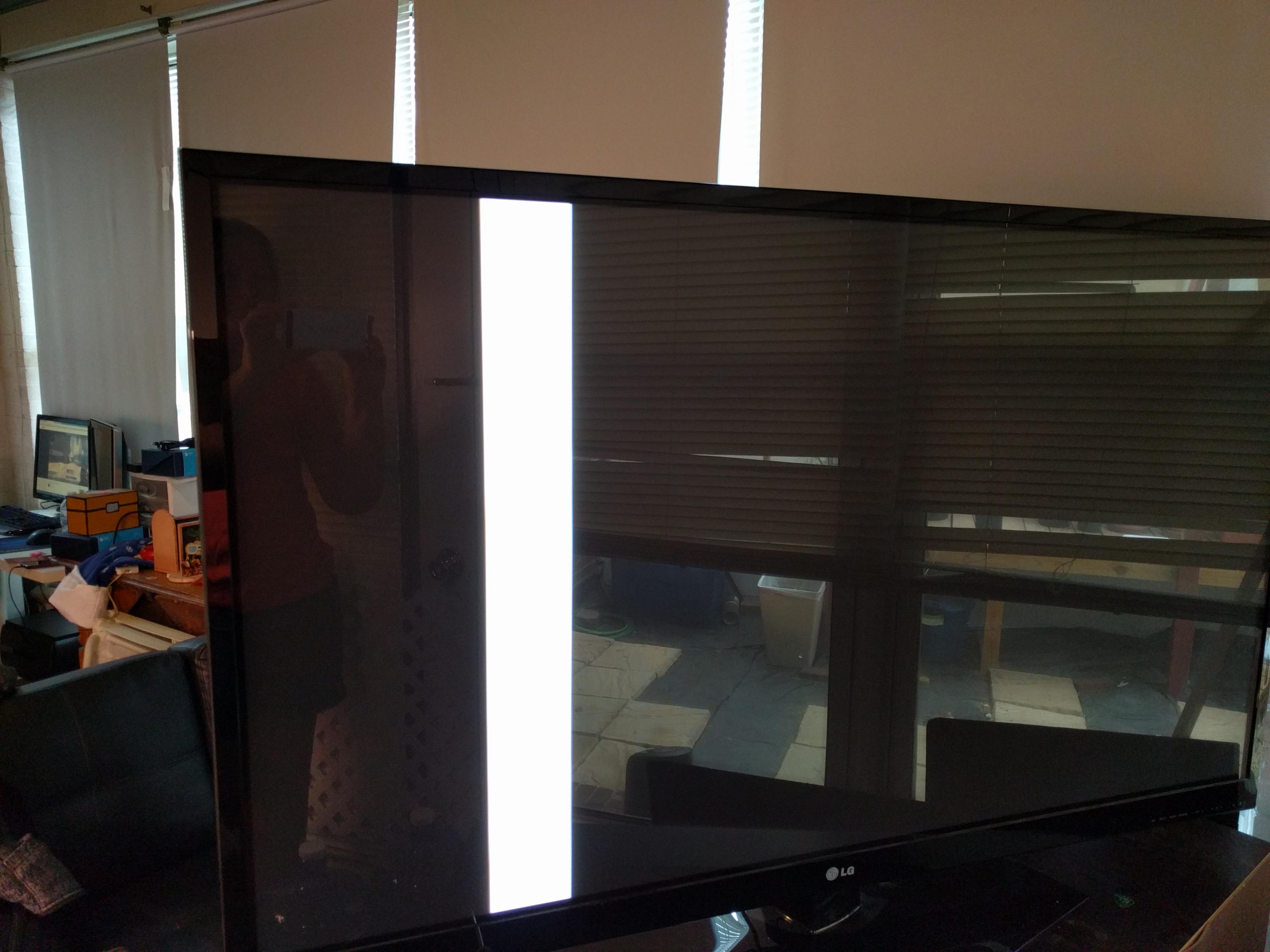

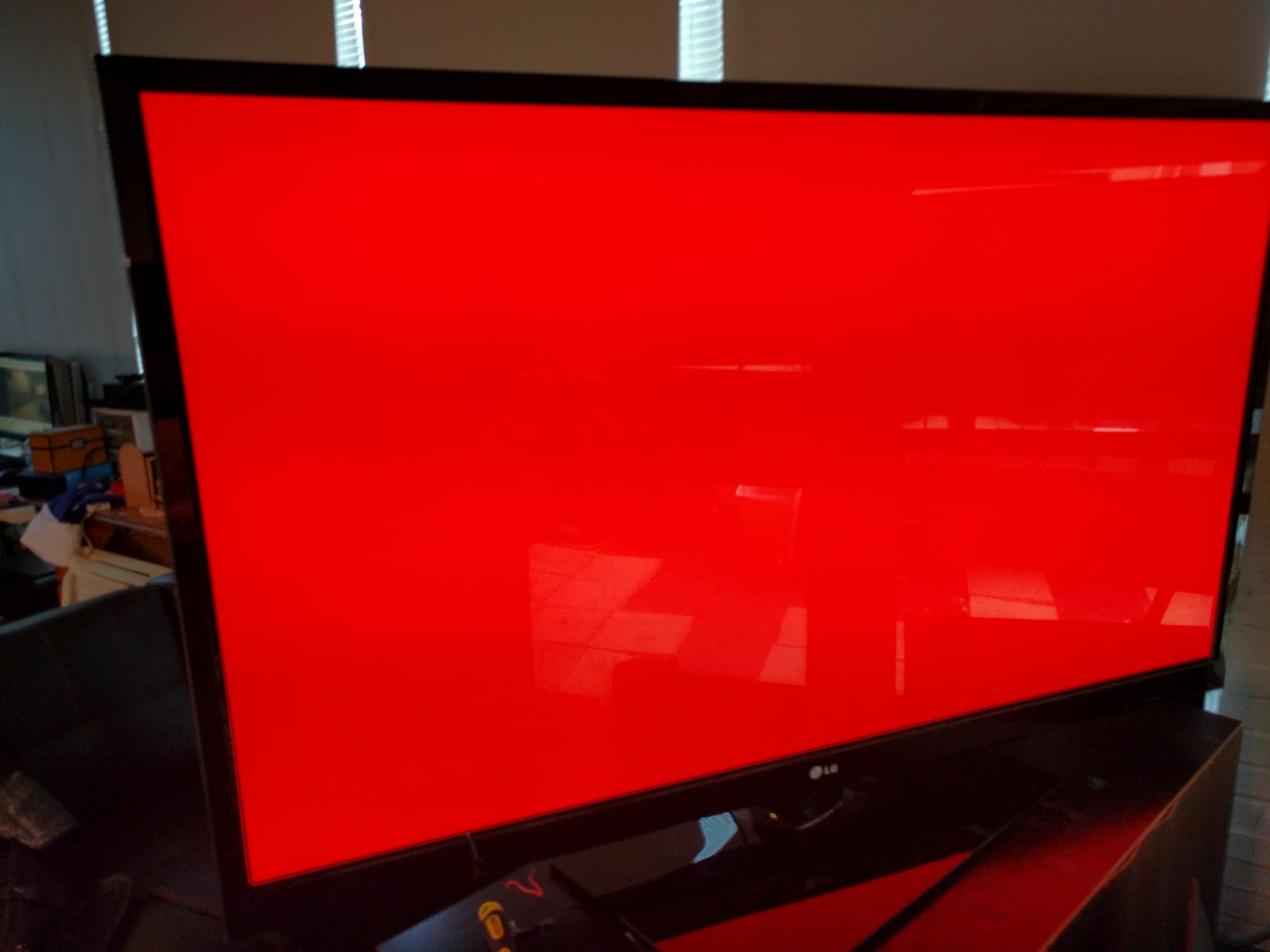

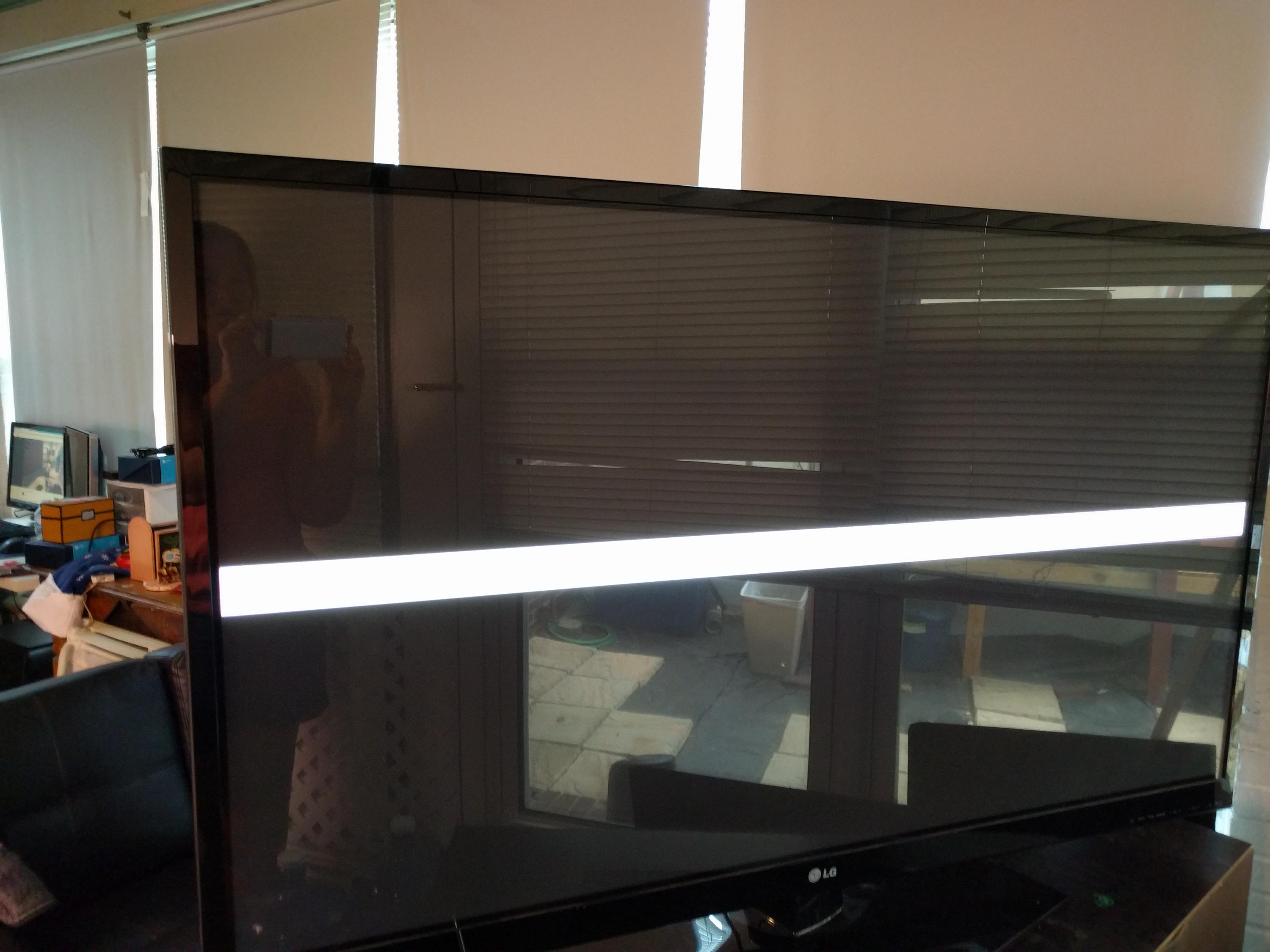

                              You will need to take the back off, remove the Lvds cable from the Contrl board and jumper the two open pins. Turning the Tv on test patterns will run, upload some images.

                                #55
                                Okay, will get back to you.
                                • Umbrella Corp
                                  • Dec 2015
                                  • 26
                                  #56
                                  Okay first I get a pure full screen Red, Green, Blue, white then a bar moving right to left and bottom to top shoing gradients. Then finally a white bar moving across black bothe vertical and horizontal.
                                  All the colors are brilliant and pure. The gradients look pure, too.
                                  Sorry about the reflections.
                                    BTW, those interfernce patterns are in the picture. The gradients are pure on screen.

                                      #58
                                      Ok that means your mainboard is at fault. Probably failed Bga solder and it will need to be reflowed, easier to just replace it.
