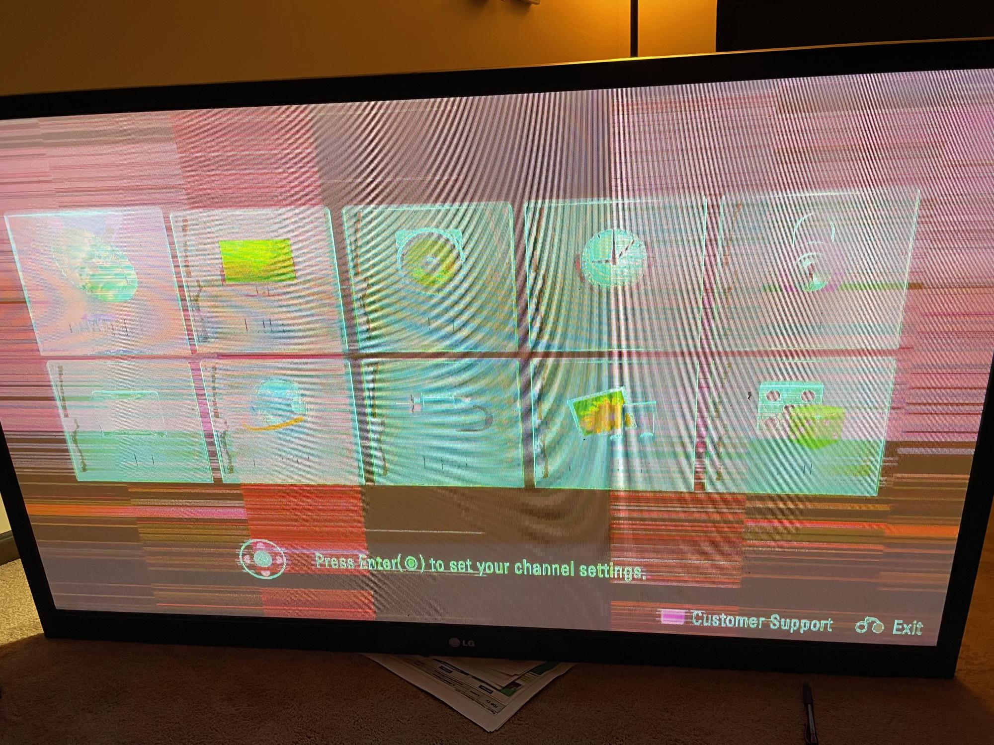

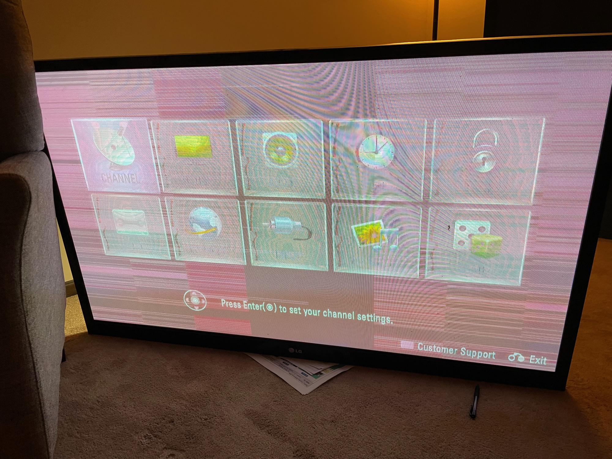

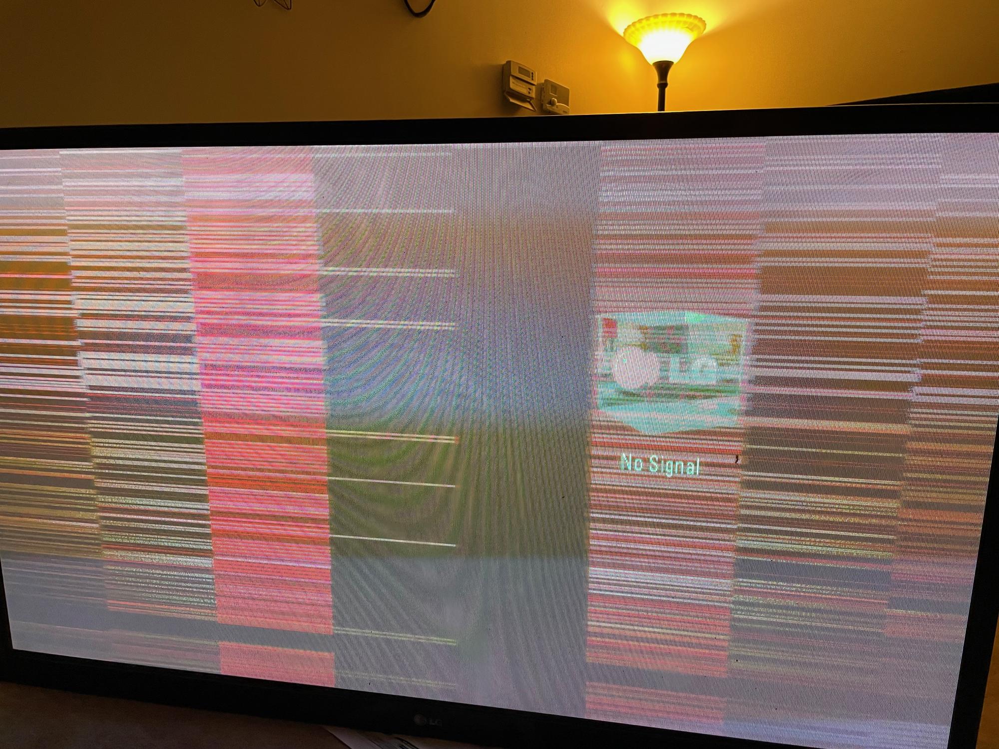

    lg 60pz550-ua erratic horizontal pink lines over image
    Hello again old friends! I am perplexed with this set. The mainboard was reballed to fix the known issue of HDMI port loss. When it came back from service I reinstalled it and now have the attached image. The image is there but it looks to be some type of Z-sus problem. I have checked and rechecked and replaced the LVDT cable between the logic and main board with no luck. And yes, the inductors on both the Y-sus and z-sus have been re-soldered with clean new 60/40 material. All voltages match the panel label Vs=202, Va =55, Vzb = 110 (it was at 115 and was adjusted down) Vy = 180, and Vsc =150. I did run the jumper test on the logic board and got all clean color screens and the traveling white bar. I am at a loss looking for any suggestions!! Thanks for any help!! Also, I sent the board back to the shop who did the re-ball and they confirmed it was working perfect in their test set!!!

    Re: lg 60pz550-ua erratic horizontal pink lines over image
    if the set works with the jumper test on logic board, it is the lvds connector/connection problem or main board.
    These models are known for terrible bga problems on the main chip, so ask the shop to prove it is working with your board, because it does not makes sense why it would only work in one tv and not in the other which can reproduce test patterns just fine.
        if the test patterns run without issues, it cannot be mal discharge or any problem with the sus boards.
                    It's 1000% the mainboard. If the display is clean while running the test patterns, the mainboard is the fault. Dont screw with any voltage changes.
                        You are all convincing me even more that it's the mainboard. I re-ran the logic board jumper test just to satisfy my sanity and same perfect result! So all other components are working fine. I am asking the original repair center for a refund and hopefully will be sending the board to Nick's TV in Arizona. This I what I get for trying to save a few bucks!!!
