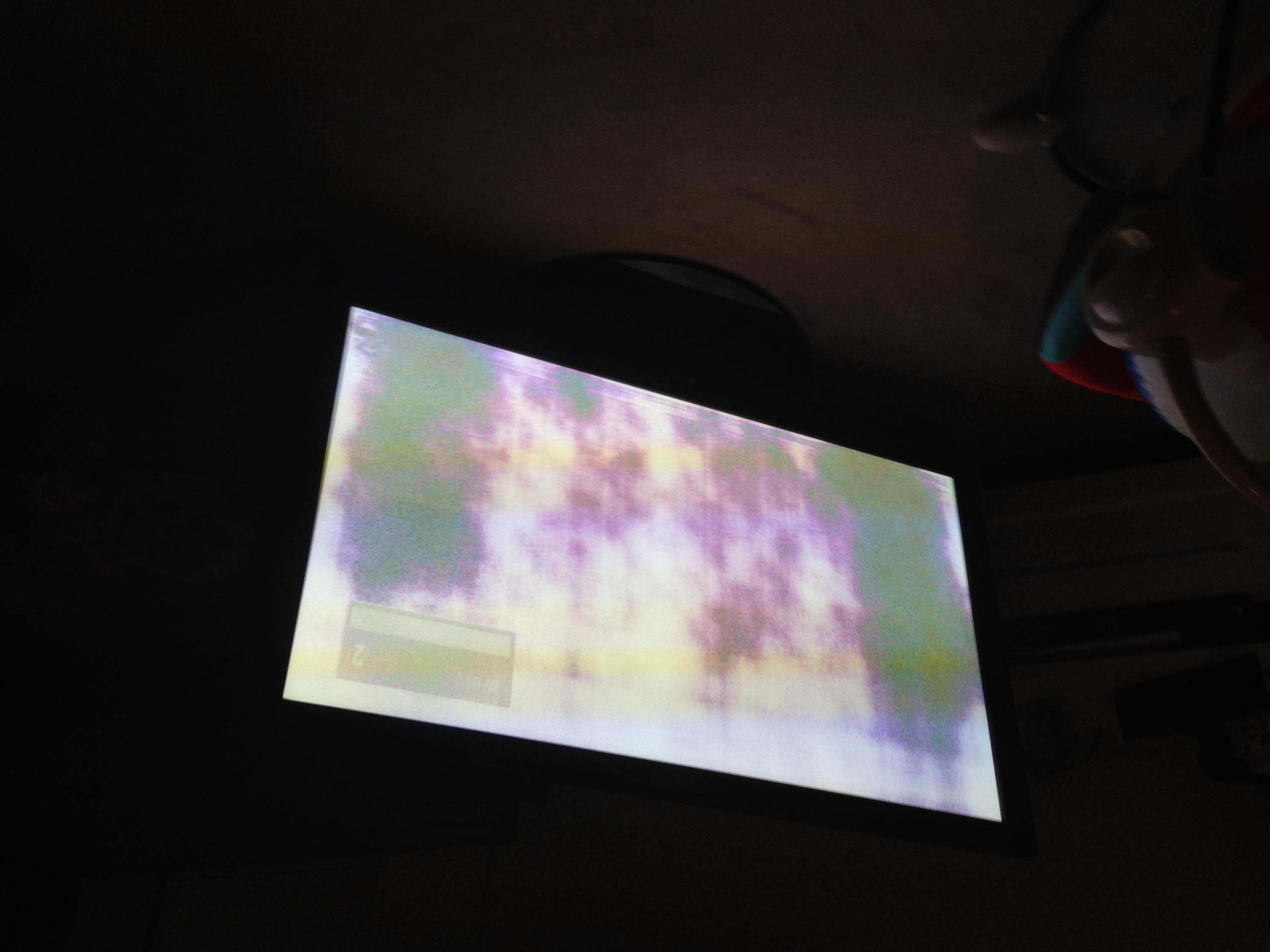

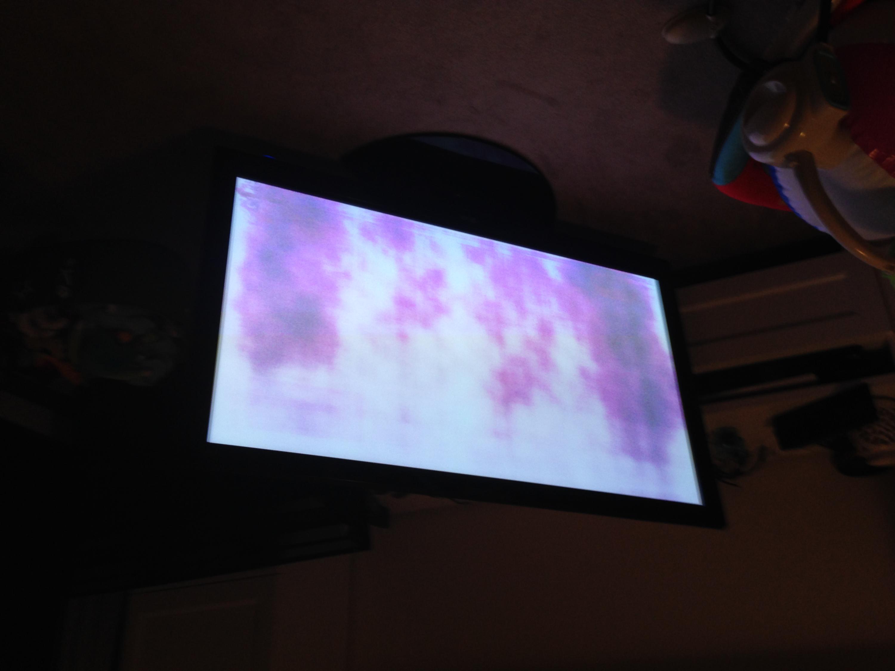

    I have an LG 50 inch plasma TV (model 50PS30FD-AA) that that went bad a few days ago. First the screen when mainly white with a bit of purple. It looks bit like the contrast was inverted as well. Then after a bout 10 minutes the TV turned off. Now it only turns on for 2 seconds before it turns off again.
    I took the back off and then pulled all the circuit boards (all except he control board and the signal input board) off and then checked all the capacitors by looking at them and by checking for shorts with a multi-meter but they all look good. All the components on all the boards look good. All the solder on the boards looks perfect.
    Please see attached photos of what the screen looks like when I turn it on (it turns off by itself after a couple of seconds).

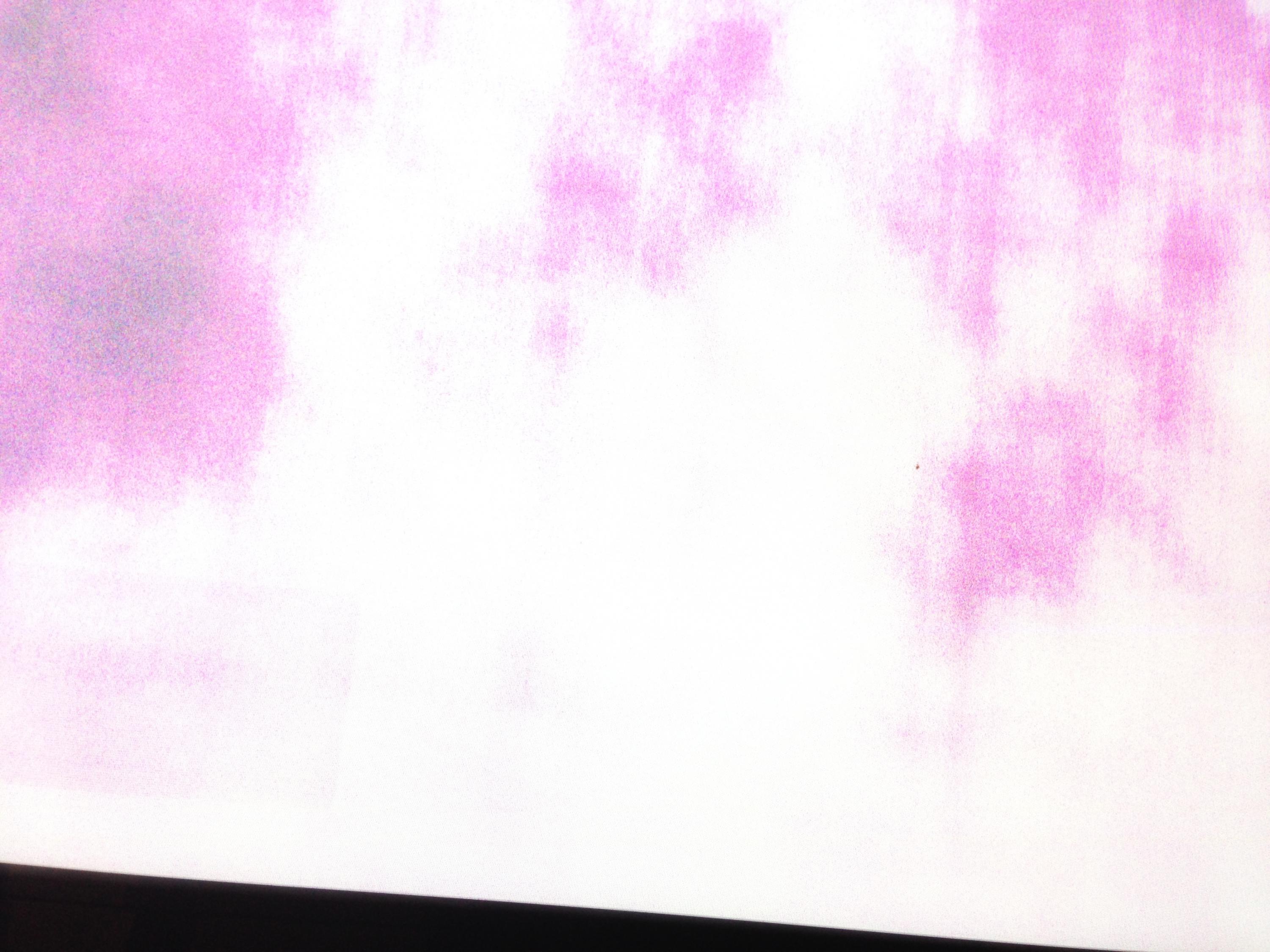

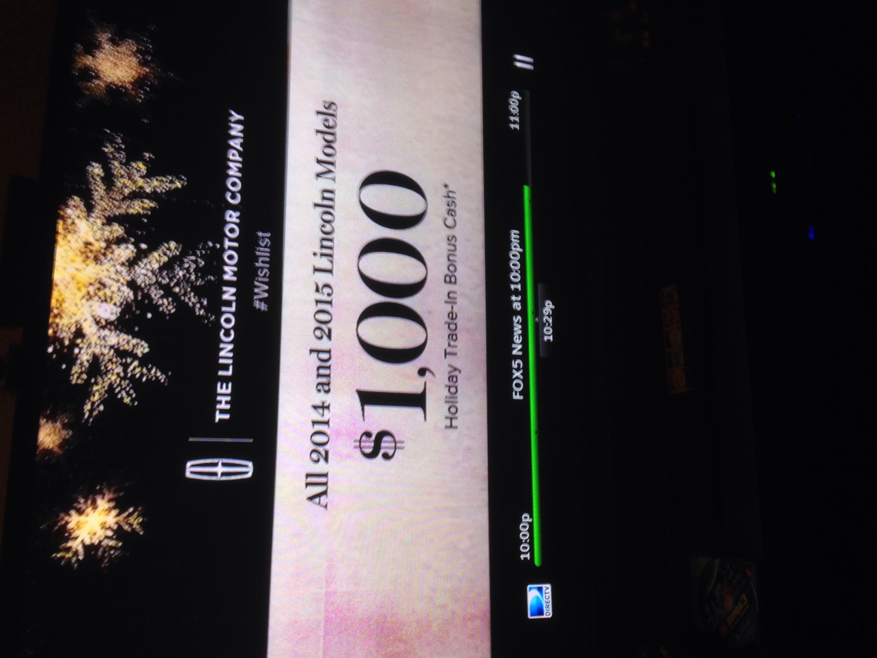

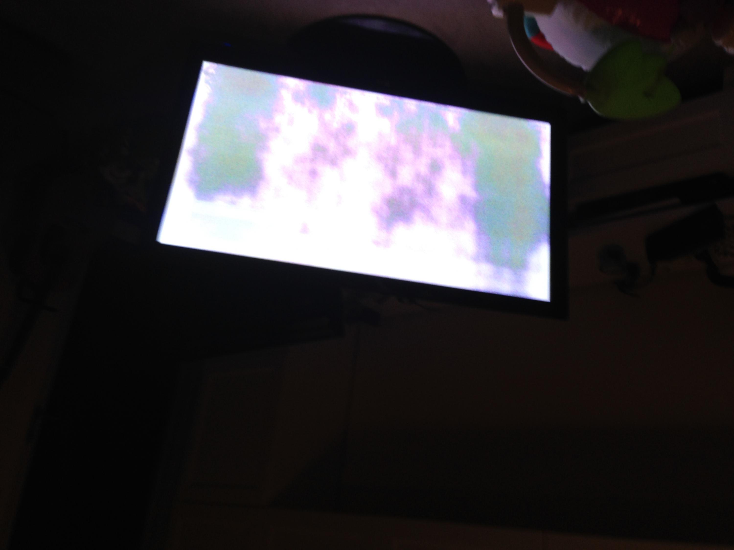

                                Seem to be experiancing the same issue. I have attached pictures to be sure before I crack the back open to fix. The TV is just over 3 years old with very heavy use. If this is the same issue as above what will I need to fix. Never really soldered anything before. How hard is it?

                                  i had the same problem with the purple streaks with my lg 60pz550. Wish i had seen this sooner. Thought maybe it was burn in related so i a ran the color washer for about 30 minutes. After the picture went out. I get sound but no picture now. I found that the fuse is blown on the LG EBR73561701 ZSUS Board> Any thoughts on how to repair?

                                        It might be best to replace the Z-sustain board, I don't know if anyone has repaired one of these yet but it will involve replacement of several IGBTs on the heatsink + various surface mount parts, ok if you've done it before (and someone has tried it before too, so they know what fails on these) but a bit daunting if not.
