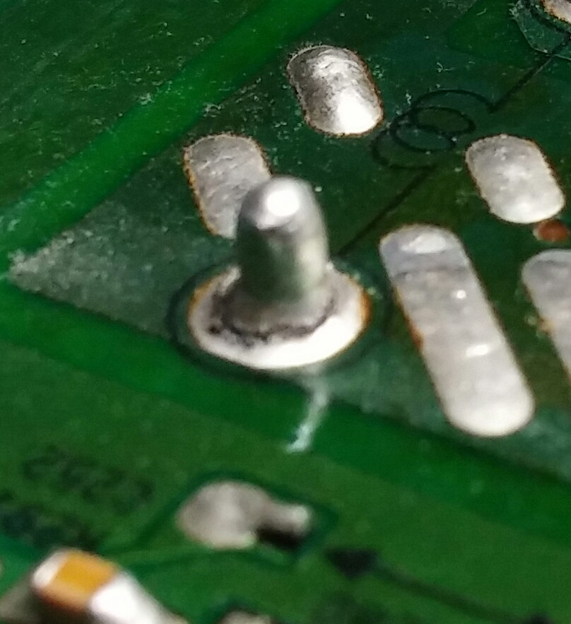

                        #71
                        Re: Purple/Pink Lines / Postering on plasma LG 60PZ550
                        I would like to thank tom for the info. My 4year old pz550 started having the discoloring so i took the back off soldered those coils and voila new picture again.

                          #72
                          I had the same problem with my TV and found that one of the boards had 2 cracked solder joints. I went ahead and reflowed all of the inductors just to be on the safe side. I did notice that the PCB is single sided copper (not double sided for example with thru-hole barrels. This would have made these solder joints a lot more reliable...

                            #73
                            Not clear on what to solder. Do i reflow the half inch long lines running diagonally? On one board thereis alot of them and some are flat and some have solder raised.

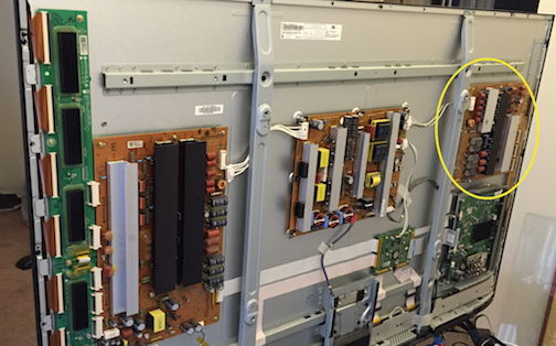

                              #74
                              Cross-posting this from another LG 60PZ550 thread I posted to in hopes of a hasty response.
                              Can someone please verify the proper method to conduct the pattern test? Since this is a common fault with this model of TV, there are several threads on this forum related to this TV and information is strewn about. The TV is for a coworker and I don't want to cause any more damage.
                              From what I gathered, I need to disconnect the ribbon cable connecting the Control board to the YSUS board. I also need to bridge the solder pads between R51 and R52. Do I need to disconnect the ZSUS or YSUS from the supply board or make any other special connect/disconnects? Do I need to input any special commands into the remote to initiate the test or should it auto-start?
                              Also,does anyone have information on the LED located on the Control Board? It appears to have a repeatable pattern of blinks. Not a steady blinking, but 3 short blinks followed by a longer blink(dot-dot-dot-dash). I assume this is an error code, but I can't find any information on it's meaning. Thanks for any help provided.

                                #75
                                Hi guys
                                Had the same problem with purple blotches and lines all over the screen but before I could try to resolder the joints, I lost the picture.
                                The TV has sat for about 3 months now and I have resoldered but I do not have any picture. There were several joints that were cracked on the Y sustain
                                Any ideas or advice greatly appreciated

                                        #79
                                        Ok take a look at the following picture I have taken.
                                        http://www.nickstvs.com/store/p477/L...Repair-Service
                                        The first picture on the listing here has the fuse at the bottom near the middle. It is white with a a red band going through it and has 2 leads on each side that go through the board. One of the ends is slightly hidden by the heat sink.
                                        That is your fuse and it should show a short if it is in good working condition.
                                        If you take a look at picture 3, you will notice 3 coils with lots of overheating around them. Pictures 7 and 8 are the other side of those coils where they solder in on the back side. If you notice small cracks in those solder connections as shown in the picture above, then you most likely will have a bad Z-sustain.
                                        Please let me know if you have any other questions.
                                        Thank you
                                        -Nick
