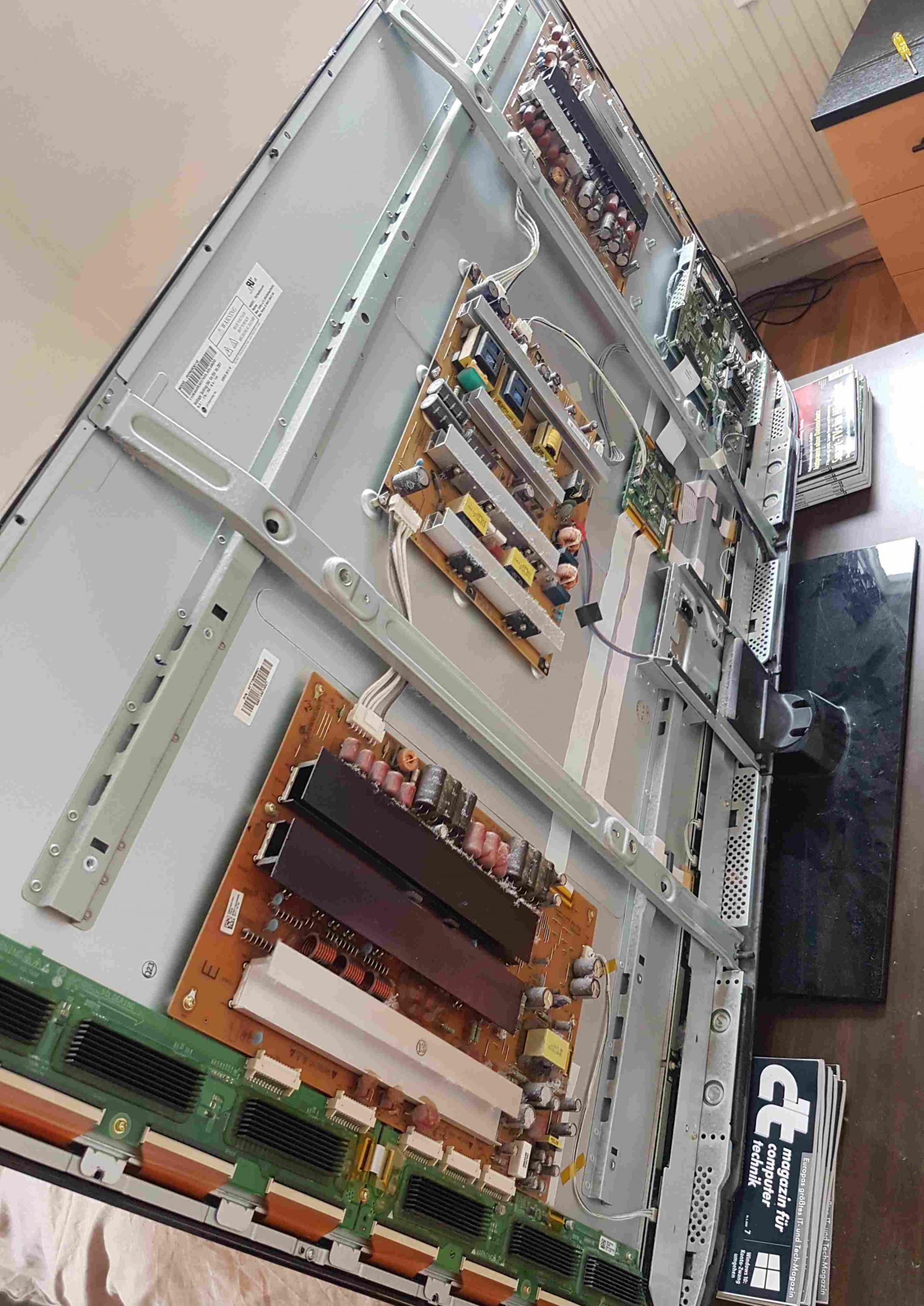

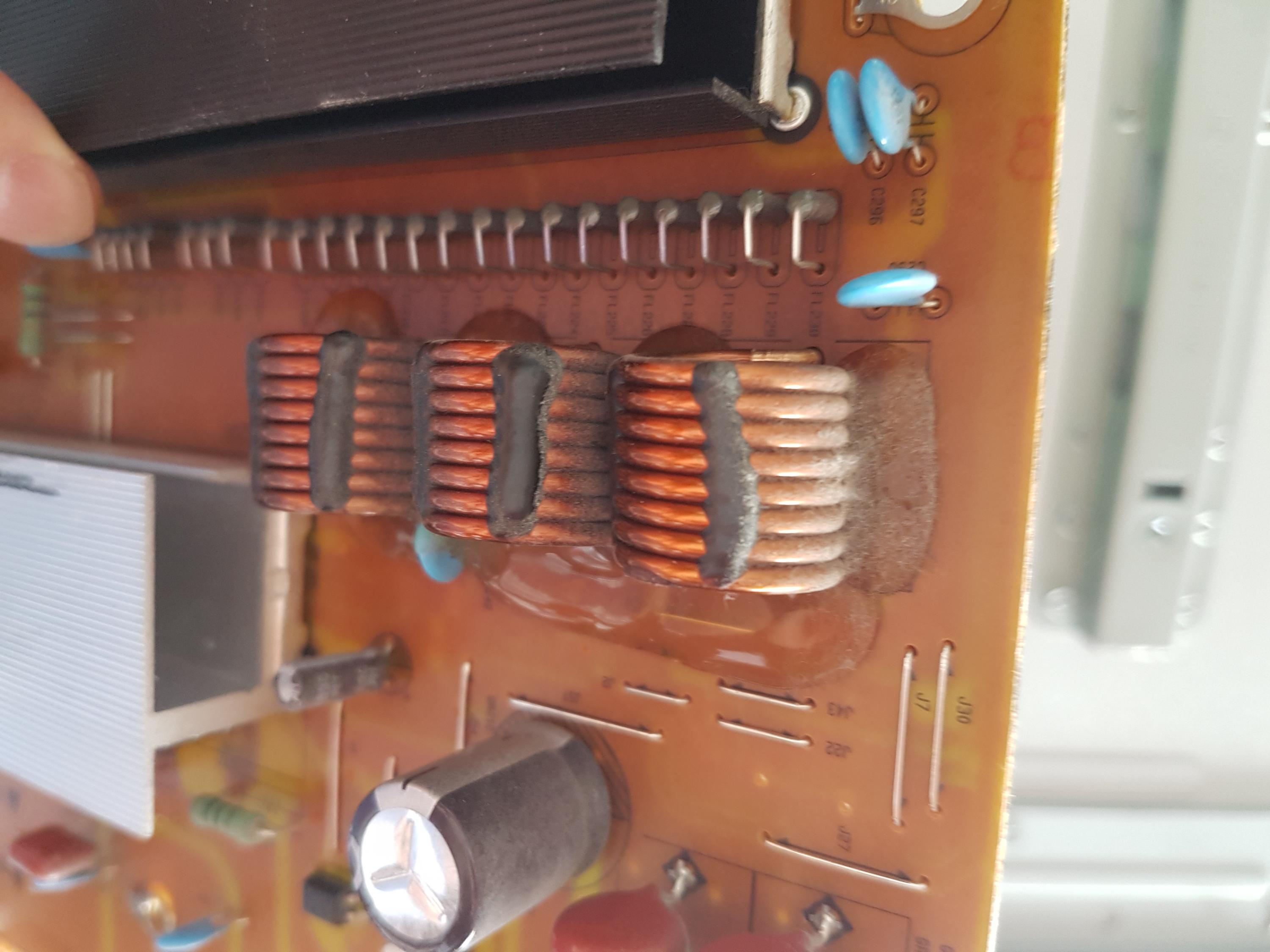

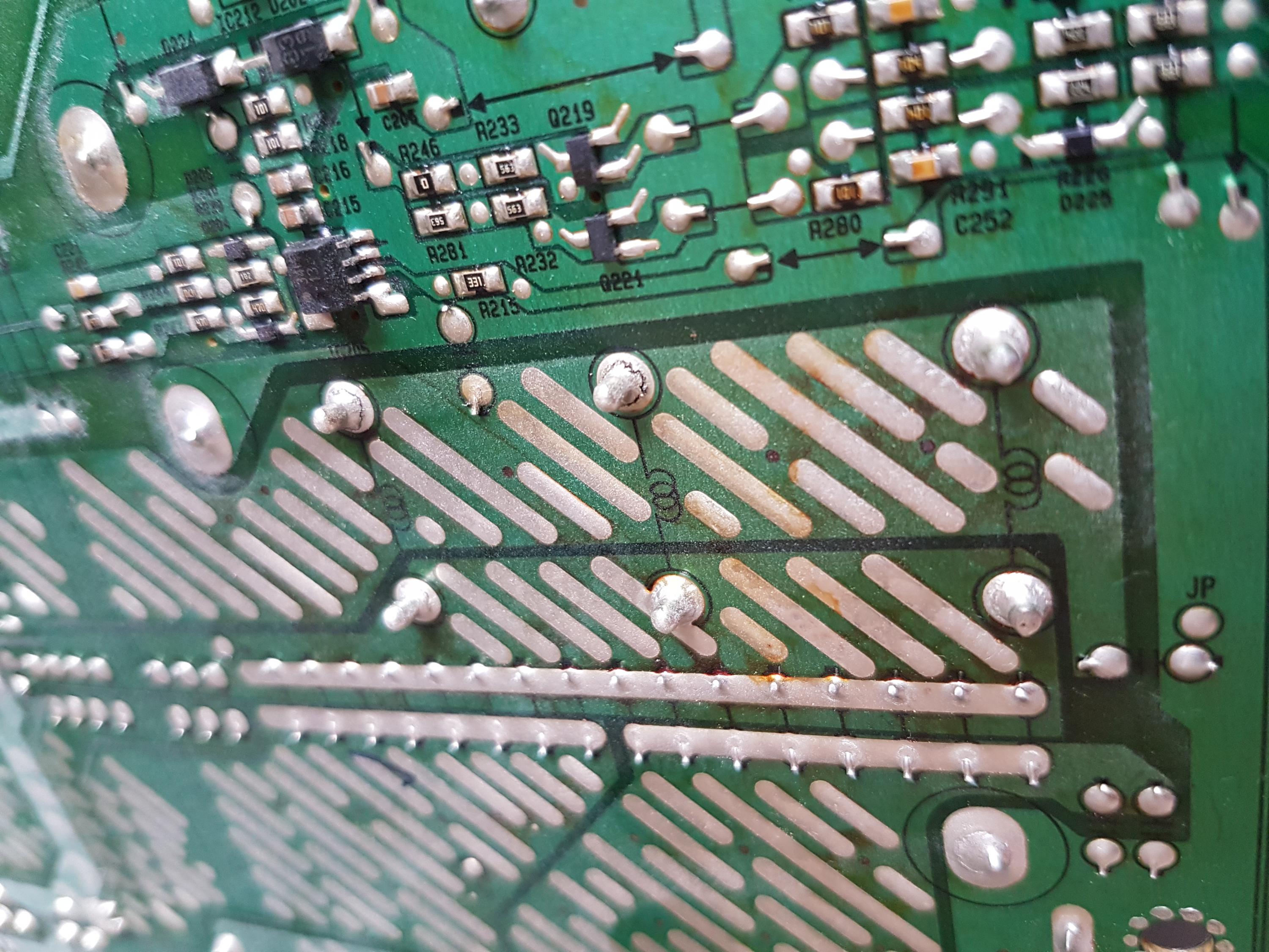

                        #91
                        Re: Purple/Pink Lines / Postering on plasma LG 60PZ550
                        just repaired my LG 60PZ250 Z-SUS Board with two cold solder joints.
                        quick fix - picture now clear without colour/OSD fading
                        see pictures attached
