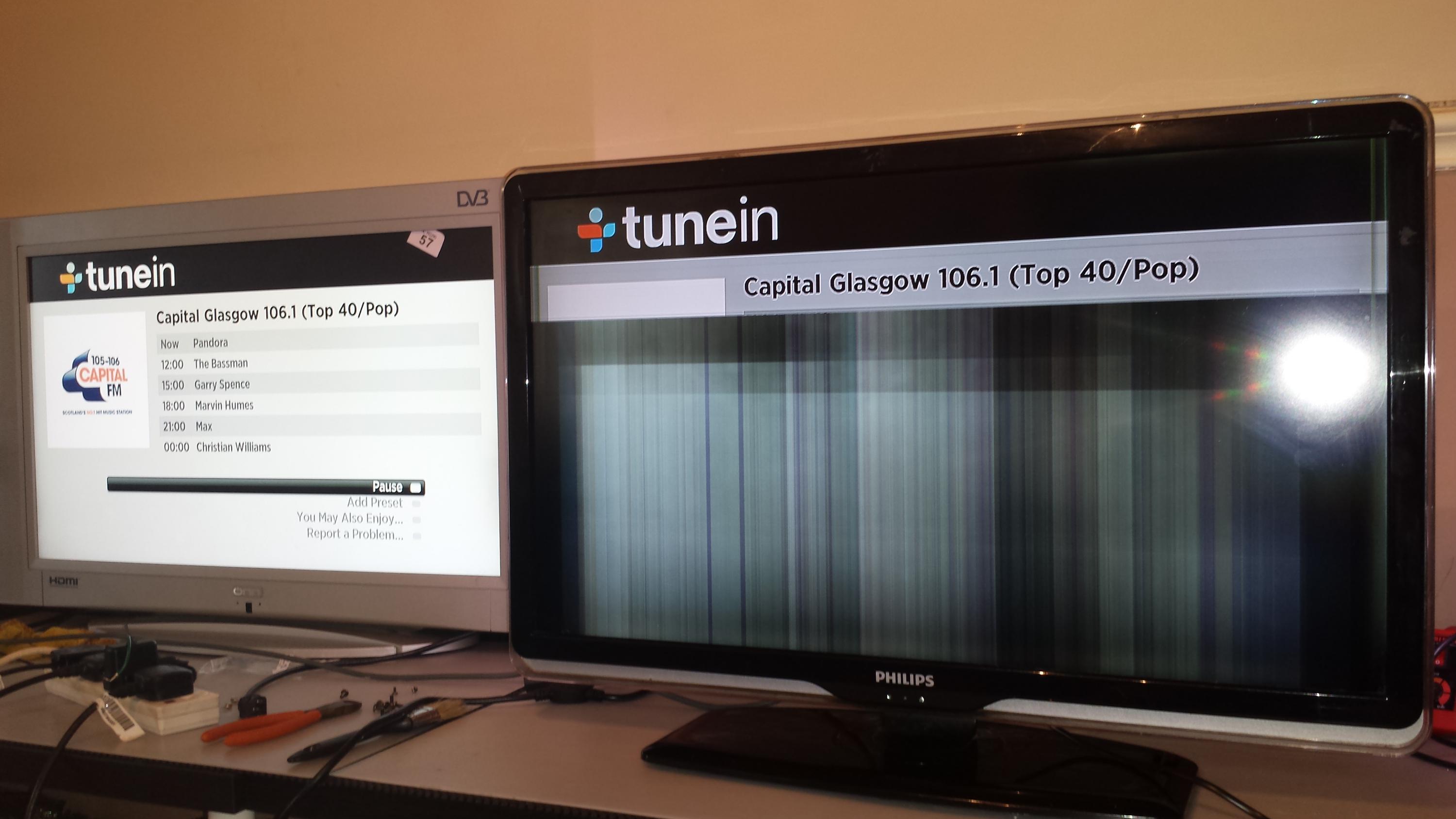

    Hi guys got a friend of a friend that has asked me to loom at his tv. He said the line used to be further down but as time as went on the fault has went further and further up the screen... is this a faulty panel ?
    I have put an old working tv beside the faulty one to show what picture should look like.

    That's a bad panel. Possibly it can be fixed by tab bond repair but probably not. Usually horizontal bars are the hardest to fix

      Ok tom thanks will let him know cheers. Hes givin me 2 tvs so hopefully other one isnt the same.
