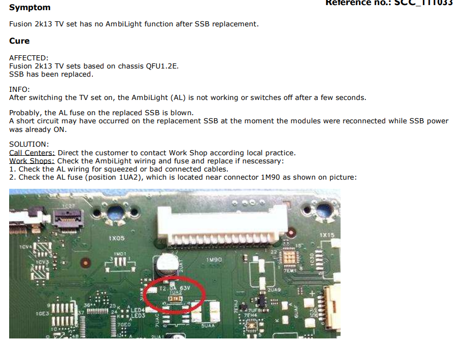

    Then I used the internet, and found a typical problem, where the ambilight fuse will blow, and ambilight won't work at all (like in my case).
    I checked the fuse, but it's fine, and has 12V on both sides.

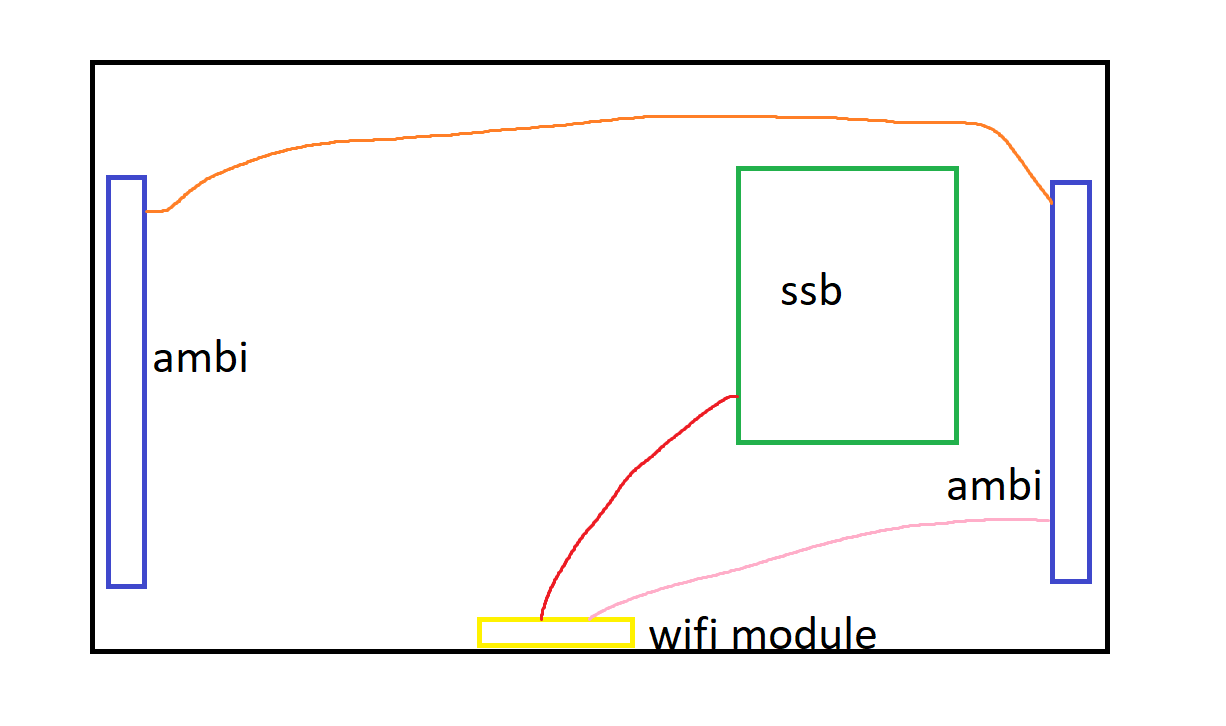

    This is how the ambilight is connected:
    First, from the SSB goes a cable to the WIFI/IR module.
    From that, a cable connects to one of the ambilight sides.
    And from that ambilight side, an identical cable connects to the other side ambilight.
    Between the SSB and Wifi module, the cable is perfect.
    Between the Wifi module and right side ambilight, the cable had a few loose pins, but these are redundant ones, so it even if they were missing, would be still fine. (However, I tried it with an identical cable, and still doesn't work with that one either.)
    Between the 2 sides of ambilight, the cable is perfect.
