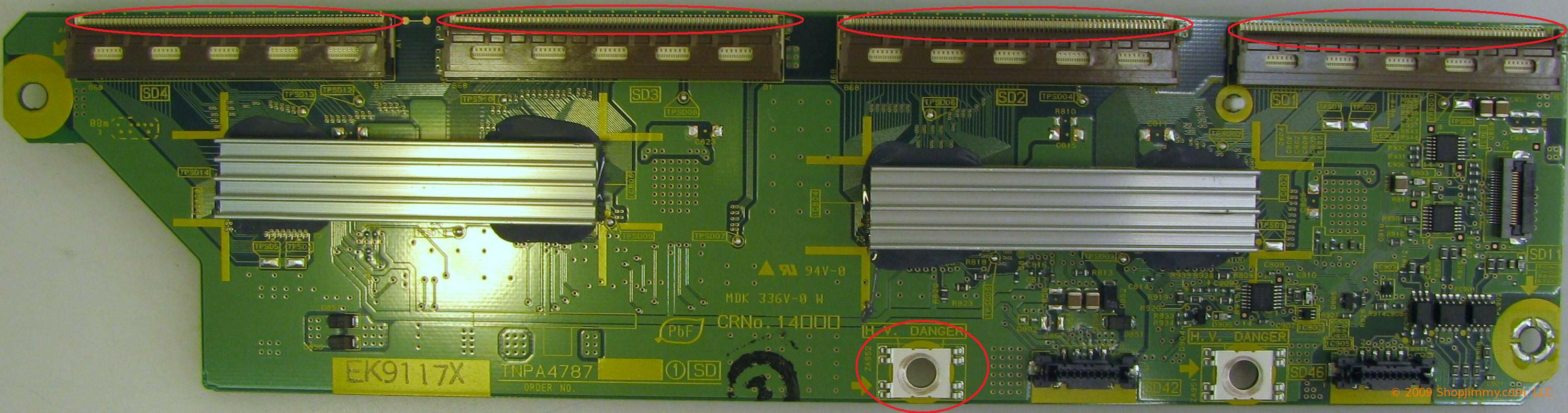

    Re: Panasonic TH-P46G10A
    gnd plate on the board where the bolts sit and each and slide the other slowly along the face of the panel ribbon connectors on the board.
    http://www.paylesscomponents.com/pan...-tnpa4787.html
    http://www.paylesscomponents.com/pan...4787-9398.html
    Should cost just around $62 AUD delivered.
      Checked SD module. And getting a beep between GND and the ribbon connector middle top that connects between the SD and SU board.
        Originally posted by UND312DOG
        Ok. Tested the SU between GND and the four ribbon connectors. Getting a beep on the second ribbon connector on about four pins.
        Tested the SD on all four ribbon connectors. No beep.
        Could very well be ok if no dead short. If you know someone with another meter like a fluke you could keep testing but with the link I gave you for a pair of boards, i would buy both at that price.
        before installing any used board, test the same just in case they too are DOA.
          that's not an area to test if you're talking the tiny ribbon that interconnects at SD11

                        Received my replacement boards. Did the resistance test before installing. No good.
                        SU board - I'm getting a short between ground and the SU2 ribbon connector in 2 places.
                        Resistance wise nothing is showing between GND AND SU41 pin 2.
                        SD - There are no shorts between ground and the ribbon connectors. Resistance wise I'm getting 1.081m ohms between GND and SD42 pin 9.
                        Sc board measure again and is in tolerance.
                        Help.
                          Not good news. That supplier is pretty reliable, not infallable I guess. I would send him a message for help and tell him what you've found.
                          Dead short between gnd and output is never good. When you say resistance wise nothing showing, do you mean 0 ohms or out of range / limits?
                            Multimeter shows 1 when open. When connected between su41 and GND it shows -.000
                              Ok, so showing dead short at pin 2 and shorted at the outputs. That's what I'd expect on a bad one.
                              Damn. Only 2 options really, try to get him to send another SU or SU/SD set. ask for it to be checked for shorts at the outputs and pin 2 - gnd.
                                    Ok. Received the replacement cards today. Just running tests on them at the moment. Both cards are showing no dead shorts between ground and the outputs. Which is good.
                                    I'm running the resistance test on both cards. SD 1.038m ohms and SU 1.052m ohms at their respective test points. A pass is 2.1M ohms. I don't know if it's my meter or not. And I don't want to put them in, in case I damage the TV further.
                                      I think you'll just have to give it a go. 1Meg seems to be a common value you're getting. Far from short and I think even your other board that was not shorted was giving 1 Meg.

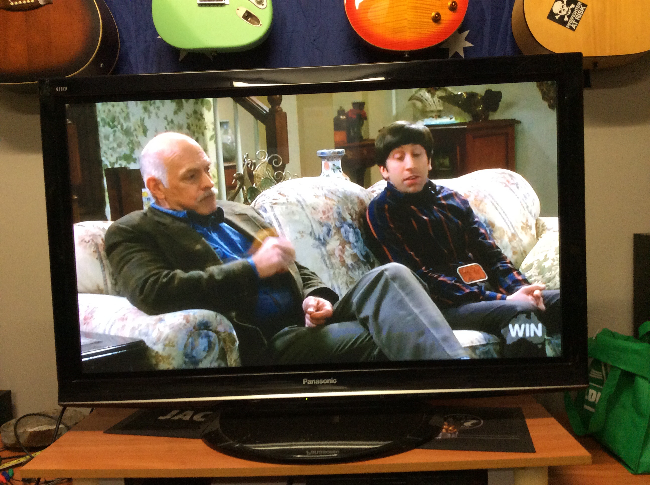

                                        Yeah I guess so. The good thing is there is no dead shorts to outputs. I'll give it a go shortly. Results shortly.
                                        • UND312DOG
                                          • May 2014
                                          • 63
                                          #40
                                          We have picture. You beauty.
                                          I have noticed two black lines running through at the bottom of the screen. I'm guessing a incorrectly seated ribbon on the SD board?
