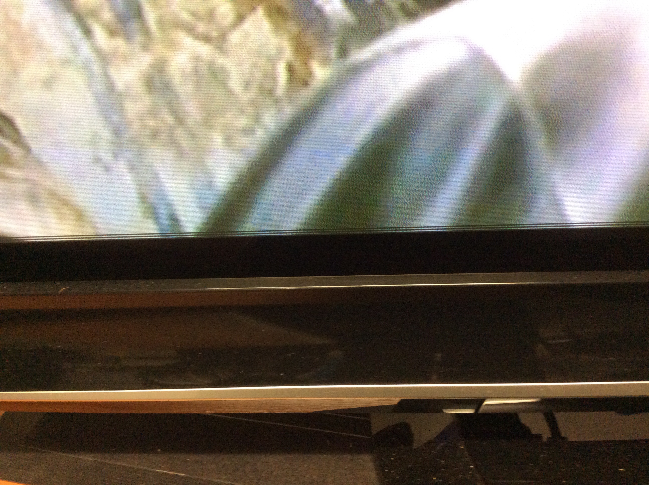

Panasonic TH-P46G10A
  • UND312DOG
    • May 2014
    • 63
    #41
    Re: Panasonic TH-P46G10A
    Here
    • tw2005
      • Oct 2011
      • 6458
      #42
      Yep, power off and reseat last ribbon on the SD
      • UND312DOG
        • May 2014
        • 63
        #43
        Perfect. Everything up and running like new again. Thanks again for all your help mate. Appreciate it a lot. $62 to fix a busted TV. Yeeeew.
        • tw2005
          • Oct 2011
          • 6458
          #44
          good to hear.
          Would not hurt to get back to payless and give them some positive feedback.
          i genuinely think he tries his best.
          believe it or not the boards I got and reported good, one turned out shorted and the other was wrong version. Seems like he's going to do the righty and replace them, yet to be confirmed.
          being away for 2 months did not help.
