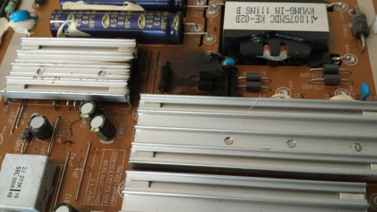

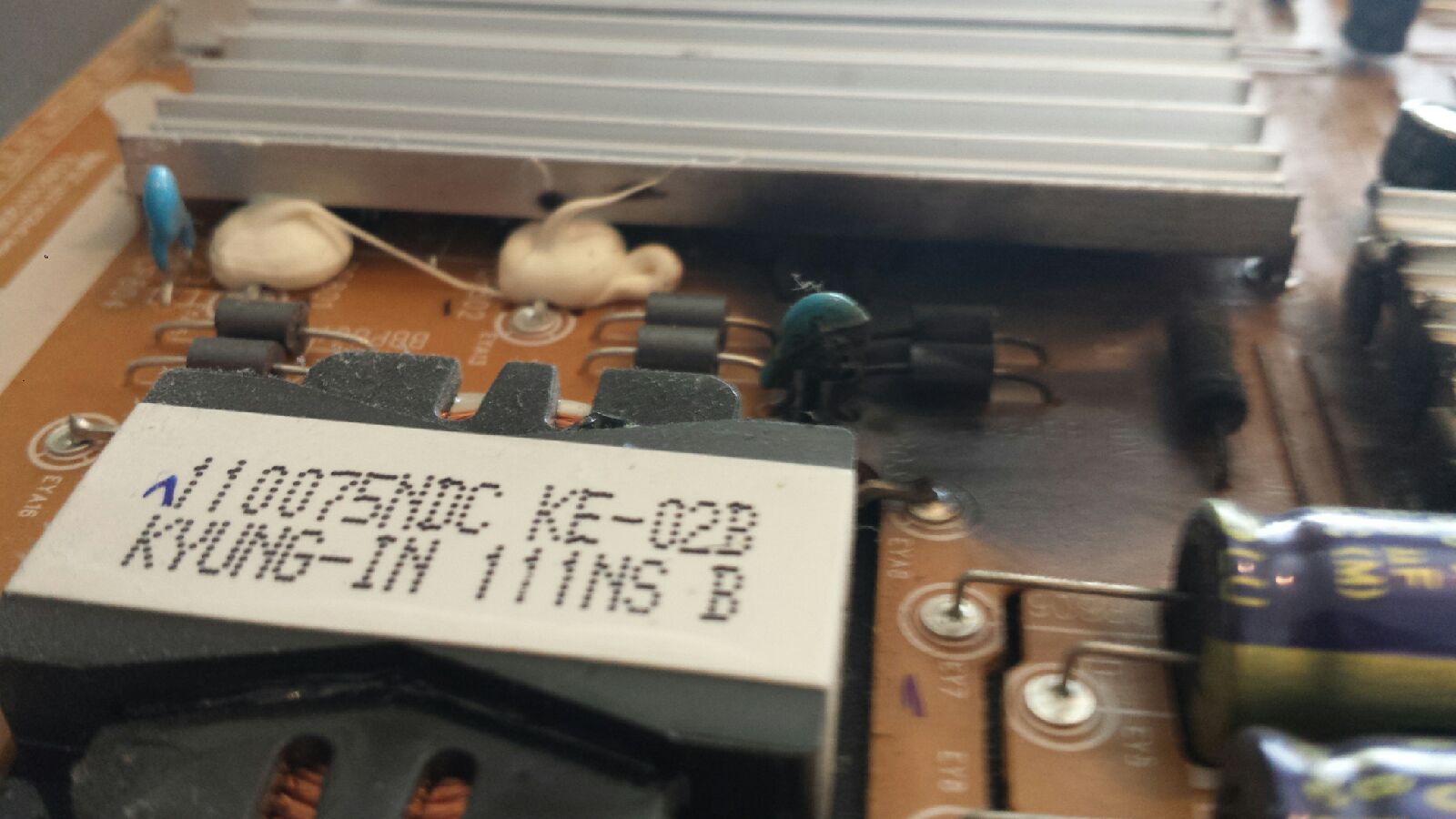

    Howdy, I am trying to get some information (part#/rating) on a capacitor on the Samsung BN44-00424A Power Supply Board. The capacitor is CP803, it blew out and I'm hoping that replacing it will fix my problem . Thanks for any assistance in advance.
    Re: Samsung LED TV UN55D6000SFXZA Pwr Sup Board BN44-00424A
    That is the high voltage snubber cap for the diode DP801.
    Did it blow up badly that you cannot read any printing on it? Picture of it may help
      Thanks Budm, I'll try to upload a picture later tonight. Yes, it blew up and all that is left is some parts of the blue. There is charring all around it, but none of the other parts seem to have received damage.

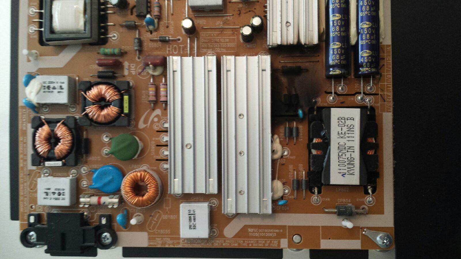

        See attached for pics. Looking for part info. Thx.
                I just look at the diagram of BN44-00428B, it has the same setup as your board. That cap is 220pF 1000V.
                I would go for 2000V for more reliability.
                1000V, 5mm lead spacing

                    So, just installed the capacitor and had the fuse checked. The fuse was bad, so I went to radioshack and got a fuse, only problem is that the fuse didn't match up exactly. The fuse I got was a glass with low breaking capacity, the one in the circuit card is a ceramic with high breaking capacity. I tried the fuse blew instantly, so I'm hoping that replacing the fuse will solve my problem, no other noted damages. I'll post an update when I get one, let me know if you have any ideas.
                      That means there is shorted out circuit on the board some where.

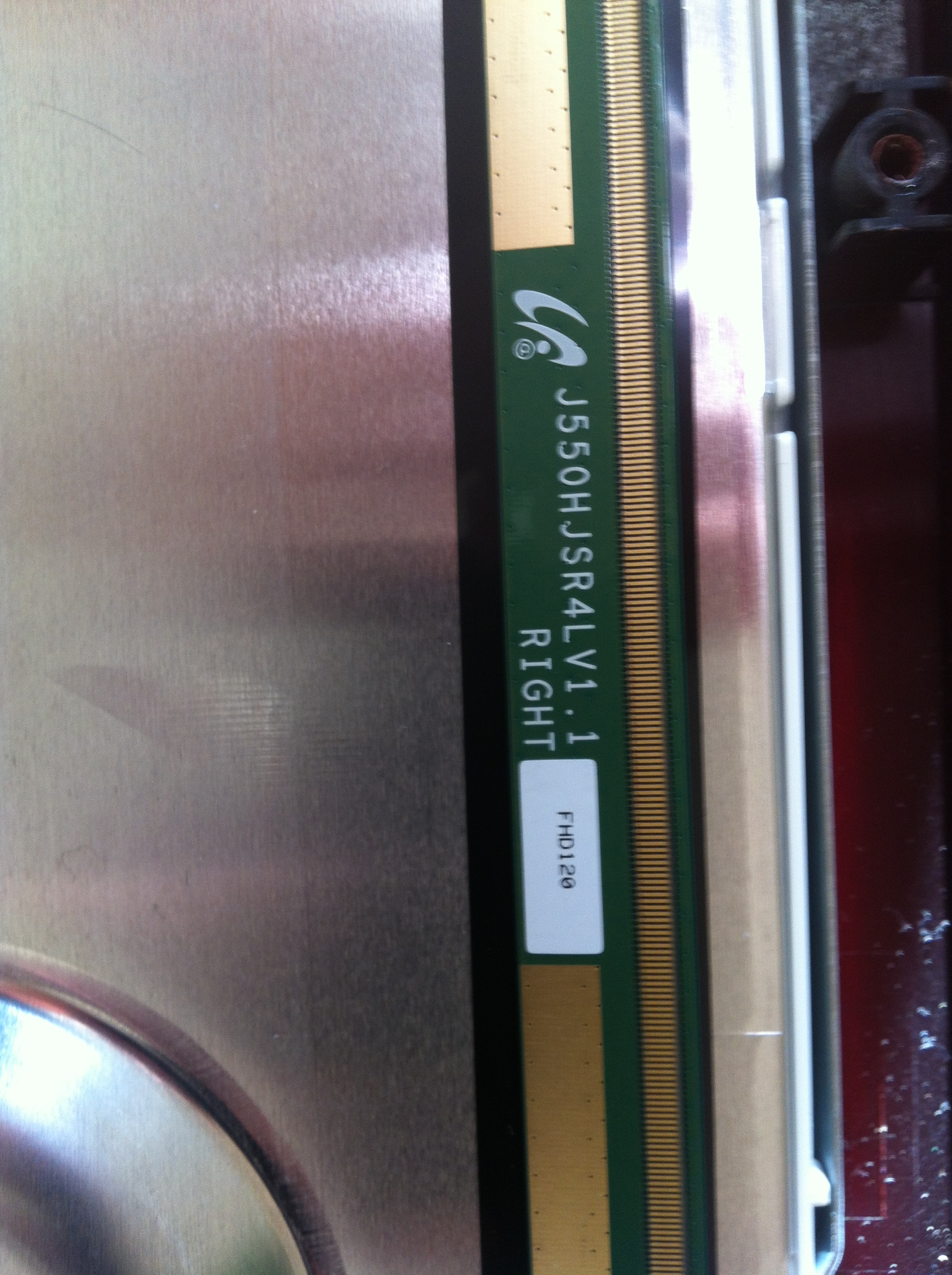

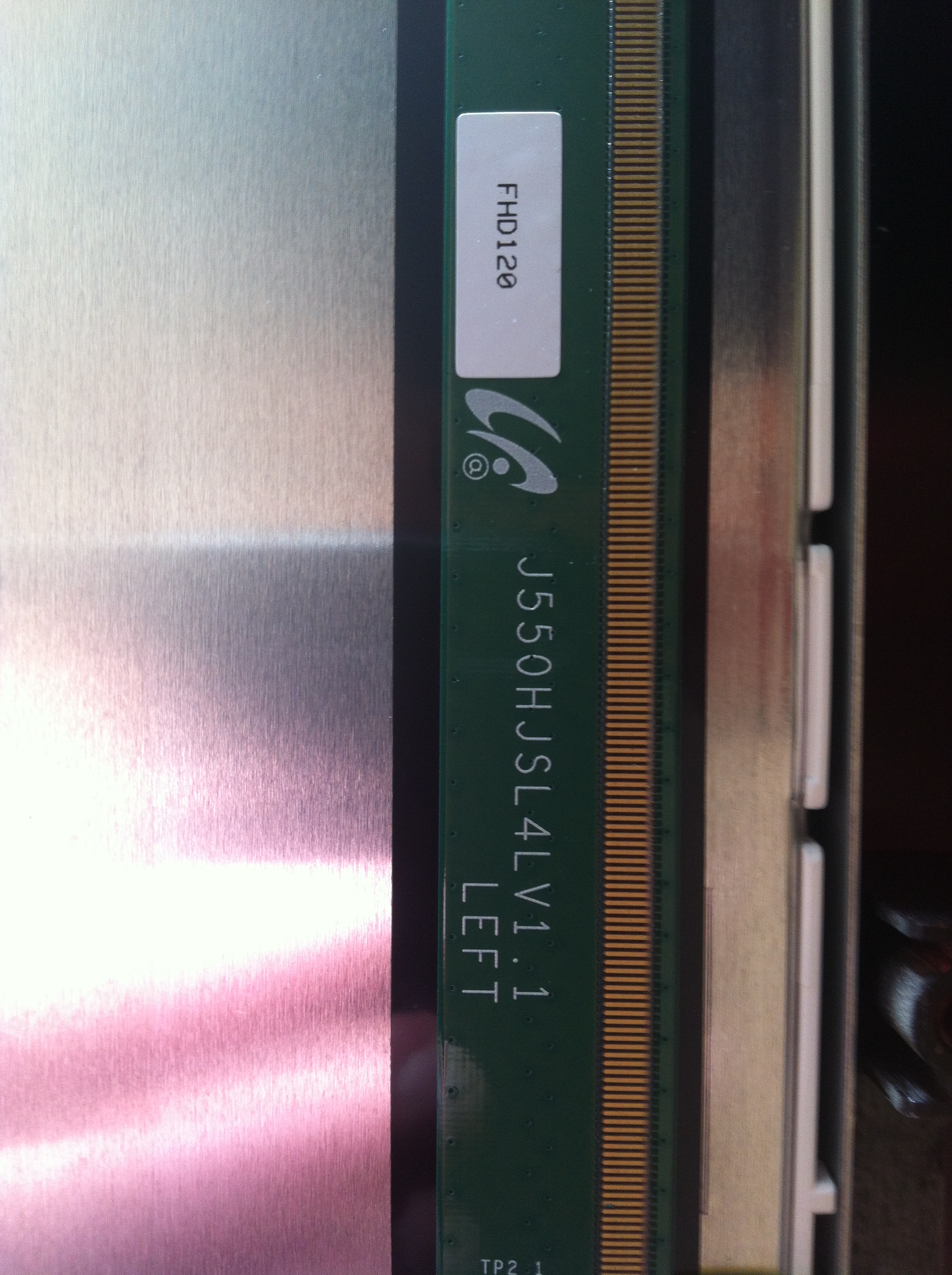

                                  I replaced the PS board and now have power. However there is still an issue and not sure if it's the PS board I installed or something else. So now my UN55D6000 TV has sound but a black screen with images that can be barely seen. Would this be a problem with the Power Supply board or the Inverter boards (left & right). From a youtube video, I unplugged the connector from the main board to the PS board and the screen was still black. I also unplugged the left inverter and still a black screen. I then reconnected the left and unplugged the right inverter and still a black screen. Do you think this is the power board/LED driver? Would you know which pins to measure the voltage of that drive the LED's and what that voltage should be? Thanks in advance.

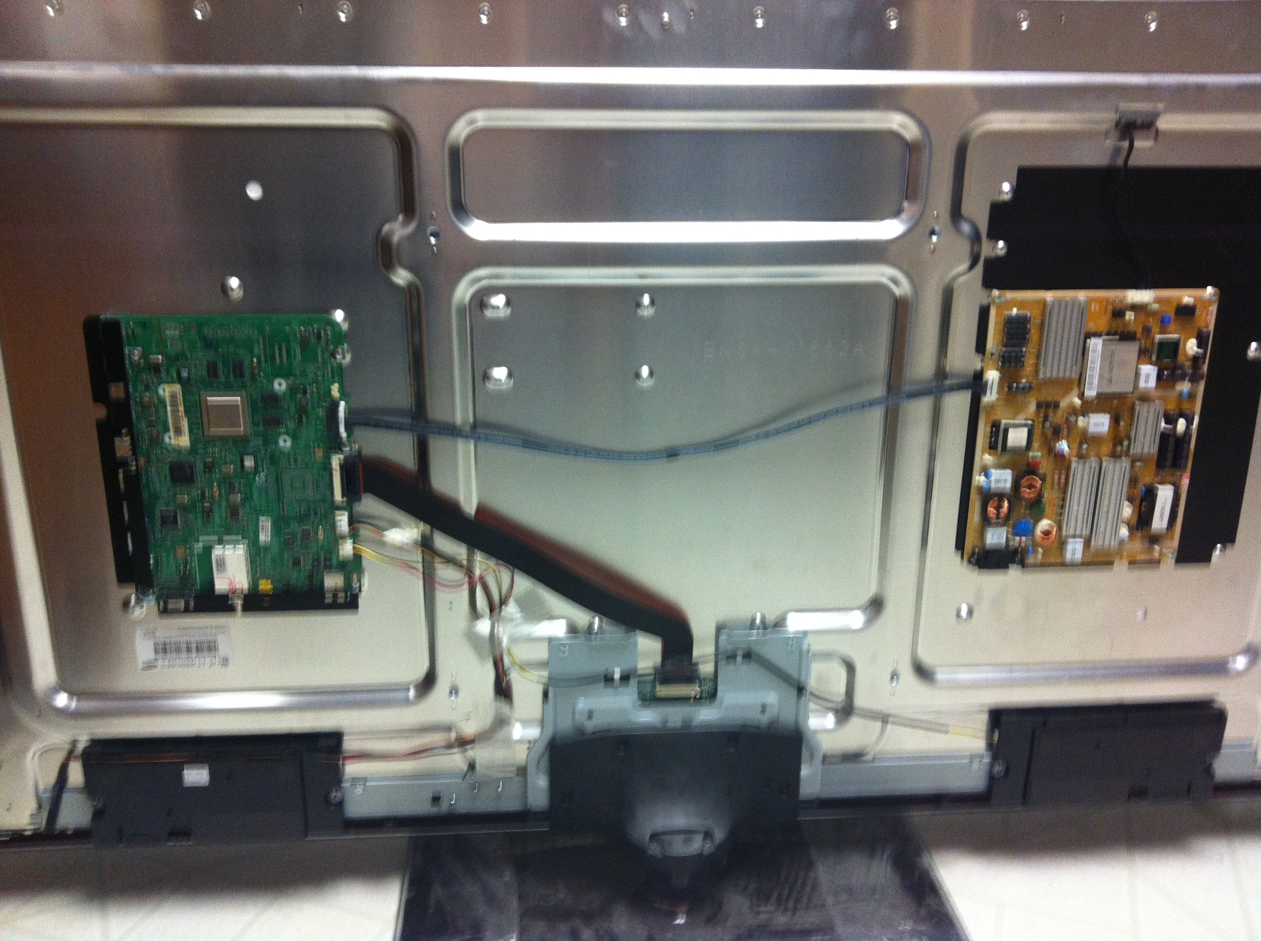

                                      It is LED backlights so it does not have Inverter for High Voltage for the CCFL.
                                      So is John is working on the same model TV power supply board or not.
                                      OP power supply board is BN-44-00424A.
                                      http://assets.shopjimmy.com/media/ca...00424a-top.jpg
                                      If is not the same model then he should start a new thread.
                                      "I also unplugged the left inverter and still a black screen. I then reconnected the left and unplugged the right inverter and still a black screen." I like to see the pictures of these two boards and the whole back side of the TV.
                                        Thanks for the help. Yes it is the BN-44-00424A Power Supply board. Attached are four pictures.
