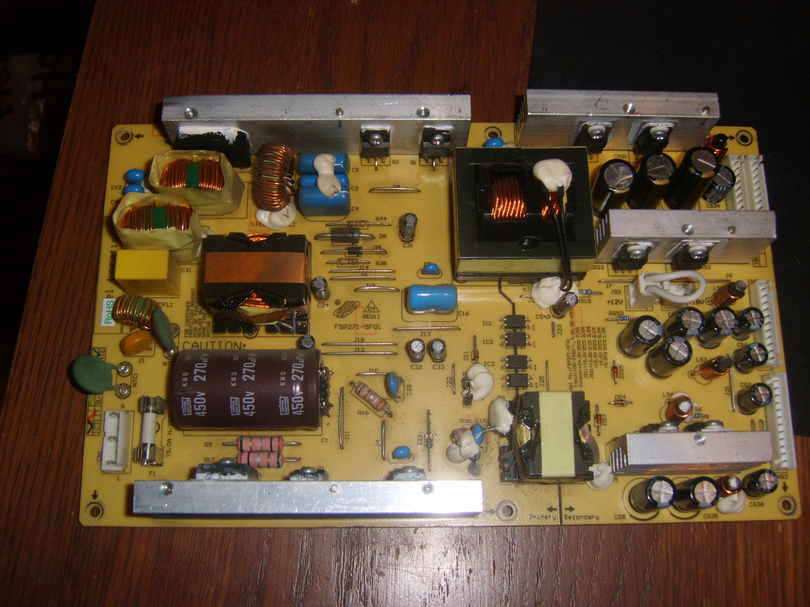

                • anotherdude
                  • Feb 2013
                  • 488
                  • uk
                  Re: ELONEX JC378BB13E Screen Flashes
                  heres a shot of the power board anyway
                  and what maybe the cause of my no standby now?
                    You've probably popped the fuse.
                      thats what I thought but i'm getting 124v on the heatsinks near the large cap
                        That means very little because the heatsinks are connected to a pair of class Y caps which are sometimes before the fuse.
                        You should try checking the fuse directly...
                          fuse tests good, also seeing voltage on the tops of the smaller caps
                          little to no voltage secondary side
                          the first picture i uploaded is it supposed to look like that? there are others with the spacer on but none have that green wierd colour on them
                            Any standby voltage? Try without main board. Check voltage across 450V cap. Check voltage across C31,C32,C33,C34, and one small cap near the big 450V cap.
                              no standby voltage, nothing on any of the pins leading to the main board
                              big cap = 124v
                              c31 = 117v
                              c32 = 122v and dropping
                              c33 = 122v and dropping
                              c34 = 119v and dropping
                              cap near large cap 122v
                                124V is that ACROSS the cap i.e. red on positive, black on negative. Same for other caps.
                                  no sorry tom was meausring across the top
                                  can't reallly measure the other caps as there on the underside but will try later
                                  but the big cap measures 327v
                                    anyone able to advise on where to go from here, can't seem to spot the problem or bad partt
