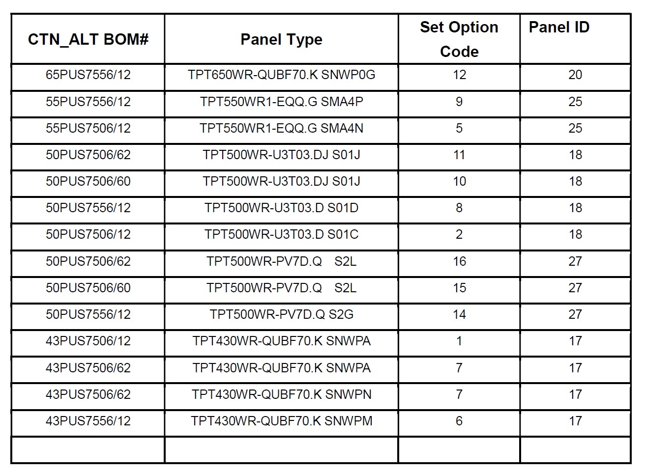

Philips TV 43pus7505 setting display option code, help please.

    Try this NVM Files - https://****************/file/d/1syA...ew?usp=sharing

        It was fuc... USB stick.
        First I try plan A. No go.
        Then plan B. No go.
        Then I try file from leszekp. No go.
        So I insert empty USB and upload NVM. It was DONE.
        But how if stick is empty? So I format other stic and upload leszekp file.
        In the moment, I insert stick, TV restarts and TA DA. All is O.K
        So again, thanks leszekp for files and of course all others to support me.
        Without you TV will be scraped.
        Thanks, again, Sebastijan.​

              Hi, didn't find it for my TV. Philips 55PUS7506/12.
              I recently replace the main board and now I have split screen. I think problem is in panel indentification. The code 062598,MENU,028(in my case) not working. So I think I need to replace the panel number in NVM file. Can you help me?

                        @ Primozd​, Maybe this will help. There is no 028 option for a 55PUS7506/xx
