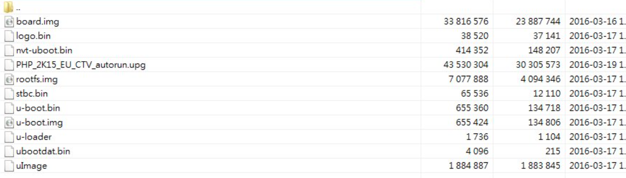

        Have you updated with the three-file firmware EmptyBurn_package 2in1_V2.550?

            Every updates I could find was in a zip comprising the three files which I copied to the root of the USB stick and installed by the update option of the normal menu.
            Yes I forgot to mention I already used "Virgin Mode" in combination with "DRM Warning off" , no success doing that.

              Do you have such an update, we tried it "EmptyBurn_package_with_2.330.zip", which contains 11 files?

                No I did not find yet a such full update.

                    I installed the new update, no change except it has no more option in the secret menu to disable DRM Warning ...
                    I had an Idea, if the CI key is calculated on the serial number, it might be interesting to grab the Serial number of the donor TV to associate to the dump containing the key, despite to find the calculation algorithm
