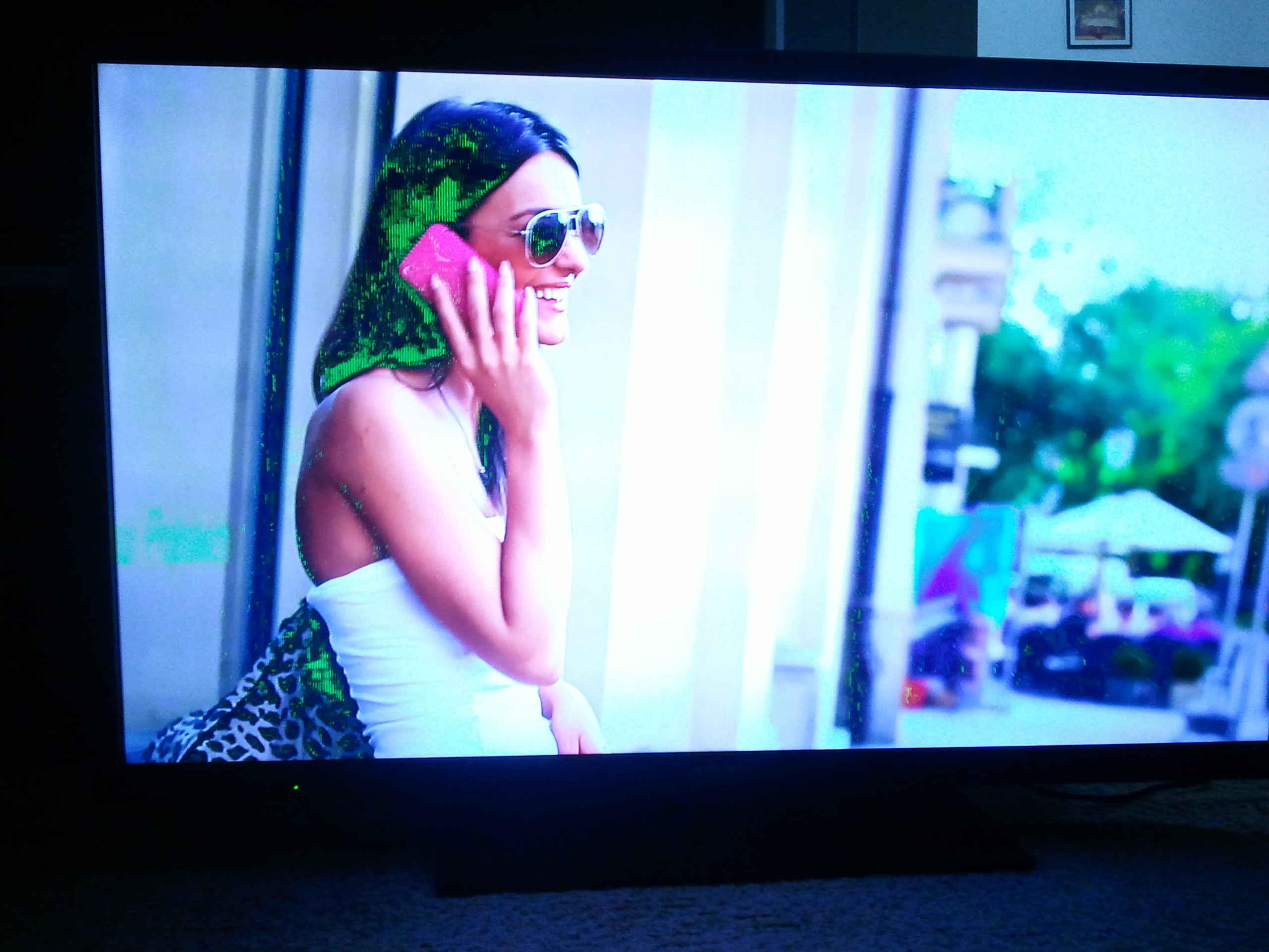

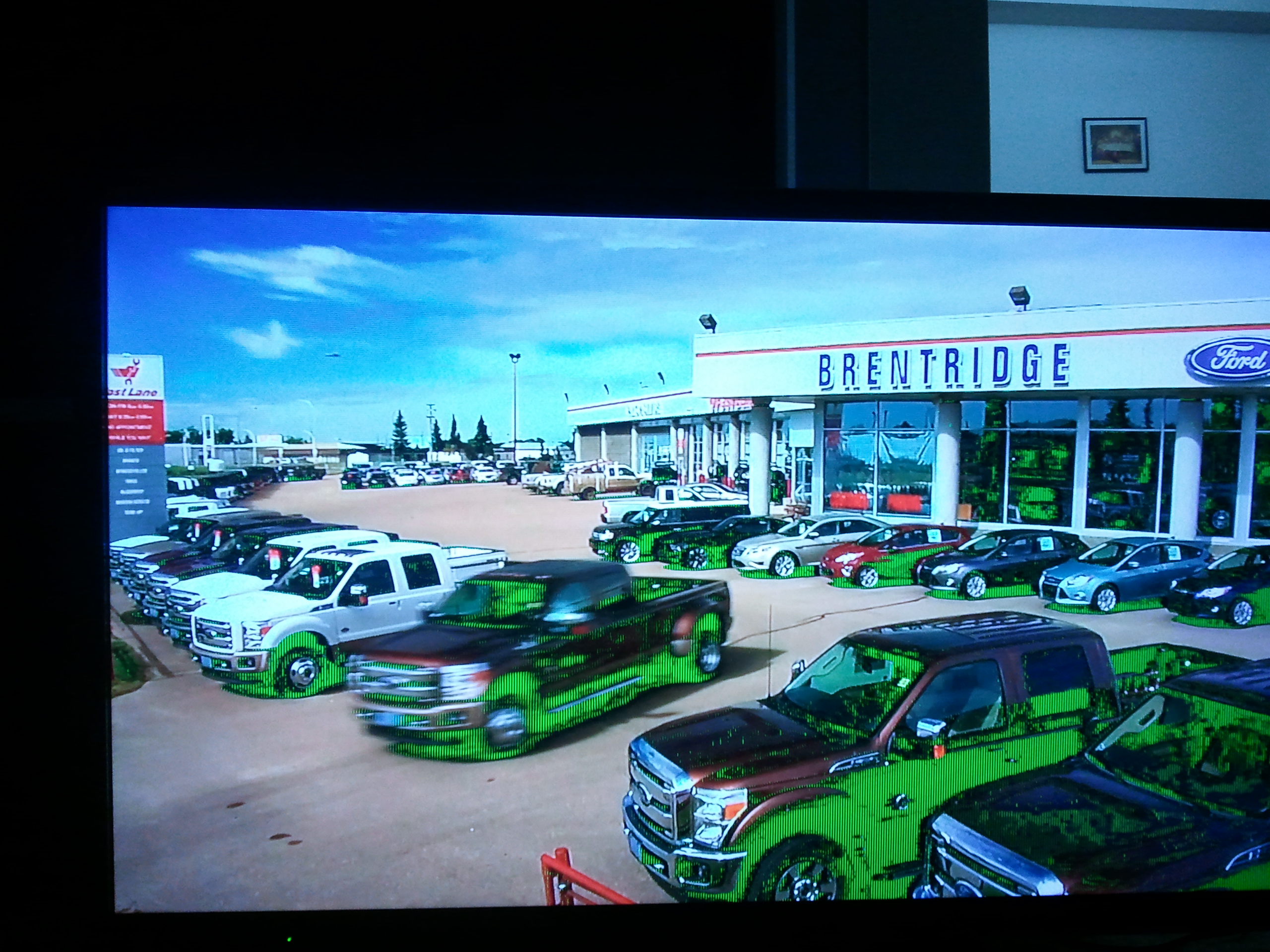

                #67
                Re: Sony Bravia KDL-46EX640 no power
                additional pics added for more infos:

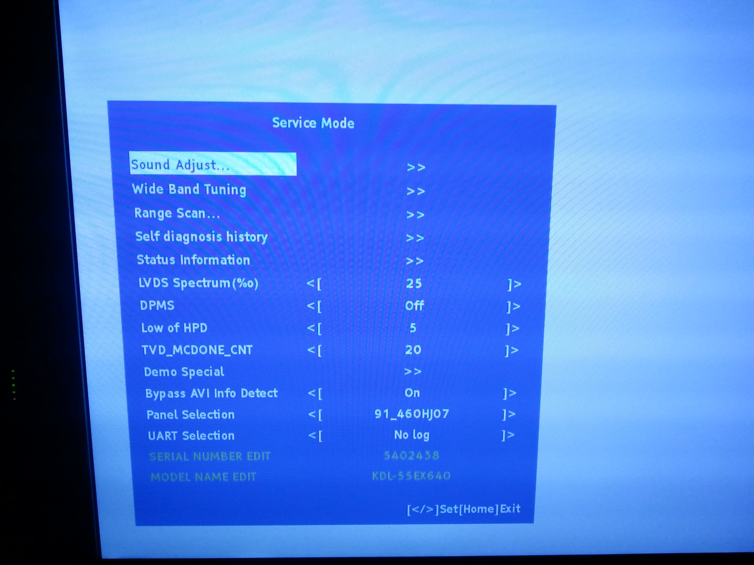

                  #68
                  More infos regarding service menu:
                    #69
                    As you can see the model name is KD556EX640 but my TV is KDL46EX640 and the Main Power registers 001. Any suggestions?
                      #70
                      looks like u got the right panel number, i think the model names does not matter since the panel is right. looking at the service menu i can see at least one setting that conflicts with yours. match it according to the manual. but honestly i think one of your cables to the t-con / mainboard might not be in properly. doesnt to clean and reconnect
                          @ holmzy: can you please point out what parameter do I have to check?

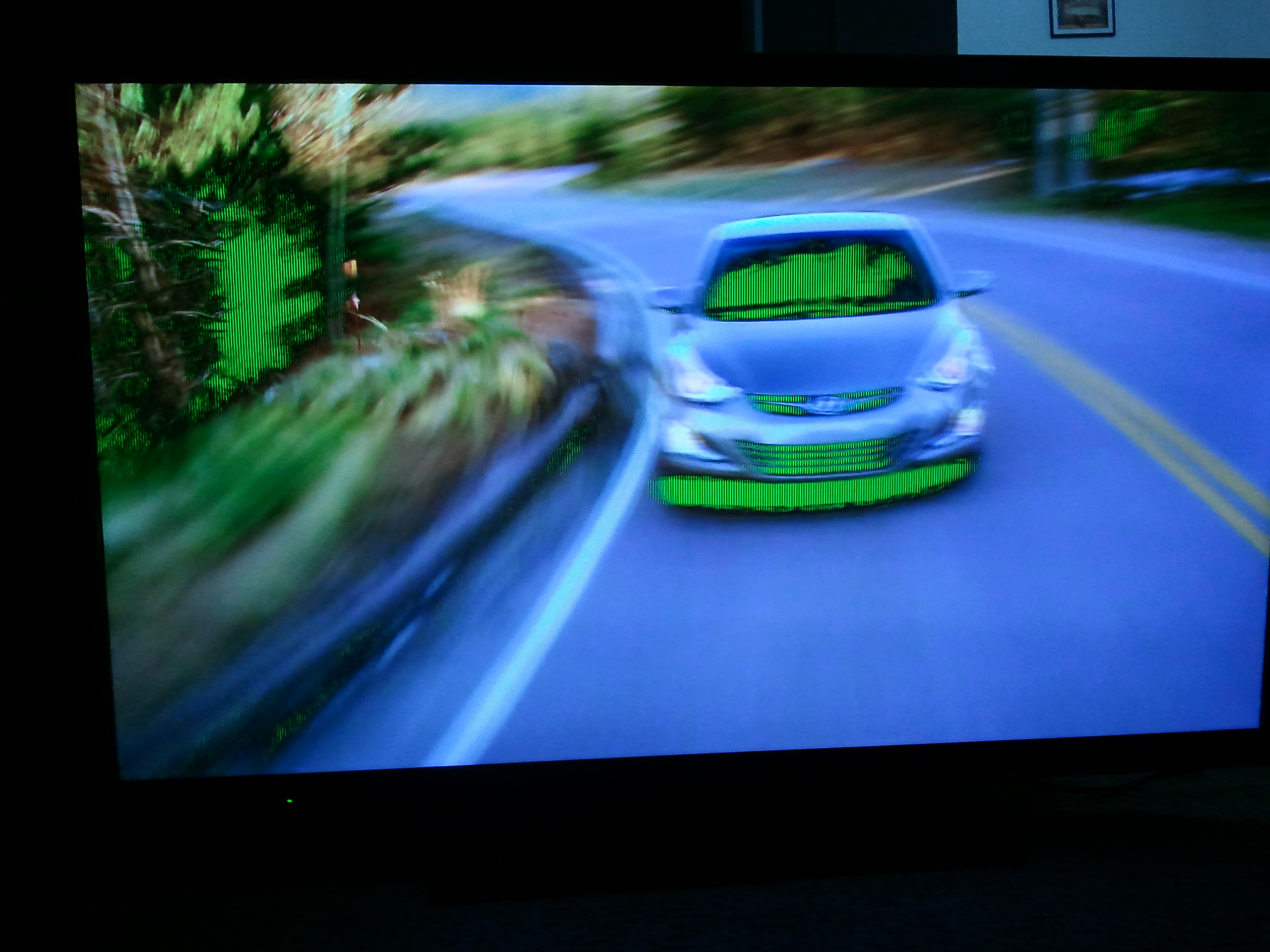

                            #73

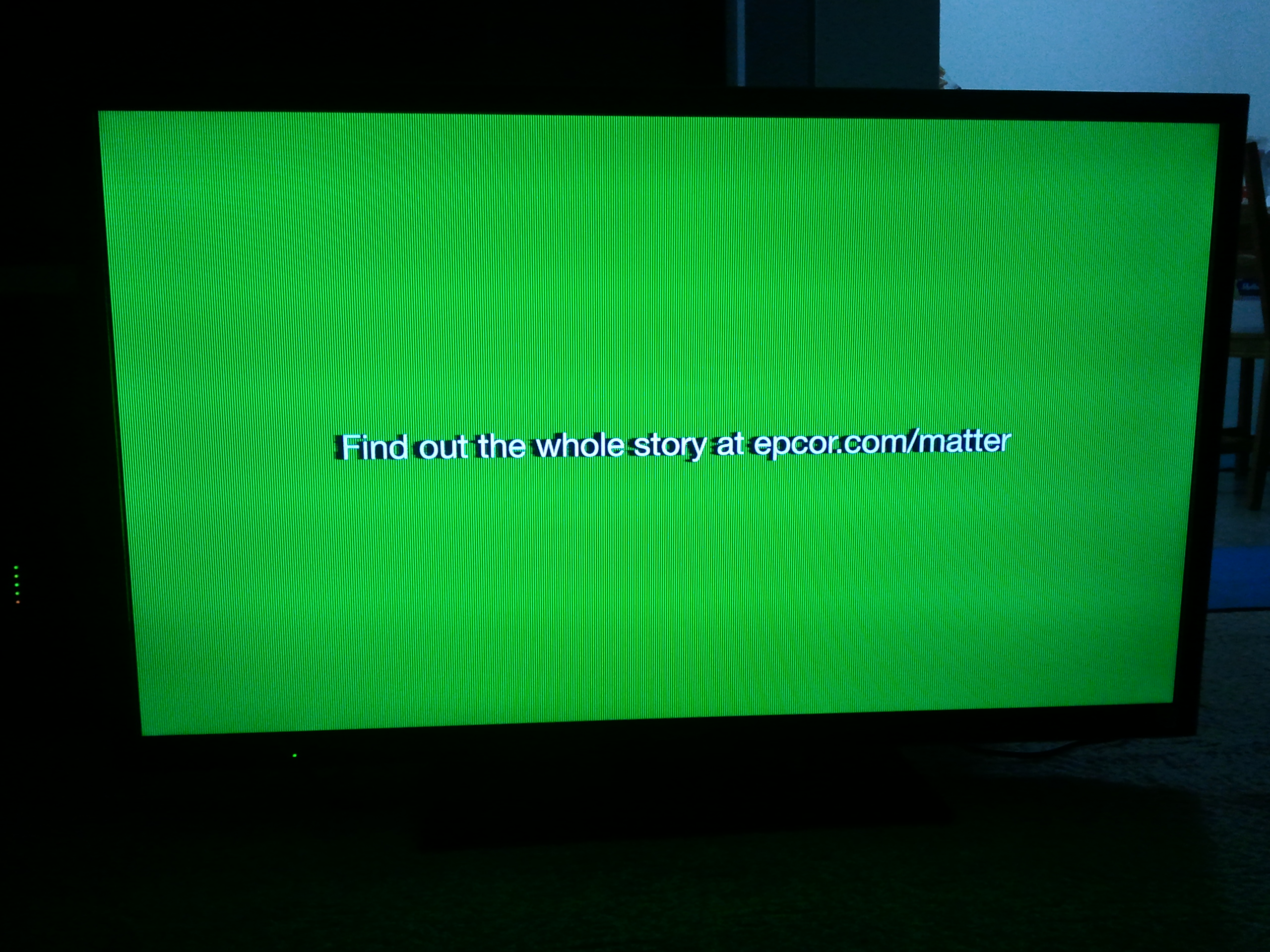

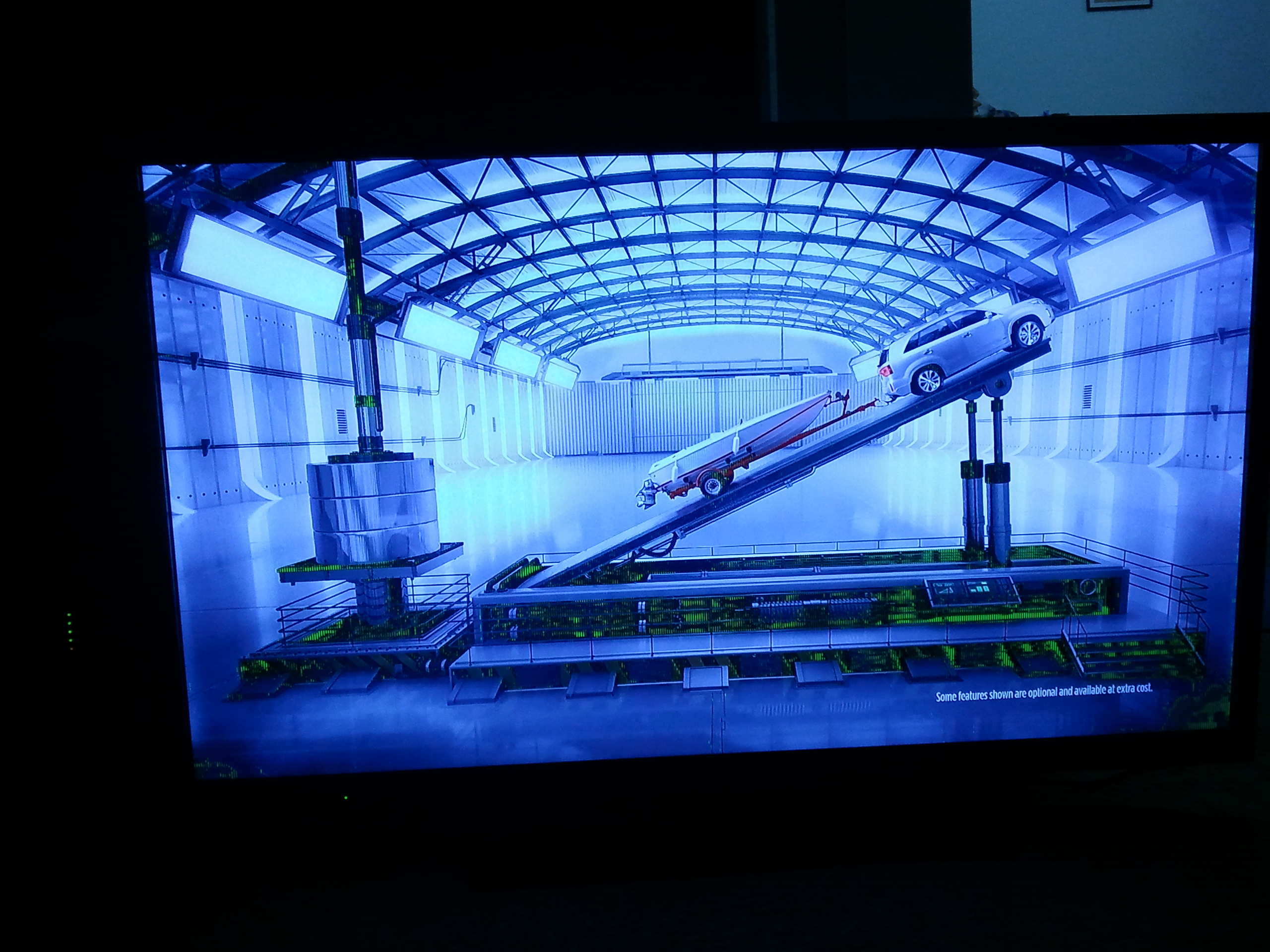

                            This is the result if I put high values on brightness, contrast, etc.

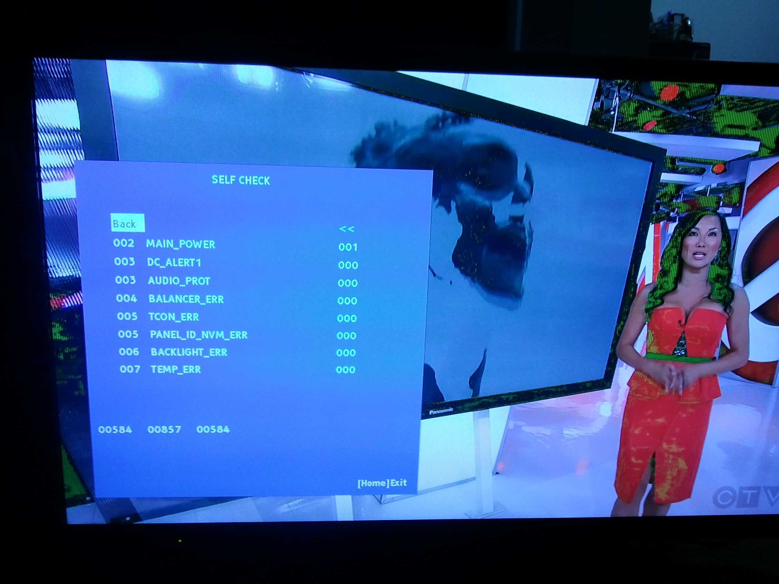

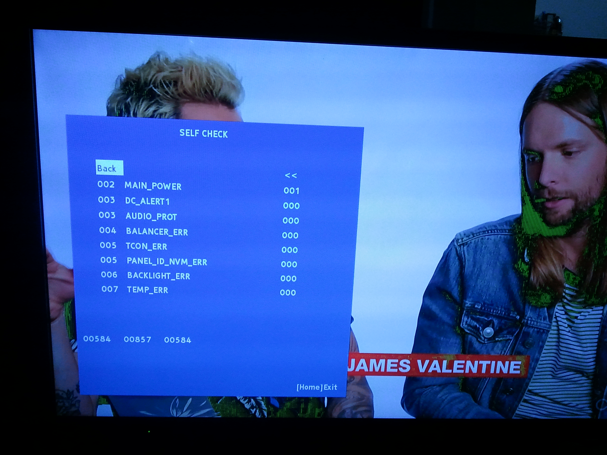

                                #75
                                In the error log, it seems like you have a main power error(001). I'm not an expert, but I would check all the voltages to make sure that is all fine and I would clear that error.
                                I would try adjusting the LVDS level.
                                I would measure gamma voltages on the T-con board also.
                                  #76
                                  @ tibimakai: thanks for your input. I have problem saving the LVDS level. It keeps on going back to 25 even if I set it at 20.
